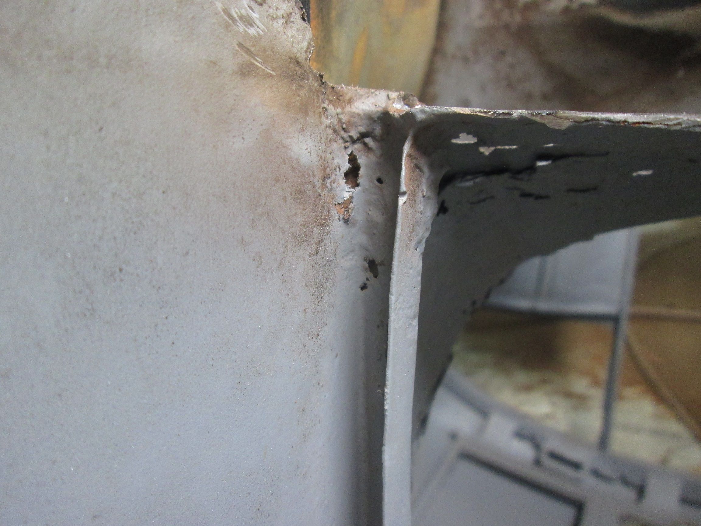

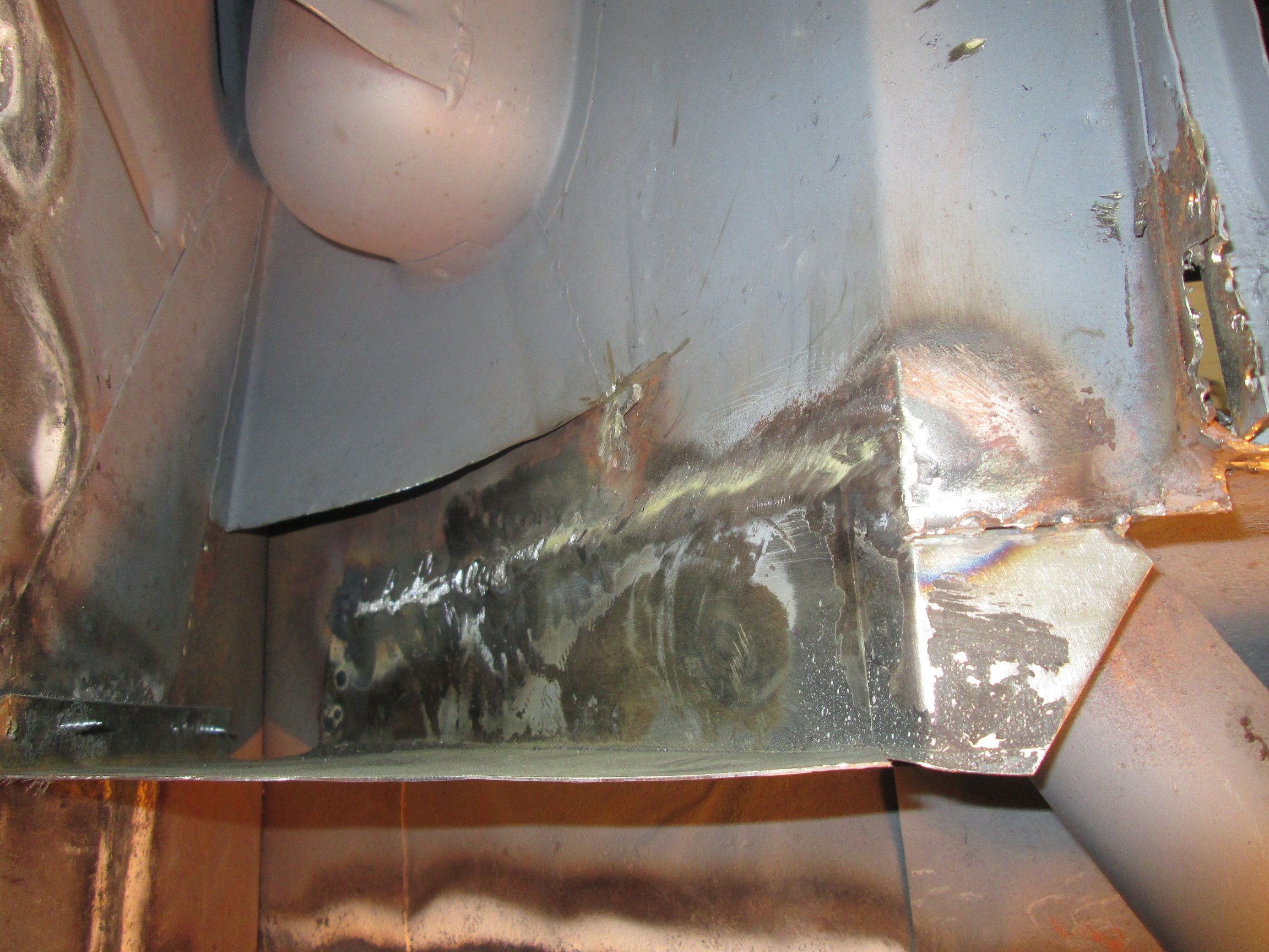

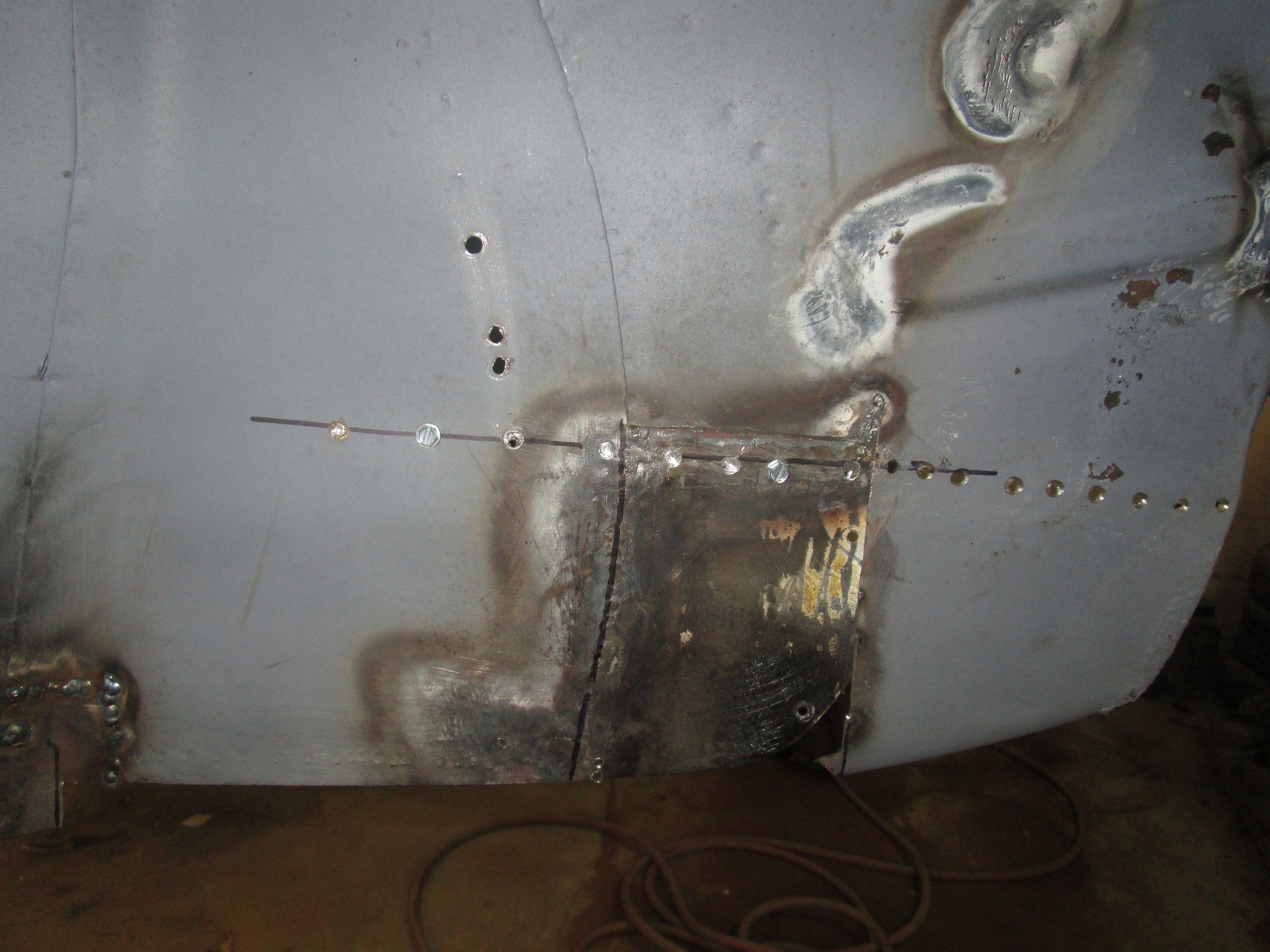

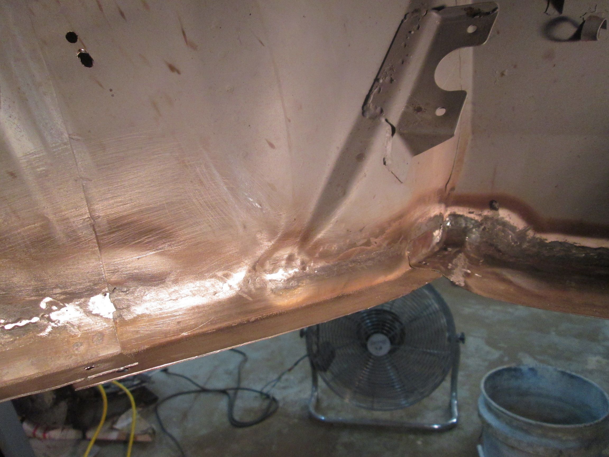

  • Installing rear closing wall:
ID:	111542 Refitting the of the original rear closing wall.
ID:	111543 Tacked pretty much back into its original spot.
ID:	111544 Thought I was going to get away without having to repair lower seal channel but as I prepped and cleaned the area a couple small chunks fell away; Not surprised...
ID:	111545 New closing panel fits down between closing walls very well.
ID:	111546 Wall seam welded back in as it was originally.

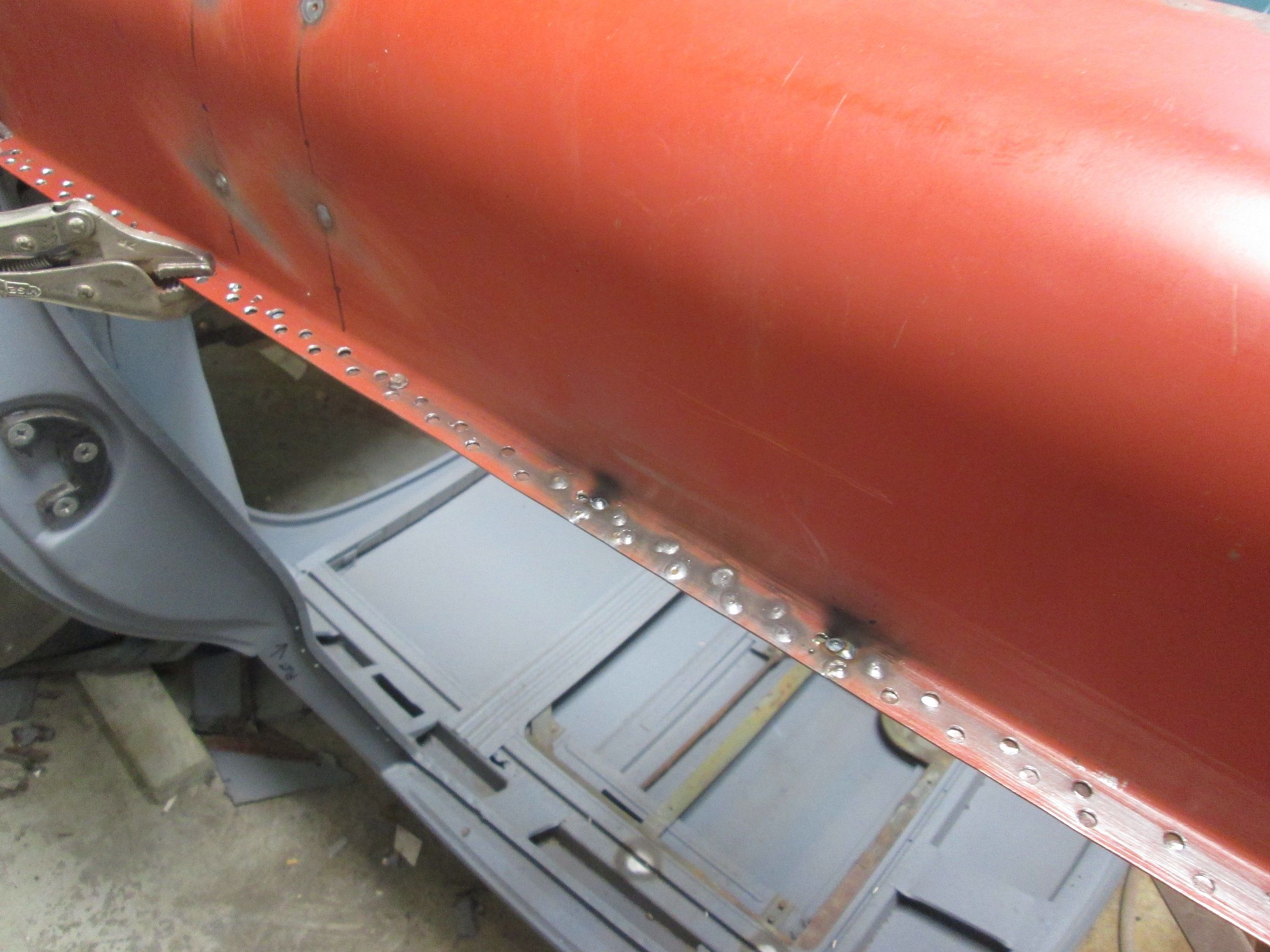

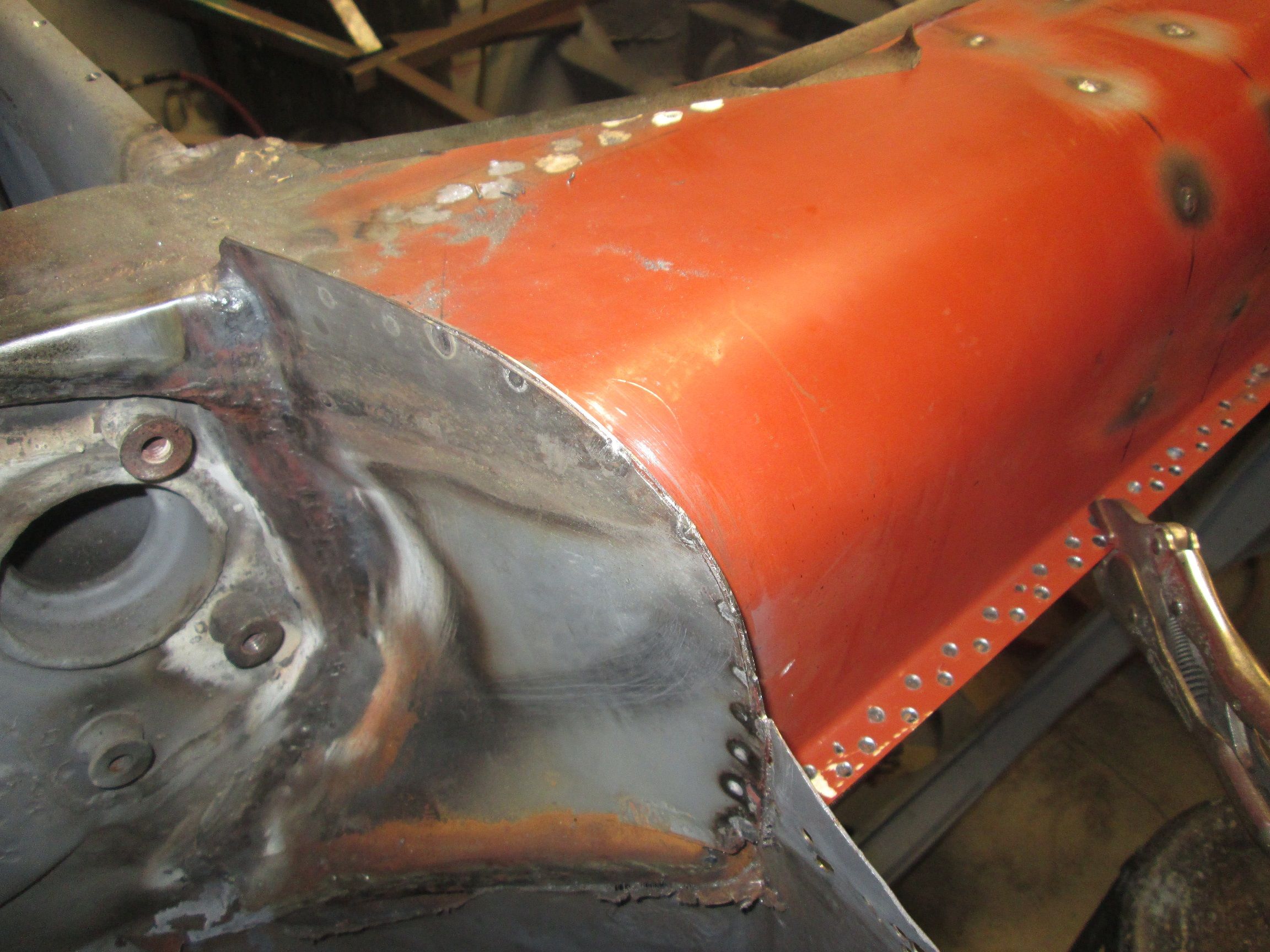

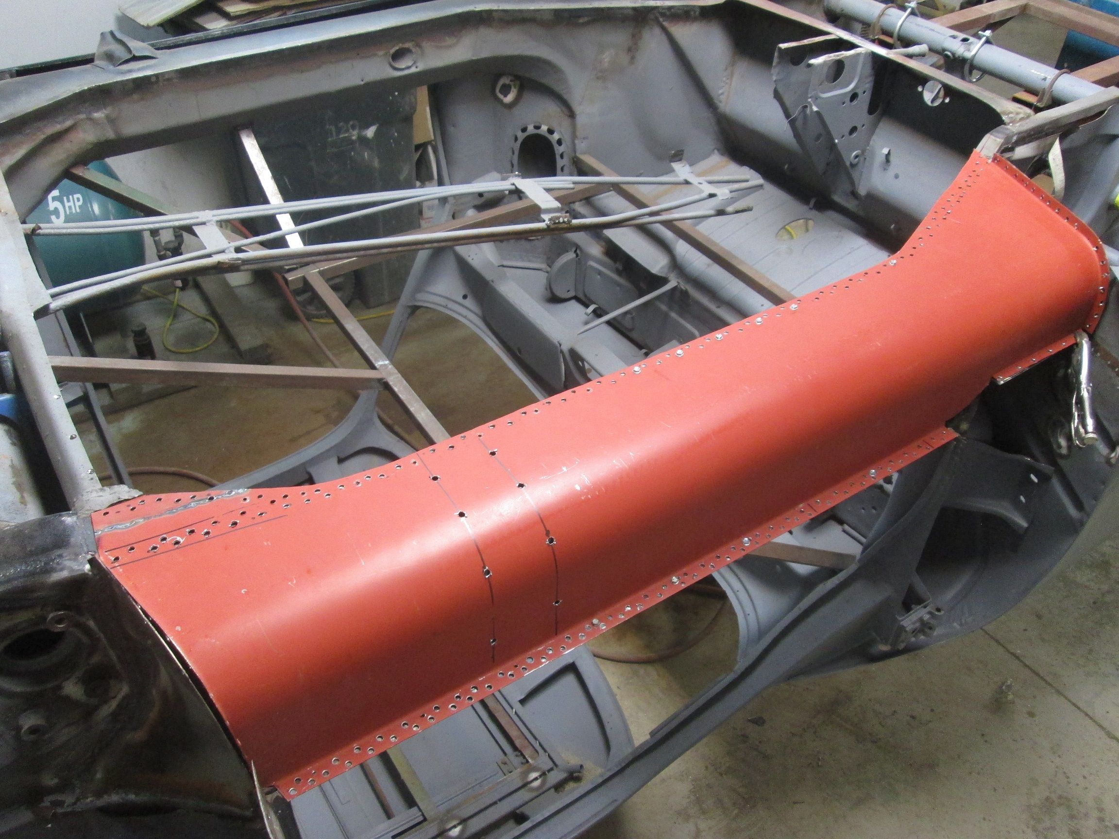

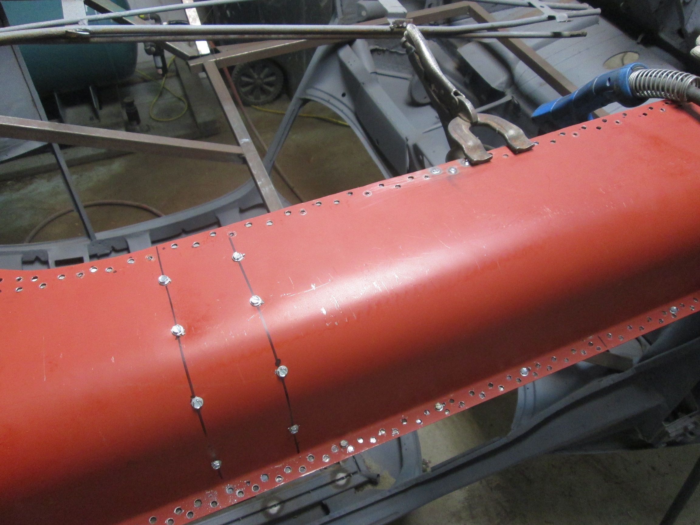

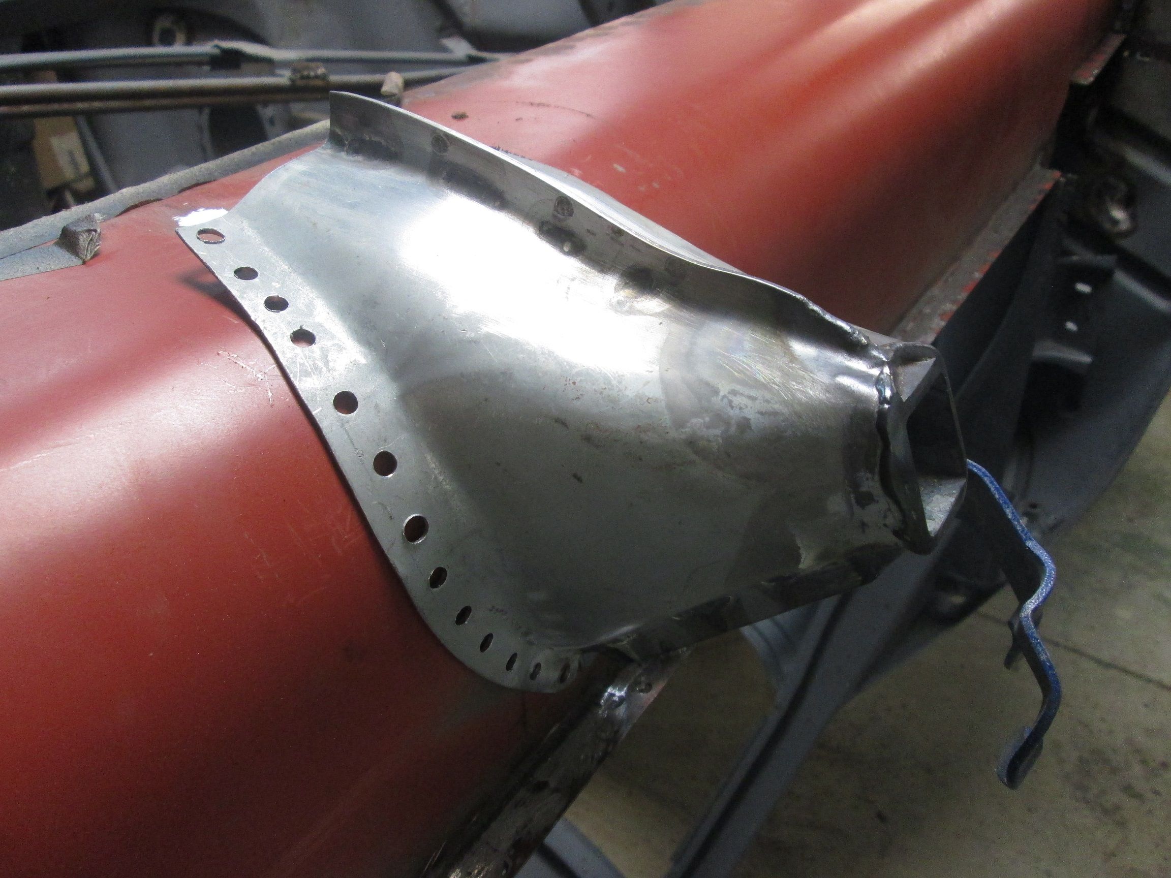

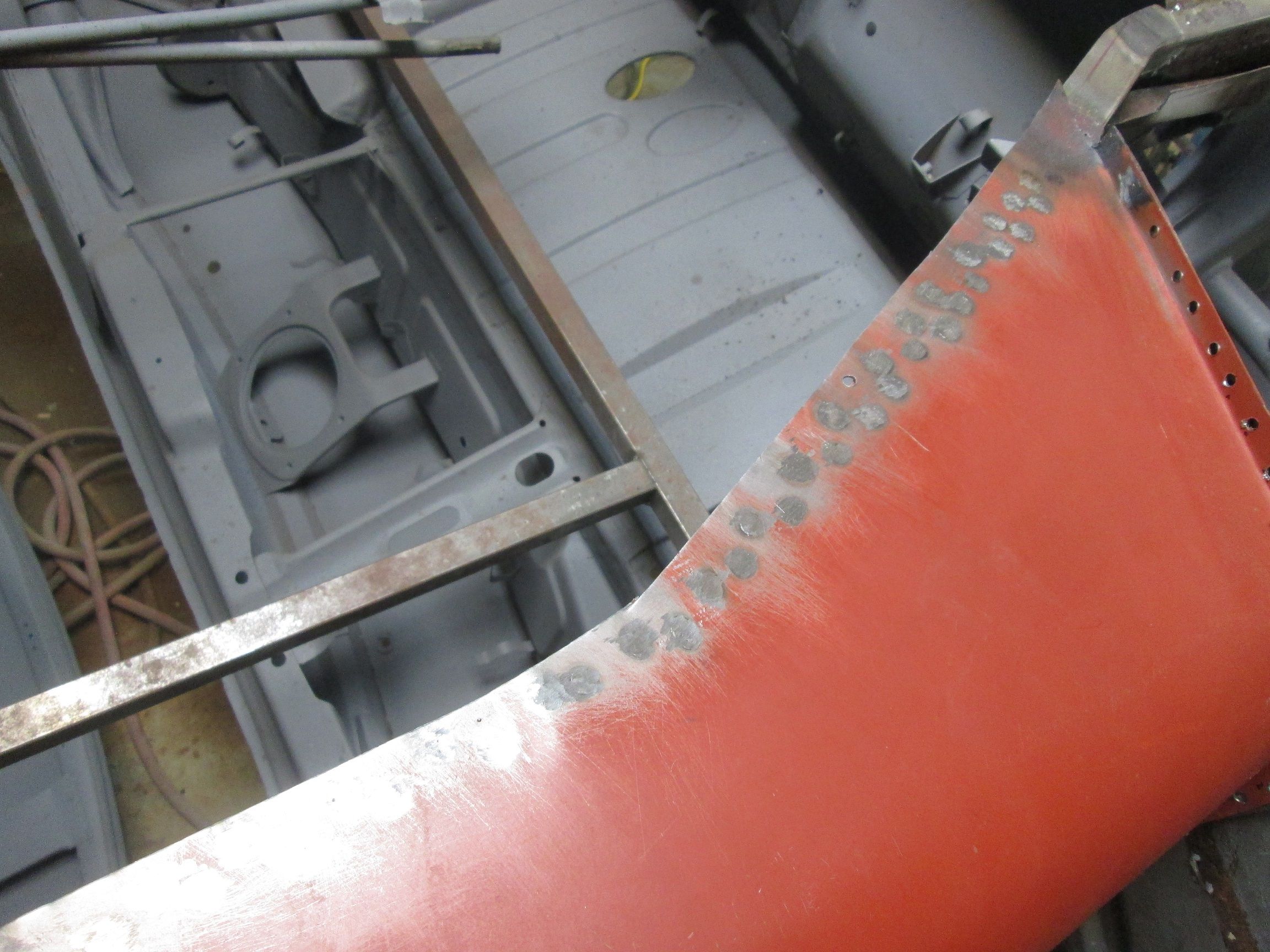

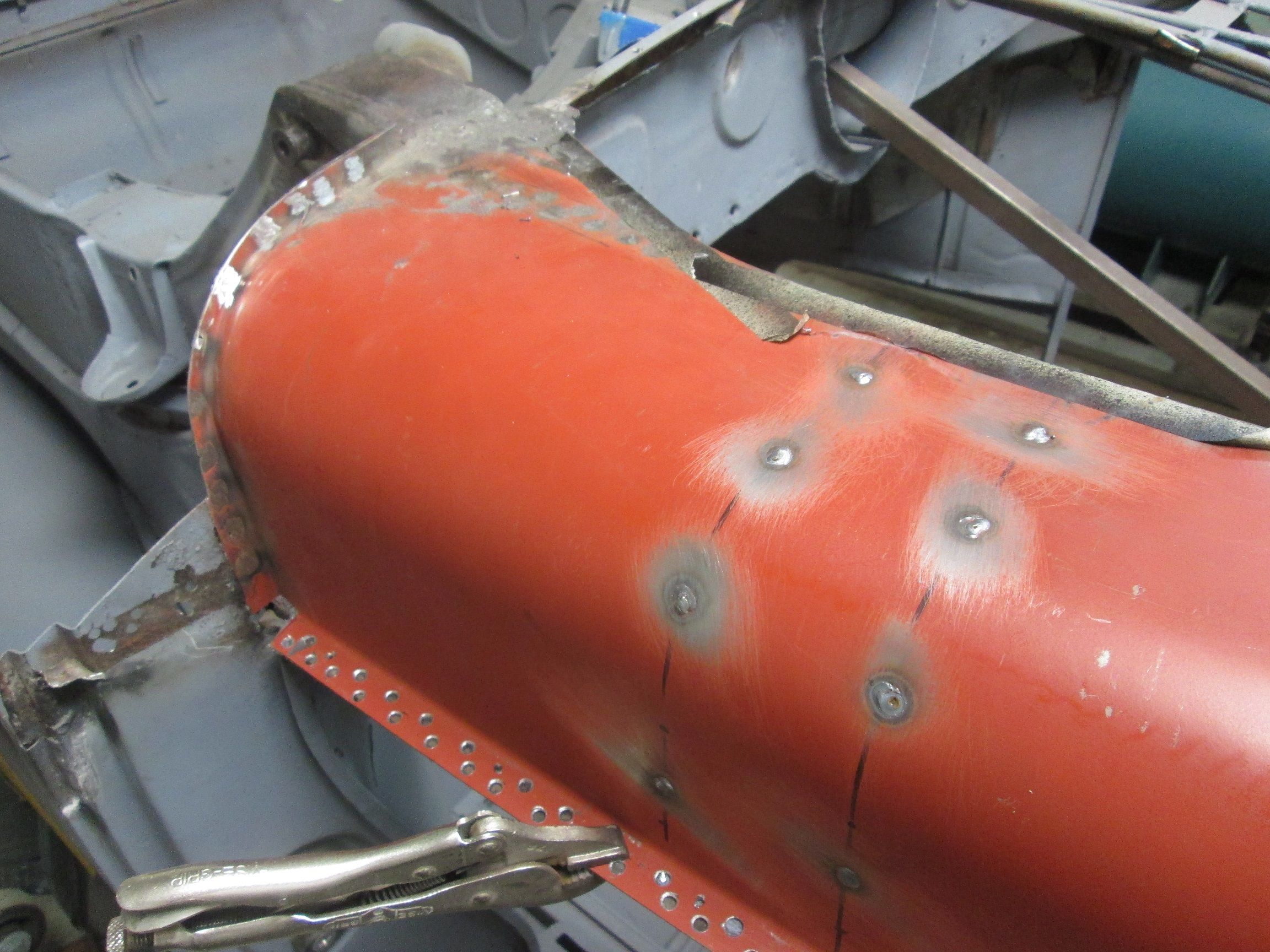

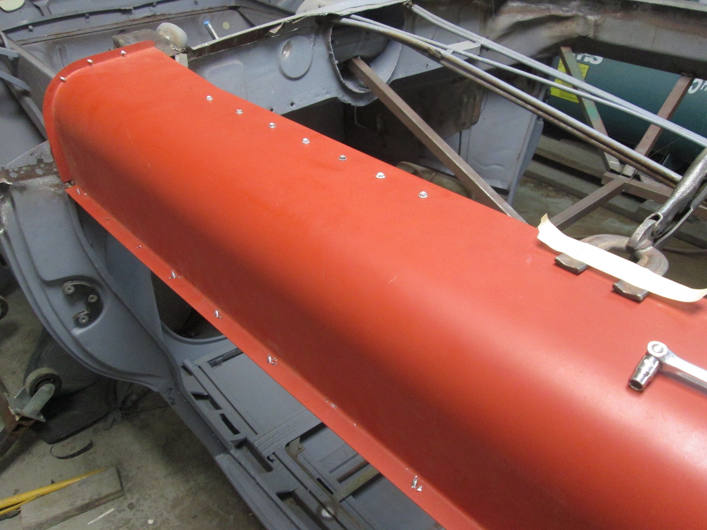

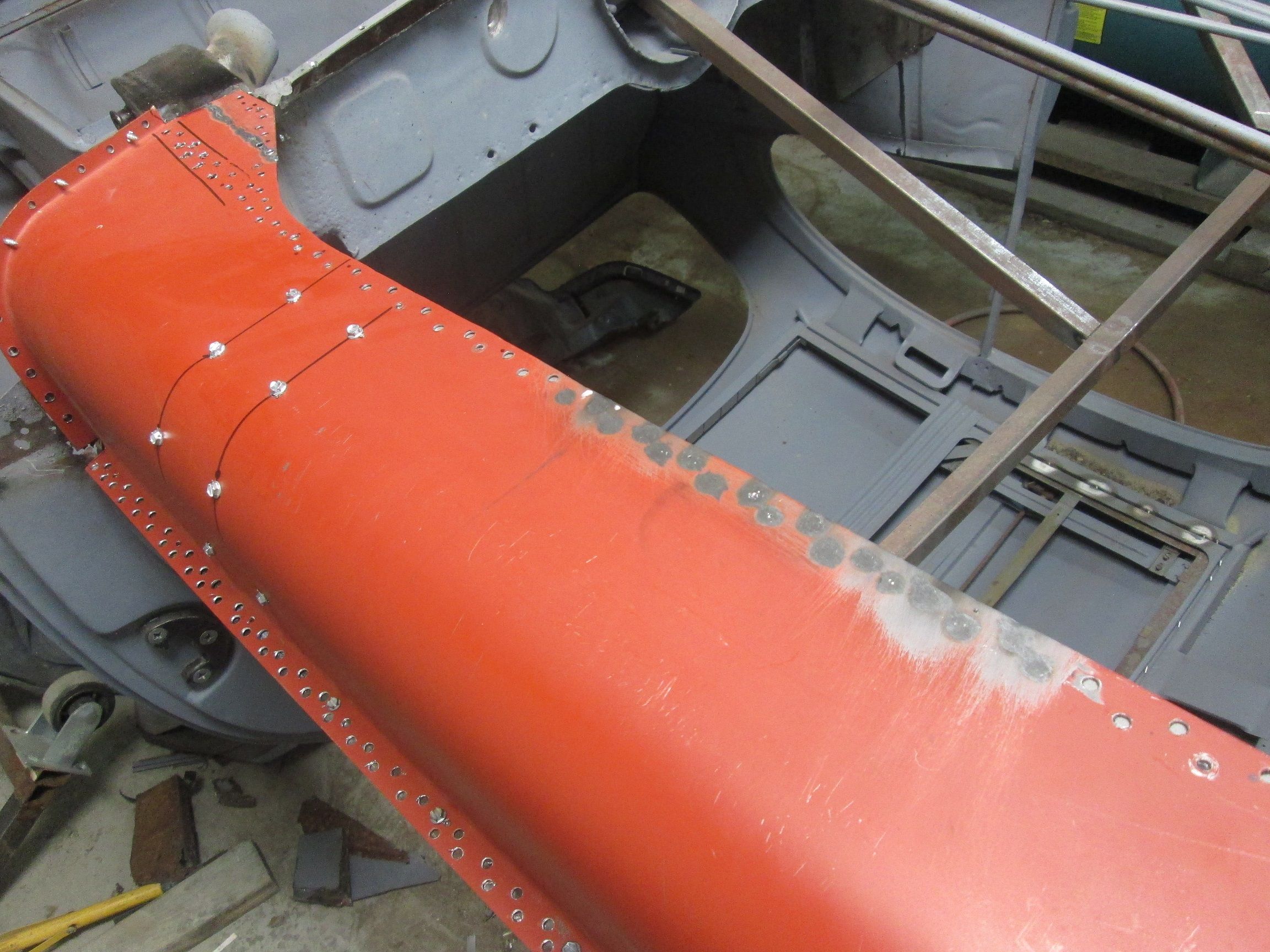

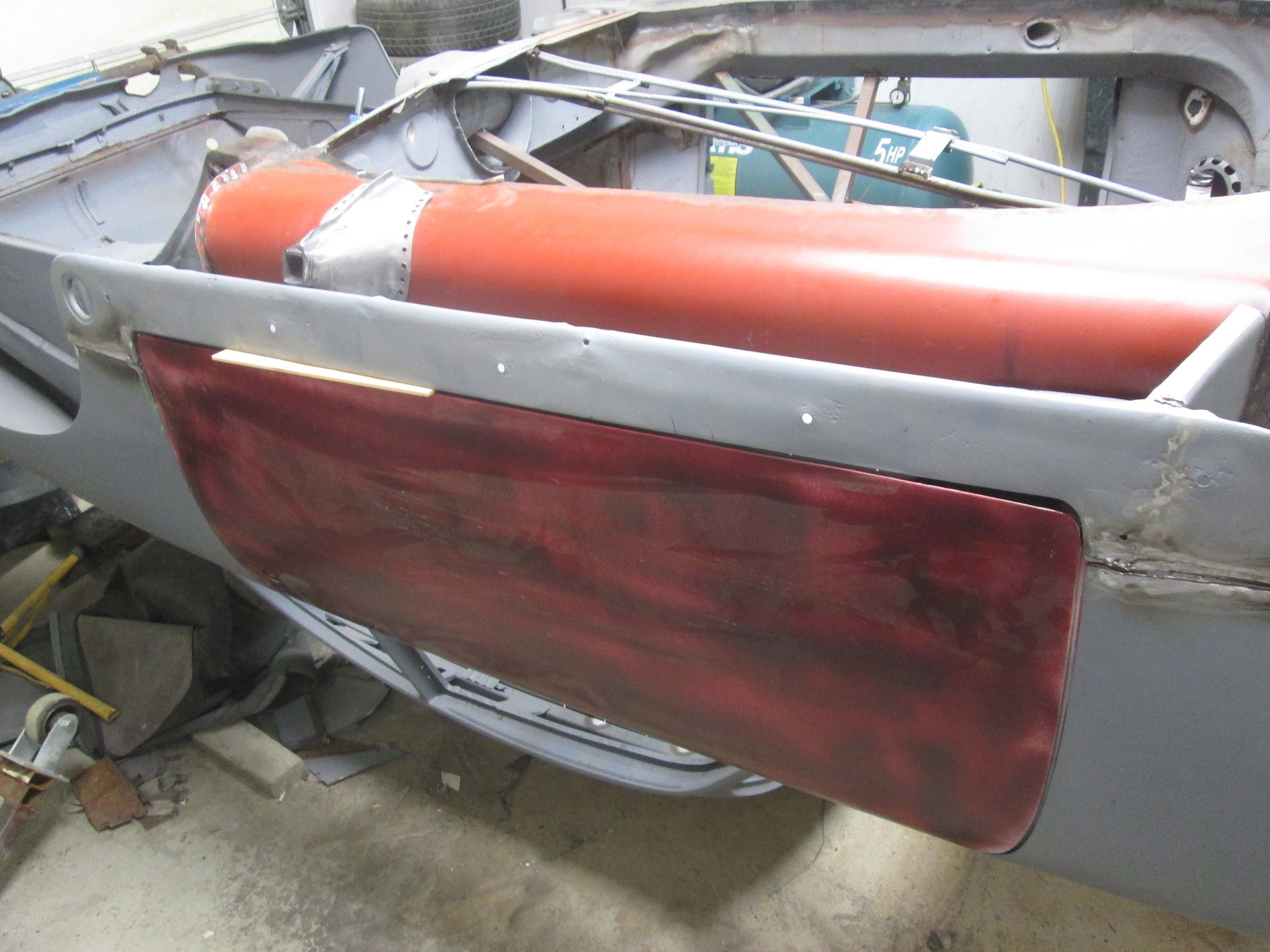

      • Prepping the cap for final installation:
ID:	111601 Just before the door well tray was tacked in for good. Trimming around the edge to get both it and the new cap to mate up.
ID:	111602 Once they fit together then it was onto set screwing the cap into its final position.
ID:	111603 Begin laying down the screws working from the center outward.
ID:	111604 I'll etch in the final trim line to the leading edge to remove the excess and will also have to add back in were it came up short at the back corner.
ID:	111605 Removing the cap one last time to trim and punch in the plug weld holes then paint and seal the inner cavity. A little prep work to go but getting very close to capping this area for the final time.

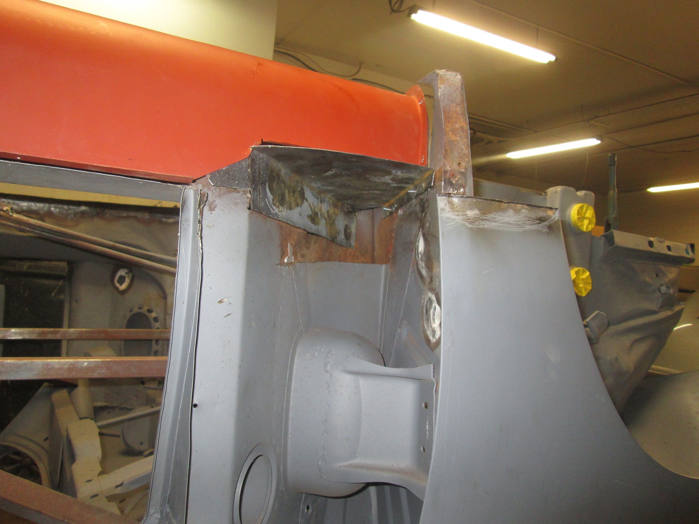

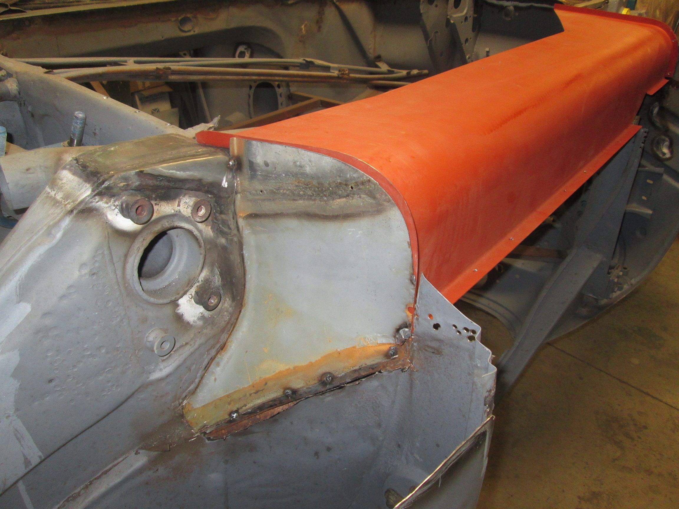

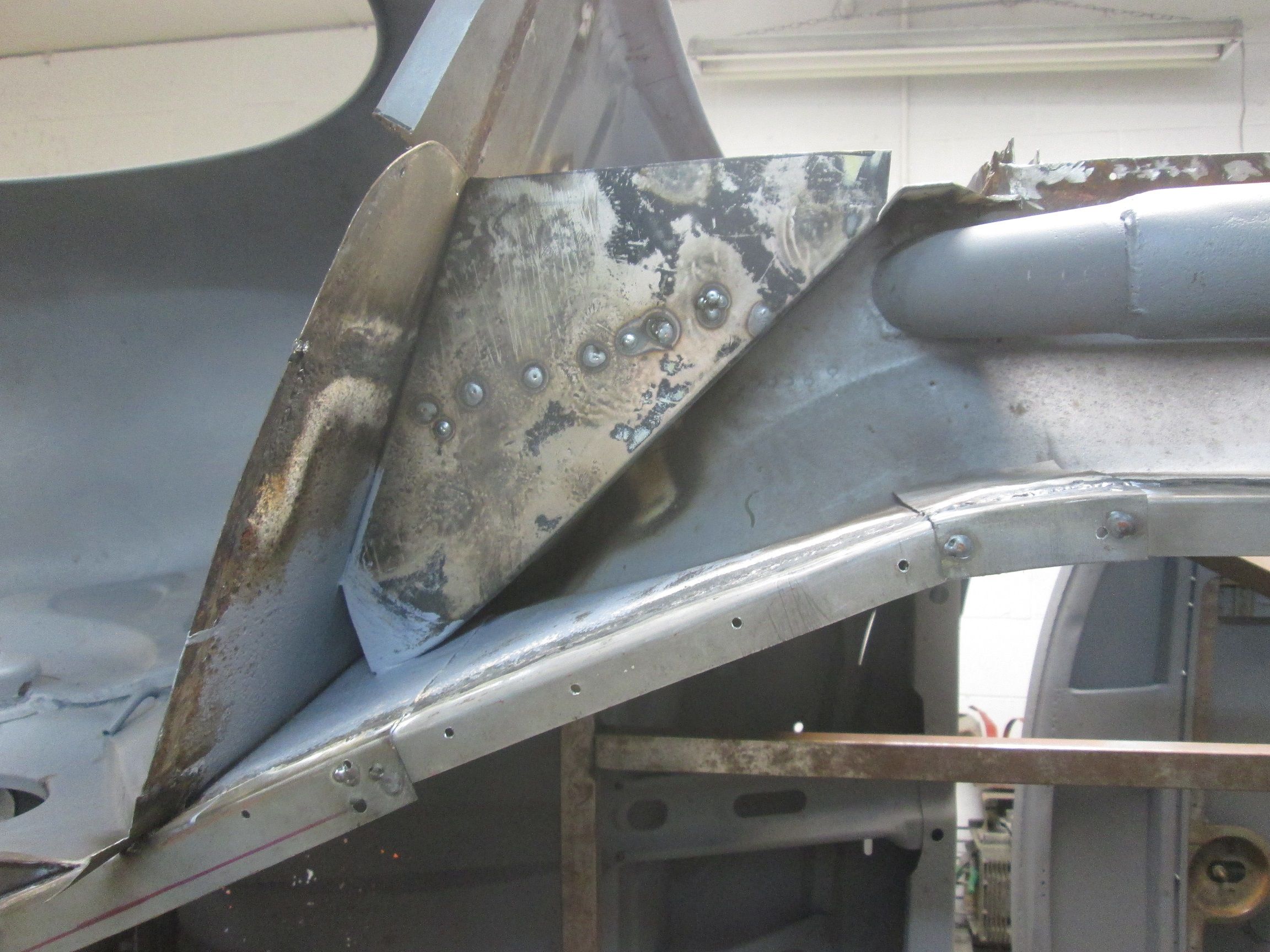

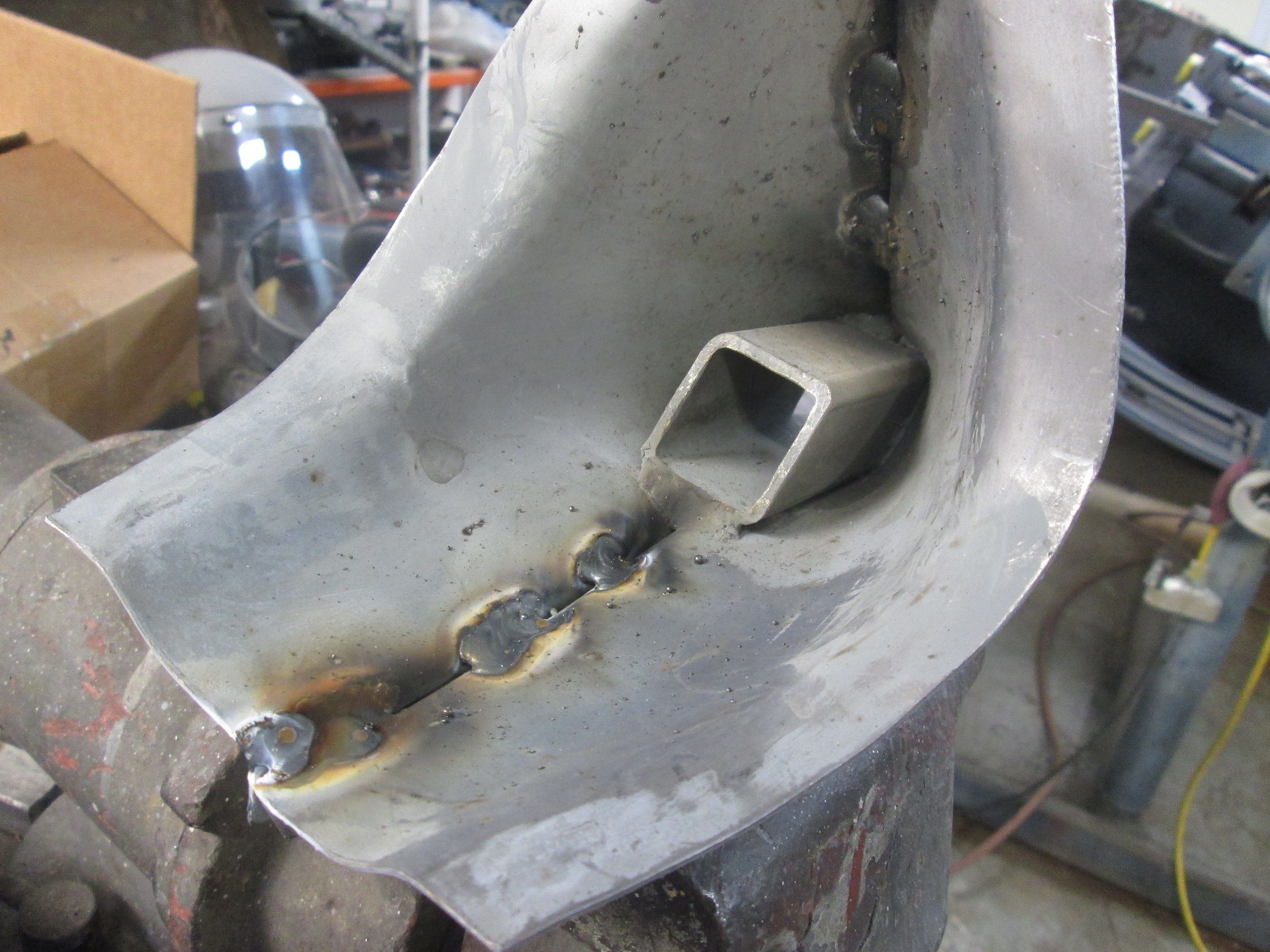

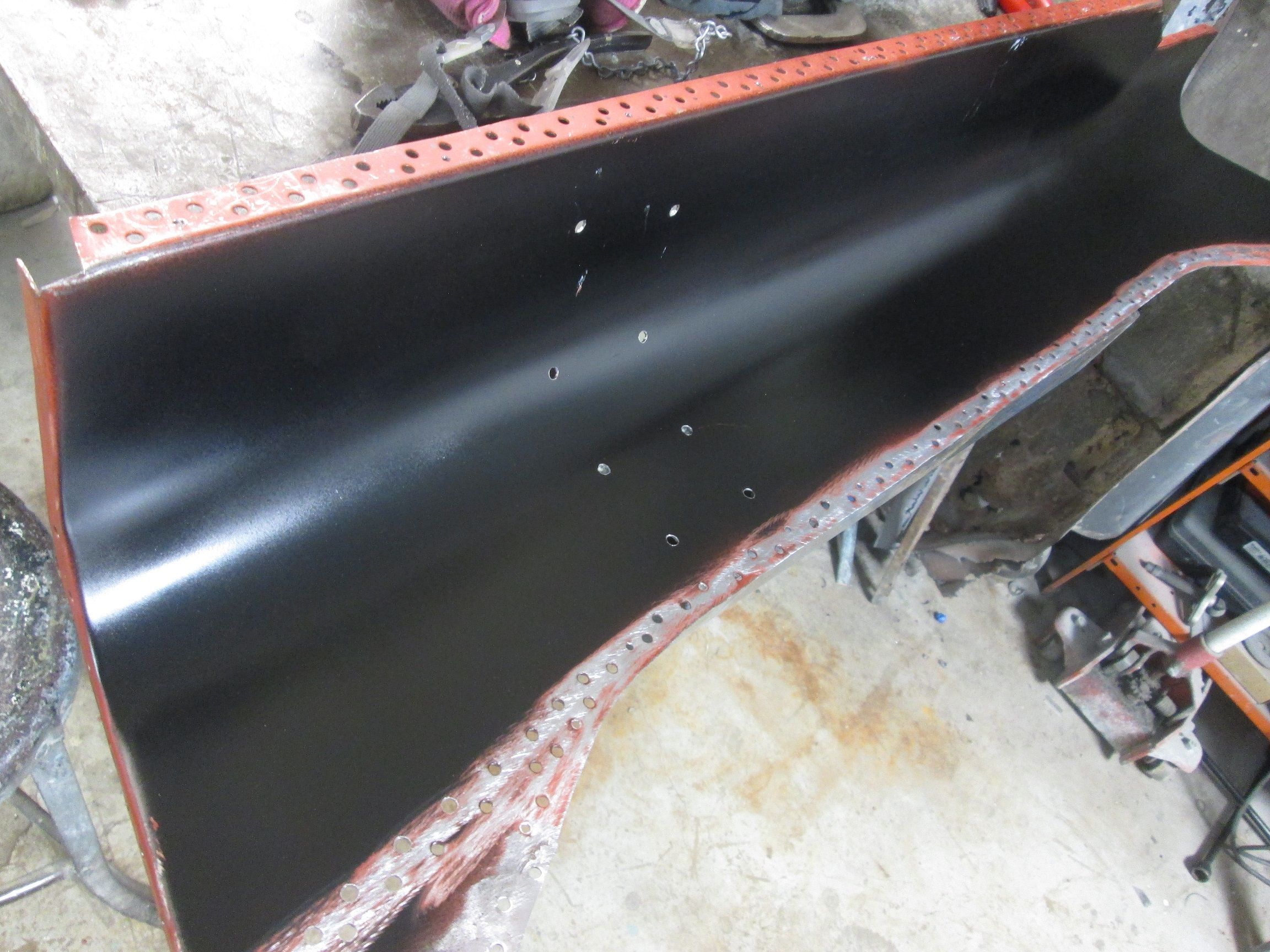

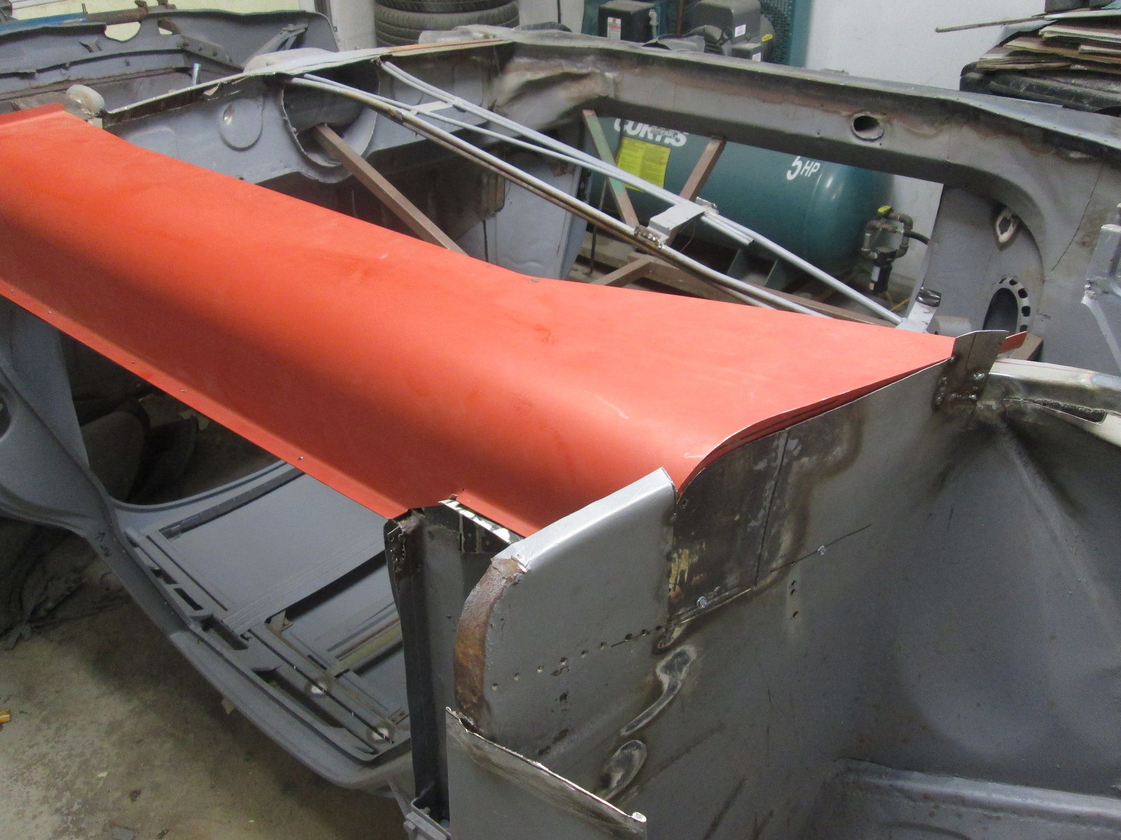

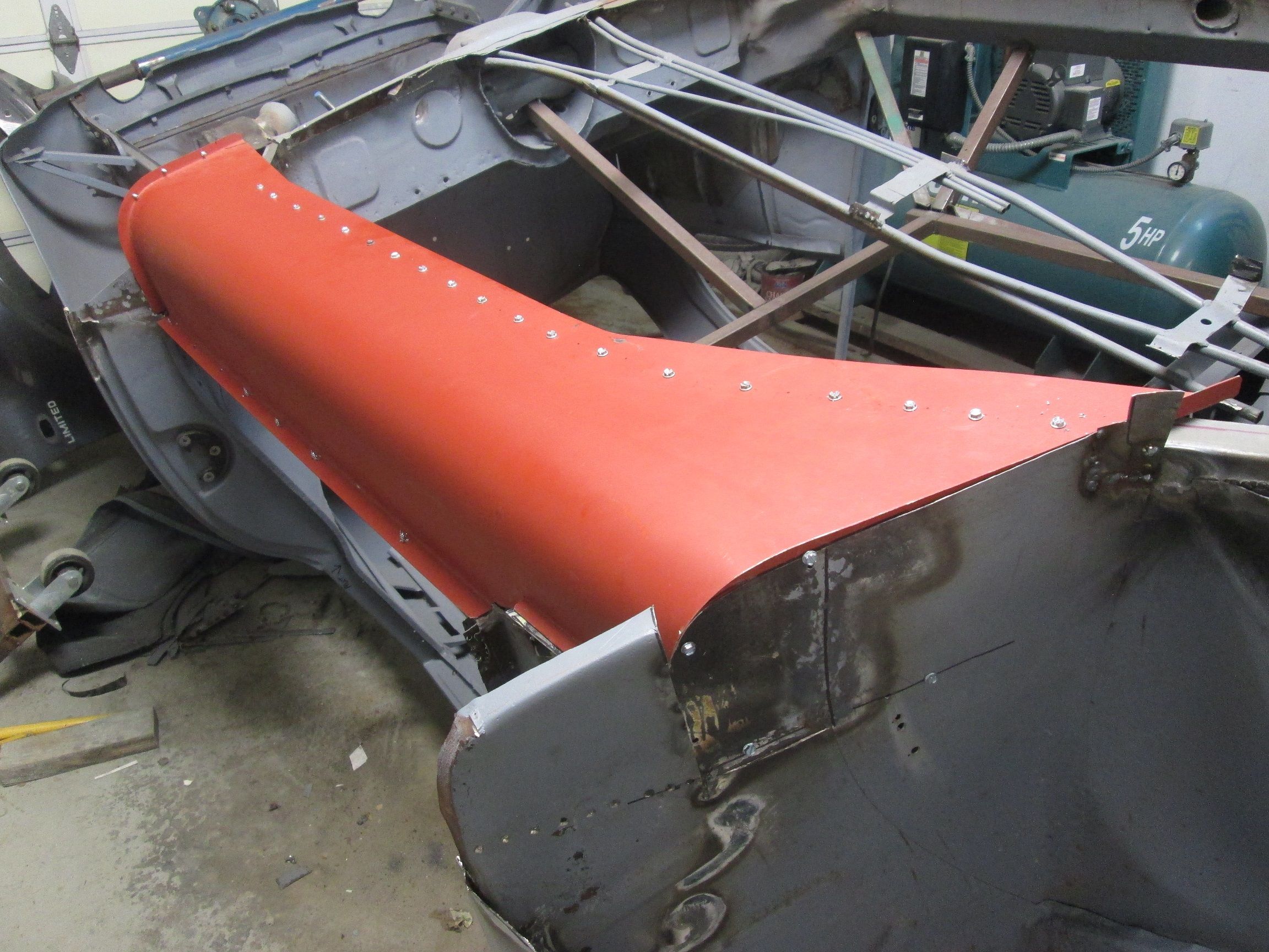

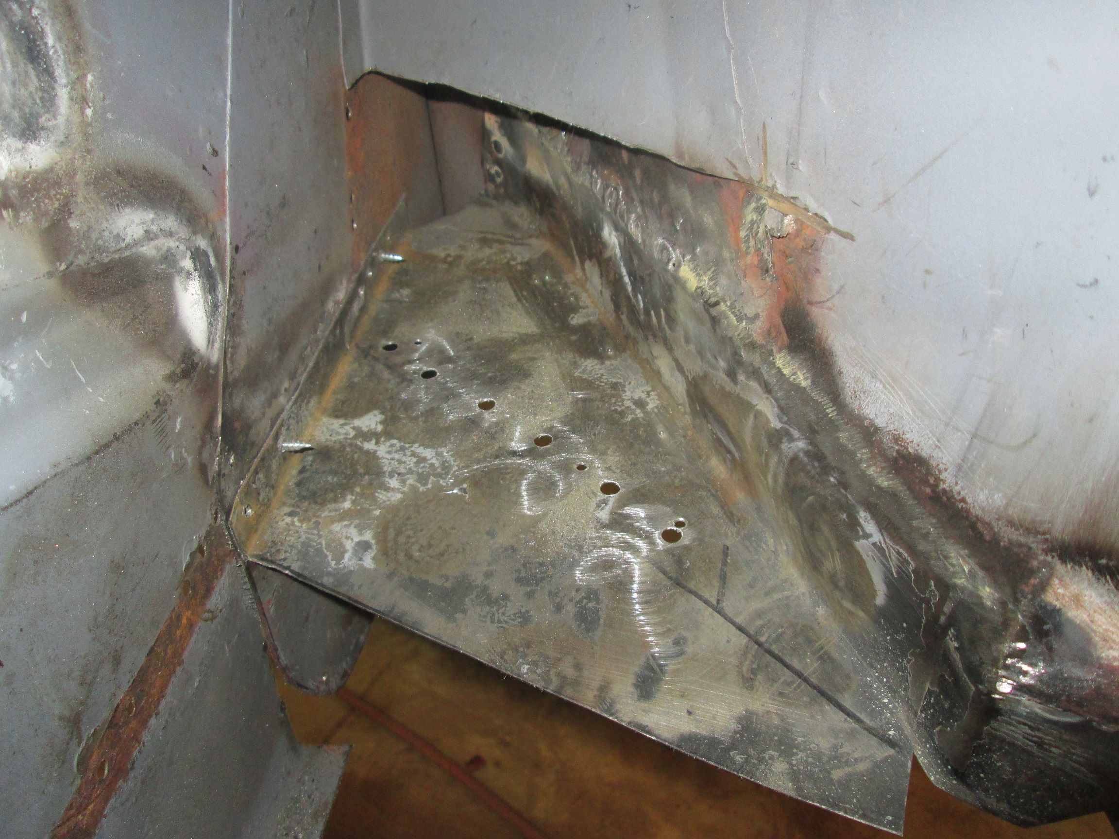

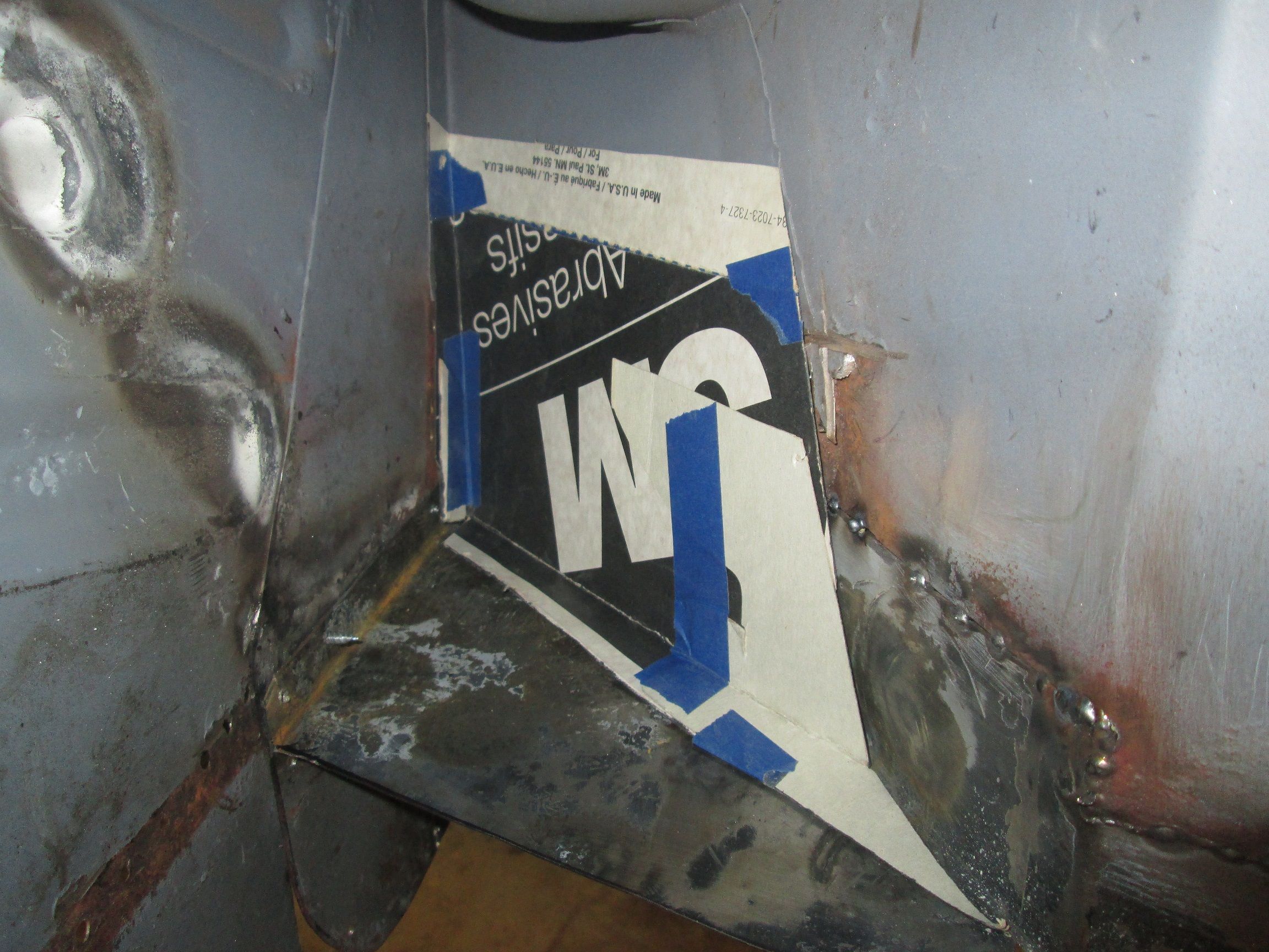

        • Before the cap goes on I had to get the outer door well wall installed first.
          Click image for larger version  Name:	IMG_7775.JPG Views:	0 Size:	547.6 KB ID:	111613 Paper template from previous project.
          Click image for larger version  Name:	IMG_7776.JPG Views:	0 Size:	607.7 KB ID:	111614 Basic part in steel. Final trimming and set screwing next.
          Click image for larger version  Name:	IMG_7784.JPG Views:	0 Size:	599.8 KB ID:	111615 Finished out the seam along the new pan. Presentation not as clean as I'd like it to be but access is very limited down in there. Looks aside it's more important that its securely welded which it seems to be.
          Click image for larger version  Name:	IMG_7786.JPG Views:	0 Size:	568.5 KB ID:	111616 New closing section set screwed into its best adjusted position.
          Click image for larger version  Name:	IMG_7787.JPG Views:	0 Size:	534.8 KB ID:	111617 Next will be adding in the plug weld holes along the bottom to attach the walls flange. I couldn't close this longitudinal up until this welding is complete. In the old days I plug welded from the top side but the area is so tight that I couldn't dress the heads of welds thoroughly. This approach solves that issue.

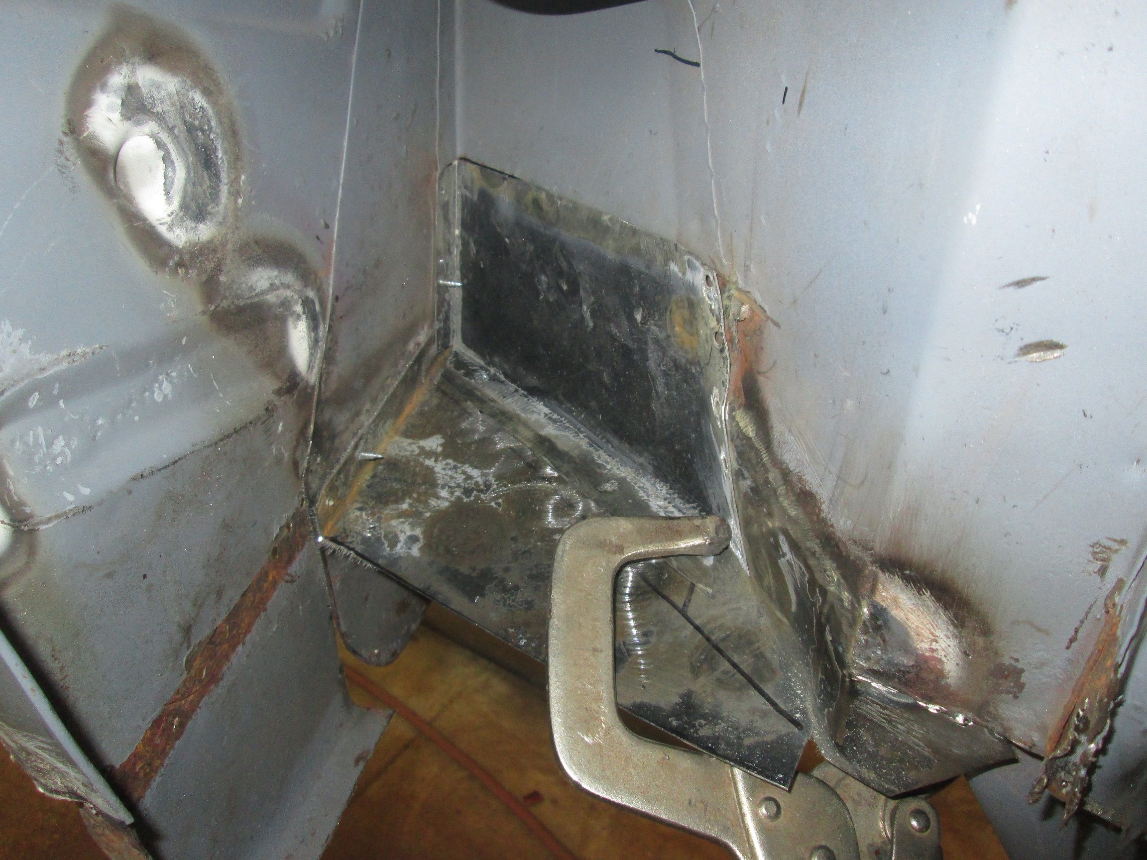

          • Part 2:
ID:	111619 Same with the vertical flange runs... Click image for larger version
ID:	111620 They all get plug welded from the outside for clear access. This makes final presentation so much cleaner down in the door well and makes my job of cleaning up the weld heads so much more pleasant.
ID:	111621 Final trimming and fitment of the new lower wall section.
ID:	111622 Area drilled and all prepped for the walls final install.
ID:	111623 Just had to apply some epoxy to seal out this corner before I close it up. Installing the wall next.

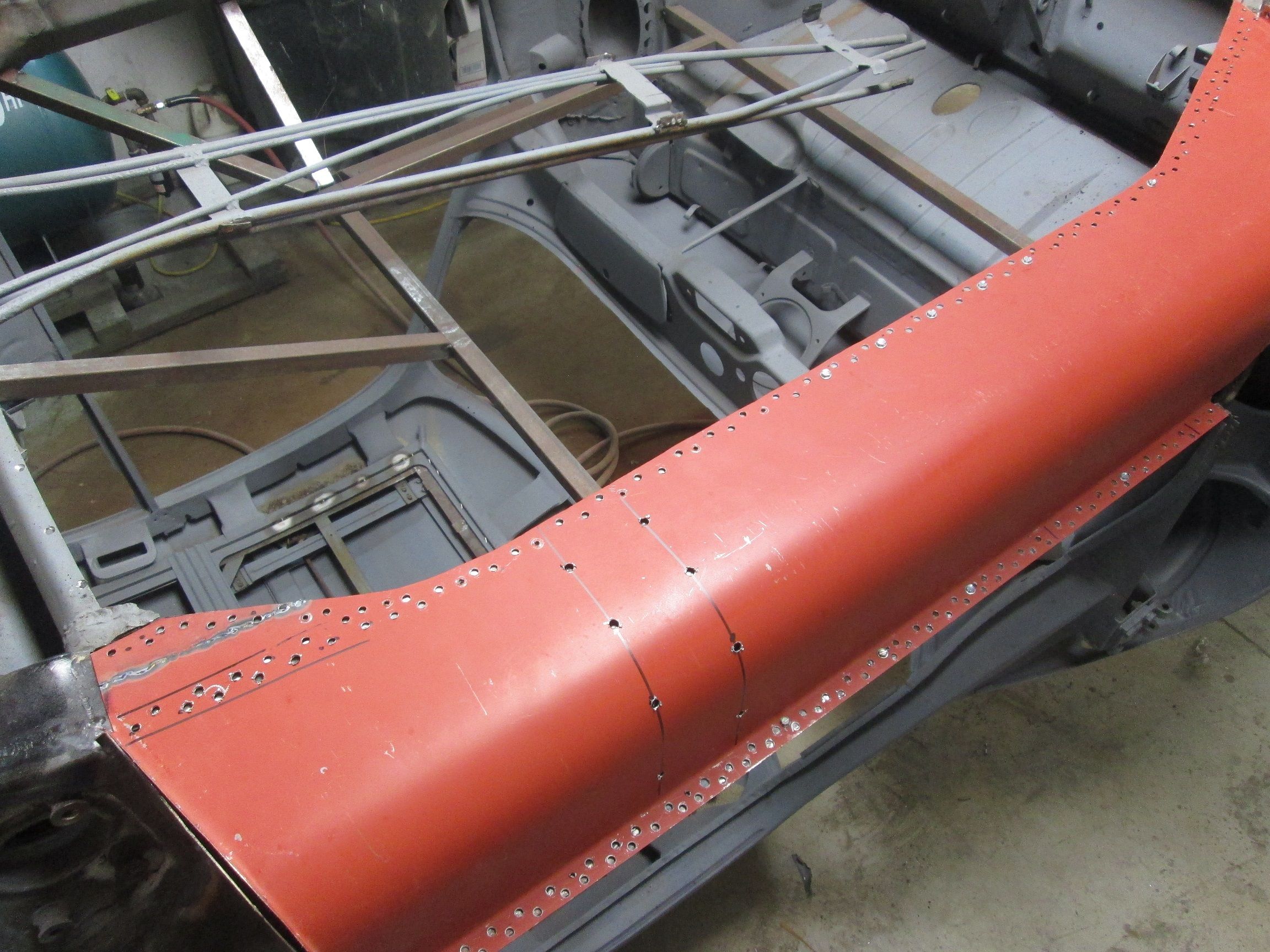

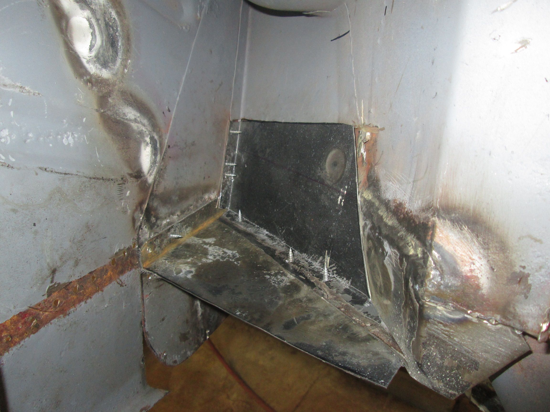

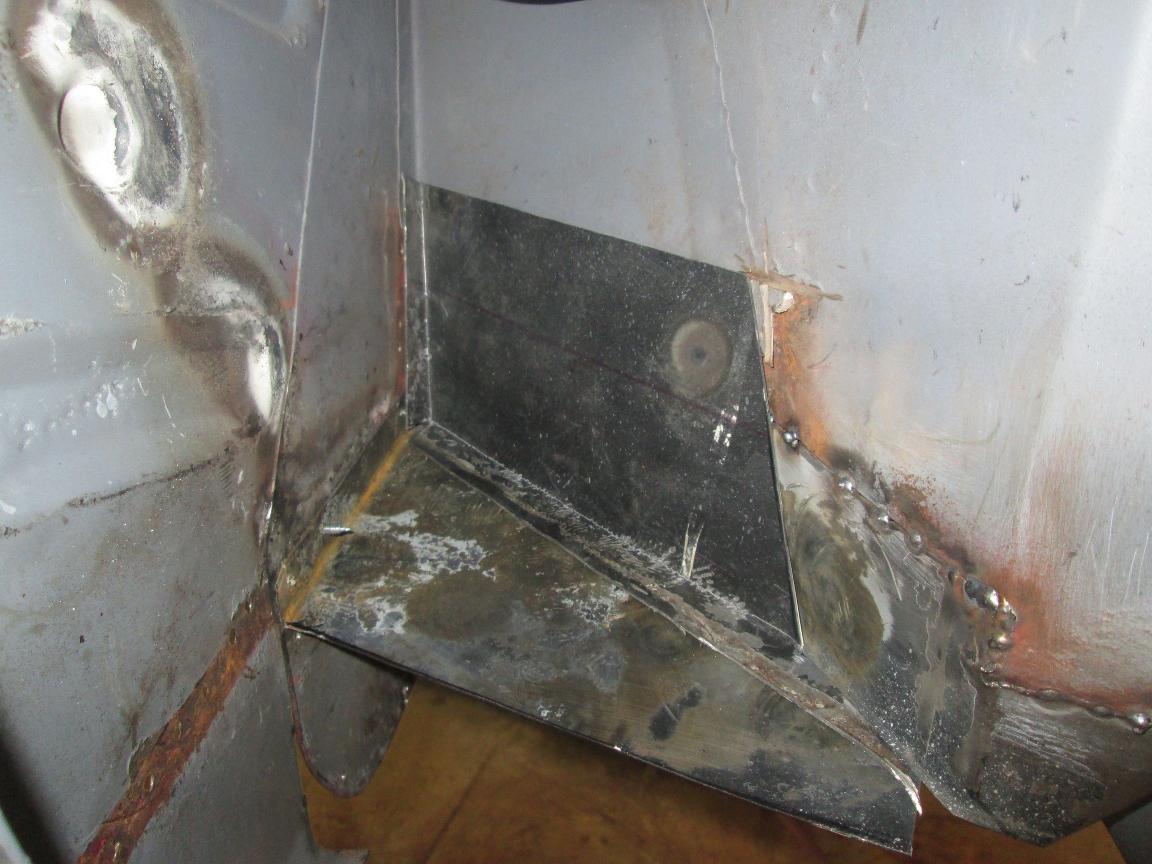

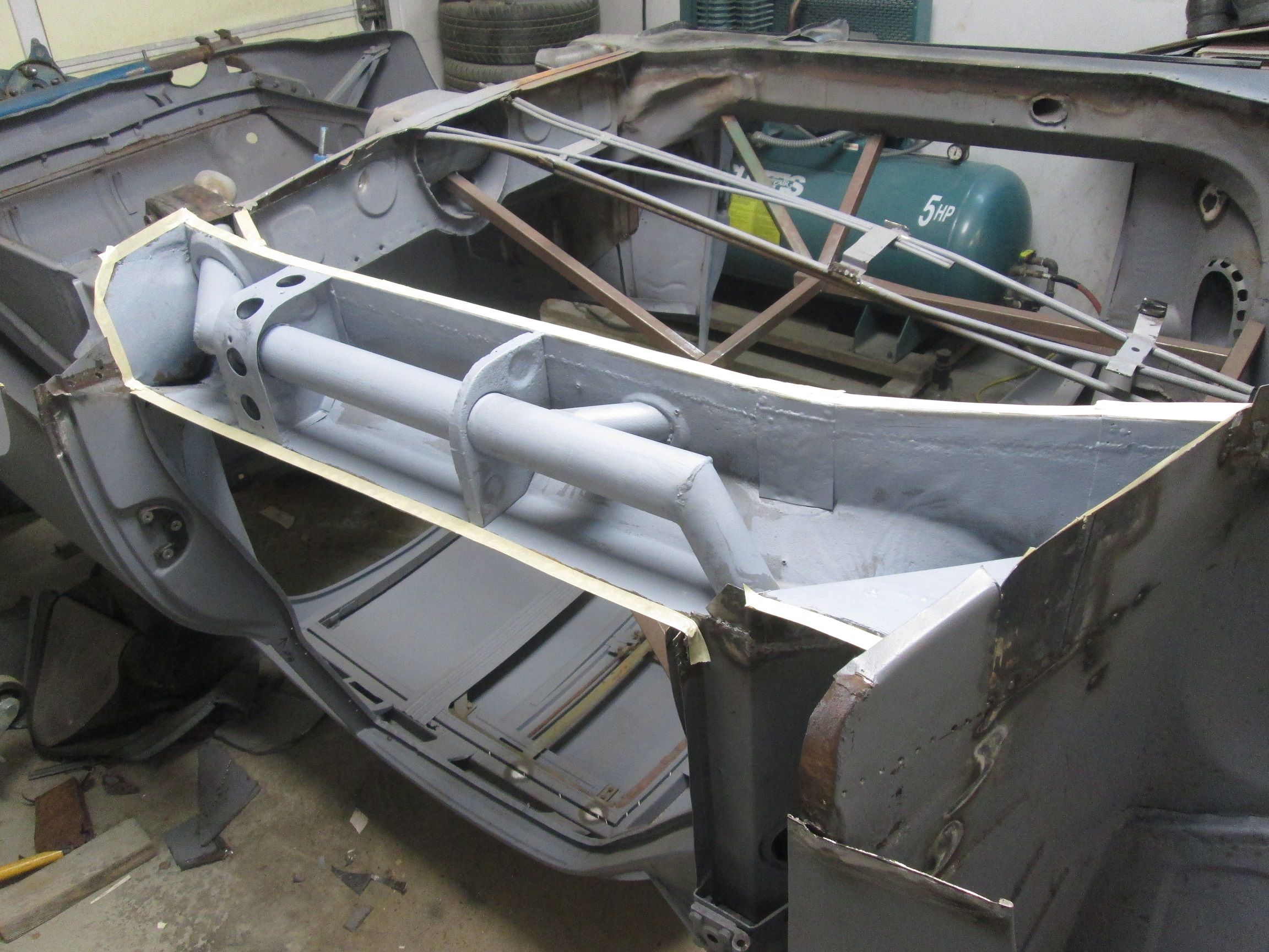

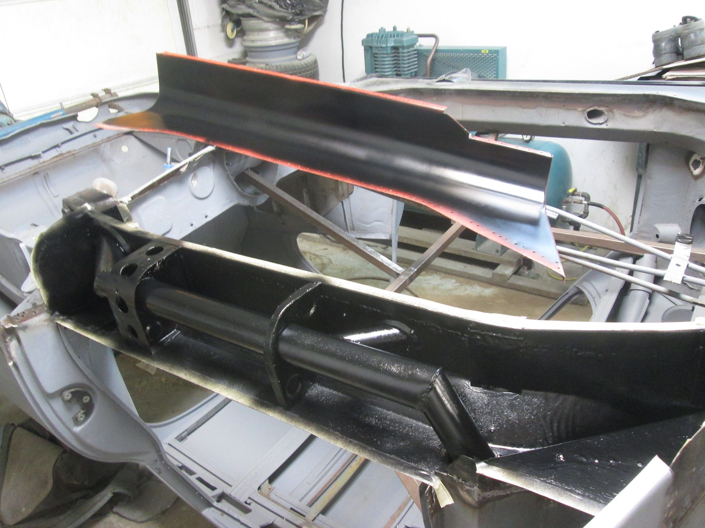

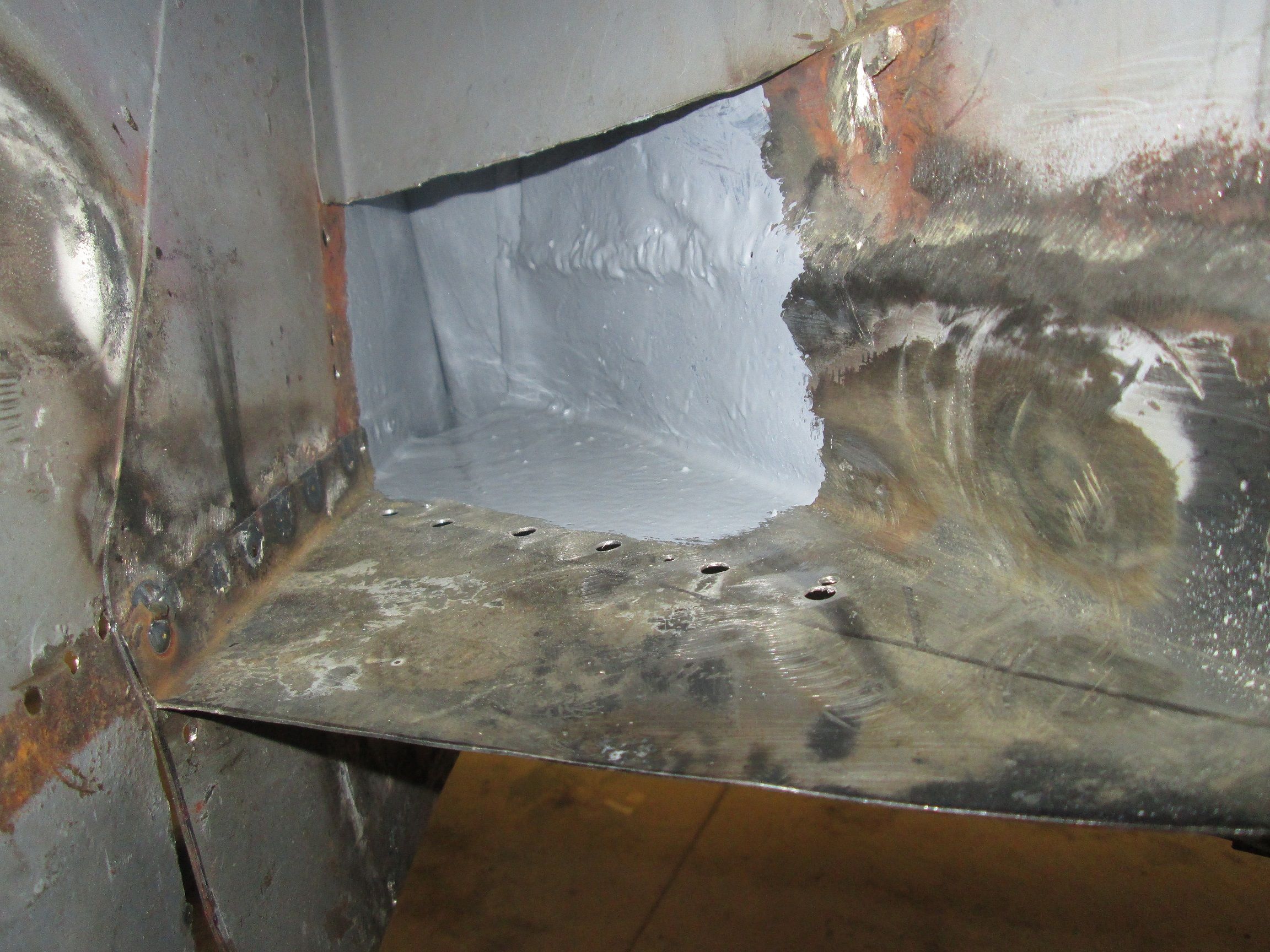

            • Closing time:
ID:	111625 Plug welding of the lower inner door well flange wall finished.
ID:	111626 This completes all the internal repairs to the left longitudinal cavity. All ready to clean and prep it for epoxy and a final coat of paint.
ID:	111627 Epoxy coat nearly finished with the welding surfaces back masked.
ID:	111628 A small section added to the back of the closing panel where it was short. Then I can seal the inside surface.
ID:	111629 Inner cavity and surfaces in a final coat and now finally ready to close this up for good.

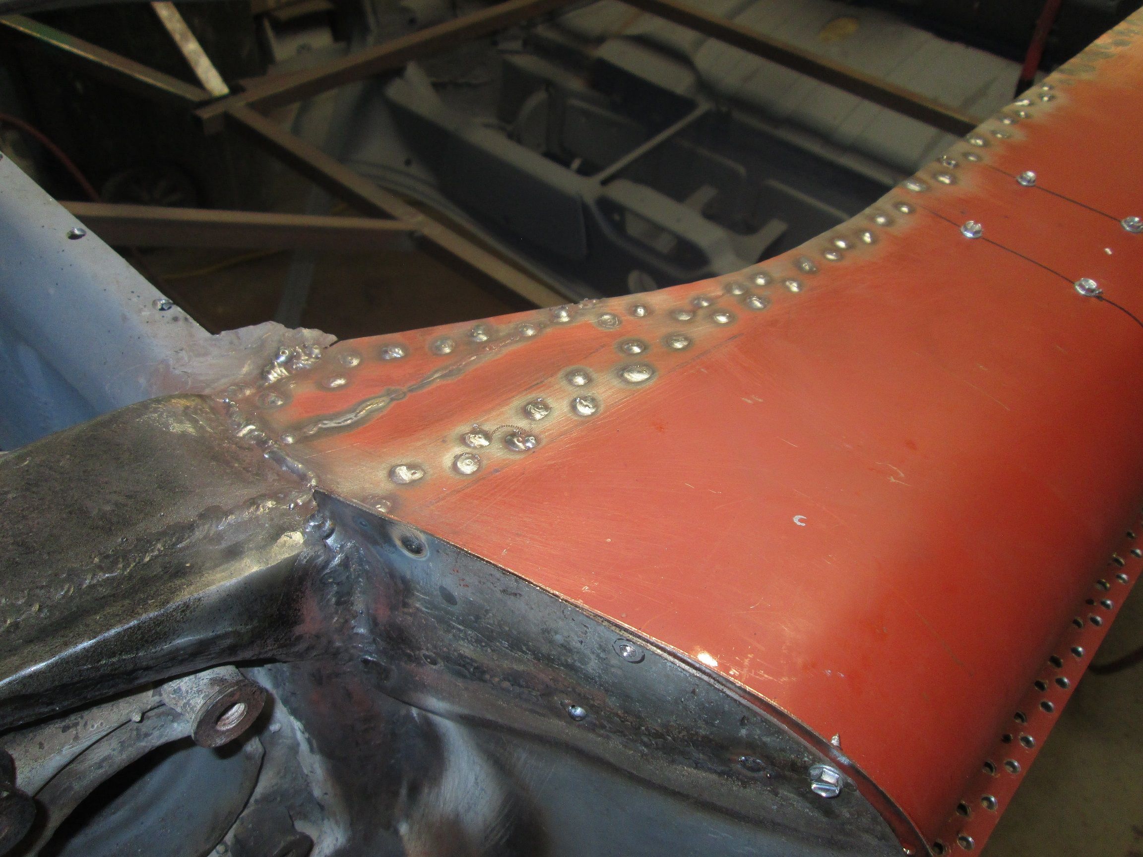

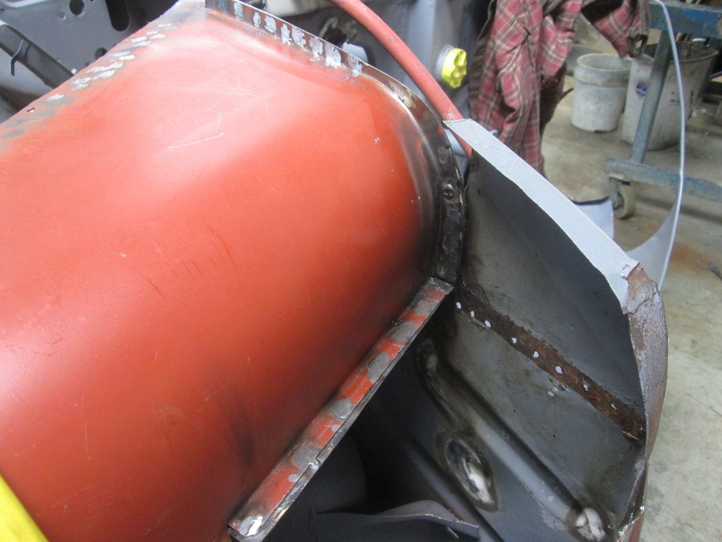

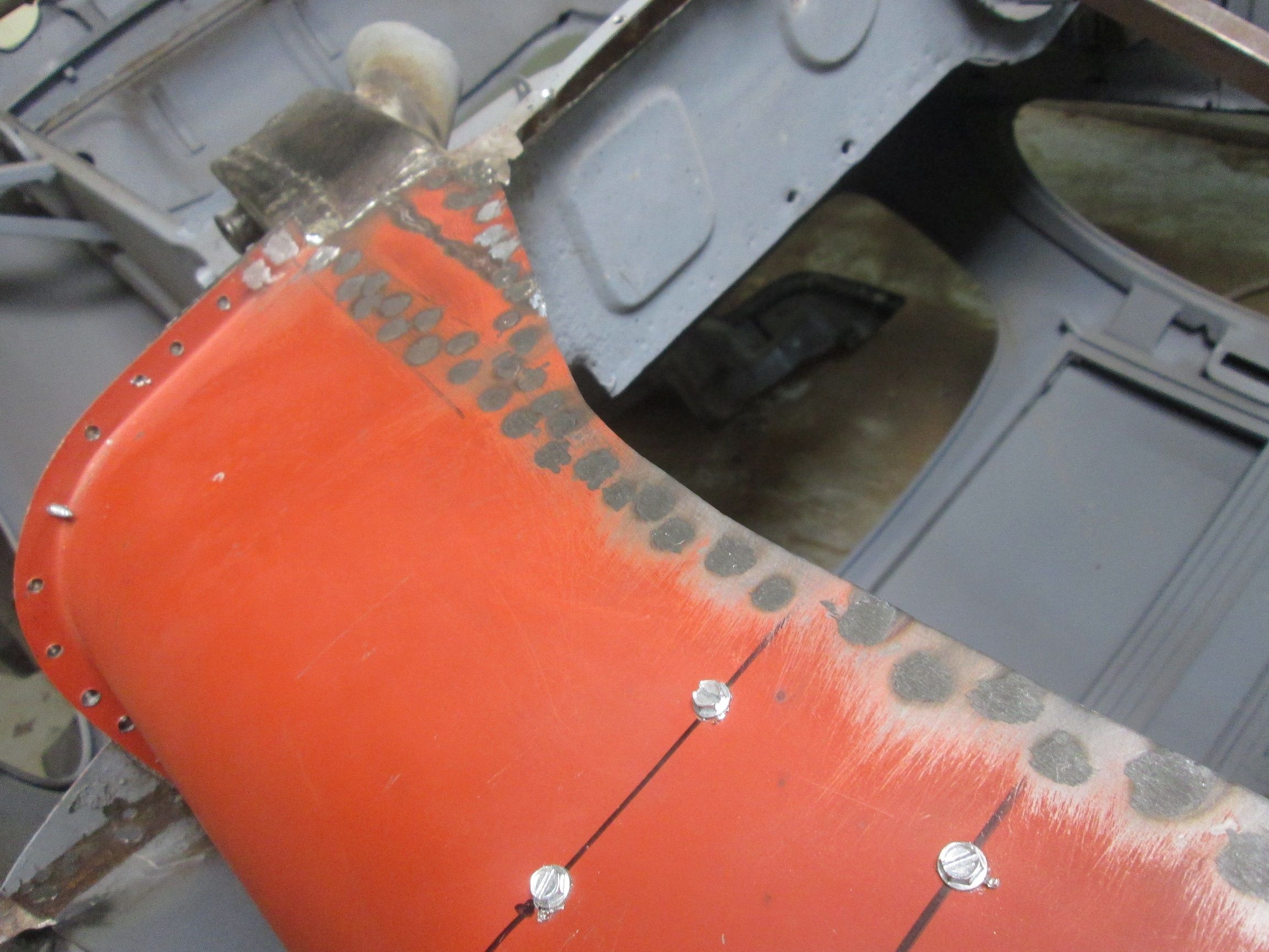

              • begin welding:
                Click image for larger version  Name:	IMG_7804.JPG Views:	0 Size:	546.2 KB ID:	111649 A few more holes to add before it went on.
                Click image for larger version  Name:	IMG_7805.JPG Views:	0 Size:	590.2 KB ID:	111650 Installed for the final time. A few holes to back fill.
                Click image for larger version  Name:	IMG_7806.JPG Views:	0 Size:	584.4 KB ID:	111651 Synched back down with screws.
                Click image for larger version  Name:	IMG_7807.JPG Views:	0 Size:	526.8 KB ID:	111652 Begin plug welding working from the center outward.
                Click image for larger version  Name:	IMG_7808.JPG Views:	0 Size:	551.9 KB ID:	111653 To break up the monotony I'll do a run of plugs and grind them flush before continuing on.

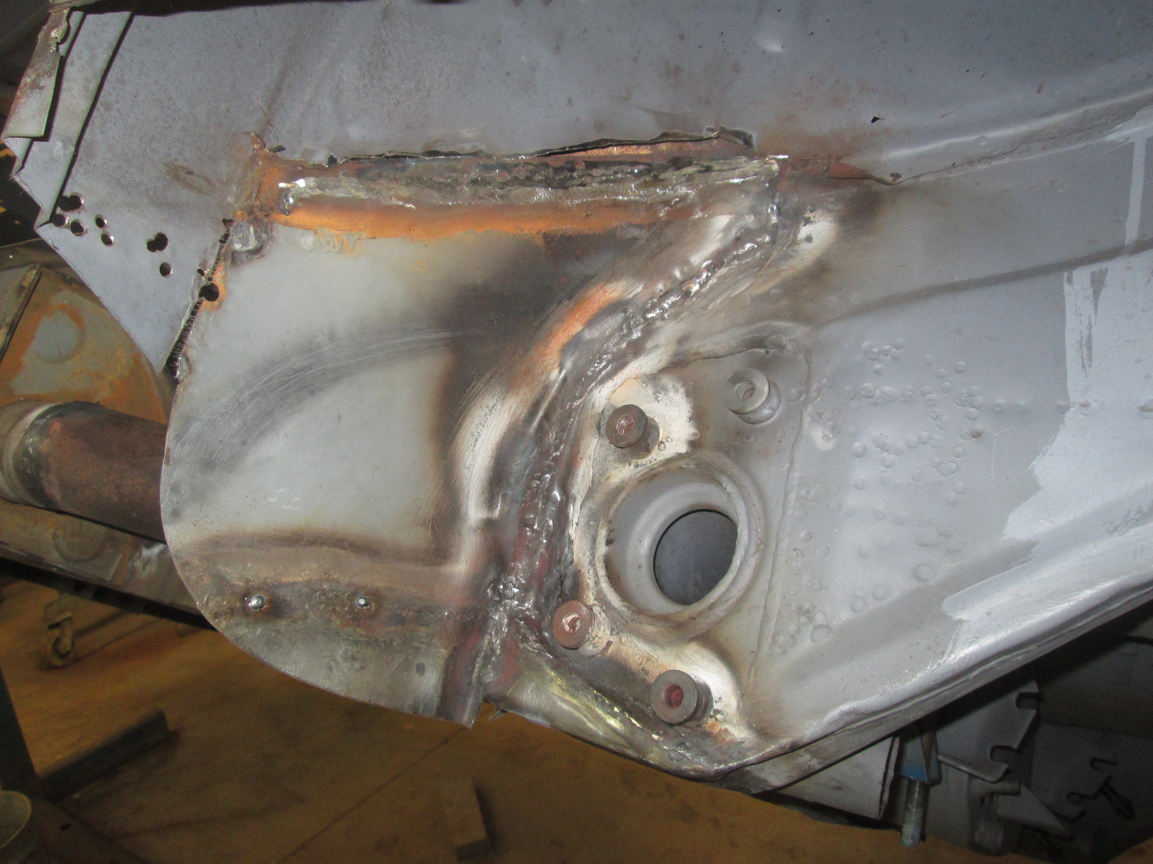

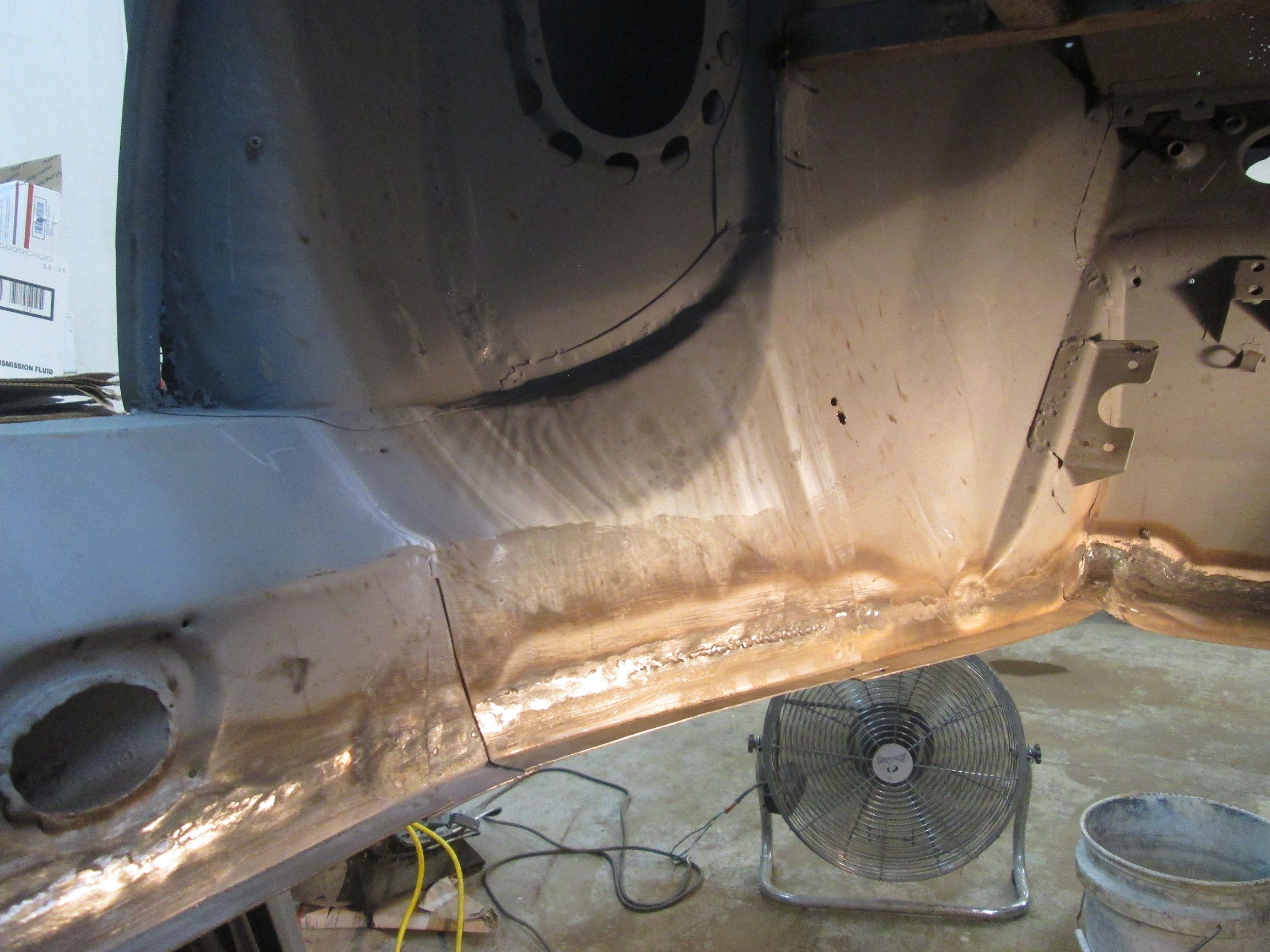

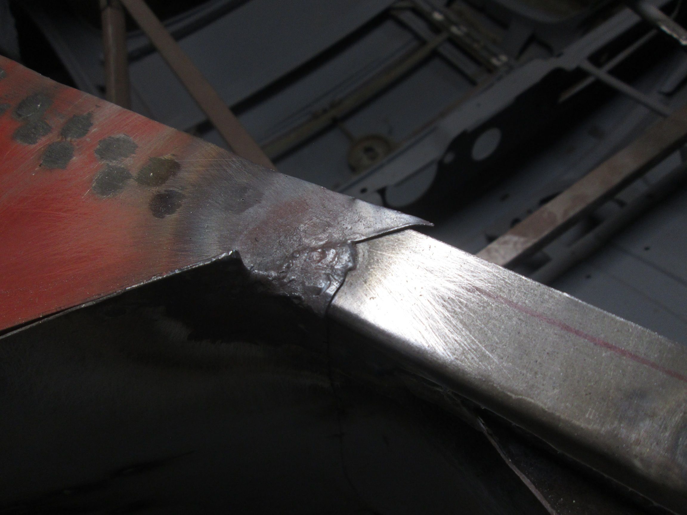

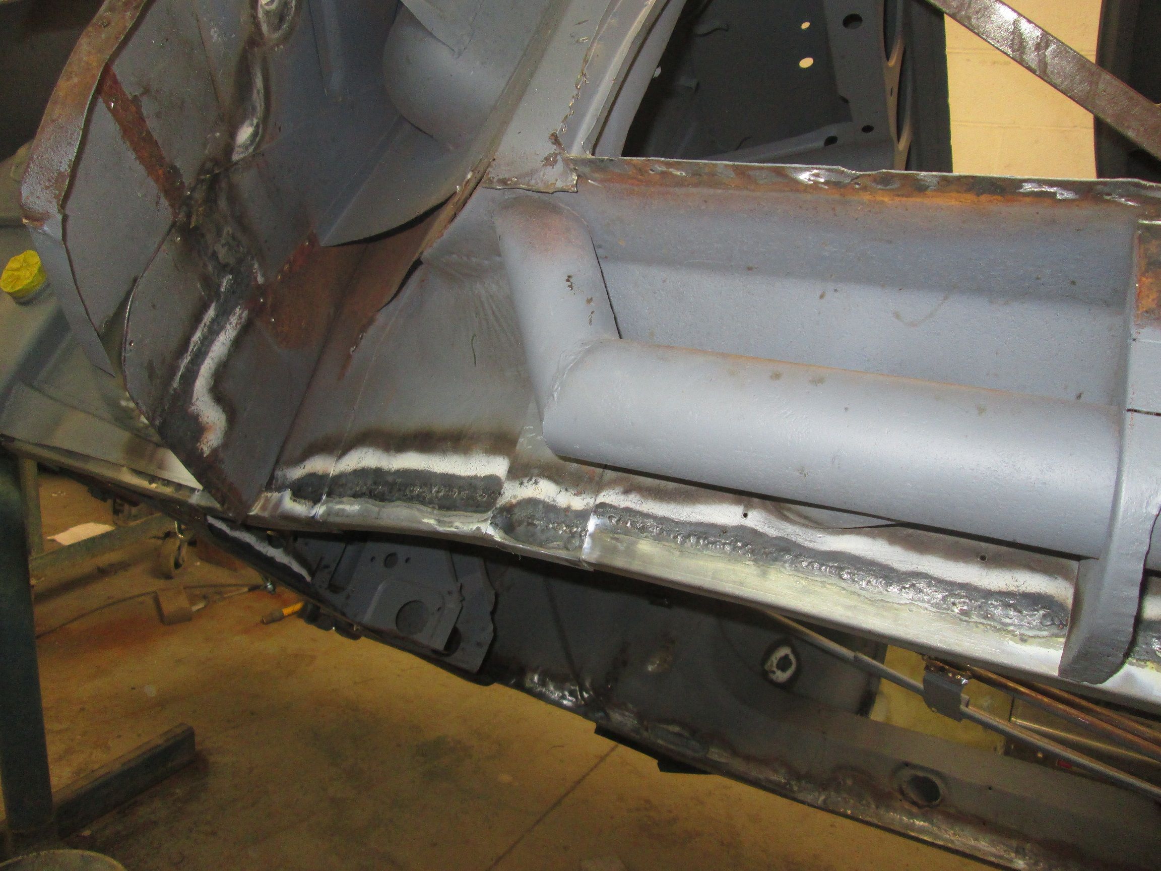

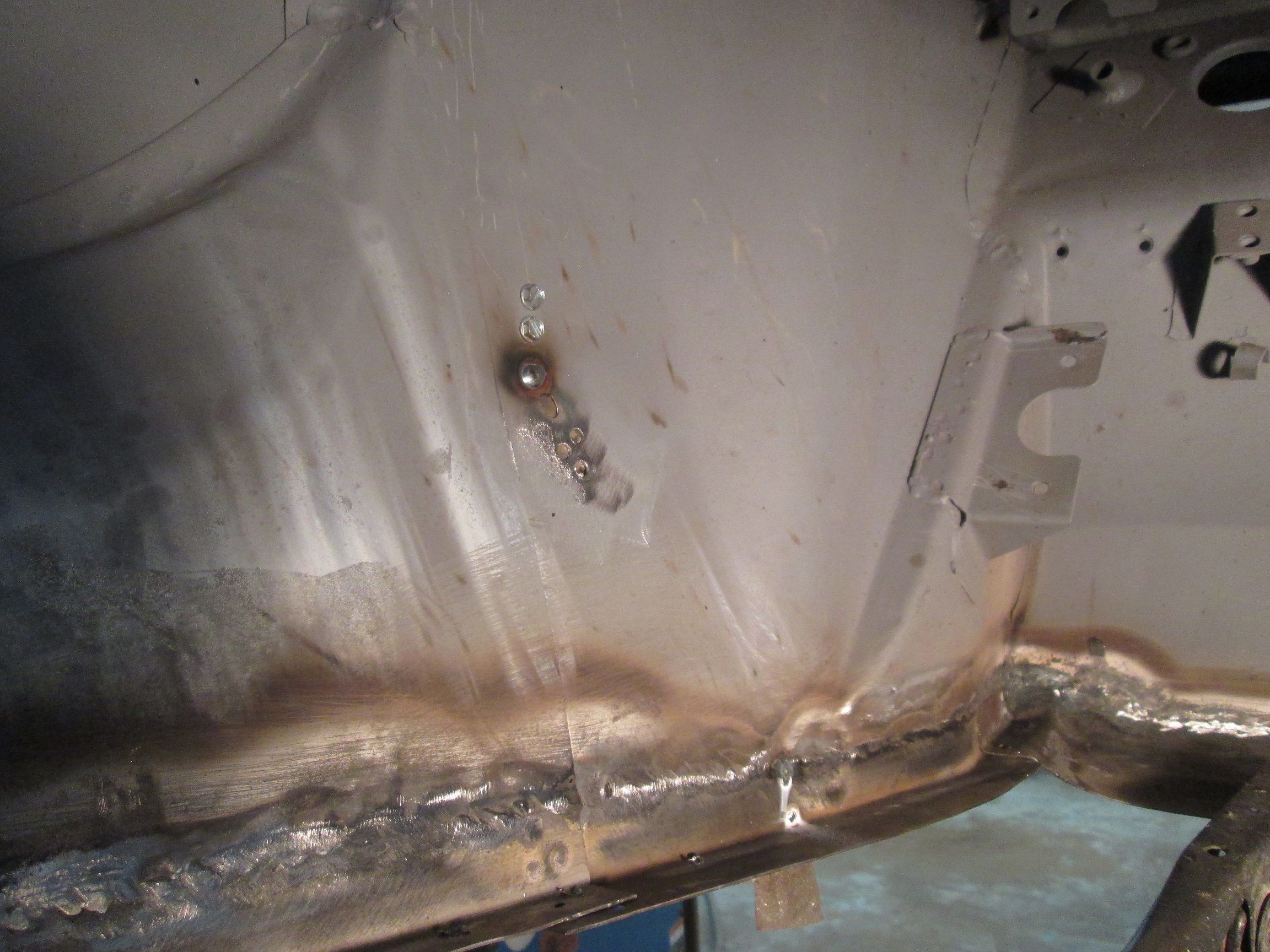

                • Plug welding along the bottom run complete.
ID:	111660 Rear plug weld run completed with initial seam weld along the back edge.
ID:	111661 tedious chore of weld leveling completed. Going over the rear seam weld with my torch to finish out the area.
ID:	111662 torch weld detail completed.
ID:	111663 Repeated the cycle to finish out the remaining forward run.
ID:	111664 Torch weld detail completed at the corner of the splash pan and longitudinal to replicate what was there originally. Moving down the sides and then onto the threshold plug weld run to finish this installation up.
                  Thanks for stopping by!

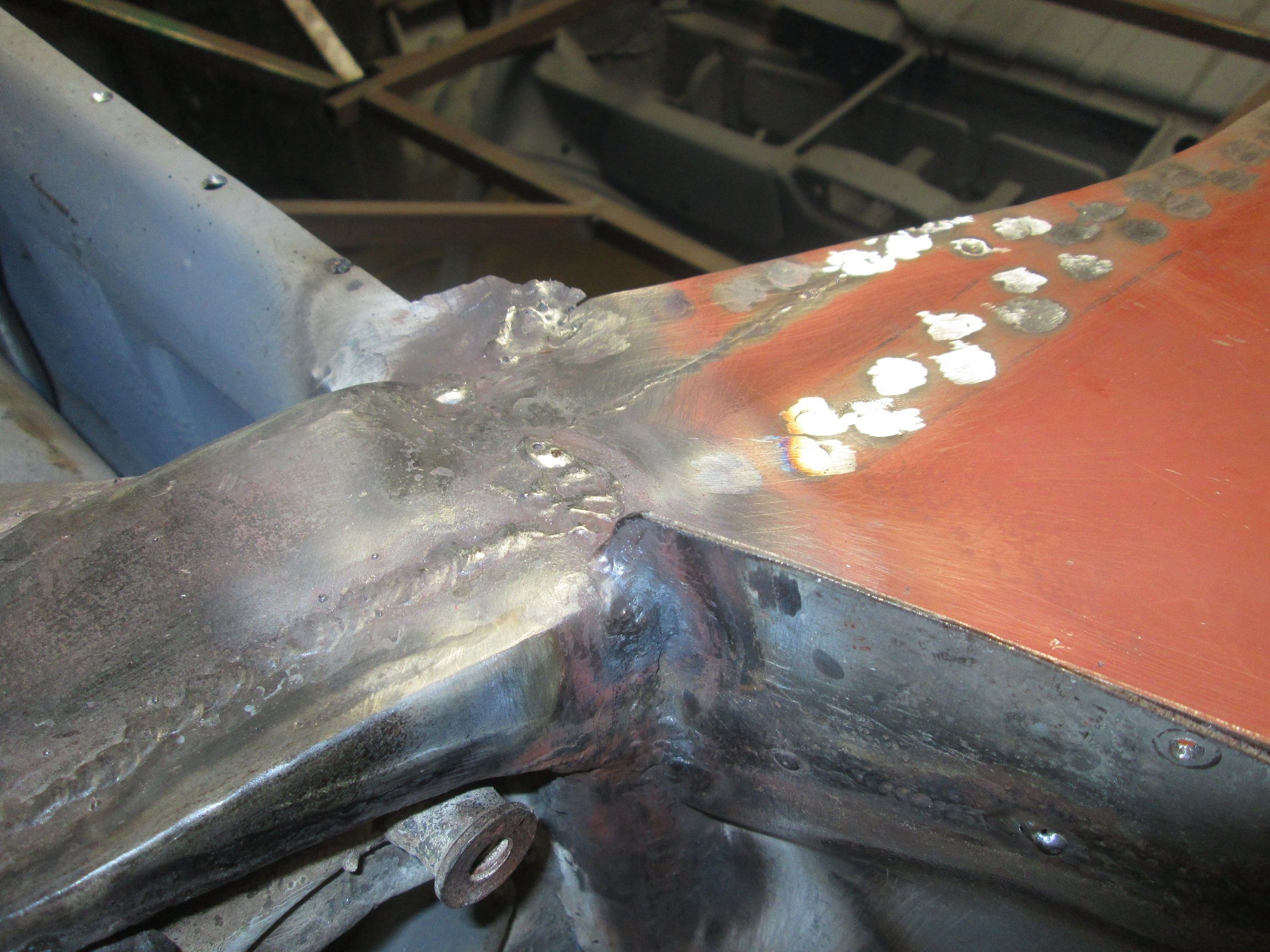

                  • Installation just about complete:
                    Click image for larger version  Name:	IMG_7827.JPG Views:	0 Size:	523.3 KB ID:	111673 Welding down the front and across the door well flange complete.
                    Click image for larger version  Name:	IMG_7823.JPG Views:	0 Size:	490.7 KB ID:	111674 Then it was down the backside.
                    Click image for larger version  Name:	IMG_7825.JPG Views:	0 Size:	539.9 KB ID:	111675 Plugs attaching to the bulkheads where next.
                    Click image for larger version  Name:	IMG_7826.JPG Views:	0 Size:	482.9 KB ID:	111676 Only the threshold run now remains. Began the plugs working from the center outward.
                    Click image for larger version  Name:	IMG_7821.JPG Views:	0 Size:	532.0 KB ID:	111677 Just about ready to install the jack spur so I'll begin detailing the snout and center flange to replicate how the originals came. This detail performed to this right side spur a while back.

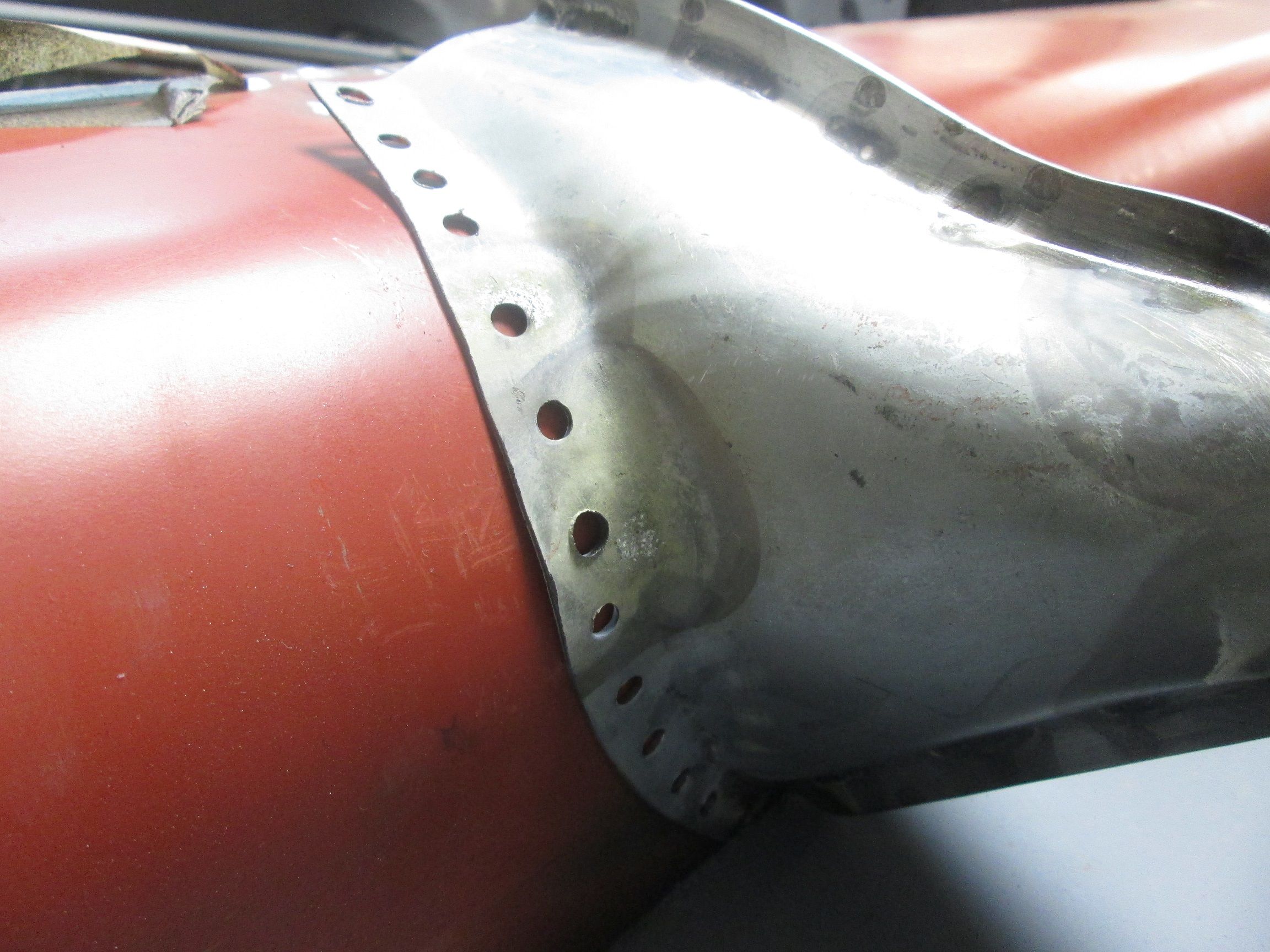

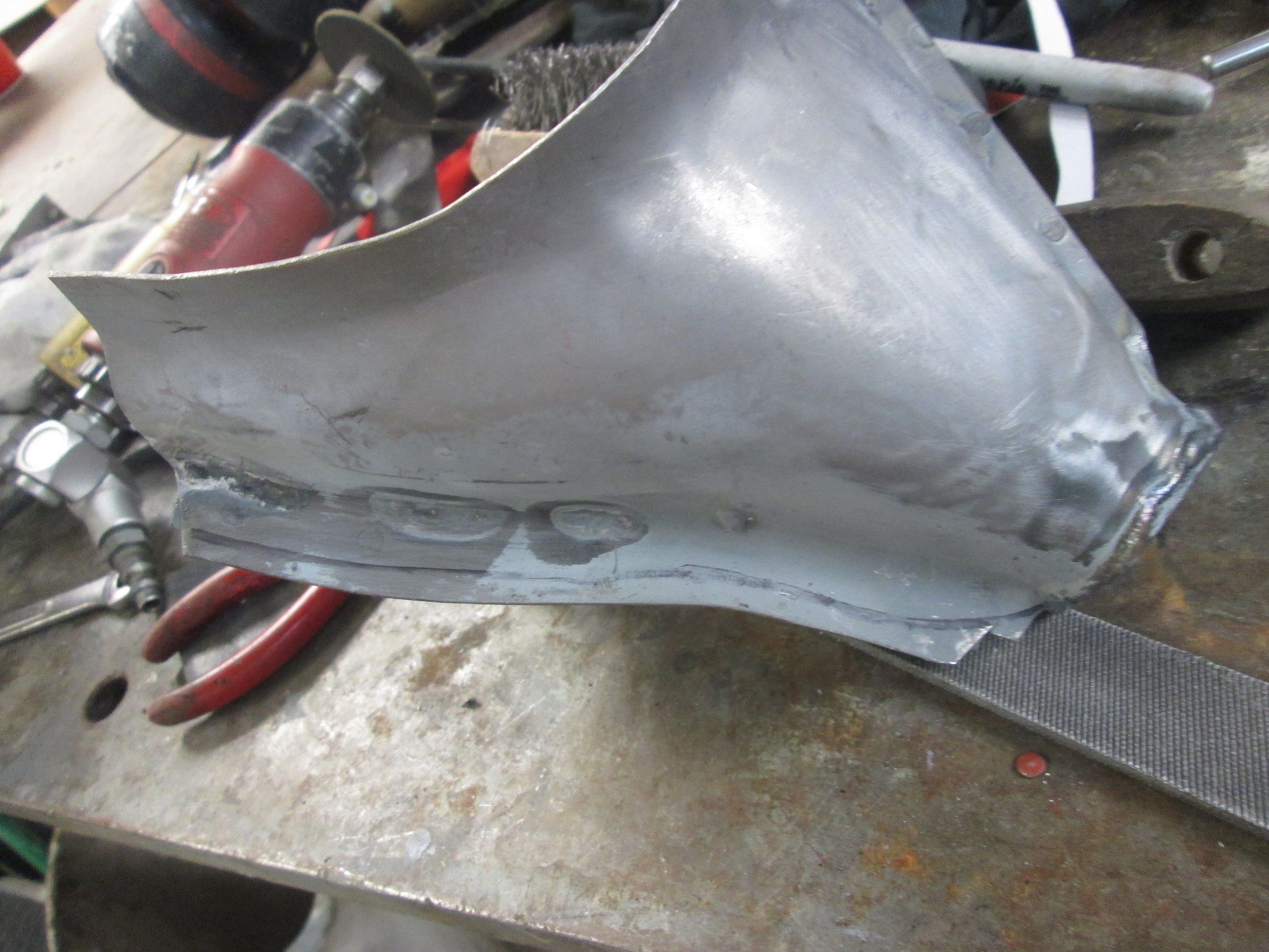

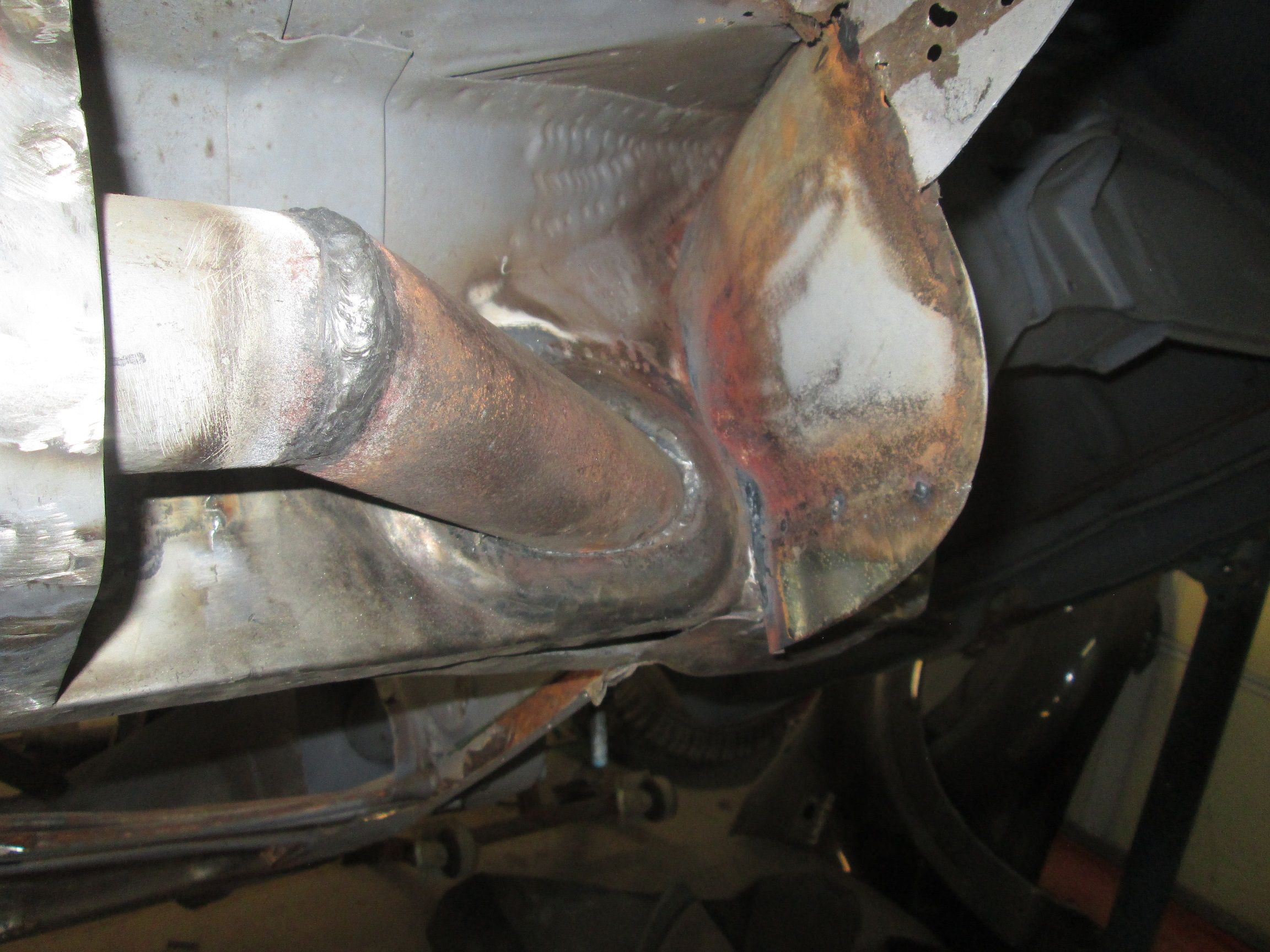

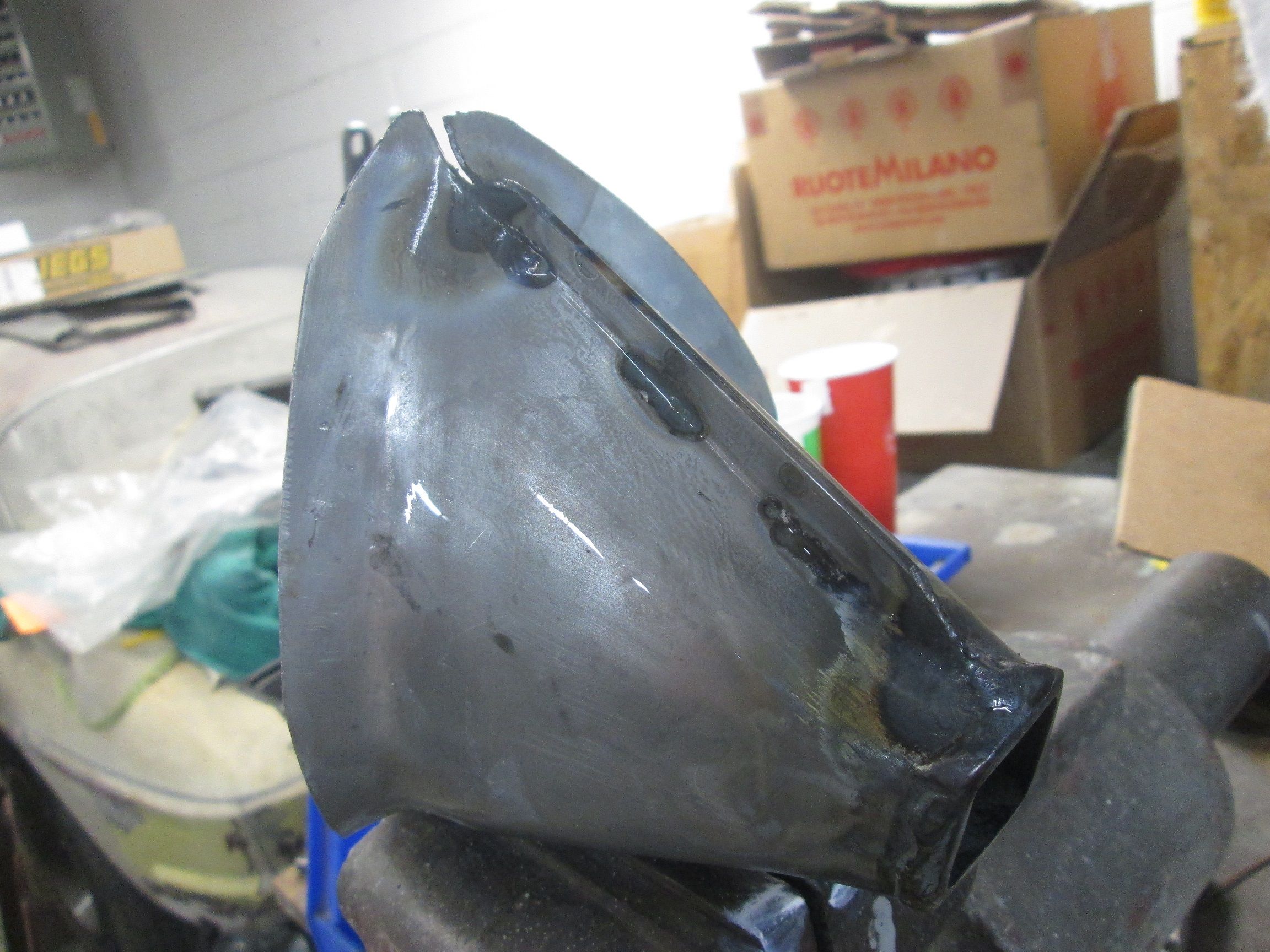

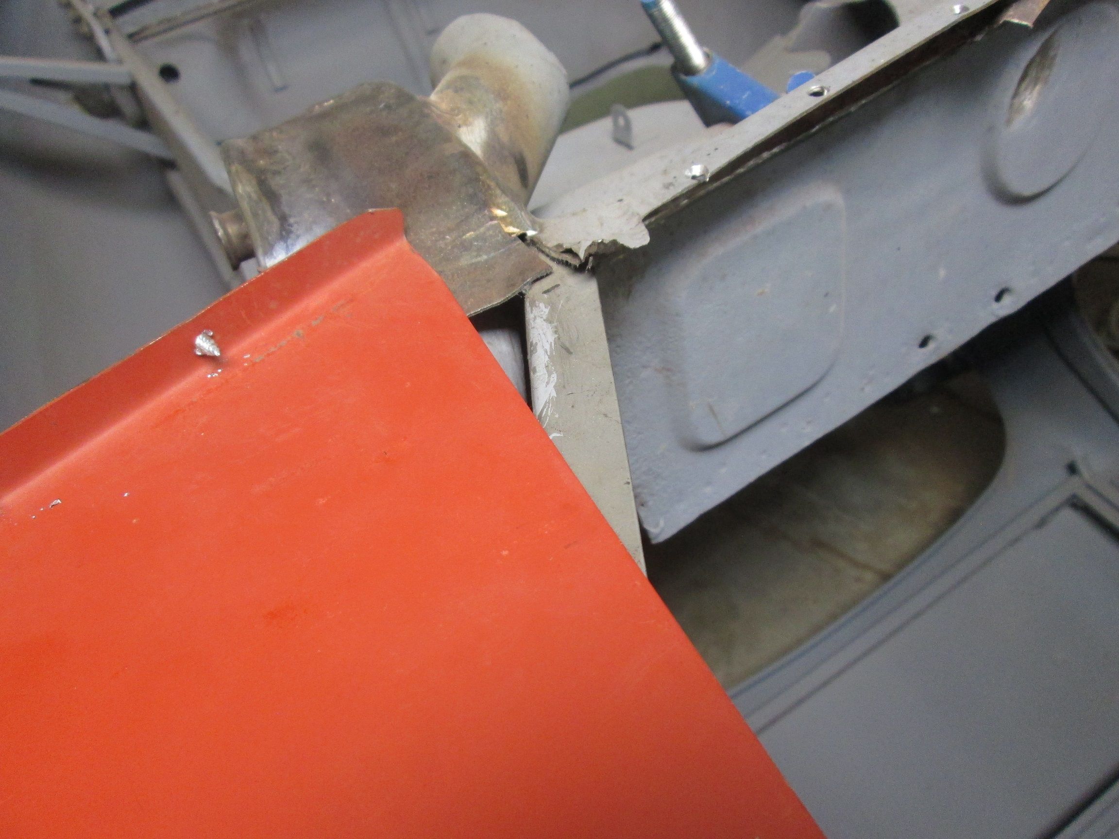

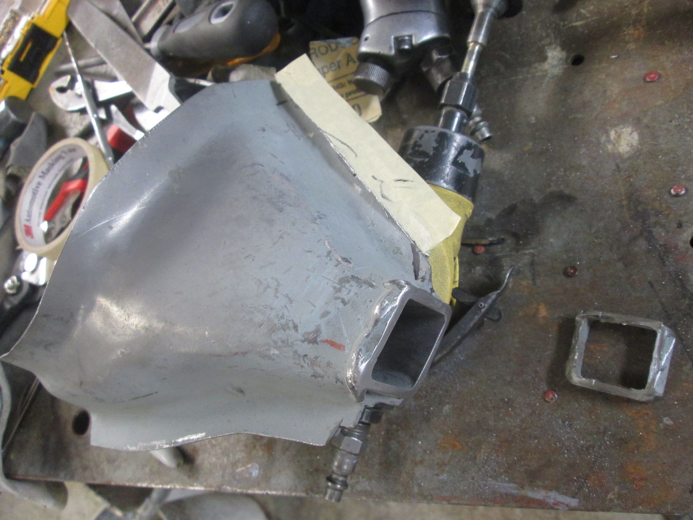

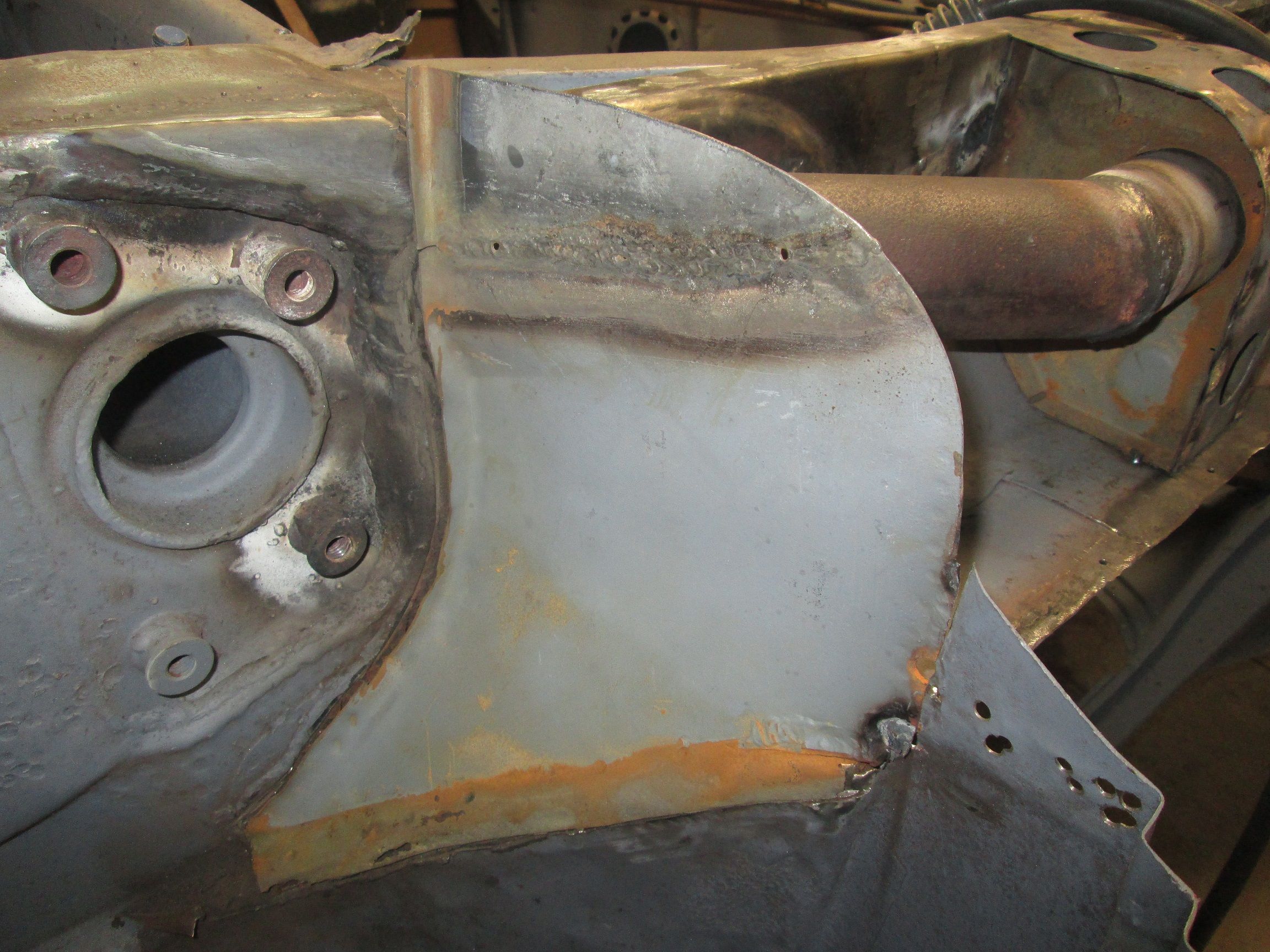

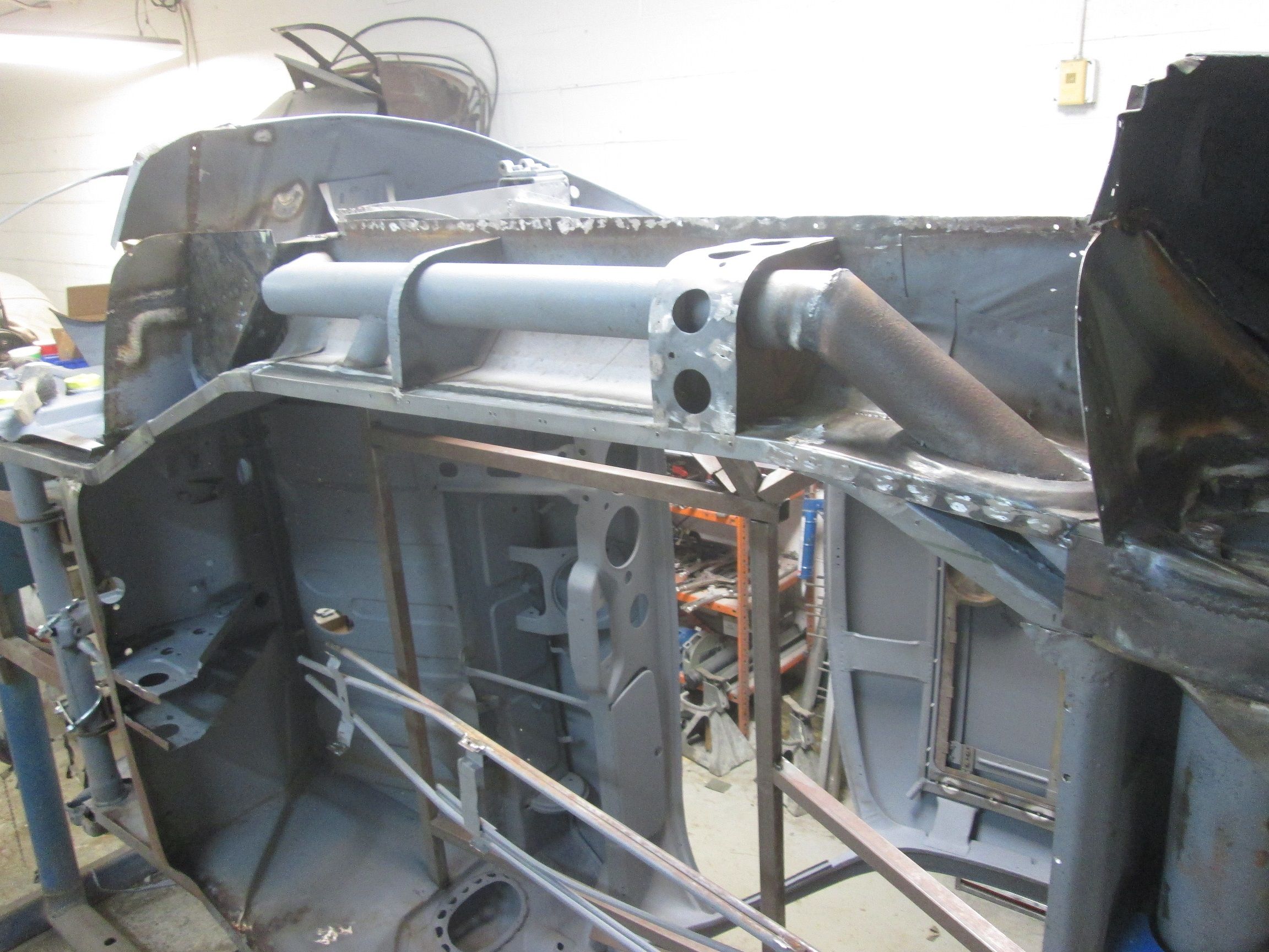

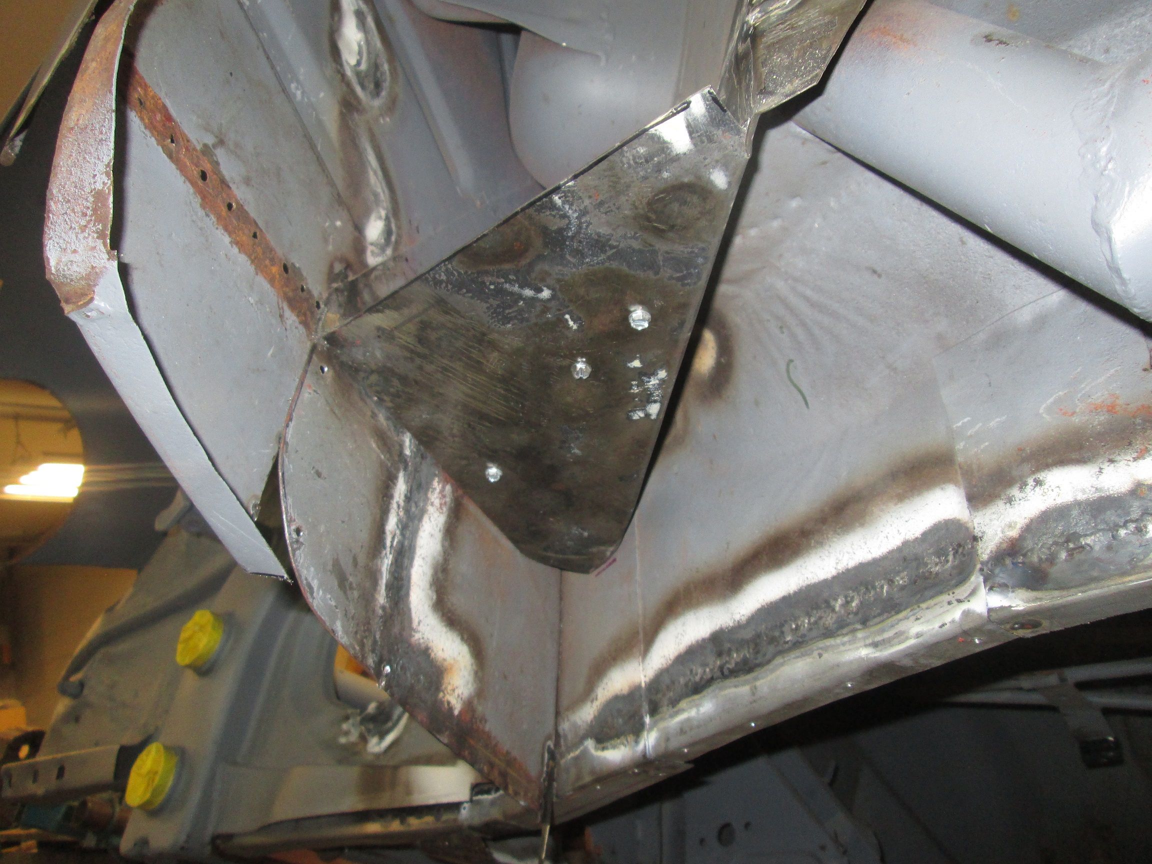

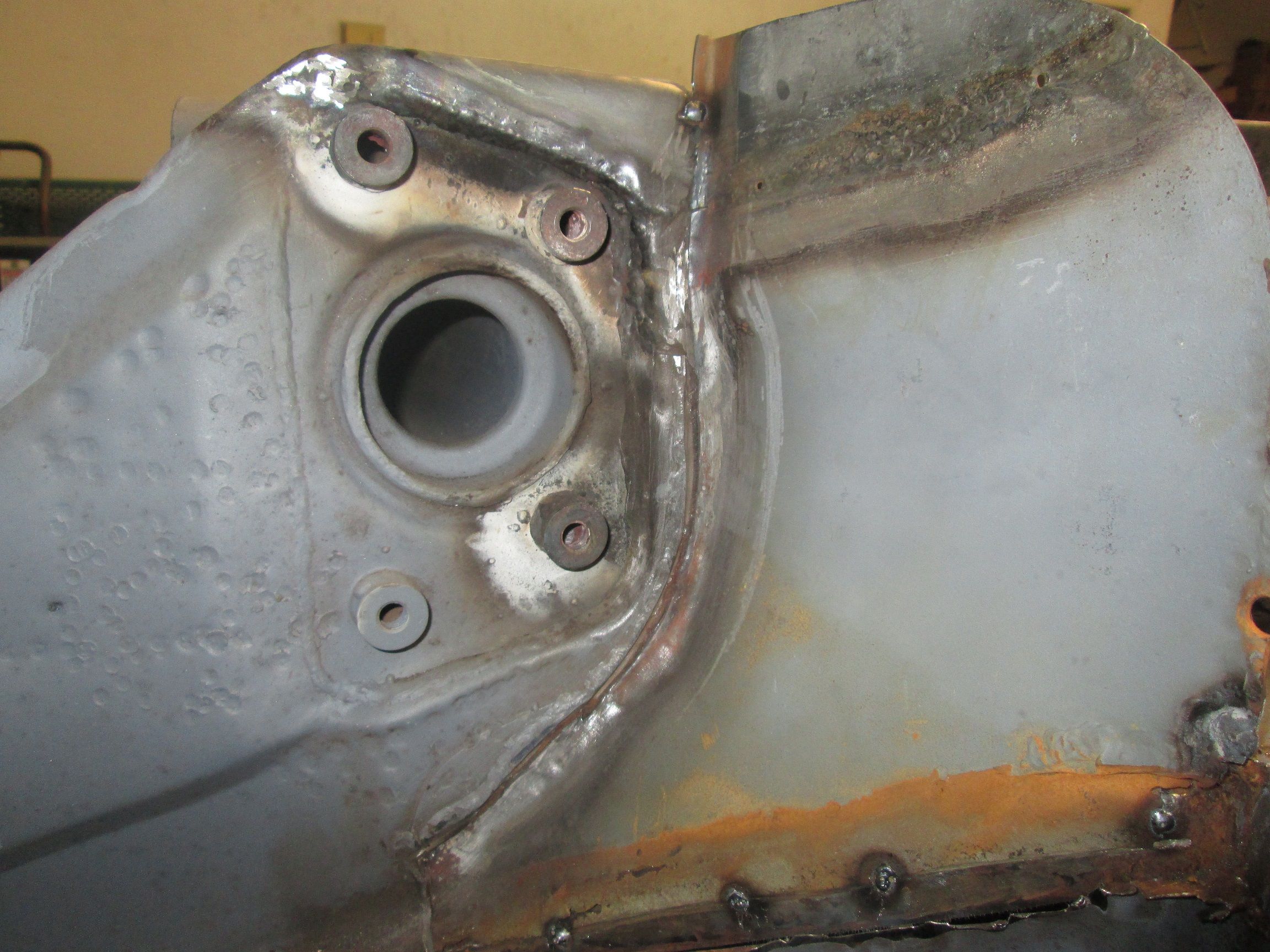

                    • Jack Spur detail and fitment prep.
                      Click image for larger version  Name:	IMG_7828.JPG Views:	0 Size:	519.9 KB ID:	111716 Threshold run welded up all but completing the longitudinal installation. Grinding the heads back and prepping the Jack spur next.

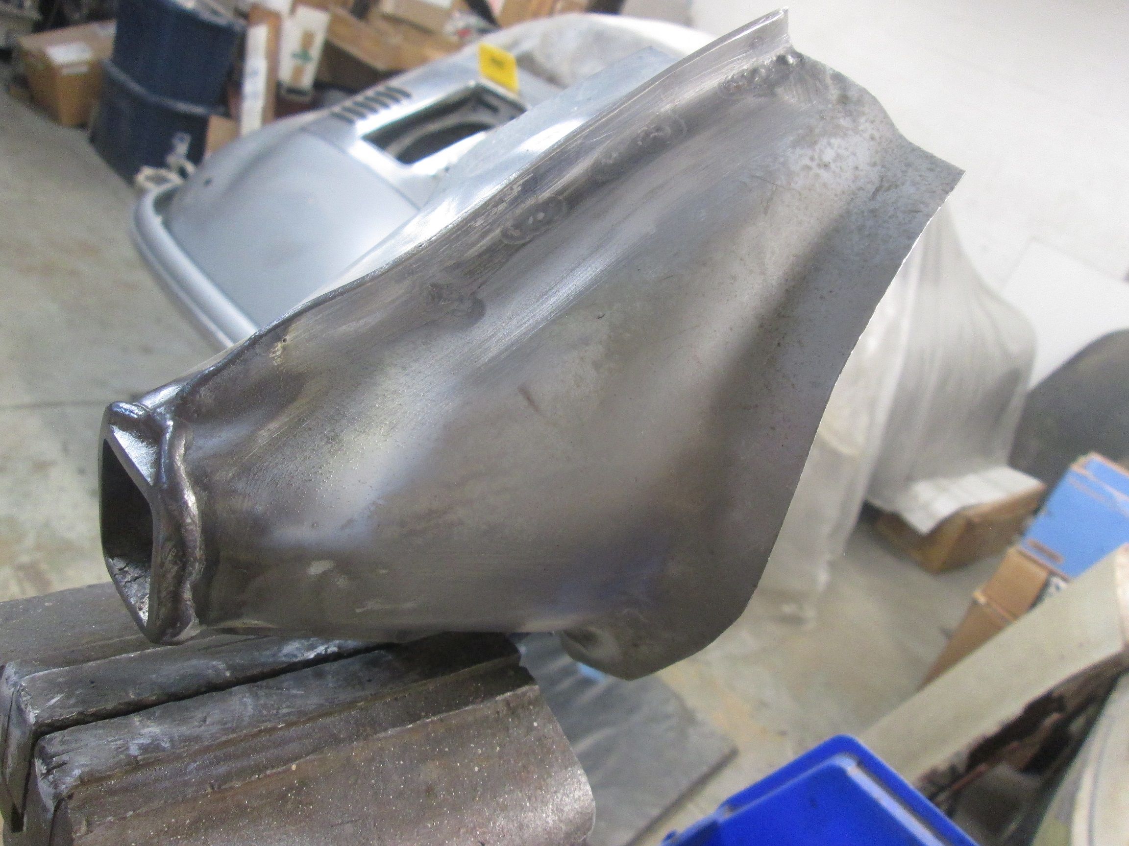

                      Click image for larger version  Name:	IMG_7830.JPG Views:	0 Size:	567.3 KB ID:	111717 Snout trimmed back to the edge of the seam weld as found on the originals. Taping my cut line and getting ready to remove the excess on the upper joint.
                      Click image for larger version  Name:	IMG_7832.JPG Views:	0 Size:	480.8 KB ID:	111718 Top trimmed back with ends notched out again as found on an original.
                      Click image for larger version  Name:	IMG_7834.JPG Views:	0 Size:	558.7 KB ID:	111719 As you can see in the previous photo only a handful of spot welds hold these halves together. A lot of guys install these as merely props these days but I want these strong and anchored securely to perform the job of raising the sides of the car as intended. Laying in some small seam runs to the inside to ensure integrity.
                      Click image for larger version  Name:	IMG_7835.JPG Views:	0 Size:	514.6 KB ID:	111720 Upper joint details and welding complete.

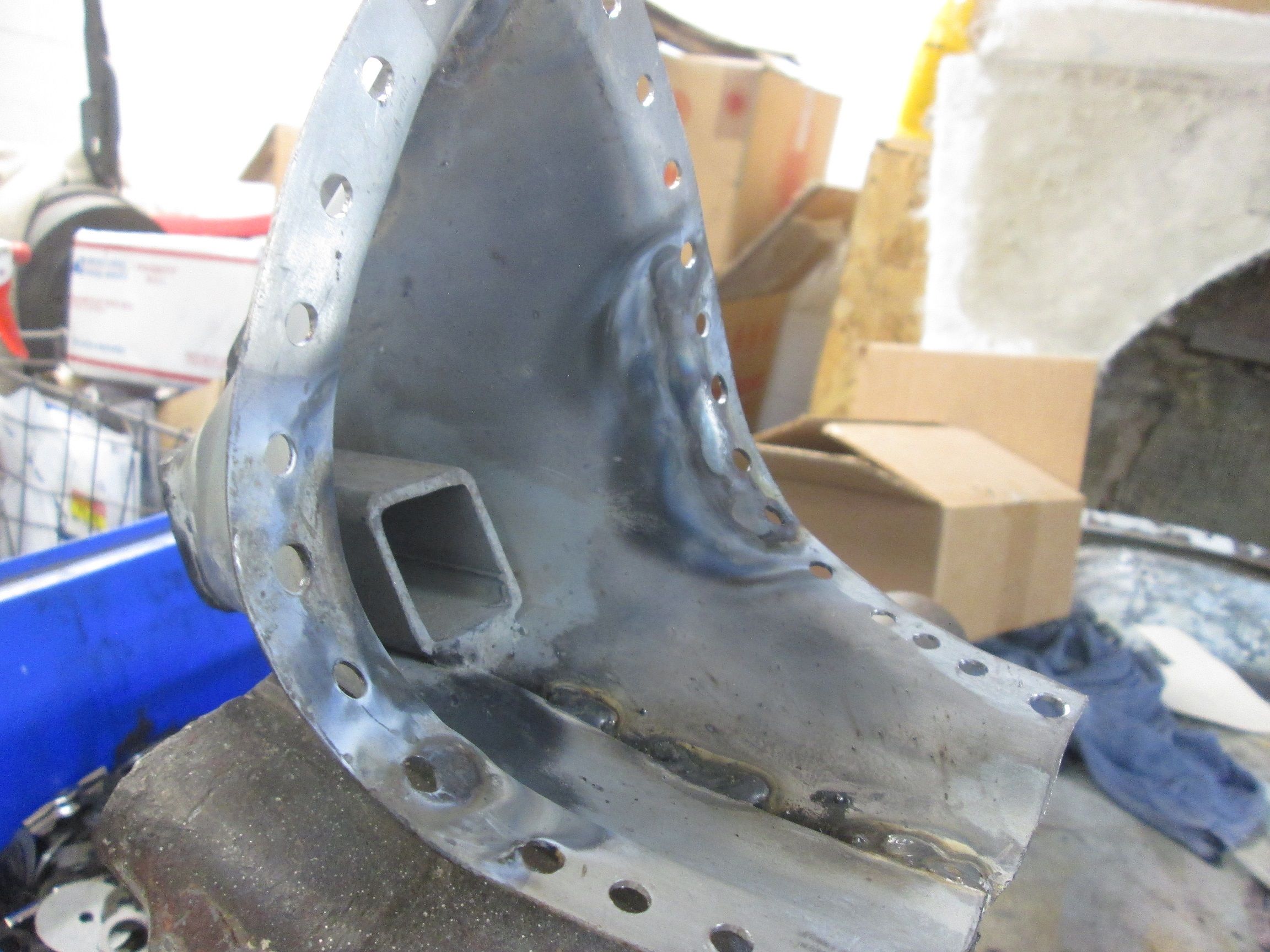

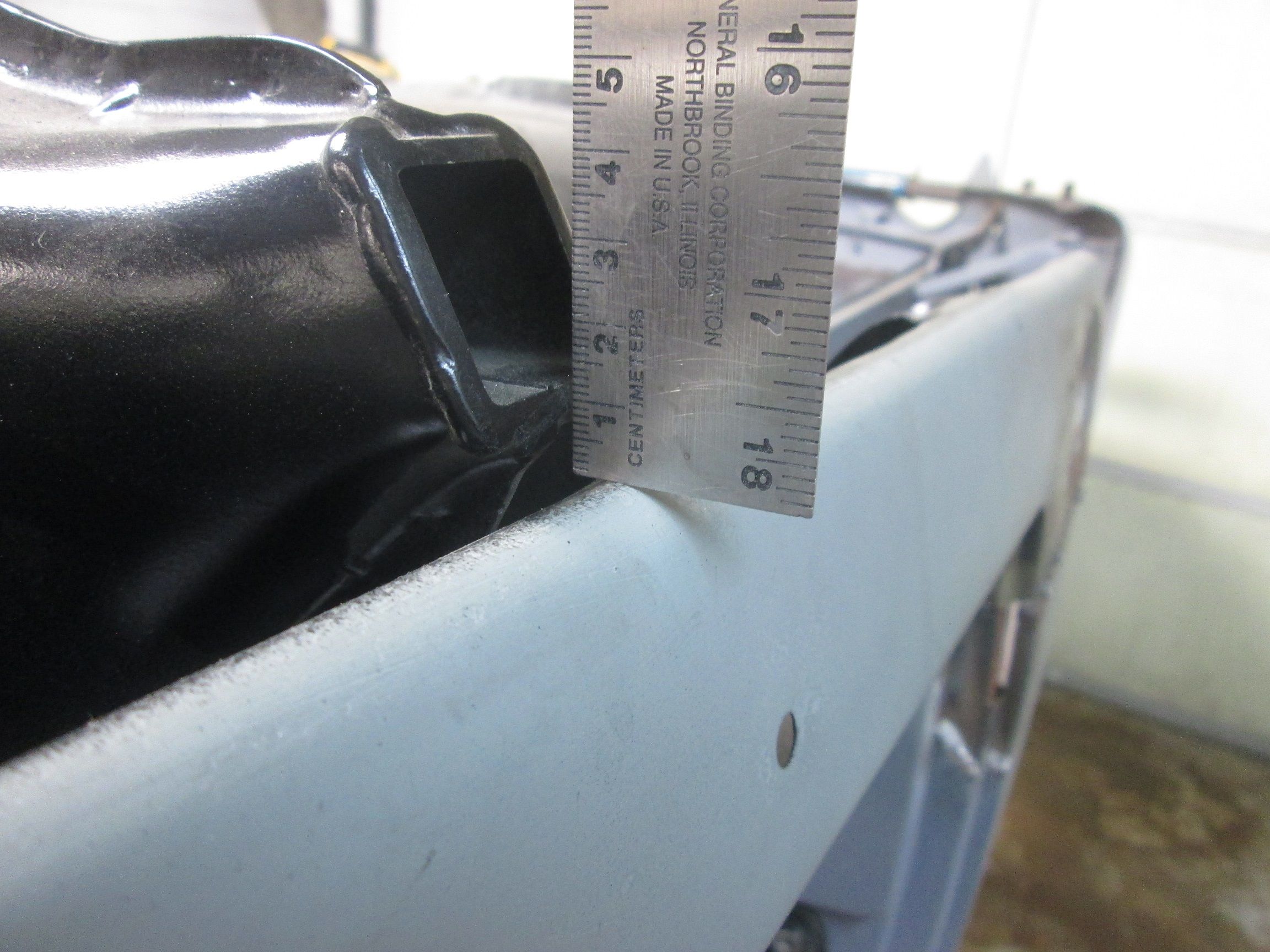

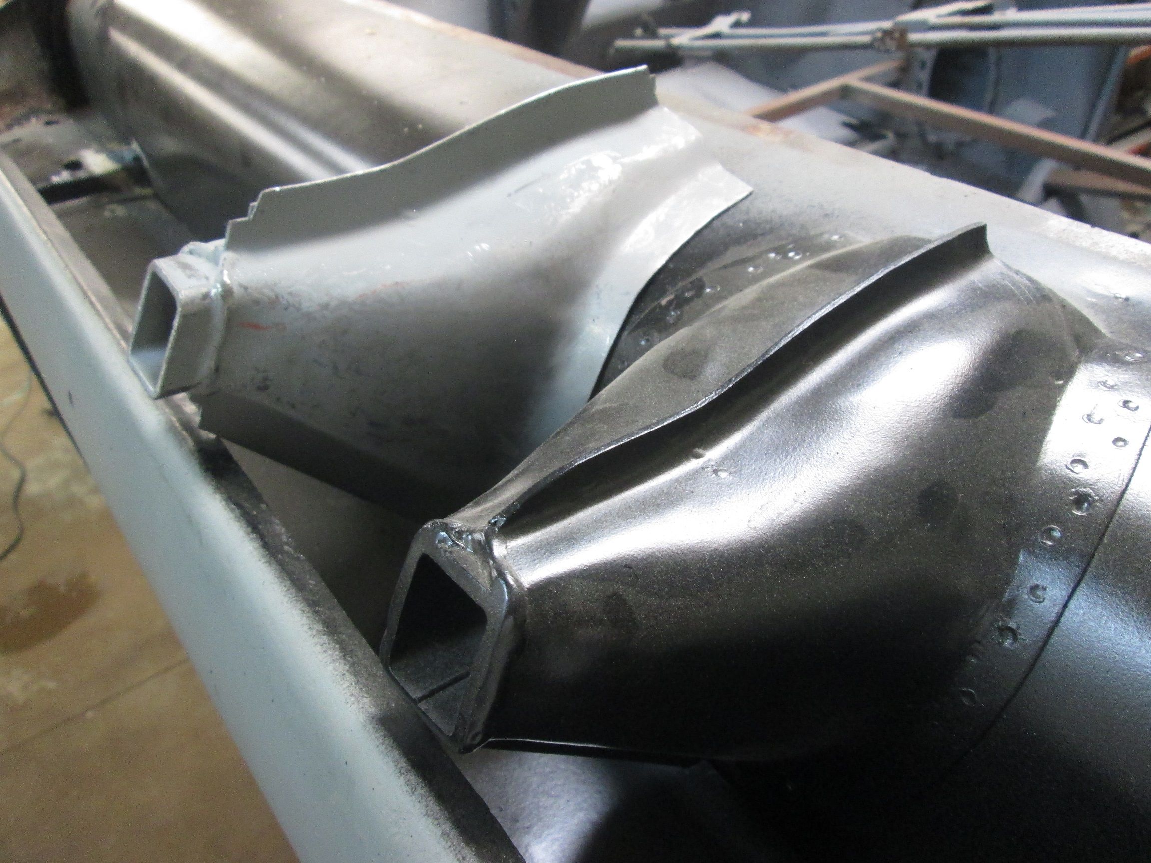

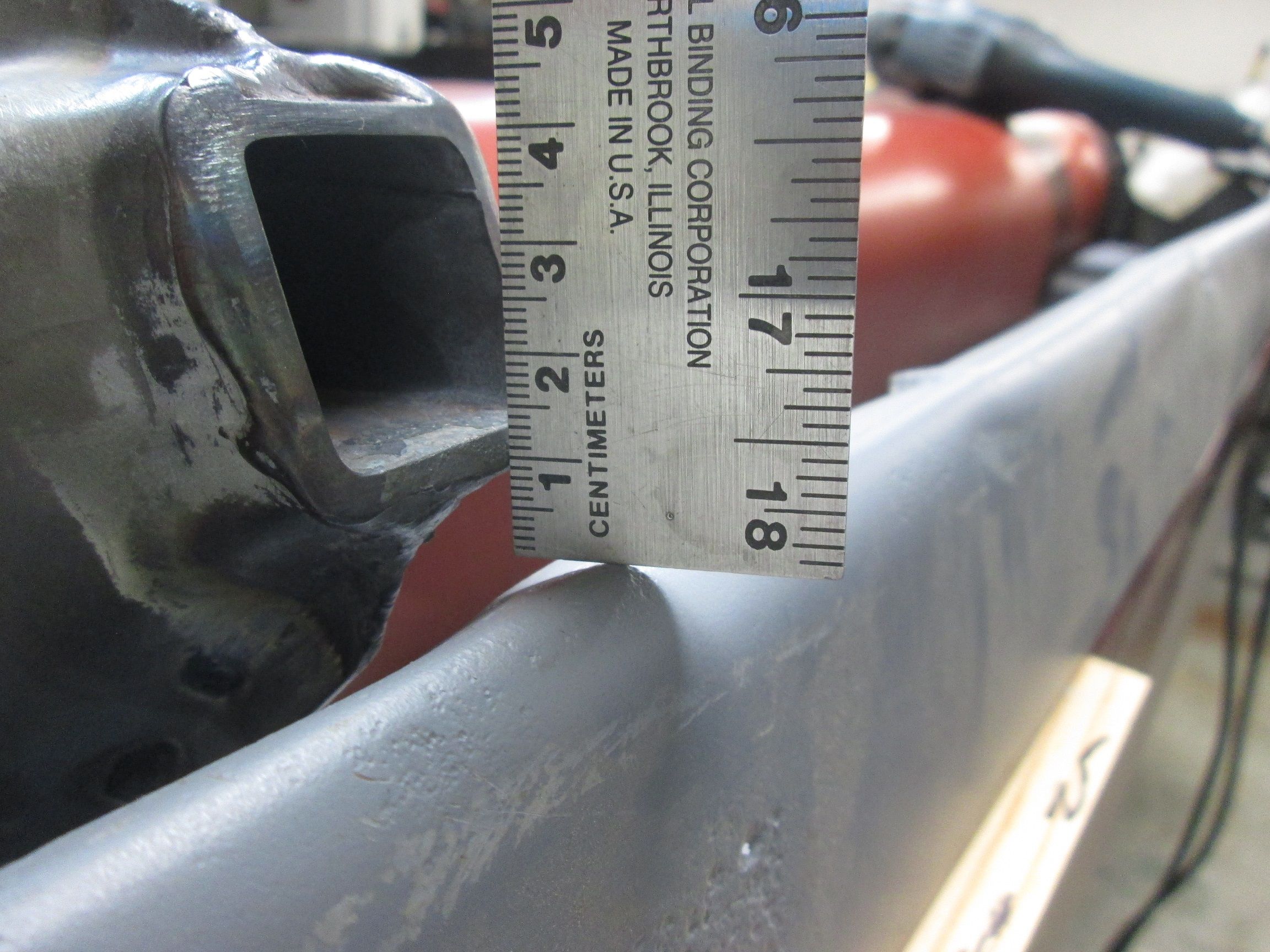

                      • part 2
                        Click image for larger version  Name:	IMG_7836.JPG Views:	0 Size:	551.4 KB ID:	111722 Lower profile shape marked out and ready to cut off the excess.
                        Click image for larger version  Name:	IMG_7837.JPG Views:	0 Size:	535.6 KB ID:	111723 Bottom flange change details and welding complete.
                        Click image for larger version  Name:	IMG_7840.JPG Views:	0 Size:	482.7 KB ID:	111724 Plug weld holes punched in all but completing the metal preparation for this spur. Now onto dialing in the correct location on the longitudinal.
                        Click image for larger version  Name:	IMG_7849.JPG Views:	0 Size:	526.8 KB ID:	111725 Door and rocker were added to find the correct height/clearance from the lower edge of the rocker. Paint stick added to establish a 3mm gap for a close approximation of the rockers final position. I'll set the snout just past its leading edge.

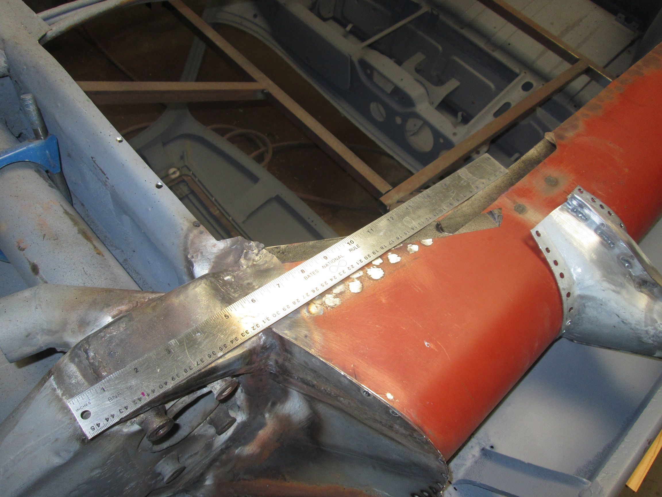

ID:	111726 Lateral position is 415MM from the rear lower spring plate bolt to the center of the spur as illustrated in the factory manual.

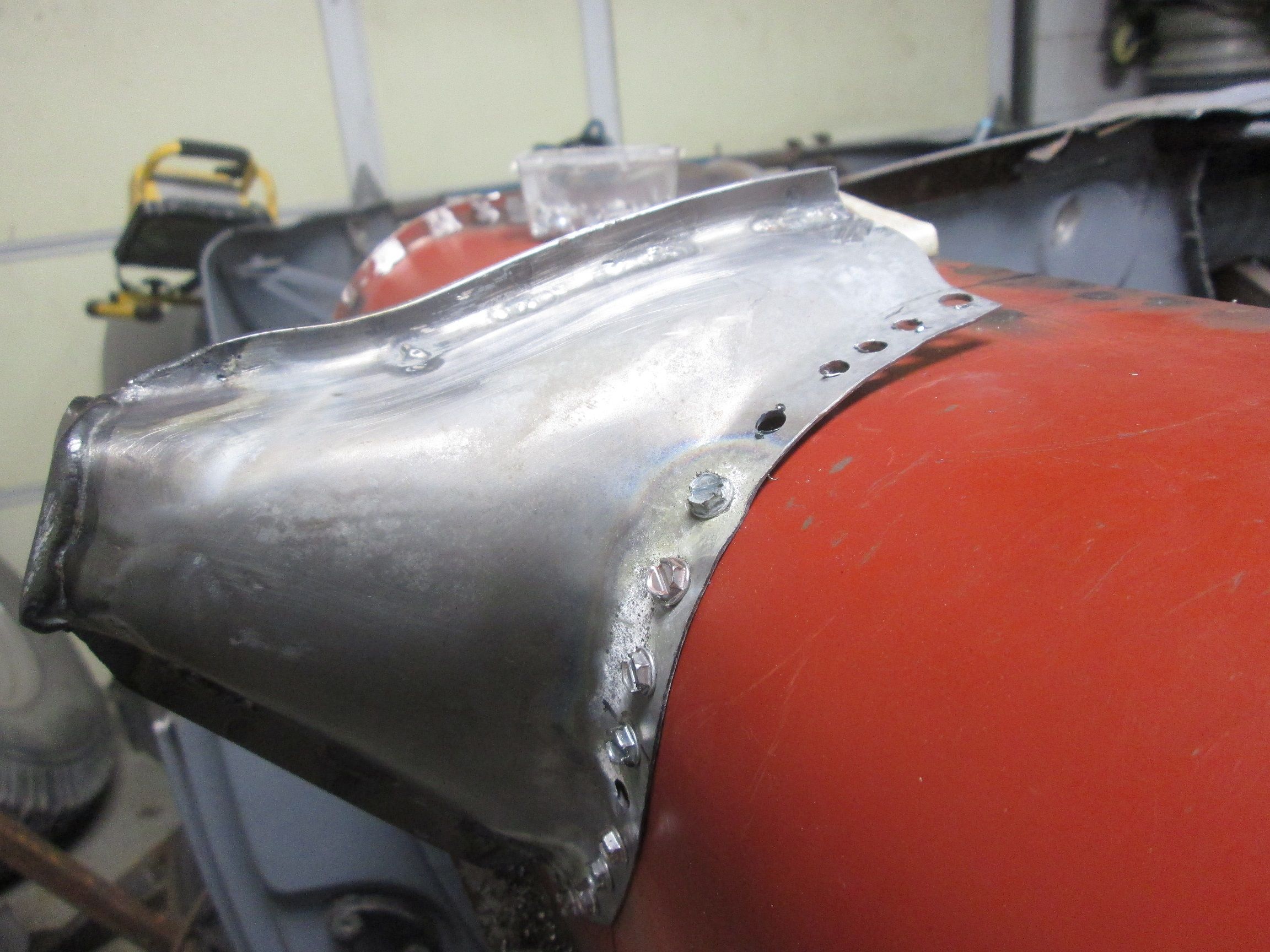

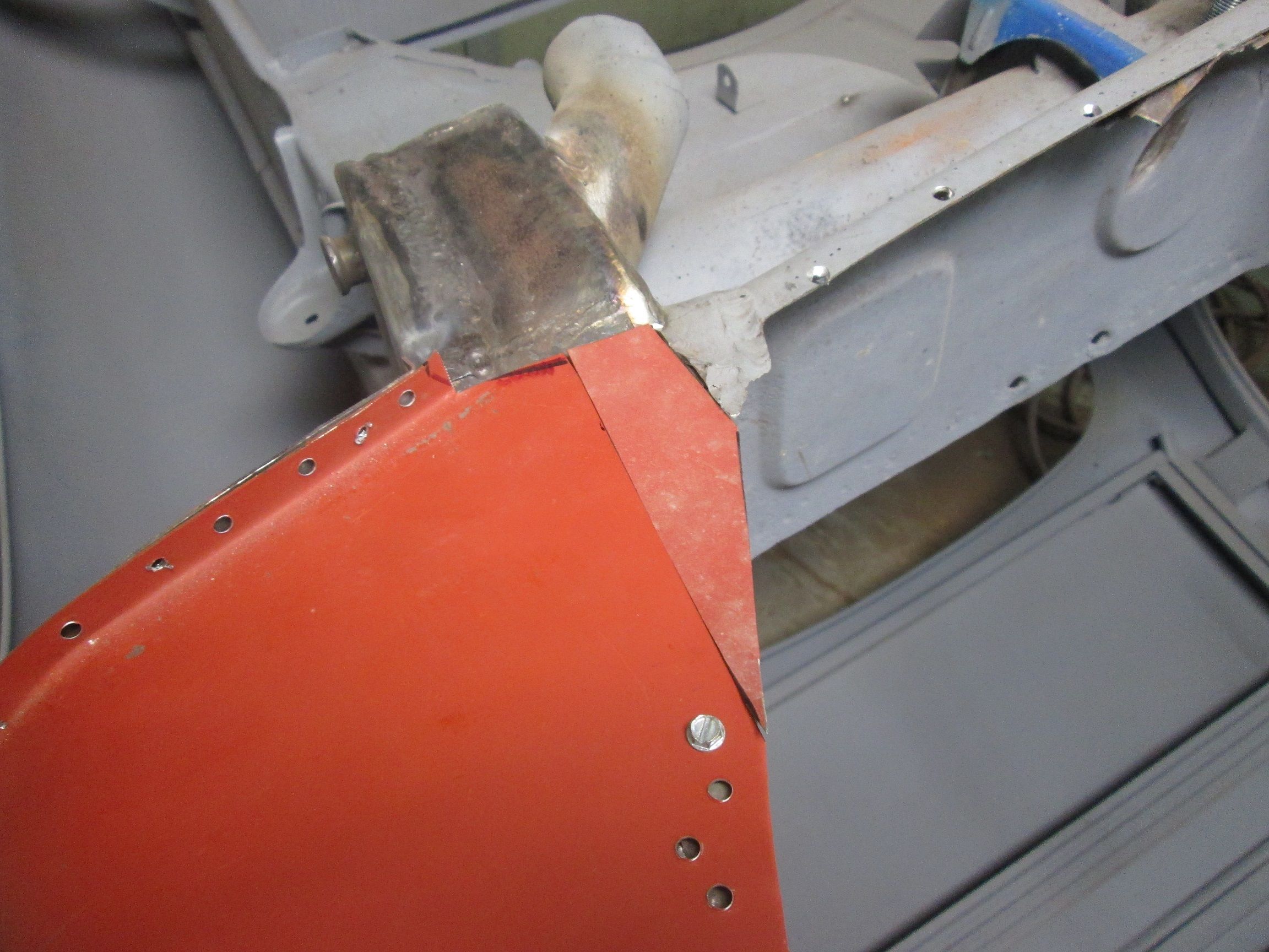

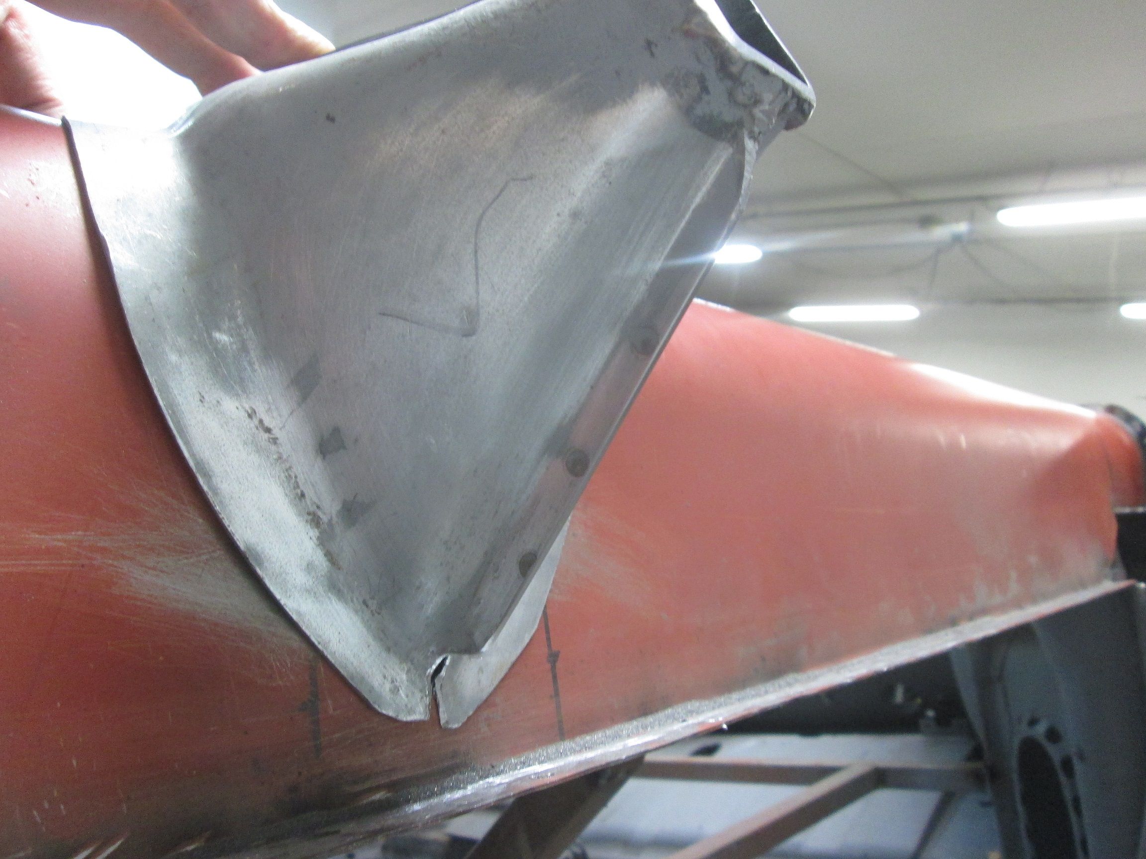

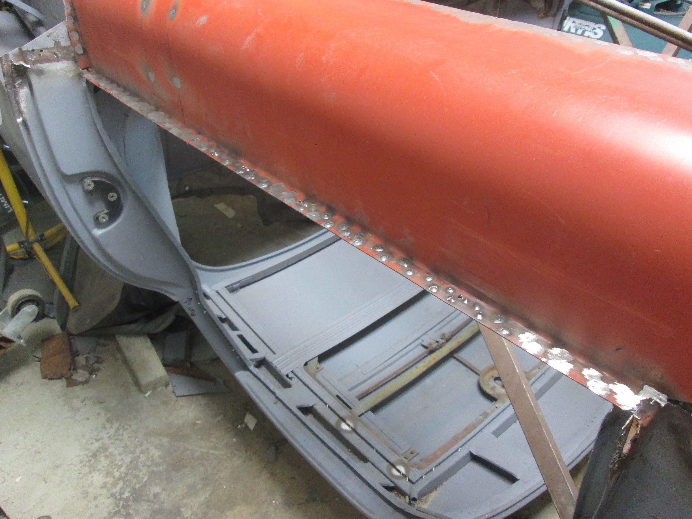

                        • Part3:
                          Click image for larger version  Name:	IMG_7852.JPG Views:	0 Size:	489.7 KB ID:	111728 One more minor but needed adjustment. Flanges especially through the turn had to heated and stretched flatter to allow a flush fit.
                          Click image for larger version  Name:	IMG_7853.JPG Views:	0 Size:	471.9 KB ID:	111729 Now the flange sits flush allowing maximum contact surface against the longitudinal.
                          Click image for larger version  Name:	IMG_7855.JPG Views:	0 Size:	451.7 KB ID:	111730 I had set the right side just shy of 10mm from the edge of the rocker.
                          Click image for larger version  Name:	IMG_7854.JPG Views:	0 Size:	532.2 KB ID:	111731 Matched that clearance as close as I could. This will of course all change ever so slightly once its all said and done but as long as ample clearance remains its golden.
                          Click image for larger version  Name:	IMG_7856.JPG Views:	0 Size:	500.0 KB ID:	111732 Set screwing it into final position. Little by little form fitting a flush fit.
