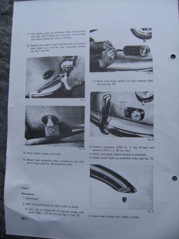

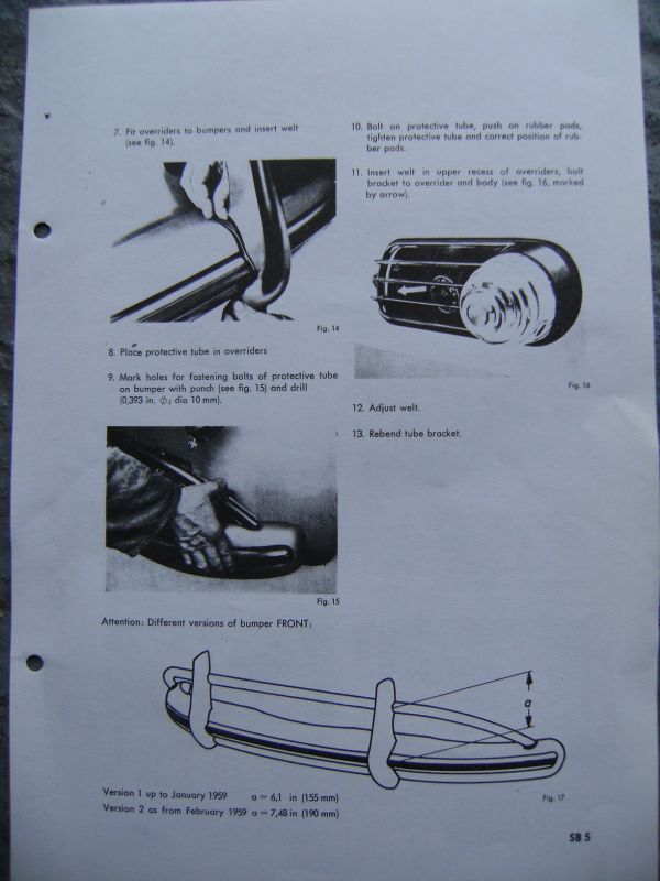

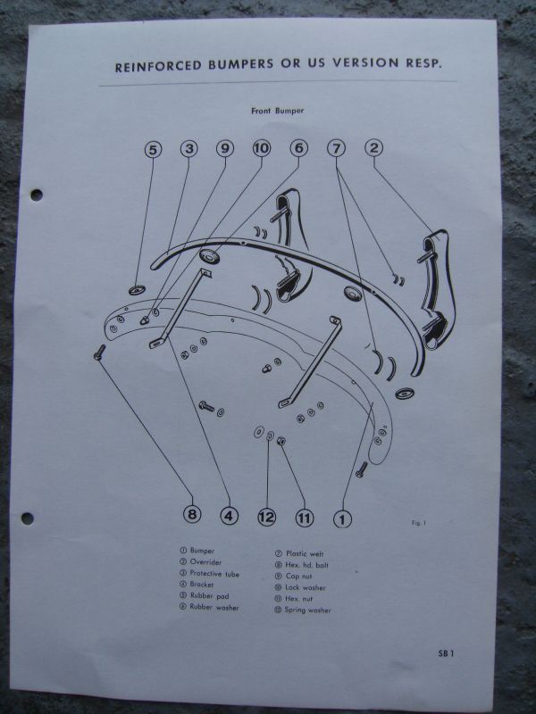

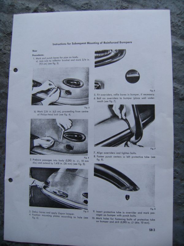

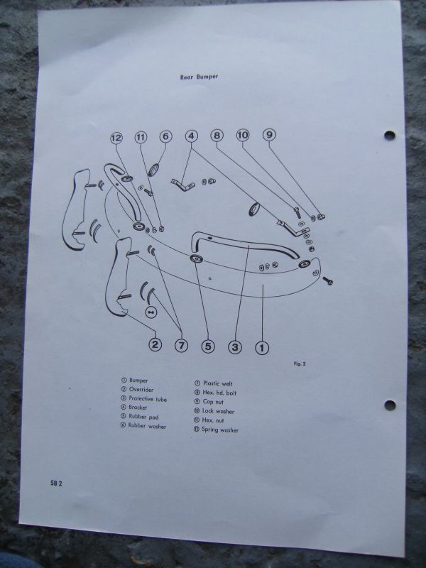

                  Bart,
                  Attached the 5 photo's for fitting these overider bars. Might be useful.

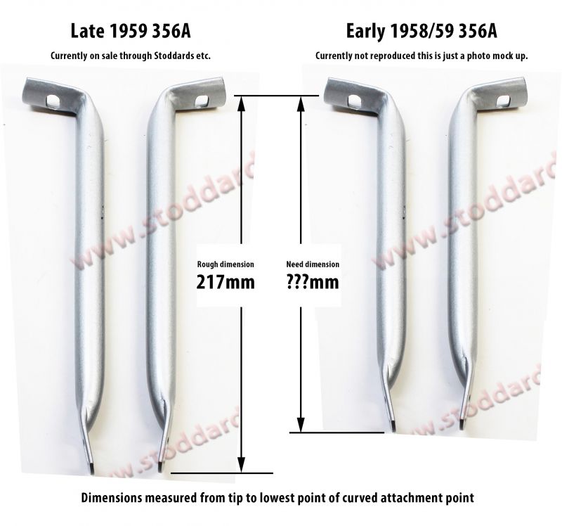

                          Hi Bart
                          Sorry to highjack your thread but I thought I would try and get some dimensions from the group so that I can have a go at producing a couple of pairs of 58/59 short front support tubes as there still seems to be no one making reproductions.
                          So please can anyone who has access to original (or for that matter repro) support tubes either early or late get your tape measures out and give me dimensions from the tip to the lowest part of the curved attachment area.
                          Regards
                          Drew

                            Drew
                            It's been about 50 years since I did an A car, but if my memory is correct the difference originally was Europiean verses American over riders. Americans were higher and in late 58 or so the all went to high style.

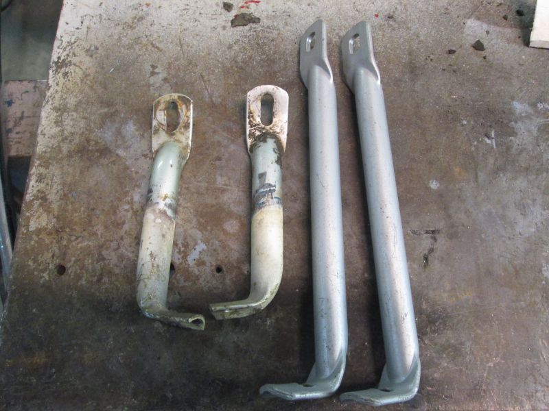

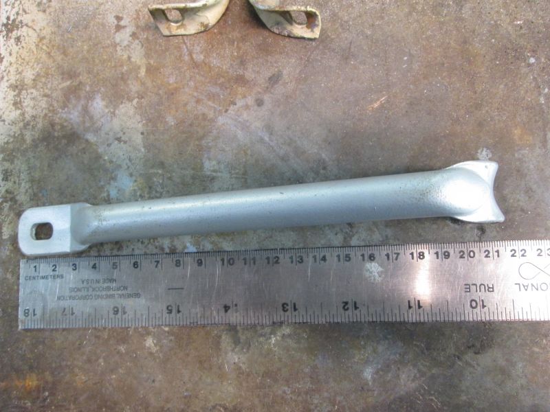

                                Here's the set I have rounded up for my car through the years.

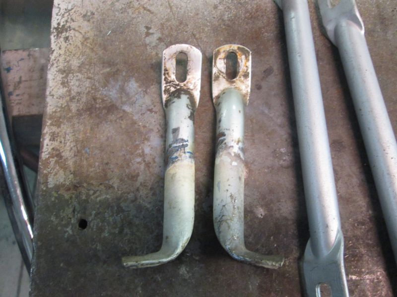

                                The short rears are definitely original but the fronts I'm sure are reproduction. Another thing too that I never noticed is that there is a right and left orientation to them.
                                I've aparently bought two of the same side.
                                I suppose in a pinch I could cut the tip off one, rotate 180 degrees and weld.

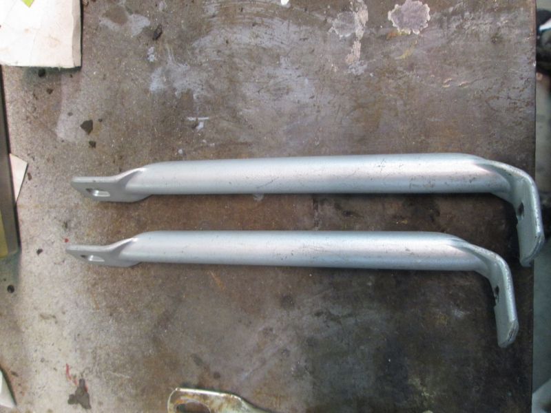

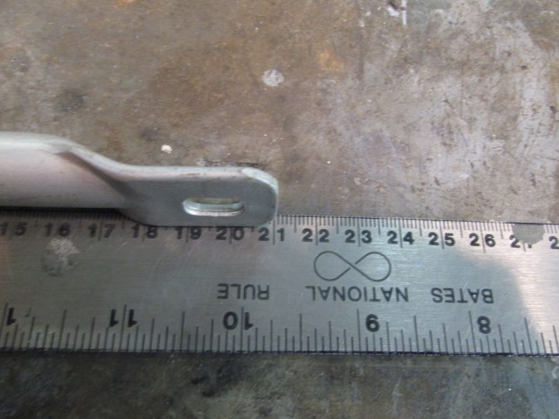

                                These are coming in at 210MM so according to stoddards these are for 1959 high bar version.
