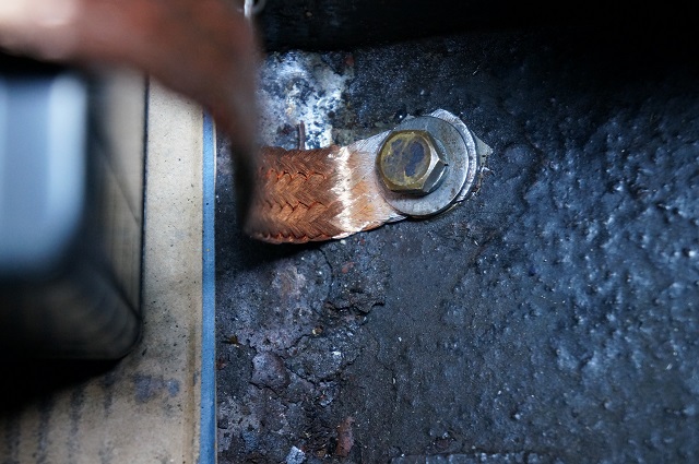

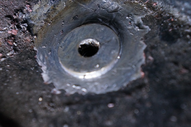

          I guess my saga shall continue. After work I took the spare tire out & removed the battery cover to expose the ground cable. Gave it a few quick hits with a hammer & screwdriver but it would not come off. Hit it harder & I realize that it is solid. I start chipping & scraping around it & mine is soldered on just like the square plate next to the transmission. I sanded all the solder off the top of the washer, cleaned around it & can't find any openings or signs of rust. I did run a tap through it by using a 1/4" wrench on the tap but it went through easily. At this point I put it back together headed in for dinner without trying to start it. I am not expecting any changes. I have a what appears to be a brass bolt, lock washer, flat washer, ground strap & the the soldered on washer which is brass. Maybe I should unsolder it but then I would want to do the trans one also. That will be a last resort only if I run jumper ground straps & it makes a big difference.
          Maybe it will be different but I remember doing Roy's test last week of starting with the lights on & they did not dim very much at all.

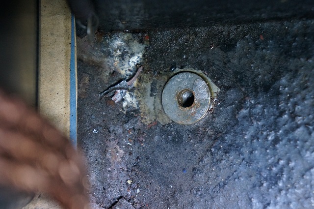

          As I am starting.
          After removal of cable.

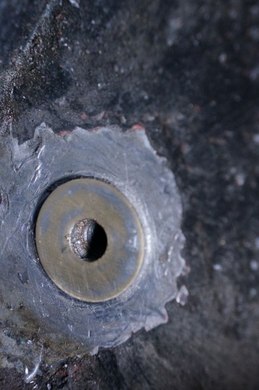

          After scraping.
          After sanding the solder off the top of the washer.
            Mic,
            Interesting and good photos! The person who soldered my washer on by the battery, for certain did not do the full job at all. I reckon 2 dabs 180 degree apart. I only found 2 small deposits of solder the rest of the circumference was untouched. The transmission to chassis earthing was a perfect job I tried to knock it off it would not move without heat.
            If your lights did not dim to virtually nothing when cranking but stayed quite bright then your earthing is probably good. I can really say after another run out today I can stop anywhere and it will restart hot without problem.

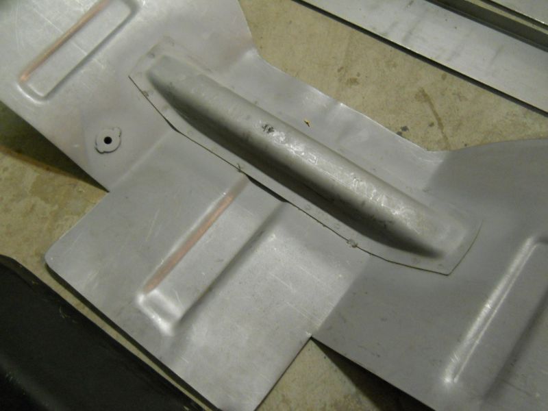

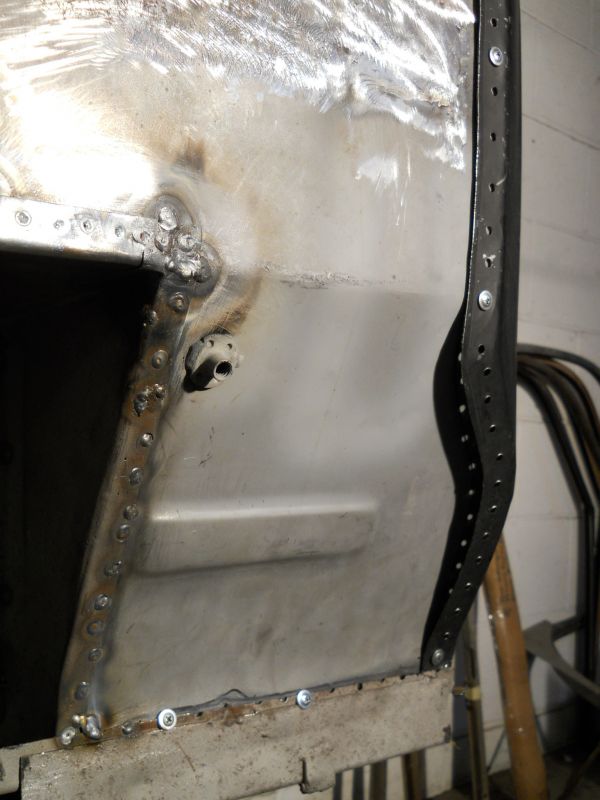

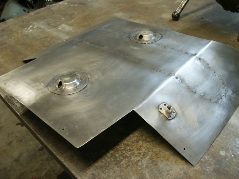

              Roy, I've ordered about 4 replacement battery floors and they all had the captive nut installed
              With the spacer washer welded to the inside.
              When I fabbed up my own partial floor for my third and final attempt at repair on my coupe I had it mounted pre-installation.
              Going by all the repro floors I welded a spacer washer in as well. Looking at Mic's photos it makes more sense that this washer would have been soldered into place instead... Always learning.
              I plan to have this strap attachment thoroughly caked in grease at all times to inhibit any corrosion. Insightful thread you guys. Thank you!
