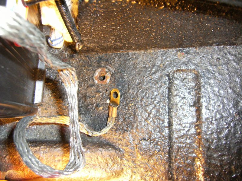

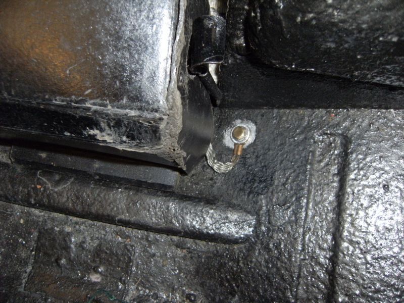

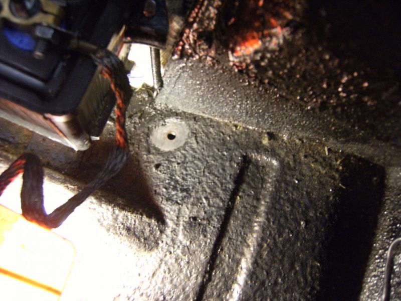

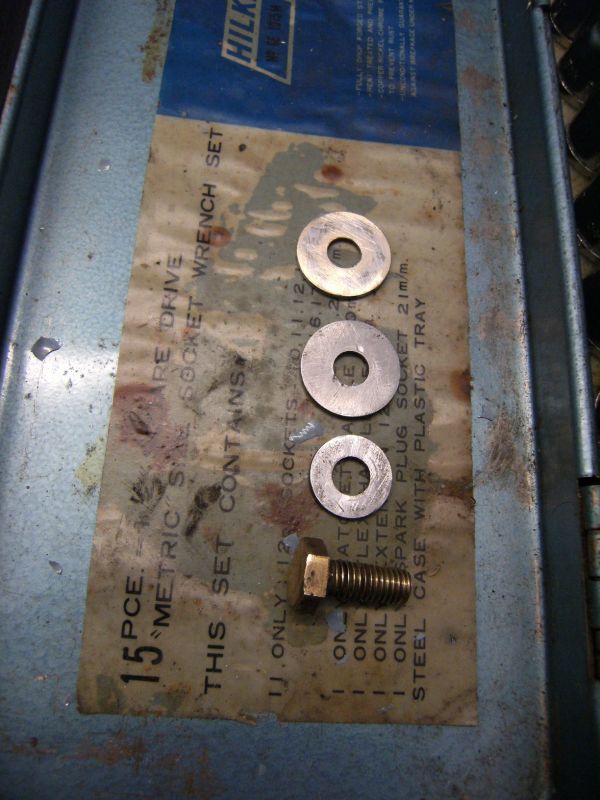

                          Okay Guys,
                          After my last post explaining my next actions especially for Mic I can advise the following with photos below:
                          1). I removed the brass bolt, one small washer and one brass plated larger washer. All were in good condition as expected no dirt or contamination.
                          2). I then looked down on the battery box floor to see a shiney washer face the same diameter as the one taken off. As I thought this washer was firmly fixed to the floor. I removed all the factory floor sealant like rock from around the circumference and then tapped it with a screw driver and mallet. Nothing it was stuck! I began to think it was solid down the the captivation nut under the car. I hit it harder and viola it popped off!! The rusty ,dirty face was exposed.
                          3). I then carefully cleaned the face of dirt and rust.
                          4). Replaced everything so now I have for sure one bolt, one small washer and 2 larger washers.
                          I then started the car much faster, then got it hot and on return as described in my last post directed the headlight on the garage door and restarted the car. Only a slight drop in headlights on the door and it turned over 85% faster. Repeated 5 times on the trot. All okay.
                          Pic 1 shows the bolt, small washer and 2 large washers
                          Pic 2 shows the contaminated surface when the stuck washer was removed.
                          Pic 3 The cleaned surface to attach the washers. ( it seems the area which contains the captivated nut is leaded in place or soldered I found evidence
                          Pic 4 All attached in place.
                          I do not know if new battery box floors have this earthing connection as my area is still all factory including the tired battery cover!!

                          Treating myself to a beer tonight I am that pleased
                            Holy xxxx Roy! I did the same thing once I removed the battery cable from the floor. I tapped on the washer with a hammer & screwdriver & when it didn't come off I figured as you did that it was part of the captive nut fixed to the battery floor. I just polished the top of it. Mine too is the original floor here so now I can't wait to try as you did. I hope I have as much success as you!
                            No worries on poaching the thread, it is all about knowledge. I am like you, pig headed & know this should work on 6 volts.
                              Aw, jeeze! I went thru this same process with the work on the coupe and I should have thought to mention it. I plead geezerhood.
                              As a means to make up for it, I will note this: while you're at this, run a tap down the captured nut to boot, as the bolt plays a part in this grounding scenario.
                              PS: WD-40 conducts electricity.
                              PPS: I also forgot to mention another benefit of running 12v: the larger dia. wire used for 6v means less resistance to 12v, and, with 12v, you run fewer amps thru switches (like the ign sw.).
                              And the hits just keep on comin'.
