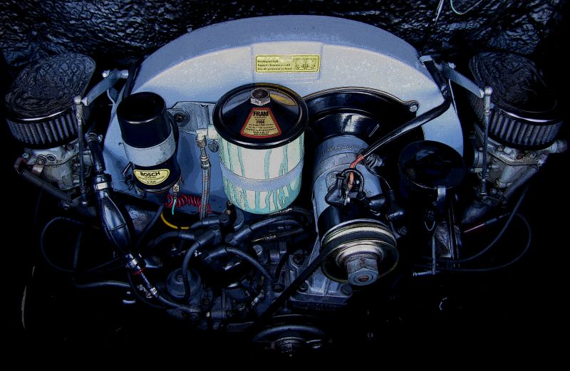

            Ashley, I see in the picture that your using an alternator. what does one do for a volt meter, can the stock gauge be made to work or do you need to install an aftermarket volt meter.
            thanks Jay D.
              Jay, I bought one of the Hollywood Speedometer quad ga that included a volt meter. I still have the original ga because the quad, as I learned, is a new part and not a mod done to an original ga.
              That picture was just as the engine went in for the first time because the wires to the alternator are not cut to the final length.

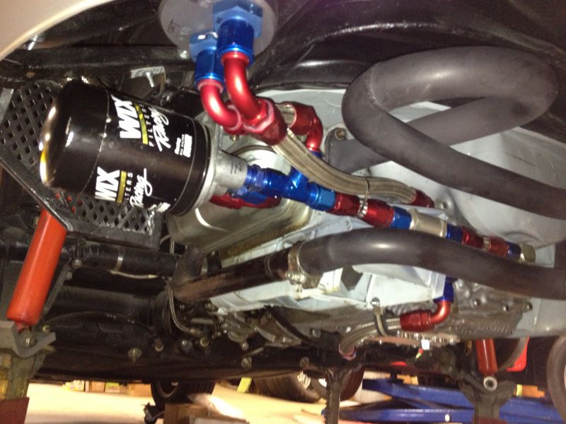

                My greater concern is to avoid cold starts with no oil cushioning the bearings after typical sitting or storage. I followed small aircraft engine technology and designed a pre-oiler system for my engine. It's rather intricate...OK, "busy" with a one-way check valve, pick-up from the sump to the off-engine pump and full-flow in the rear left fender, etc, but I just love to plumb with Aeroquip! It's also on a pressure switch so if the oil pressure goes down, it kicks in and a bright warning light gets your attention so you can look for a place to land safely.....oh, I mean "pull over."

                  Bruce, what pump did you use?
                  Where does the hose running forward under the engine go?
                  Thanks
                  Ashley Page
                    Damn, I'm home and I forget the two names. Sorry. One I tried was a Varna, I believe (I'll look it up in my file) and the other from an aircraft supply outfit in SoCal. The bigger version is shown, as that's for back-up generators and heavier. The other is in a kit made to retro fit small aircraft engines and much lighter.
                    The line you mention is from the sump drain of the engine case. That's the electric oil pump's main supply. It (the close 90* metric/AN fitting) will be protected by the same shield I made to protect my much deeper sump extension on the much lower race car.

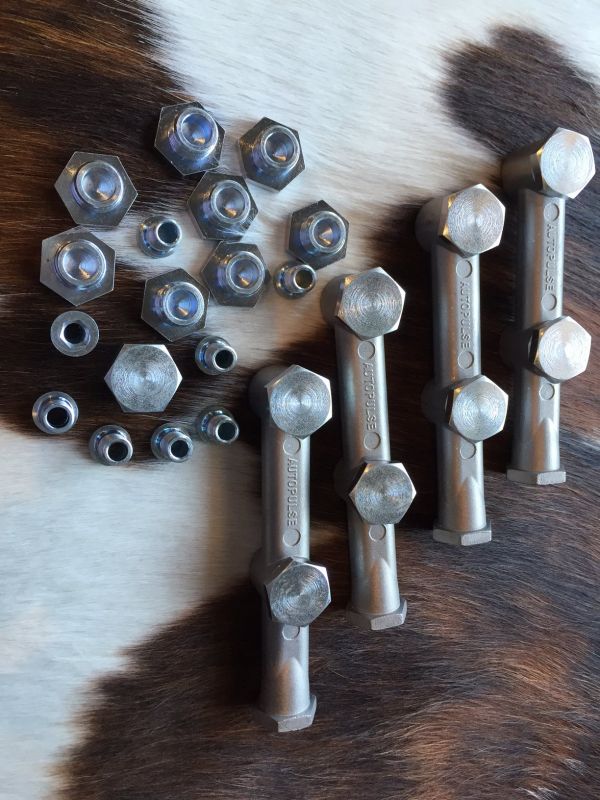

                      If anyone is using autopulse fuel pumps like in the spyders, I got a number of sets of manifolds and screws made up which are exact replicas and fully functional. I still have a few sets left

                        Hi Andrew,
                        I could use some. What's your asking price?
                        best,
                        Joris

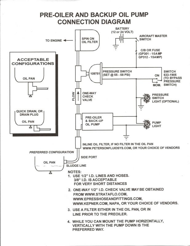

                          Ashley,
                          This is the aircraft kit's diagram and I didn't dig out the pump from that acquisition yet.

                          The pictured pump in my previous posting is a Varna EP-4.
                          I'm sorry to intrude on a fuel pump thread. I just consider oil in the bearings as important (or more so) as filling the carb bowls with fuel after sitting for long periods of time between starts.

                            Hi Joris,
                            1 x pair of manifolds plus the correct 8 screws @ US$330.00
                            Registered parcel to USA @ US$35.00
                            Email me at spyder@type550.0com if you are interested
