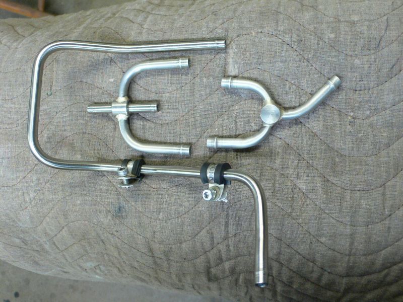

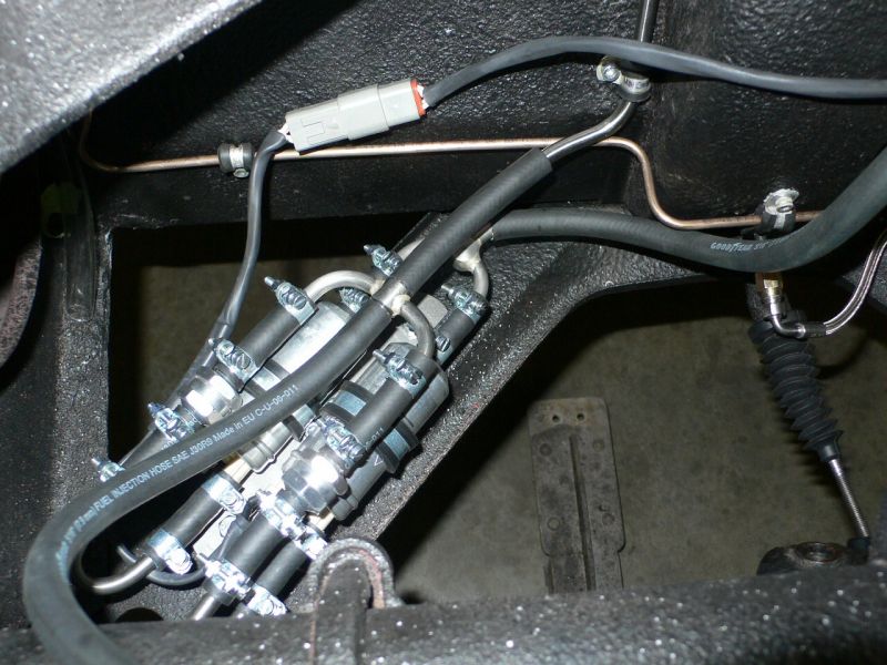

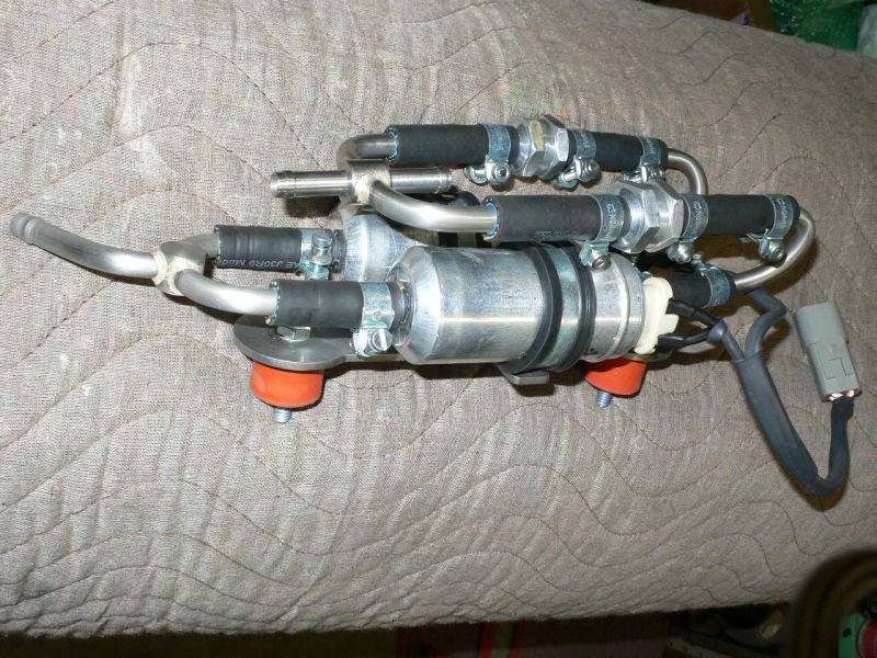

      I have a C and mounted two pumps on the V brace under the fuel tank. I used a single pole double throw switch mounted in the sunroof switch location to select either one or the other pump. Only one runs at a time and the other is a spare. Used two check valves to prevent pumping back thru the unused pump. The pumps are mounted to a stainless bracket isolated from the car by two rubber mounts.
      I used the pierburg 12V pumps. They may be dual voltage and I think they have 6V versions. Some have had failures with those pumps. They need a return or bypass line to live as is stated in the paper that comes with the pump and on their web site. I added a bypass regulated by a small orfice that still provides some pressure and the need for a regulator. An equally good or maybe better solution might be a better regulator with a return line provision. But I put my bypass at the pumps so I would not have to run a second line from the rear of the car back to the tank.
      The filter is mounted to the underside of the body near the left rear axle. The regulator is in the engine compartment on the firewall.
      I made up stainless steel fuel lines to replace all the original lines. 8mm (I think?) thin wall stainless tubing available from McMaster Carr on line.

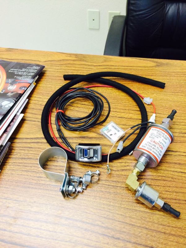

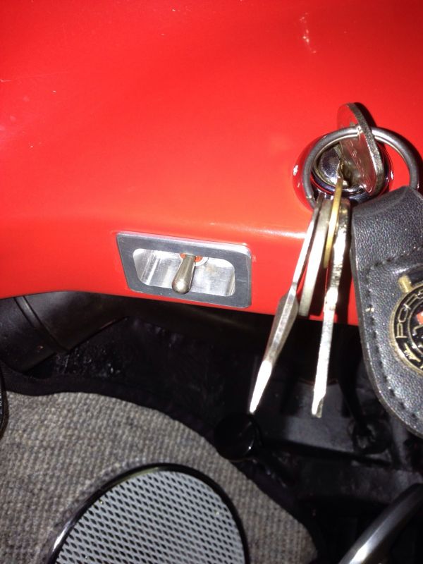

        I installed an electric fuel pump in my 6 volt 63 356 B to prime the carbs. If my Coupe sits for more than 2 weeks there's a lot of cranking going on to start. I bought the "Kit" from Ed Rutherford at Klasse356.com who put the kit together for me. It contained every thing one needs for the installation including great instructions.
        I didn't want the pump in the floorboard or in the engine bay. I had the pump mounted on top of the right diagonal brace since there is already a hole there for the bracket. Then they drilled a hole for the ground wire on the same channel and attach with a bolt and ring terminal. The hot wire of the pump runs thru the brake light switch wire grommet above the master cylinder, following those wires up to the steering column and under the dash.
        I used an original sunroof switch as the my primer switch. The hot lead comes from the ignition switch. We picked up one of the connections next to the radio wire as it is only hot when the ignition is in the on position. We installed a fuse holder on the other wire from the switch (the one leading back to the pump). It takes a 10 amp fuse.
        If you do use the sun roof switch, it just snaps into the rectangular hole under the dash to the left of the steering column. You can pig-tail the wire from two terminals to a single wire to the fuse so the pump can be activated either by pressing the switch to the right or left (open or close) mode of the switch. It's about an 1.5 hour job.
        For those concerned with the authenticity of the appearance it's all reversible and can be removed as easily as it was installed. Using an original sunroof switch gave it the original touch.

                      Thanks for the compliments. I was going to mount my pumps in the rear but changed my mind at the last minute. Because the pump will likely be mounted below the tank and always have positive head pressure I don't think it matters. I also was concerned about noise with the pump in the foot well.
                      For a do over of my installation I would get a better regulator. The one I used I have had for 40 years. When I found that overhaul kits were still available I decided to use it. Those newer Areomotive ones (and others like them) are nice and probably do a more precise job. They are also available with a bypass which is essential for precise pressure control (and pump life for some types of pumps).

                        Thanks Justin. Nothing special about what I did. I followed the pluming schematic on the Pierburg site. The only thing I spent a little time finding were the check valves which I found on ebay. McMaster has the seamless tubing in the right diameter and wall - actually it comes out marginally bigger ID than stock and I didn't want to end up smaller.
