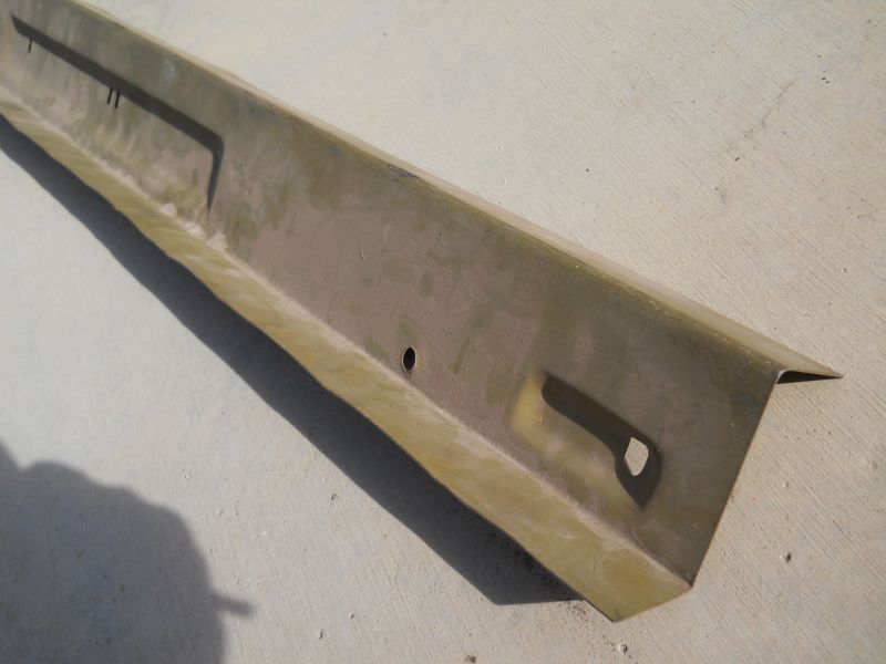

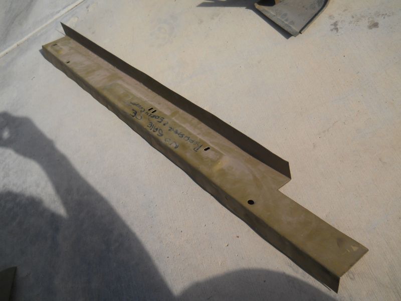

            What appears to be an NOS "A" version door bottom.
            Right side anyway.

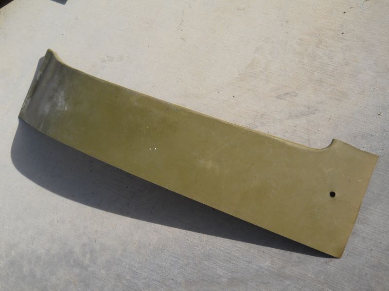

            Factory Rust repair panel.
            Right rear quarter panel leading edge.
            Door jamb flange and corner..
            Didn't think the factory offered these small rust repair strips back then. Looks identical to what RD offers today.

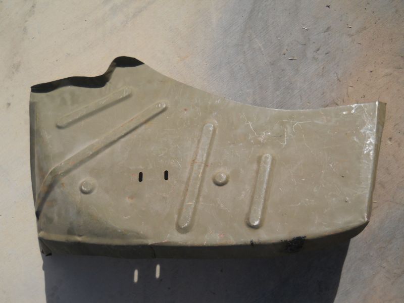

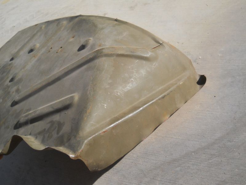

              NOS Late B/C splash pan. (possibly AT2 as well?)
              Lower corner is much more squared off than the reproductions
              Corner is also relief cut and spot welded in place.
              This was good confirmation for the correction I had to do so the new panel would snug up against the rocker profile as it tapered too quick with a very soft rounded corner. There was no relief cut in the corner as it was shrunk and worked heavily to gather up the metal to make the turn. I was impressed with that even though it was the wrong shape to fit properly.

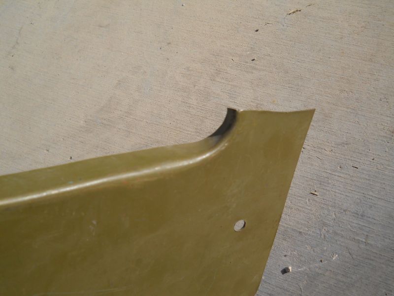

              Outer mount flange for the back of the front fender.

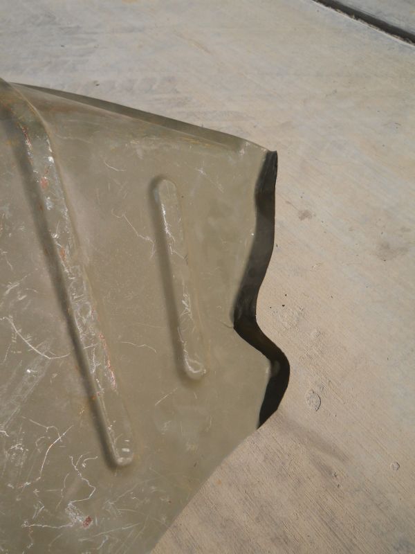

              Several relief cuts to make the turn. The repro I bought only had one relief cut along this flange were as you can see this factory unit had several more.

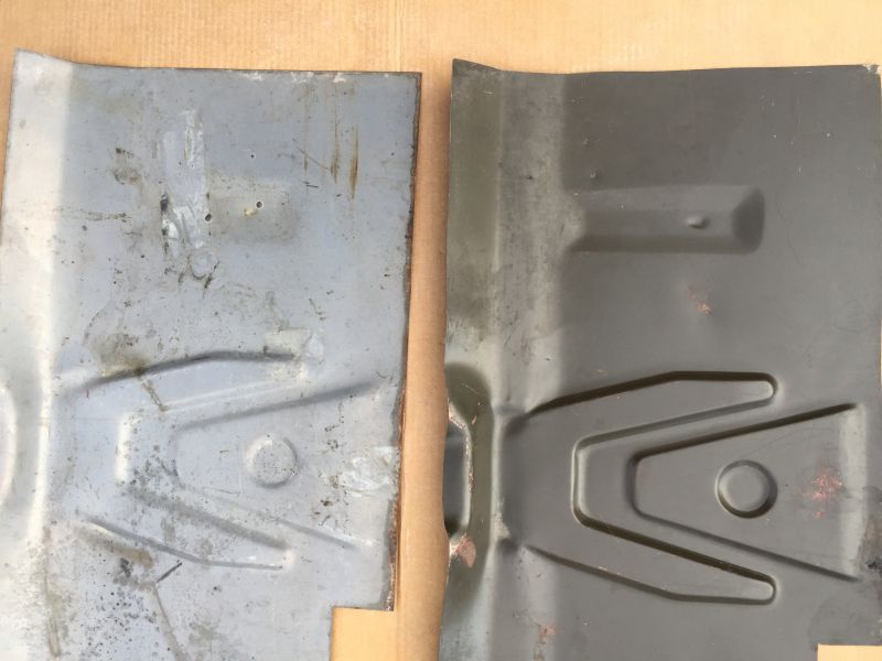

                The difference between (galvaneal) reproduction
                stamping and NOS battery floor.
                The definition is lost and the bend line not present on the reproduction.

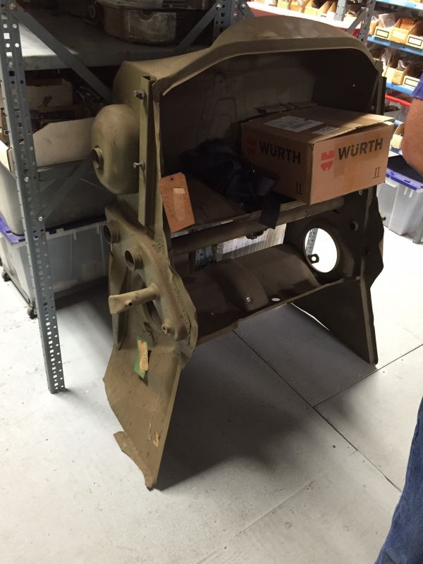

                      Here's a good one. NOS T6 "subframe", from the cowl to the battery box.

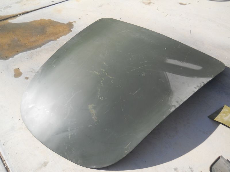

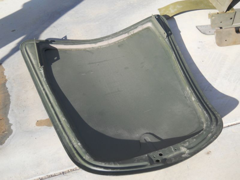

                        WOW Jim, That is a nice piece! That would go great with this hood:
                        Notice no holes for the handle.
                        Notice the large spot welds ahead of the hinge plate. Seems a reinforcement plate had been added behind there to slow down a possible "gas station kink"

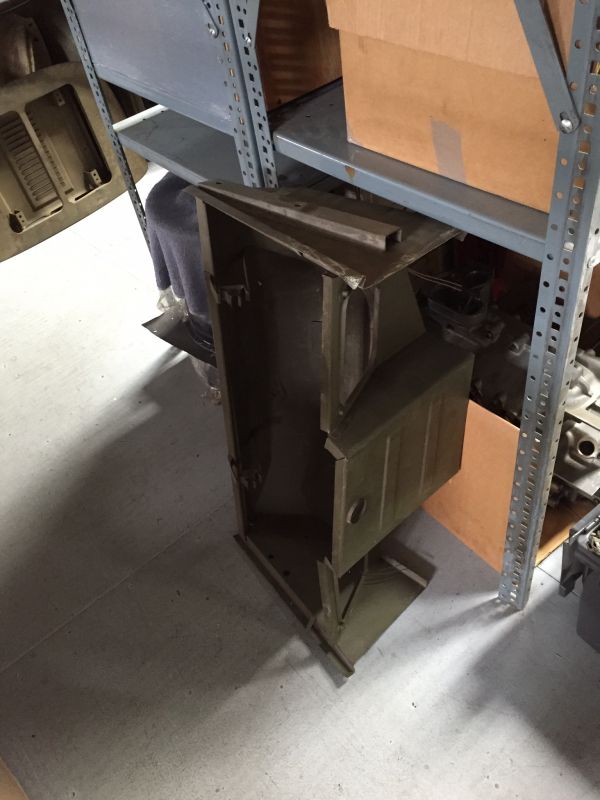

                          Another nice piece....battery box, complete, and a T6 engine lid in the background...

                            As for sheet metal, that T-6 hood doesn't look quite NOS, sorry to say, unless it had been thrown over the fence at Teaneck instead of into the dumpster as a reject. The edge inner fold is crude and the inner frame usually had the hood handle holes even if the outer skin didn't.....but usually did. The "reinforcement" spot welds appear as I remember those of the Stoddard repros which were made with that added support and also made with the 'either/or' mounting for T-6B or C latches. Those were e-coated black as were the close-but-no-cee-gar noses from the late '70s/early '80s production...and maybe the green was used sometime in that run. Can't be sure of anything from a picture, sorry, so as the kids say now....."jus' sayin'"...
