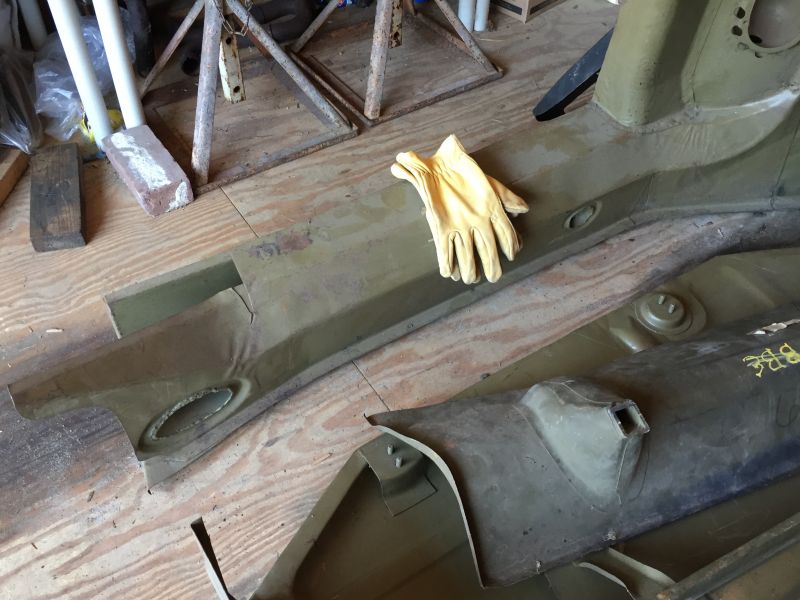

              Alex, I just looked at that picture and here is another:
              Can you or anyone please tell me what that rear oval hole could be for? It exists on both left and right sides of the inner longitudinals, so no heated air piping comes into the cockpit at that point.......that outlet is seen farther forward.
              I am embarrassed that I noticed this so long after these pieces arrived from CA. I'm gettin' old!
              Edit: I looked at Justin's thread and what he was laboring over with that tubing which passes through that oval and I see that this oval hole was internal, between the inner angled corner piece and the rear closing panel.
              I had not (as in never) used a full piece like that and the shape is of the later forward exit. My shorter original inner longi replacement pieces had no such reinforced pass-through. My bad.

                • #53
                  "Bruce,
                  Hard to tell from picture but, almost looks like a T6 tunnel."
                  Hi Alex,
                  It is a morphing tunnel with the >&T-5 spaced weld-nuts for that earlier track design and the clearances for the later 2-1-1-1-2 tracks that are hidden under the angle with those weld-nuts. The measurements from one to the other seem to suggest that the angle will not fully cover the earlier pattern holes.
                  I will either fill those present holes or make the angle 1 or 2 mm wider.
                  That combined NOS part has oddities like the earlier outer seat track riser pods with the two studs sticking up and the rear bulkhead with threaded seat belt anchor receivers whereas the original on this T-6 Roadster had the T-6 riser mounting pods and no seat belt anchoring.
                  The Belgian floor holes share their mystery with the Karmann floors (but in a different method) and a lack of shallow dimples at intersections of the floor reinforcement ribbing are yet another couple of the the details to match.
                  I am always learning about the subtle differences with these cars even after all the years of exposure to them I have had. It's the old "Assume nothing."
