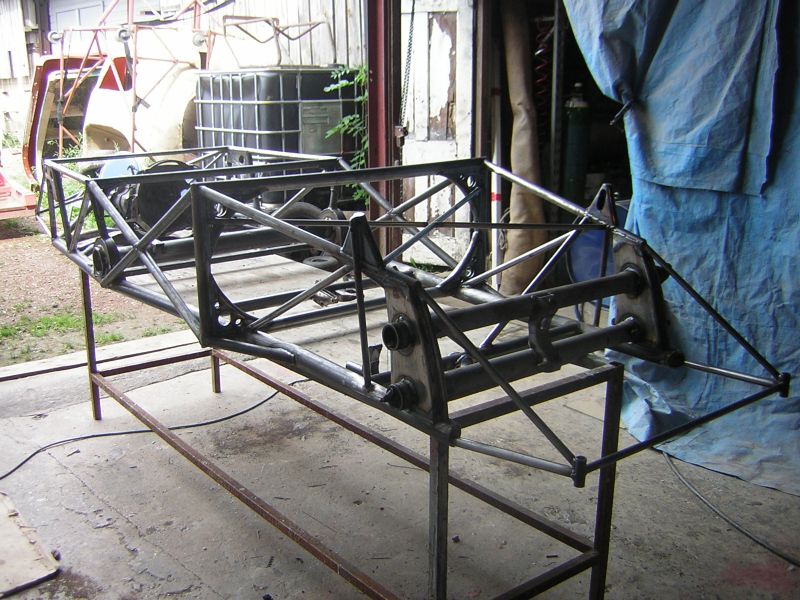

    Replica chassis......

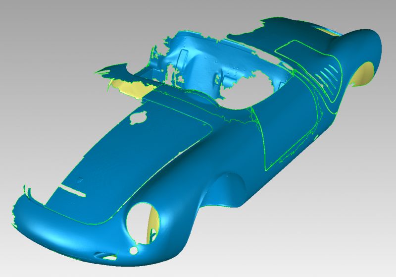

    and an early render of one of the body scan files.

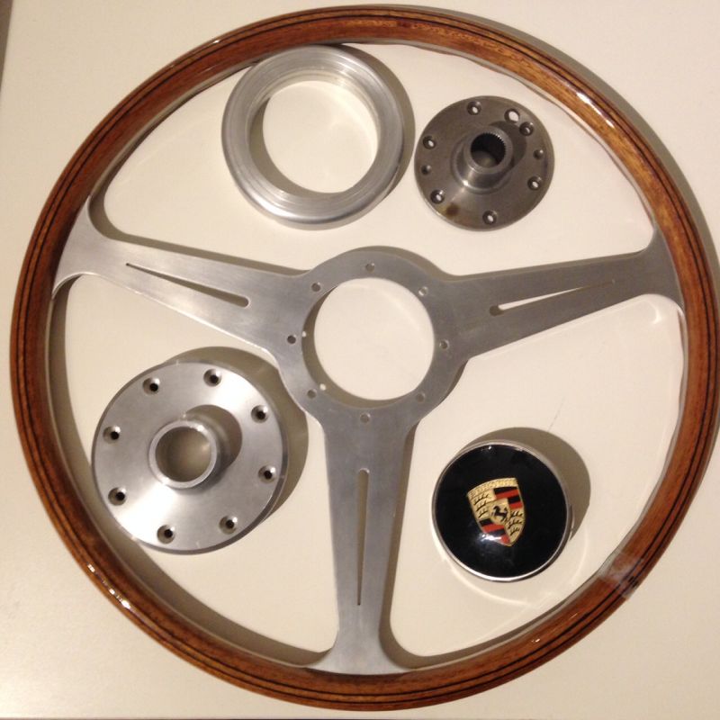

      A replica steering wheel geared up for a 356 steering boss.....
      There is a some debate as to where exactly the two inlaid dark strips should be......but this one was copied from a (supposedly) original wheel. ( and it matched the one on 141 dimensionally)
      Bodywork or details on 550s and 550As seem to vary widely ...... no two cars seem the same.

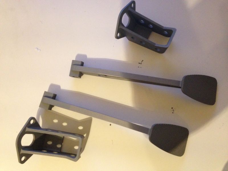

      And some pedals,
      The only problem with these is they are too good being CNC machined out of billet in stead of cast.
      I think maybe Ill acid dip them to 'round em off a bit'

          I'm an architect and a fairly good engineer. I did a good set of drawings of the Chassis. Those drawings were used to build a 3D model of the chassis to check it all. More recently a friend of mine went over and scanned the body. That scan was very comprehensively processed to remove all the errors in the bodywork. It was then mated to the chassis model. All good.
          We are building two cars, both replicas of the hard top Le mans cars. My friend has managed to find the correct windscreens.
          We could build a third as we go along. But it is not a cheap game.
          I am also making a vintage racing car and it sooooooo much less work. Apart from anything else (and there are lots of little bits and pieces to fabricate) the aluminium work is incredibly complex and expensive. I have toyed with idea of producing a Glockler type car - the aluminium work under the skin could be very much simpler and less expensive.

              Just about to do another steering wheel for my friend if you want one.

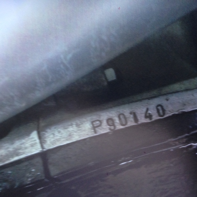

                        I thought the same until the owner contacted me. There are still a few things that don't add up, but there are some interesting facts like the original engine, even though it was removed during its racing life...

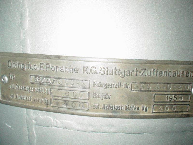

                            This is both exciting and interesting. The numbers add up (engine and chassis), BUT I know the last owner personally ... and according to him the chassis is still buried...
                            The engine was secretly salvaged by Paul's brother just before the car was buried by their parents. Paul's brother put this four-cam engine in a 356 which he owned for a few years after the accident. Apparently the 356 is still in SA...

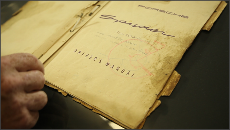

                            Below a photo of the original manual. Confirming the numbers...
