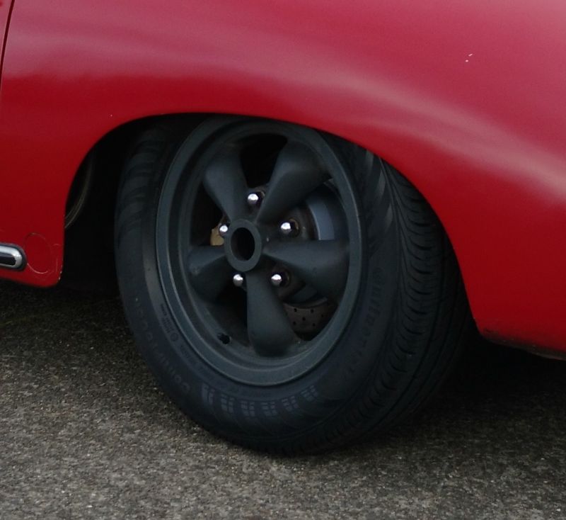

                        Geordie, those look like magnesium torque thrust wheels you're running. Can you post your profile pic so we can see better?

                          They are original Torque Thrust cast magnesium, I've had them since the mid 80's
                            Those are killer!
