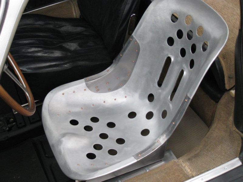

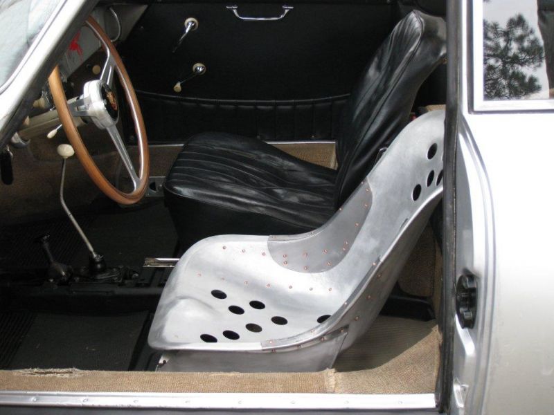

    Jorgen Anderson has just finished a run of his expertly crafted alloy GT speedster seats. If your interested you can contact him direct at: TeamGOG@telia.com some pics:

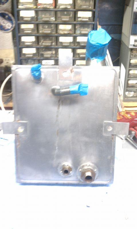

      I'm just starting on my outlaw build, which it going to be a 356A Carrera GT tribute with a 911-4 cylinder motor and independent rear suspension.
      I just got this Carrera oil tank that was made by Thomas Tate from the 356 registry -- should be a great piece.
      Anand
        Hello Anand,
        Thank you for posting and Welcome to our forum! Tom makes a nice product! Is it alloy? Sounds like you and I are building very similar cars. If you have a chance please share your build we would be very interested in following along with its progress!! Thanks and Welcome once again! Justin

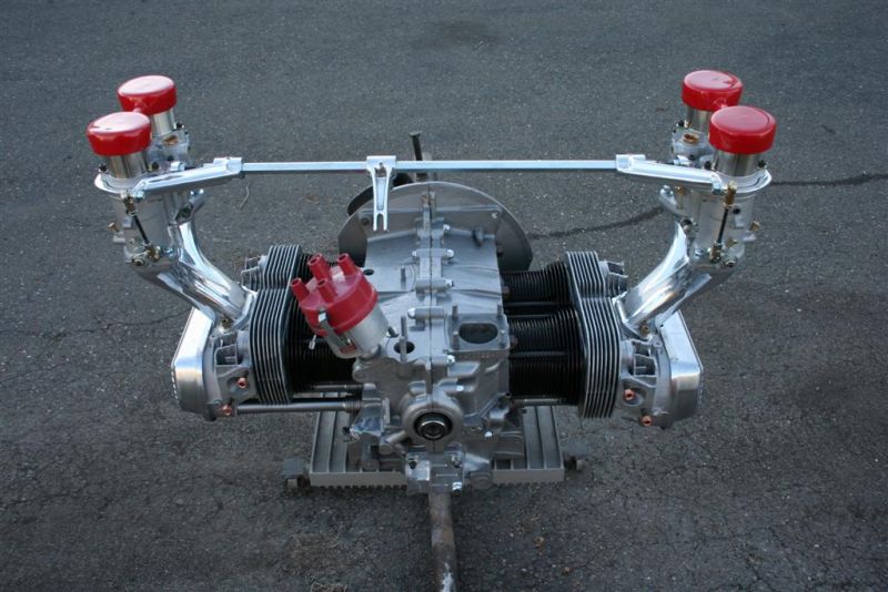

          I've got lots of great parts for my 1956 356A-I'll put up a post with a few photos on my car -- and the powerplant! I've actually got a Chuck Beck 911-4 -- one of the first ever made by him, pre-Polo!
          Best,
          Anand
            Thank you Anand, I am so glad you approve of the site! Your car sounds very interesting. I am very curious to see your "pre-polo" motor! Any shots and details you're willing to share would be great! Thanks again! Justin
            I believe this is Greg Banfill's punched-out type 1 motor...

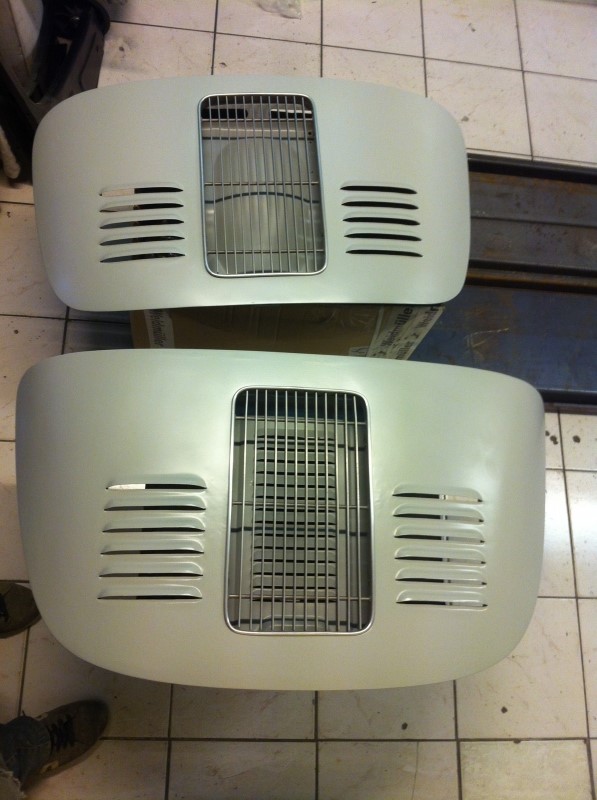

              A buddy just sent me this photo... T6 twin grille lid converted to single A/BT5 GT style. Note the remaining stock T6 louver grating under the centered grille opening. Like to see what it looks like on a car...

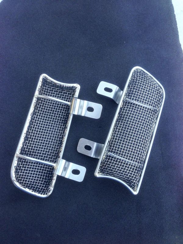

                Made stainless screen assemblies to replace the OEM horn grills. The install using the original screws in the original location.

                  Ashley, Those are really slick, I love the mesh screen look in there and the pocket shape is a really nice detail. You did a great job on those! I can definitely see you generating interest. I need an A-car version..
                  Thanks for posting these up!
                    Thanks Justin. Is the A flat in the area where the grill is? The C is compound curves in that area and the corners of the grill are different radius making it a little work.
                    Ashley Page
                      The A's are basically flat in profile but I do like that flanged perimeter you put on yours.
                        Thanks. The perimeter is made from stainless welding rod. The stainless screen is silver soldered on. The A looks like it would be much easier to do.
                        Ashley Page
                          Ashley, are you willing to make more? I am working on my brother-in-law's T5 mild outlaw right now, and was planning to make something similar, but your work is better than what I would probably end up with, and I wouldn't have to re-invent the wheel...
