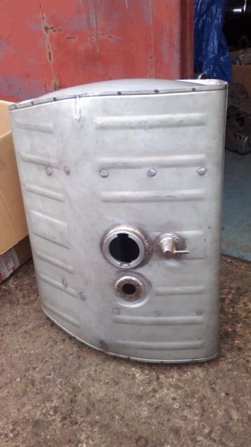

    Alloy replica GT 80 liter gas tank. Looks spot-on and no concerns of rust with this baby.

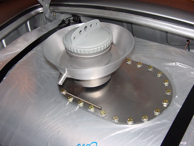

      GT style Through the hood filler neck and rain tray kit. Finned GT style gas cap.

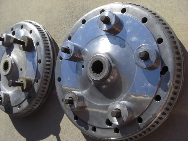

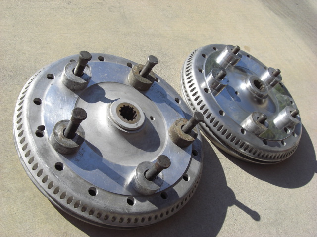

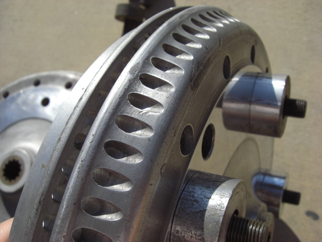

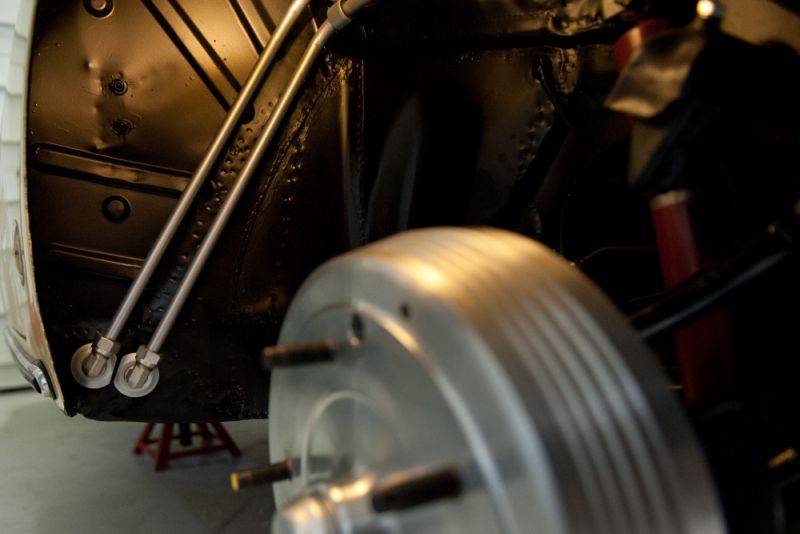

        Bought these off ebay several years ago. Just some stock rear drums that someone had machined out to replicate the early 550 Spyder lightening efforts. I added the GT studs and spacers.

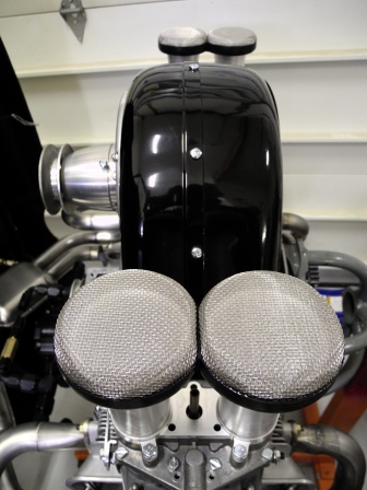

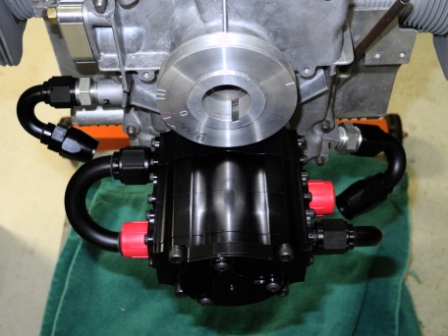

          Pushrod motor being built on a low hours industrial case. Ibrahim Kuzu 4 cam cooling system. Pauter dry sump pump. 1883 cc, twin plug, crank fire, 42mm intake, 42mm solex, Elgin 7208 cam. Mated to Skirmants 741 box with A nose cone and drum brake axel tubes. Custom stainless exhaust.

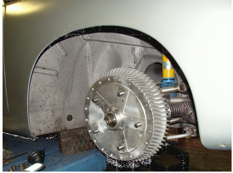

            GT Drums from Classic Parts in Germany. Carrera oil lines from Spydersports in CA.

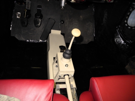

              Gumund race car style above tunnel shift set up from the late Ken Daugherty

                Bill, Thank you for posting. I was hoping for your input. You have so many cool parts for your GT Cab. I'm still blown away with the quality of the Kuzu fan assembly. Was Ken offering that shifter as a kit or is this a prototype unit. Who made those killer velocity stacks? Any clear detial shots of those pretty GT drum brakes and your backing plates? Thanks again! Justin

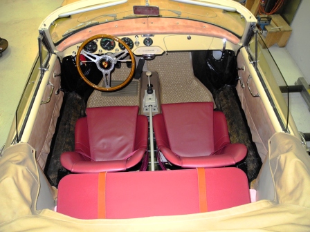

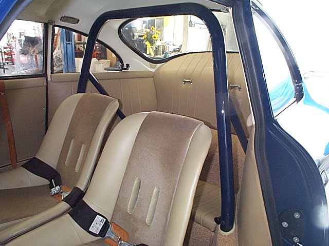

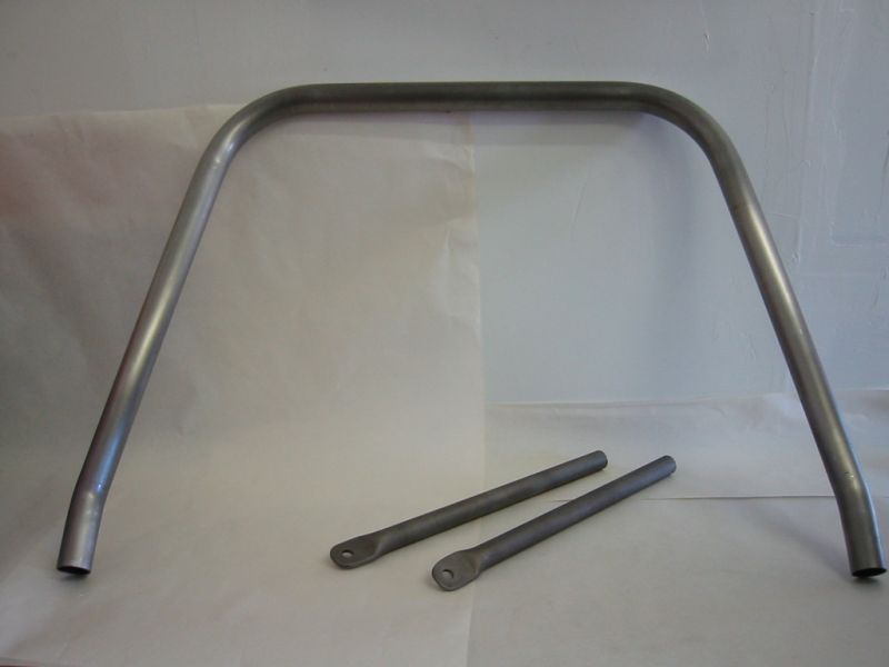

                Factory Style GT Roll bar.

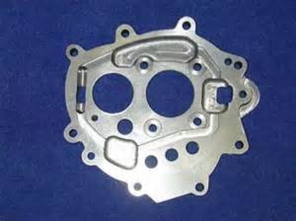

                  Carrera GT style HD steel billet intermediate plate for 741 trans.

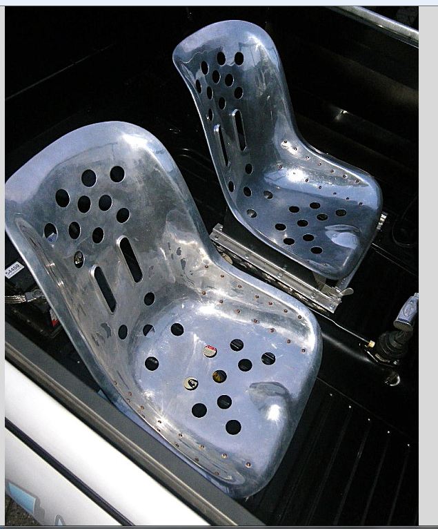

                    Aluminium seats by Karmann Konnexion England

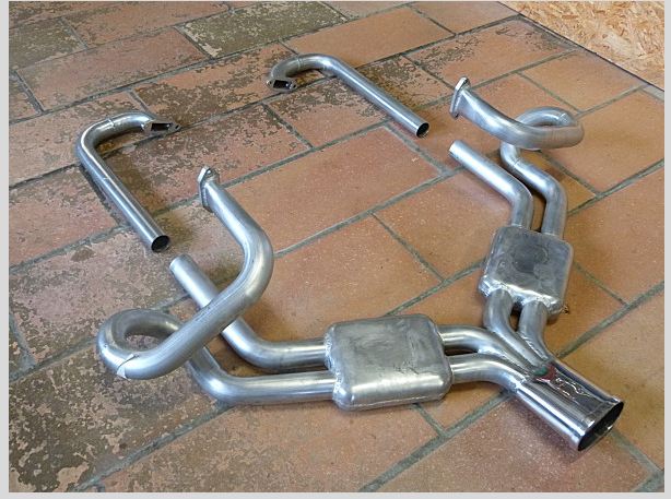

                      stainless steel Sebring type exhaust always by Karmann konnexion

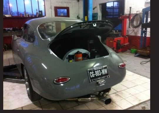

                        The same exhaust in my Porschinelle
                          Way cool parts guys! BTW what color is the car with the roll bar interior shot? Is that a P color or??
                          60 Coupe Outlaw Project
                            Hey Brock, yes, that is Porsche Bali Blue. Its an okay color but it has a bit of a milky tone or hue to it. My buddy here in town has a formula that he does all his "bali" cars in and its so much prettier.
                            Thanks Gerard, that is a great looking exhaust system on a pretty cool car! The repop Alloy seats from KK are the best I've seen!

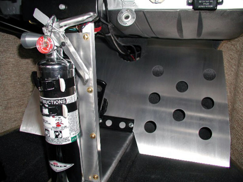

                              How about some cool punched alloy floor boards and gas pedal.
