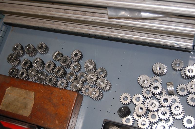

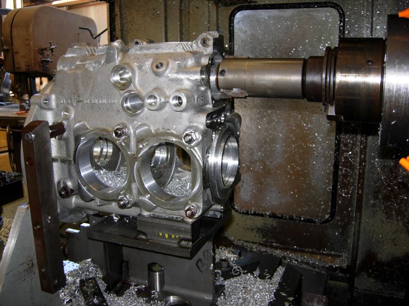

    someone clued me in on how to post pics this is one of my many projects to keep our cars running and vintage racing without the burden of damaging the original parts.
    Glad you got the picture loading thing dialed in Jacque. What exactly is this 4-cam case being milled for? Custom inserts to repair worn out bearing surfaces? Thanks for posting some of your handy work!
      Hi Justin
      we started off with a raw casting now the hard part will be to do the heads I just will have to figure out how to use 911 heads like Dean.

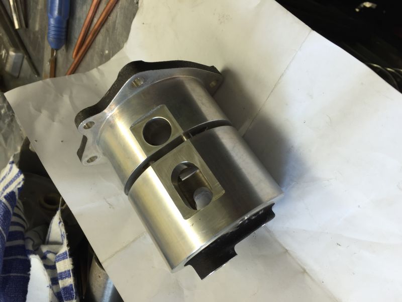

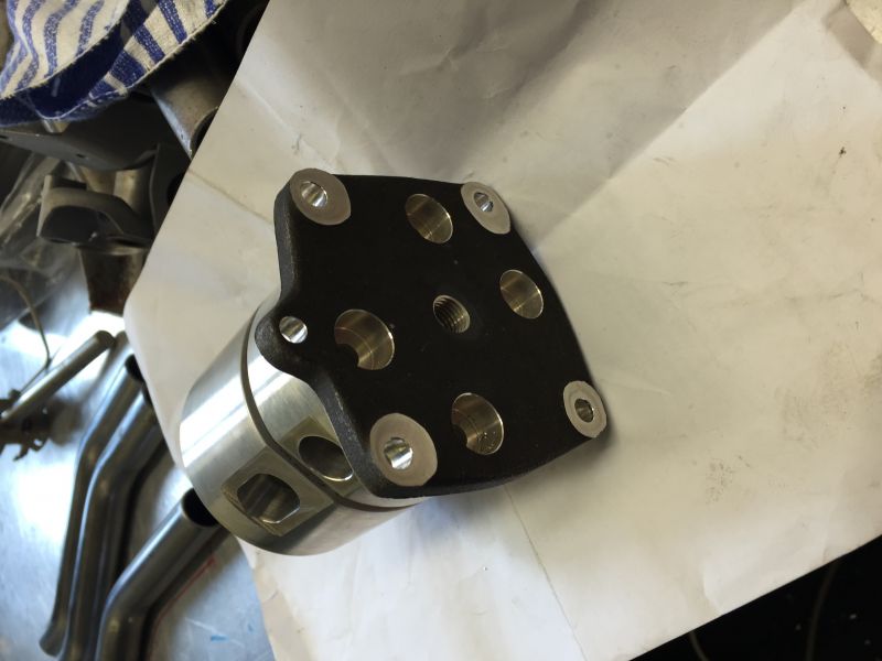

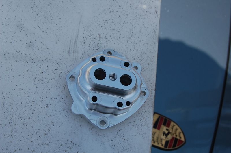

          WOW, So you're making your own newly casted 4-cam blocks!
          ...and new 4-cam oil pumps? Very cool! You're not casting new 4-cam heads but retro fitting 911 heads?
          Beautiful parts!

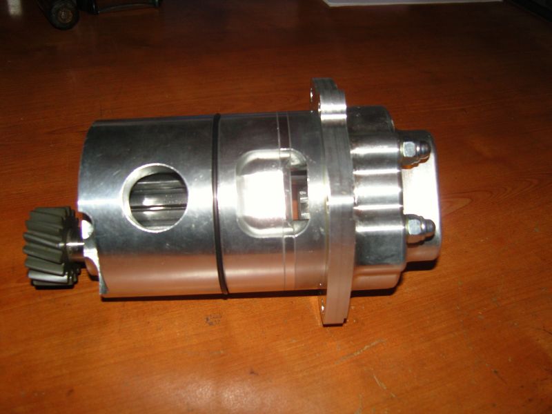

            Some cool parts I am involved in

              WOW! That is cool to see such rare and valuable parts being made available once again. Beautiful oil pumps! Any word if a run of 547 heads will ever be reproduced?

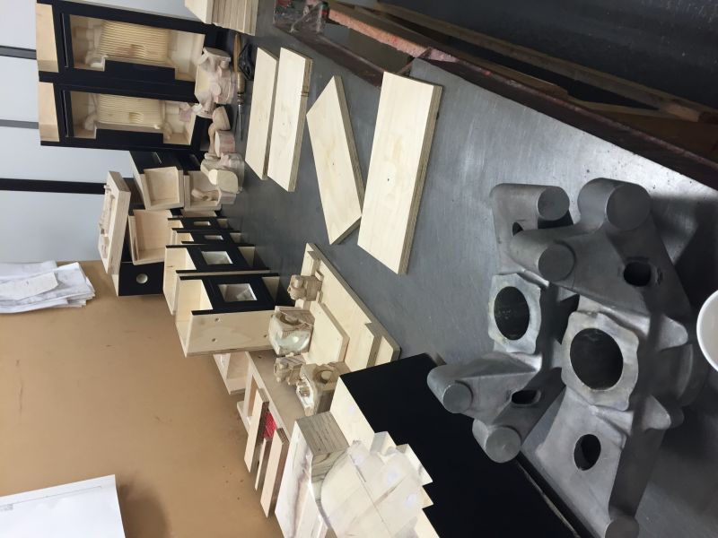

                  Hi making parts is a good exercise. the need can be for a unique situation when nothing is available. When i do the heads they will be honest that is not just a copy and improved the way Mezger/May would have probably done it. besides Joris' effort now there already exist heads by Capricorn also the following are involved in the effort https://www.facebook.com/BenColesHistoricRacingComponents/ i think the other set of heads done by the 3D method is more efficient http://www.voxeljet.de/en/case-studies/case-studies/reconstructing-cylinder-heads/
                    Jacques, making parts is a good exercise indeed.
                    What do you mean by honest? And how do you know that we are not incorporating improvements into these heads?
                    Ben, who's facebook page you link to, is my partner in this project. he has a long track record of making NLA parts for both Porsche and Ferrari to a very high standard.
                    To each their own, as you know I am a purist. I do not like the texture 3D parts give a casting. Our heads are done the old fashioned way. While the upfront cost are much higher the variabel cost per head is substantially lower compared to the 3D printed option. Our head will have all parting lines in the original locations and original markings. Down the road we will offer improved port design and possibly smaller chambers for those people who like to push the performance envelope.
                    I look forward to seeing your heads. I think it is a huge benefit to 4-cam owners that they will have various options. Also, competition will drive down prices which should benefit owners also. I can tell you right now that our price wise will be superior to any other option currently available in the market.
