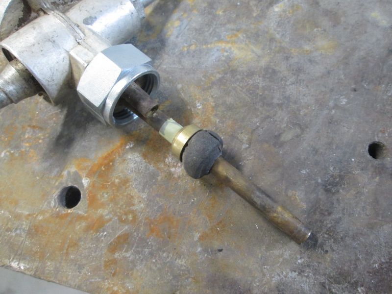

        Hi Thomas,
        Here is what the collar looks like. Again seals off the lower reserve tube so it will draw through the scavenger tube.

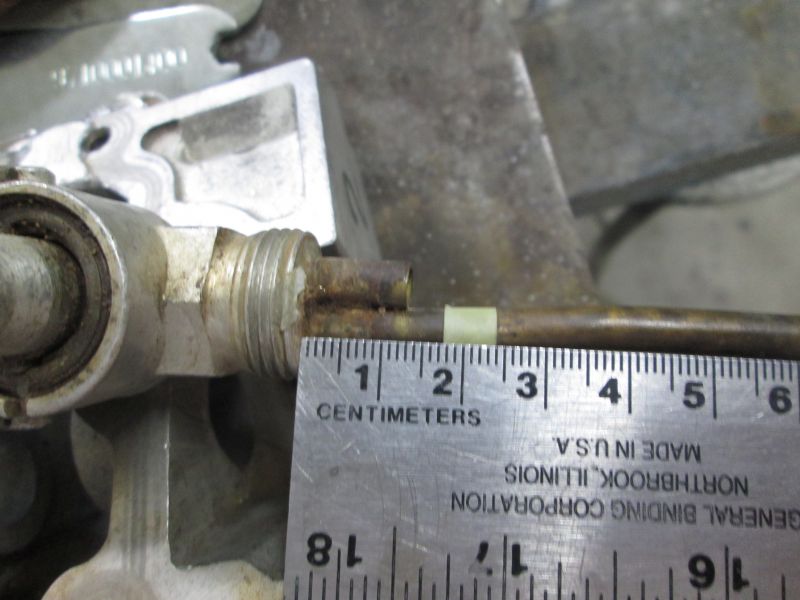

        I had a couple of copies machined some time back. I marked the original height with tape and I can get that for you later today. What's more critical is your seal thickness to ensure a crush fit once the pet cock is fully seated.

        Here is the old rubber seal I found with it. Pretty sure its original.

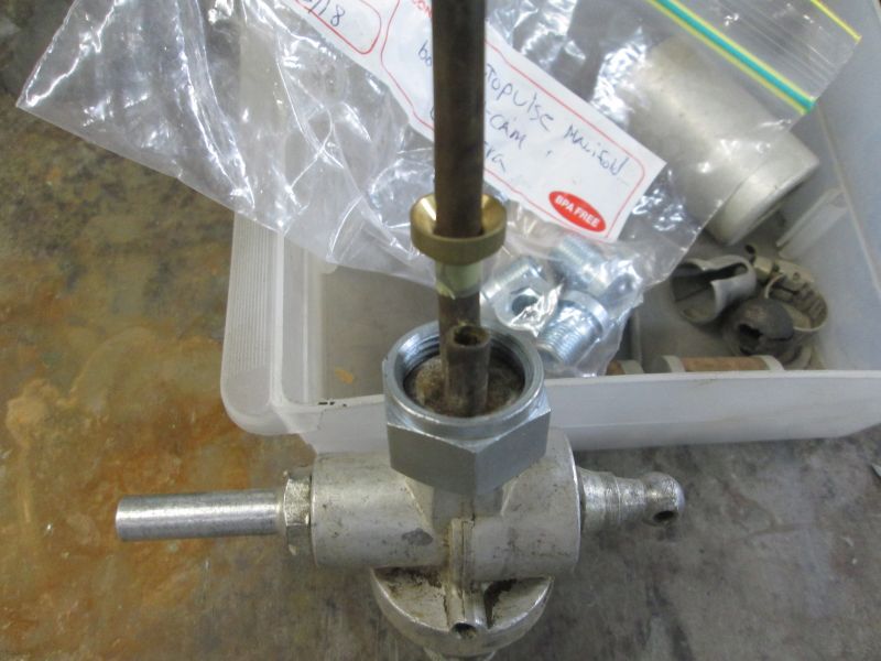

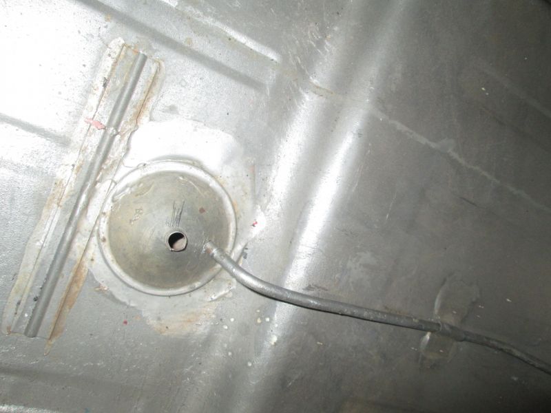

        A shot of the housing and scavanger tube to help illustrate.
        Hope this helps.

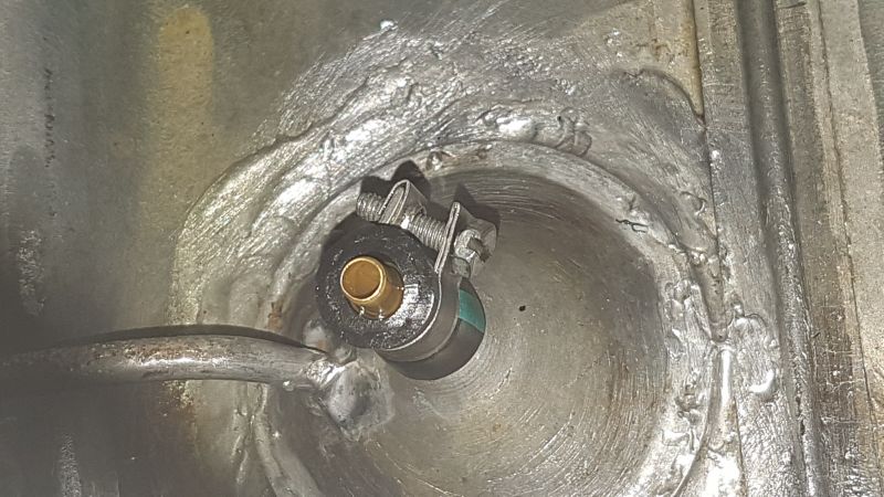

          Thanks that helps a lot. The last years I just had a standard fuel cock with a small fuel tube from the top. See my picture. This had worked too but it's maybe not safe enough.

          What kind of seal do you use?
          Thomas

            From the base to the top edge of my tape is right about 29mm. The thickness of your seal however is going to be the determining factor as to whether its in the right spot or not. Not sure what I was going to use as a seal but after looking at your setup a section of hose should do the trick.
