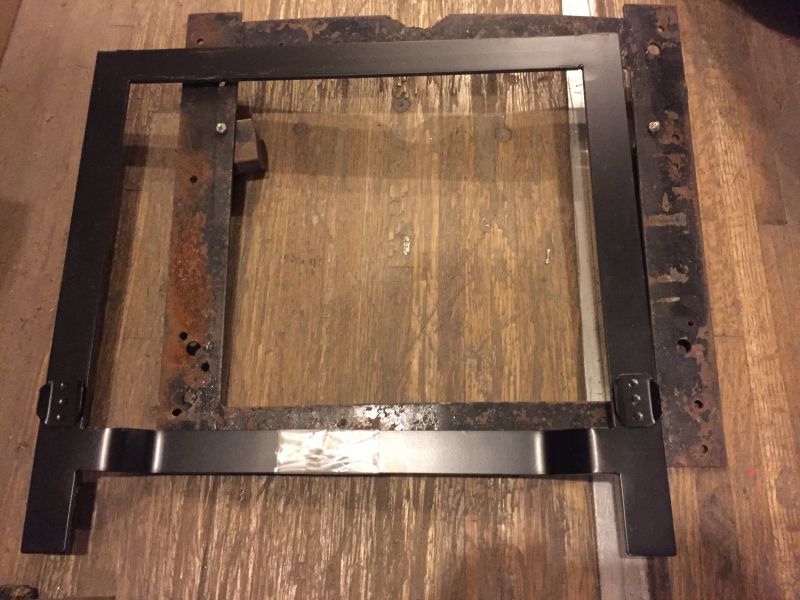

    Pictures of the seat tracks or the metal base frame?
      The metal base frame- the part which attaches to the seat, not the floor.

        The under-frames were indeed 'home made' and the tracks on the bar stock were ripped from the sheetmetal pans of the original 'stock' seats that had come with the car and were stored away. I was able to provide very nice original seats, complete, even before the butchered originals were found.
        The tracks previously on the original seat pans were installed to fit typical T-6 rails on the simple flat stock frame, a la the wood frame under the earlier Speedster seats.

        The one under the typical safer metal option is a home-made frame from a Speedster and used to lower the seat
