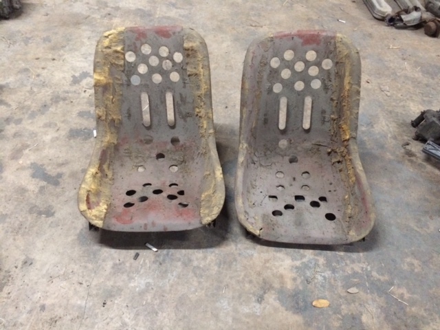

    Do these shells look correct? Your comments please.

    The top pair, seat back hole pattern is what I remember, not the evenly spaced 2-3-2-3 as in the single seat in the bottom photo
    Thanks
    Michael Doyle would be the one that could give you a definitive answer as to any differences between an early steel GT seat and the standard Speedster seat if there are any. I'll forward him a link in case he doesn't see this.
      This may help:
      The one single seat is a '54-'55 356 Pre-A Speedster steel seat shell. The other pair are '56 356A and later steel Speedster seat shells.
      The Pre-A seat can be recognized by the defined top corners of the seat back. The later are more rounded at those locations.
      In early 1957, the 356A GT Speedster & GT Coupe began production and both used the basic steel Speedster seat. There was no "GT" seat.
      In the 1958 GT production, an Aluminum alloy seat shell started to be used in some of the cars.
      The upholstered appearance of the Speedster seat changed little other than the more rounded shaped at the front of the bottom seat pad in 1958. Was more angled before then. Many GT models featured "Cord Samt" (Corduroy) inserts.
      During the 356 B/C time period, GT models did have a different upholstery feature at the top of the seat back with an unique finished Vinyl wrap over the top edge. Also, a longer bottom seat pad extended under the legs further. Some wider width seat shells have been documented as well.

          Thanks so much for the info. The 356A pair is going into a speedster that is in work now. Its been a long time and I was young and stupid the last time I messed with these type of seats.
            That's great you have the car that goes with the seats!
            Notice the prior upholstery job on them had glued on aftermarket foam on the sides. Not the correct installation. I do all the original Reuters materials and install methods now. Basically recreate the Speedster seats including the Horsehair pads.

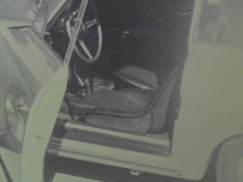

                      This is the only pic I can find of the steel driver`s seat in my old 62 Carrera. The bottom pad extended further out, and I remember measuring the width of the shell, and it was wider than a standard Speedster steel seat. I owned a Speedster at the time I had this car. The seat was in original condition.
                      [attachment:1]SAM_3116.JPG[/attachment]
                          Thanks Bill! Is the steering wheel a VDM or LL?
                            The wood wheel was a Carlotti
