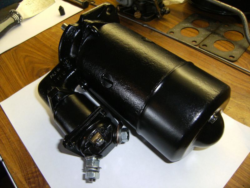

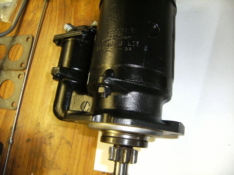

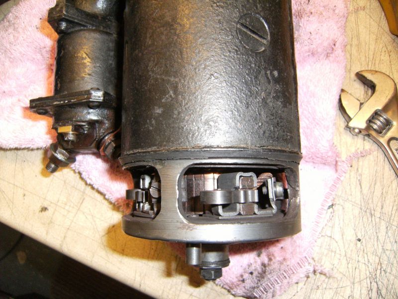

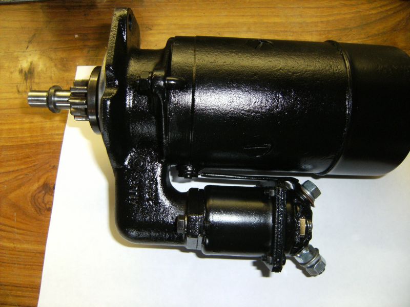

    1 - 3 These are the pics of Rob's efforts which included taking off the solinoid cap with the rivets and inserting screws and nuts. The interior of the solinoid and its 3 copper contacts were very poor. they are now good. He changed the brushes for new and sent me the old ones. There were 4 brushes? I thought my motor had only 2. Phil please look at the photo I took 2 years ago and advise me if it looks like a 4 brush set?
    There is a photo of the solinoid still on the motor when I removed it from the car. I can see the heated up bottom connector. It had welded itself to the washer and he cut the nut off. He sent that back too!!

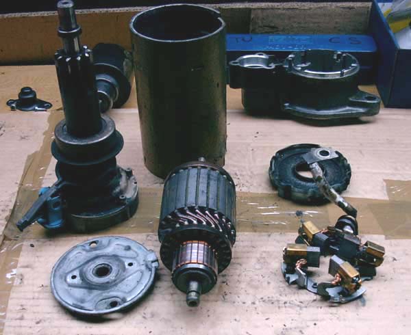

      Great news Roy, and thanks for all of the installation tips. Is the first picture in your last post the 2 year old one? I see no others in this topic.. If so, that is 4 brush version.
        Phil,
        That is the pic I took about 2 years ago of the motor brushes, I can see 2 brushes but not 4. I am bemused by that. I don't see where the other 2 brushes go. I have the 4 old used ones and the old cut off nut and washer its was welded to all returned. I never took off the end cap before sending him the motor so maybe I just missed seeing the other 2 brushes two years ago??

          Maybe this will help:
            Phil.
            I guess a couple of years ago I did not see the opening under the back cap for the 2nd set below the top ones! I know I checked the brush length at that time and it was okay. I must be just confused/ Thanks Phil for the layout of the later 356A starter. I have never seen that before only the previous 2 brush version.

              I can say the motor is now perfect as good and fast as my BMW 12 volt. You have a 57 A. It will have a 2 brush system and I think the exact same solinoid as mine. The end cap of the solinoid is riveted on and inside this are 3 copper contacts. The bottom contact carries current through the flat copper strap ( on the lower solinoid threaded stud ) to the starter motor outer casing and then into the field windings.
              In my case that stud had got so hot it welded the connections of that stud together so it had to have the nut cut off!!
              Problem was the condition of the lower copper contact inside and the other remaining two contacts. They drilled out the rivets replaced with nuts and bolts and made the copper contacts like new.
              The armature and field windings I thought would be poor were perfect. Remember, I had already changed the transmision bell housing bush, they changed too the rear bushing and put in 4 new brushes, the commutator was good. All those things as well as perfect earths from the battery and the transmission to body are important.
