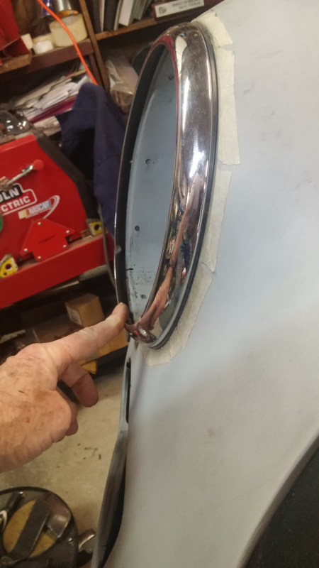

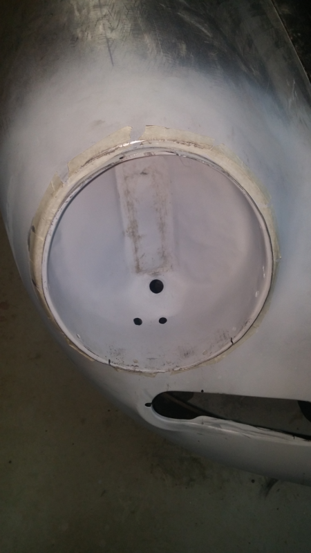

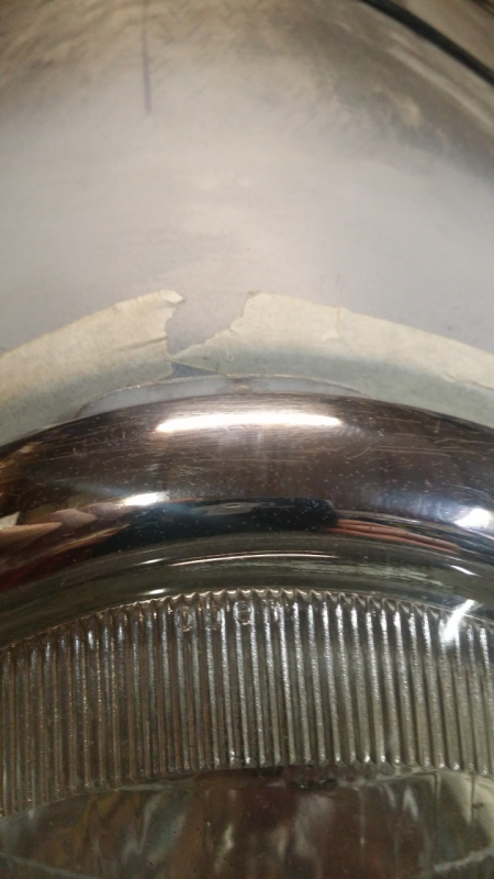

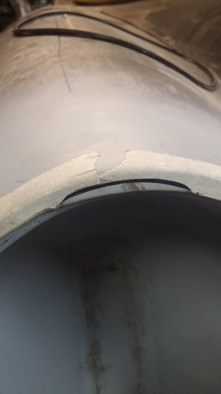

          By pulling out bucket at bottom, I got the drivers side nice an flush. Passenger side is another story. Both original headlight assemblies fit drivers side, and neither will fit passenger side. I measured the flange for retaining the top of the light and drivers side was .025" lower. Looking at the inner rim you can see a shiny mark from the flange. If I install passenger side on the bottom first and push up as far as it will go, the top flange protrudes above the rim:

          This does not occur on drivers side. Original bucket in NOS passenger nose. Bucket went in much harder than drivers side. Figured okay, lets lower that flange some, so made a mark to gauge how much metal I remove:

          After filing down as much as I dared, the flange was now below the rim when pushing up from the bottom, but as there is a lip clear around the bucket, in order to install the light after hooking it over the flange it must clear the lower lip, which was interfering. Flattened out the lower lip about 2" from bottom on each side and headlight "snapped" in place. AHA. But wait, now I can't snap it back off. The can't open hood problem of headlights.
          Did some gentle prying here and there with no luck so called it a day. Worst case I will have to drive the bucket with light in it out and work on it on the bench. In my next life I will test fit the light prior to installing the bucket. At least then I will know if is caused by the new opening in the nose.

                  I'm assuming that the NOS nose bucket hole is slighty more elongated than the original one and this elongated the bucket making it impossible to seat at the bottom. Probably why it was so hard to drive in, and impossible for me to drive back out.
