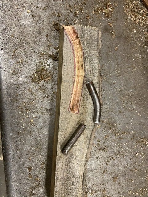

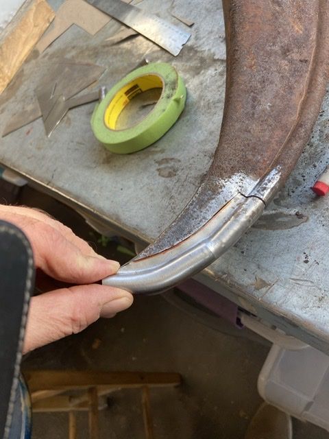

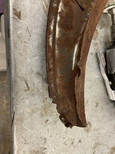

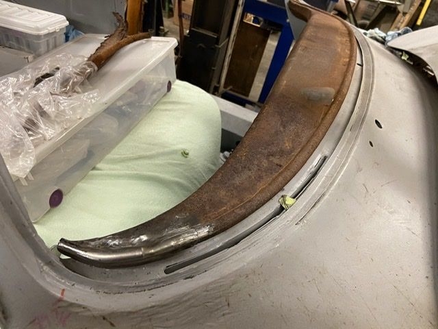

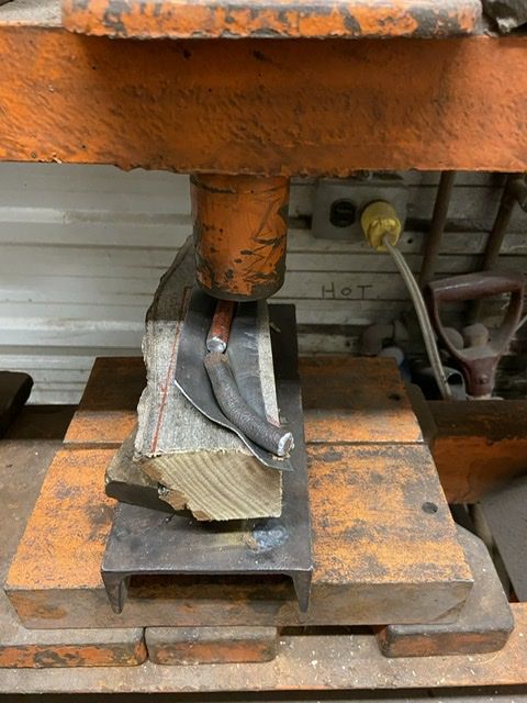

          • Thanks Roy. Took a short diversion to repair rusted padded dash metal frame. Router and block of wood provided the shape and some metal and a press turned out the replacement piece.

              I've tried that repair before and its a really tough shape feature to replicate. Nice job on that, I like the carved out hammer form idea.
          • Nice repair. Great to have a few woodworking tools.
            • Yes Scott nice thinking there, with thought you have made a nice looking repair bet you were pleased with that!
