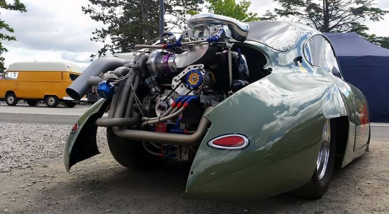

                    Seth, you could just drop it on a VW pan and go racing much the same way this guy was built.

                    I'm with both you and Neil, a big Type 4 motor is the only to go. If I wasn't building a polo-motor for my coupe a type 4 would surely be going in its stead.
                      Thanks for all the info. Any other info on that green one with vw pan

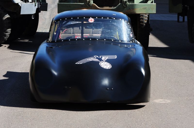

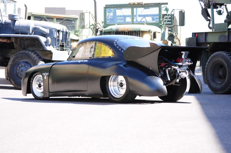

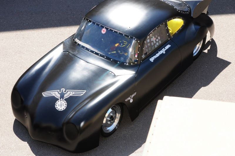

                          I spoke to the guy who built it several years ago(who sent me the pics below) I'll see if I still have his contact info. This is what it looked like before he sold it.

                          Its a big window T6 coupe like yours but with an A-version fiberglass front end.

                          I saw one interior shot of it which clearly showed it was on a VW pan.
