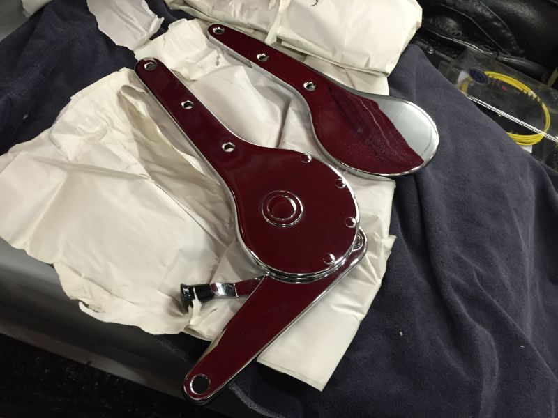

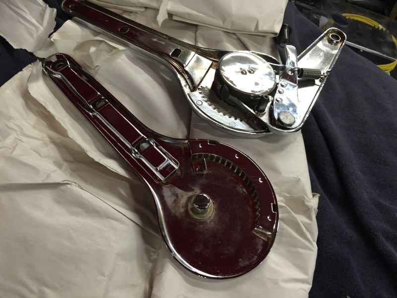

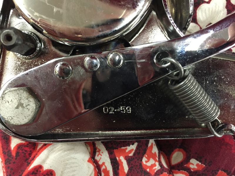

              Jay, I was imagining B seat recliners having the inner covers snap-ringed together on posts which slightly protrude through holes. The pictures below show an A recliner and a date as struck on that set. Those go on a '59 Cab. Another shows the early and with the separate pivot/washer the late version with the smooth exterior.
              Sorry for the confusion. Happy tool-making. BTW, I ground a taper on a Sears 14mm socket to get to the hardware in the recess. No 'regular' socket or wrench would fit.
