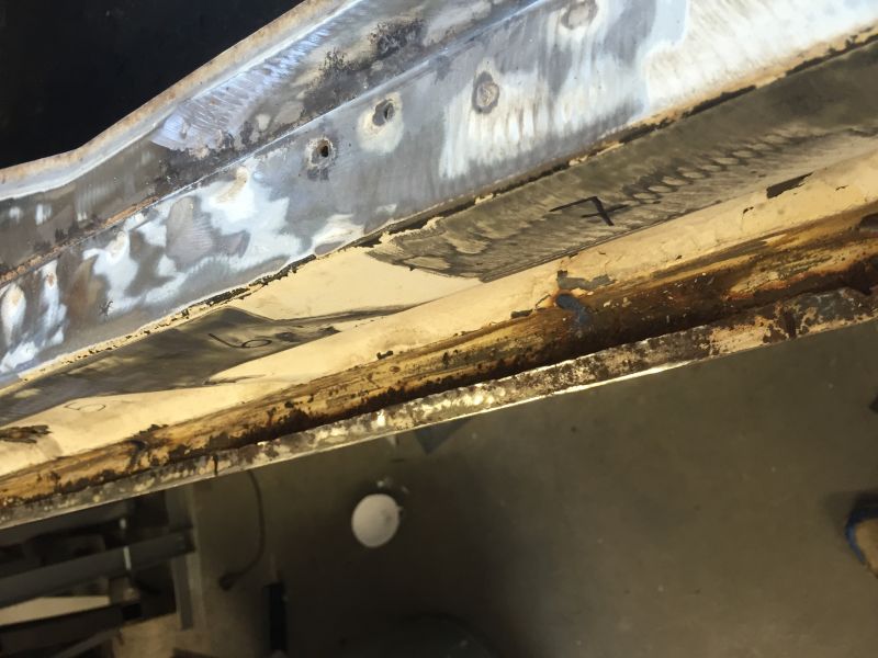

        This flange rolls right around the corner on up the edge of the fender to create that pinch seam for the edge of the back of the fender. As the flange makes the corner and transitions from rocker/drain pan to fender there is a bit of a gap left as it crosses over. I hope this is the info you were asking for. Justin

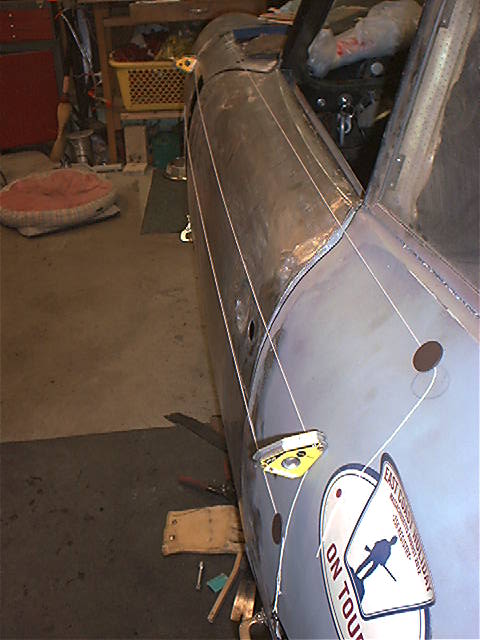

            • #96
              Might have been this one. Bruce Baker does not do this but uses a long slat. I have done that and don't see much difference. Hopefully Bruce will chime in now that he is done cat sitting.

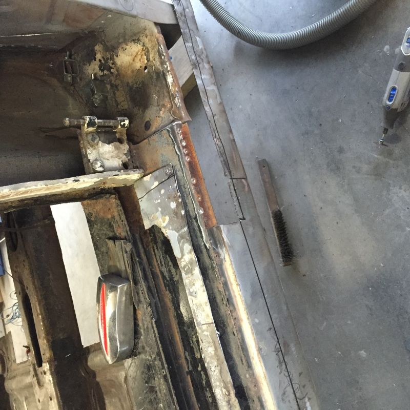

                All you're looking to do is to continue the door line and shape profile consistently across the jamb onto the fender. Don't trouble yourself with any "factory spec" type profiled shape. All that matters to your car is what its door profile shape is saying. Locate and mount your doors in their shimmed and fully latched position (don't forget to add in the door seal while you're at too) then build your rear fender sections off your fully set doors. Hope this helps and that I understood your question correctly. Justin

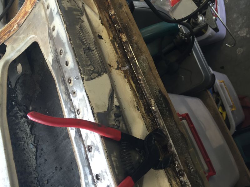

                    Jonesy, you are Very lucky to you have Jason and Luddy so close by!
                    Two unbelievably talented craftsmen! I was fortunate to have them help me with my fender one fine afternoon a few years back.
                    Glad Luddy's got you on the right path, tell them both I said hello!

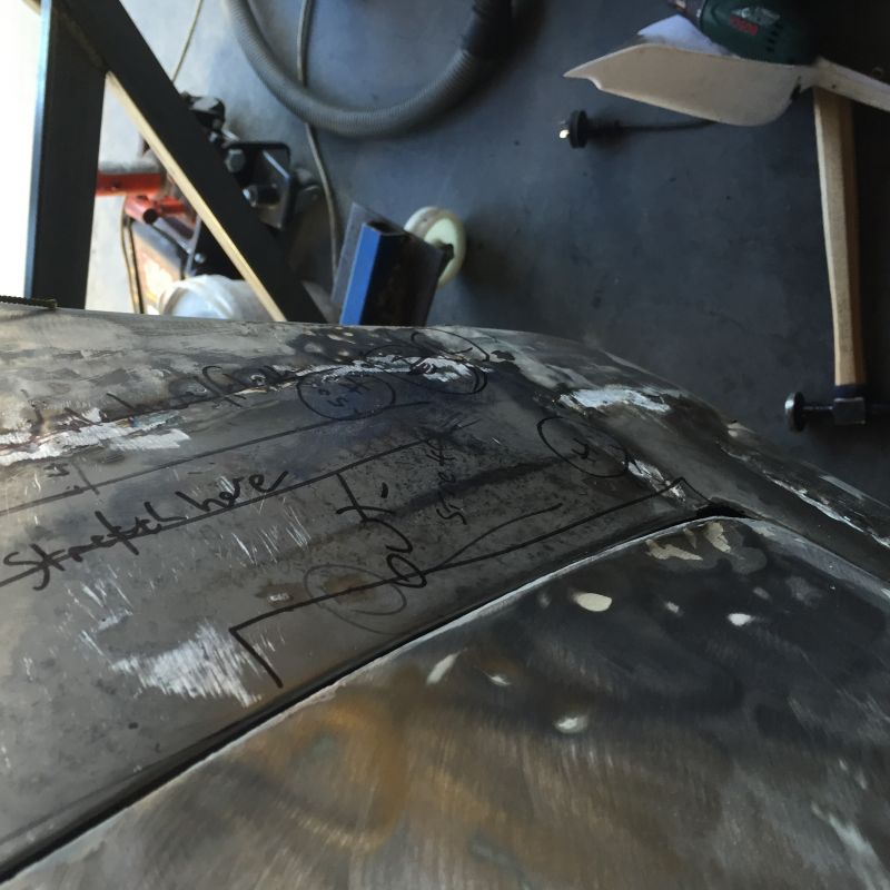

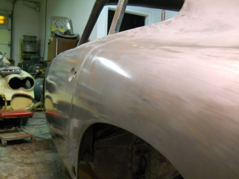

                            So the story in the last few weeks has been the area in between the front of the door and the rear of the wheel arch, on the right hand side of the car. I made a rookie mistake and ass-u-me'd that the previous guy had done the job right. So I matched the curve of his repair when i cut out all the crap and made my replacement. But after I had it in it just didn't look right...
                            When viewed from above it was too rounded. The flow of the gently curve from the front of the car to the back of the car was broken. So I have to redo it. I'll make it flat. But before I do that I have to fix my door. The curve at the rear of the fender is good, even though the curve of the patch is too convex. The door, particularly the forward edge, needs to be fixed before I try to get the lateral position of the next patch I do right. I know I was supposed to do this first (according to Ron's book) but I had my reasons for doing it this way. Anyway, the door...

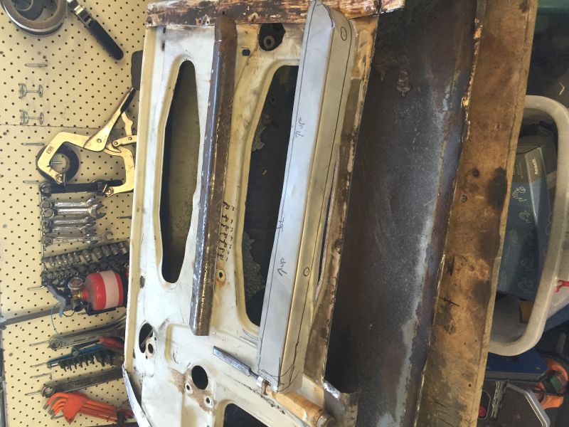

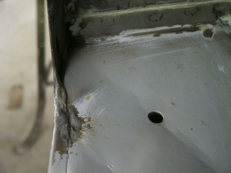

                            • So I drilled out and cut the bottom panel, and bent the seam/fold at the bottom of the skin...
                              Note the funky tool I made...now where did I get thay bright idea??

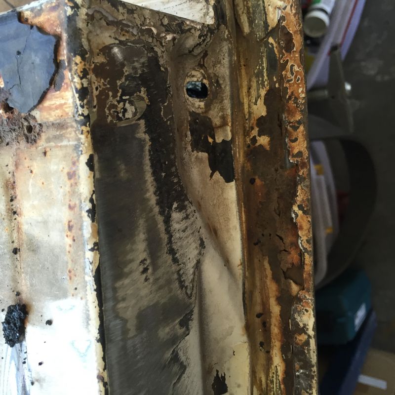

                              Glad I pulled it all apart. It was a typical one step back, one step back type deal...

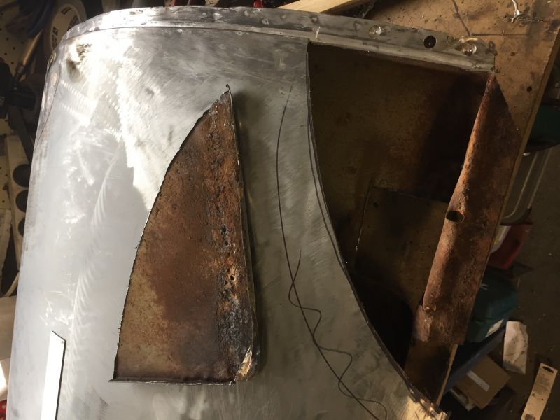

                              I had to cut a section out of the skin...

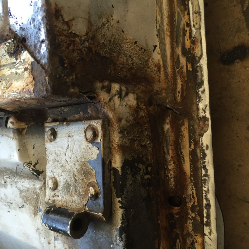

                              • Tidied it all up - plenty of grinding, rust converter, and had to make a patch...

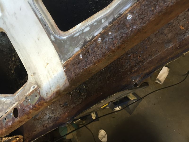

                                This is about where I am at, although it has zinc paint on the whole thing. I have made the patch for the skin and am waiting till the right time to weld it in. Meanwhile, have been making patches for the forward sill/rocker area

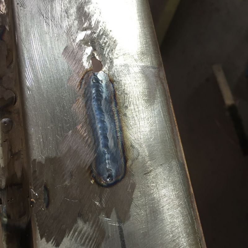

                                Some of my TIGs are actually all right...
                                More often then not, though, I have to 'rescue' them with my MIG, then just accept the subsequent grinding. I've a while to go before I'd call myself OK at TIGing, but I really like it.
