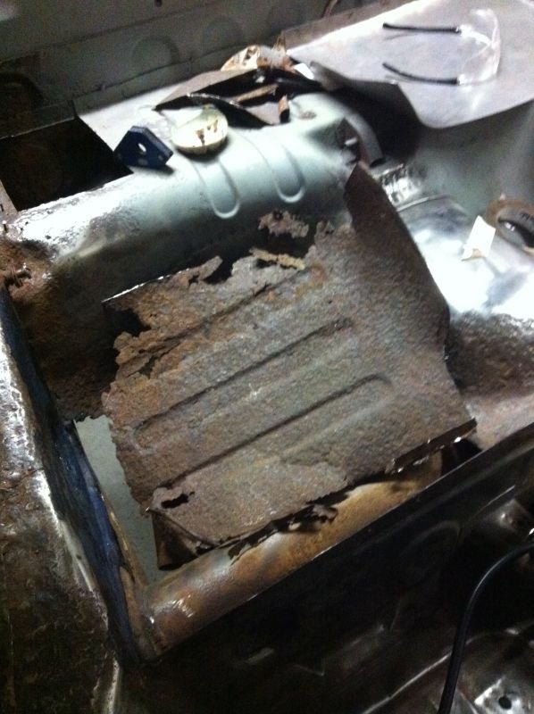

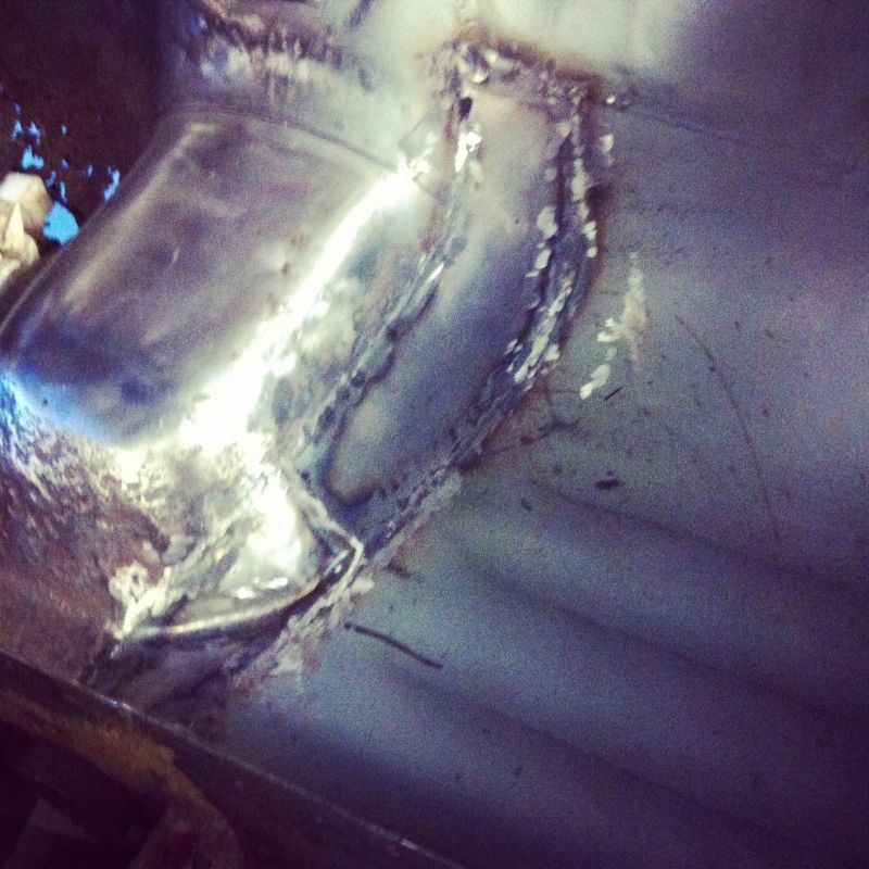

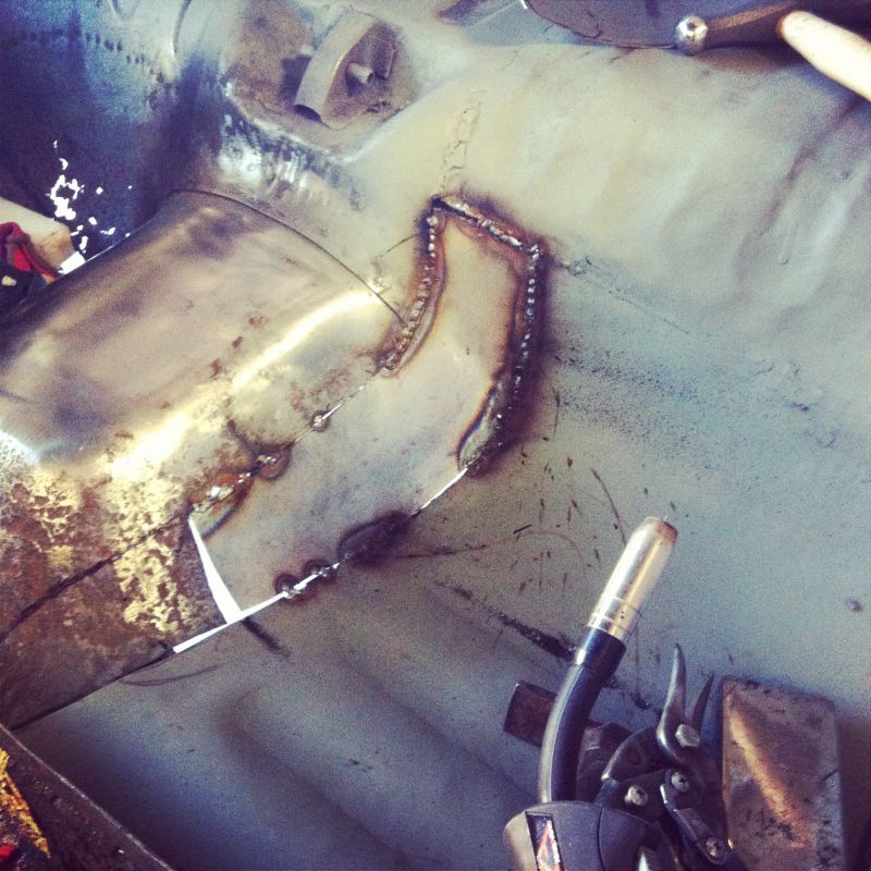

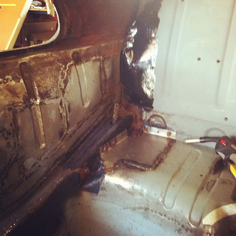

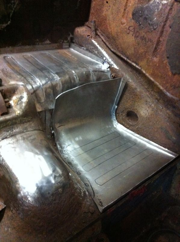

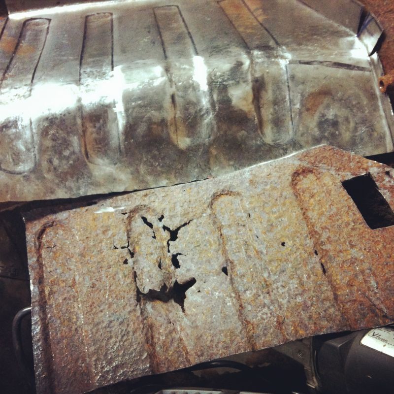

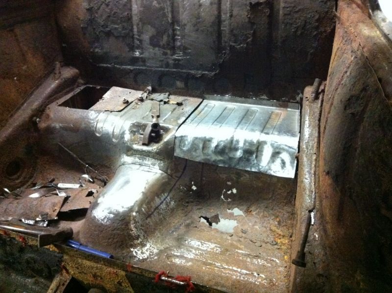

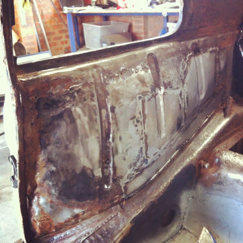

                  OK - apart from stripping it the main body work I have largely finished is the two rest seats and surrounding areas. They're expensive, and hidden, and curvy - so I thought these would be good characteristics to prompt me to make my own. This is the journey so far...

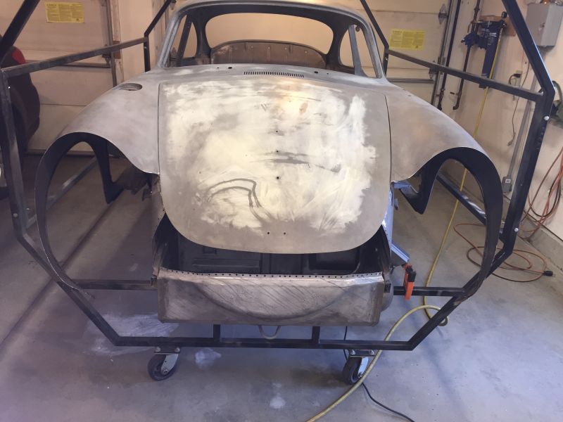

                        So that's about where I was in about October. I then thought that the chassis would be strong enough again to enable mounting on a rotating frame. I borrowed the plans kindly shared by Restoration Design an mounted it up. A nervous moment when I first turned it over, but all went well! Doesn't it make it easier! Everytime I went and saw Jase the first thing he would always say is 'have you made a rotisserie yet?'. Now, I understand.

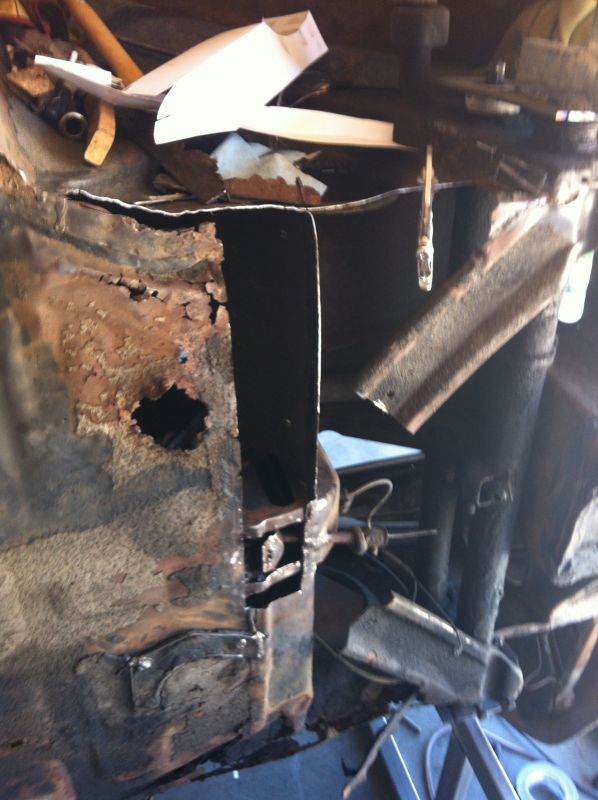

                        So the next phase is the vertical panels that support the front torsion tubes. I was thinking about making a new front floor panel from scratch, but when I saw the complexity of the different panels joining at the bottom of the pedal board/floor/torsion support wall etc, I though I needed at least one good reference panel. I'll take some panels you'll see why...
                          This is where she is today. I have removed as much as necessary of the TT support wall, the pedal lateral wall, the floor pan and of course the 'longitudinal extensions' (that I note from another post weren't included on earlier cars...didn't know that. I plan to make them based on the plans supplied in Roland's book...the templates I have made fit well).

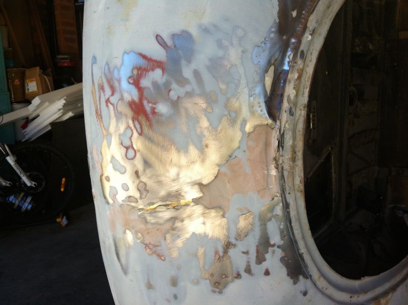

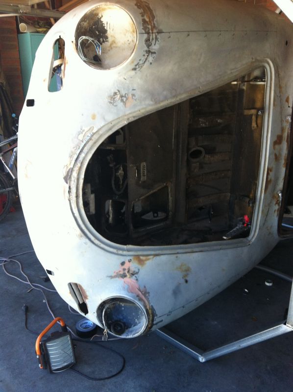

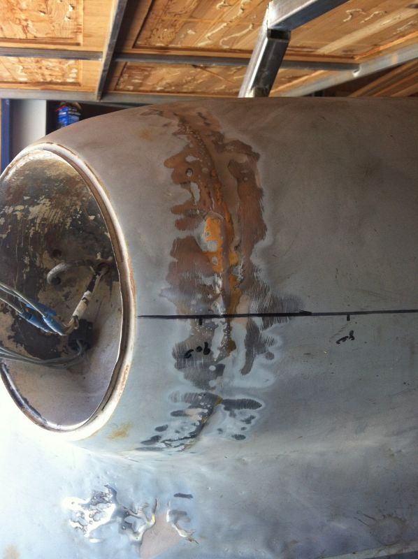

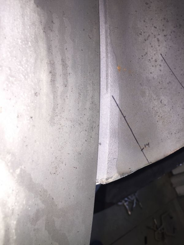

                          My next big headache will be, as mentioned, the nose. Overlapped and brazed. Who does that?
                            Some basic measurements along the zenith line of the 'fenders' tells me that the headlight buckets weren't even in alignment. But looking at a few of the posts here, maybe that's how it cam out of the factory!

                              Does the lower lip (flange) of the TT support wall run in a straight continuous line from the longitudinal all the way to where it joins with the V-shaped member? Mine is so rusted and bent on both sides that it is heard to tell...

                              How do I pull the nose apart? You can see it has been done in two pieces and joined roughly in the middle (i.e. a rough job was done and it's approximately central to the car ) - what is the best way to attack the brazing? I have a gas set (oxyacetylene).
                              What do I do with the headlight buckets? I know they were an interference fit and I have had a few bangs on mine with some subsequent flexing of the nose metal that they are attached to. There may be some small tack welds holding them in. But I am thinking I could cut about an inch into them and leave the resulting 'hoops' to help support the nose as I pull them apart. Then re-weld them back on later - obviously they are unseen. I should mention that I plan to re-use these nose halves as I believe that there is enough overlap to allow this.
                              Thoughts appreciated...thanks in advance, Jonesy
