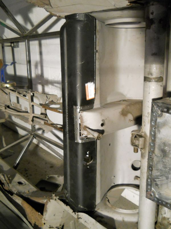

    Here is a shot of the forward bulkhead you were asking about:
    This is on an "A" chassis but they are all the same here. The sides are recessed shouldered and rest directly on the inner flange of the frame runner.

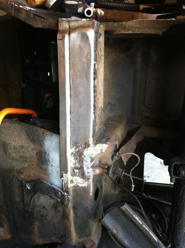

      Thanks mate, that last photo confirmed a lot. Hand formed this patch panel and started to weld it in...

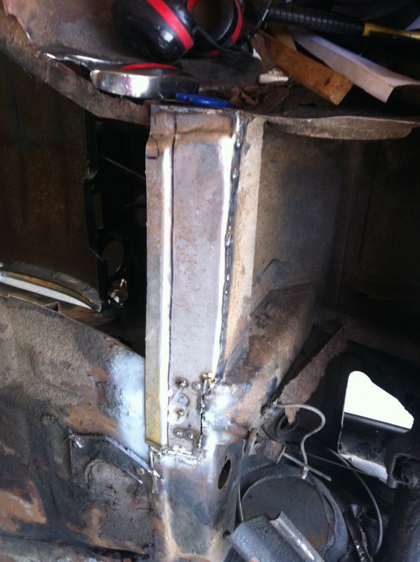

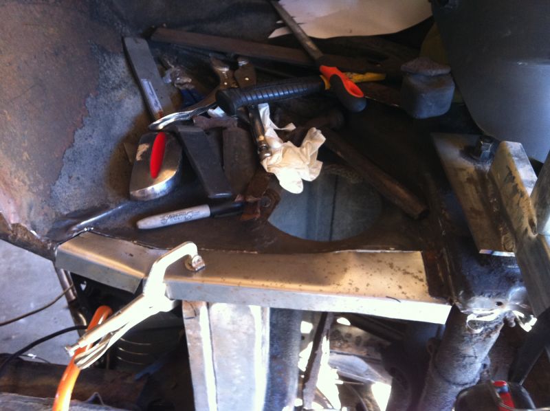

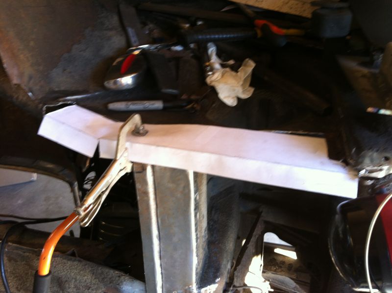

          Bit more work this afternoon - mocked up the next patch from cardboard, transferred to steel, cut and bent. This is the RH lower torsion tube vertical support wall, the bottom section of it was rusted and smashed into a twisted mess (likewise the LH side, it's next). I don't have any fancy tools, so I just used a piece of angle iron, a bar and a few clamps as a bender, with a solid planishing hammer working the bends overs slowly to form the flange. Still a bit more work to make them sharper. I don't have a stretcher/shrinker so for the bend in the flange I just cut this one and will make a small patch and fill it in when the piece is solidly mounted to help with warping. I am using .6mm wire with the voltage and wire speed rates changing based on the metal I am welding to. I need to get some more gas to press my oxyacetylene back into service. Cheers, Jonesy.
            You're on your way Jonesy! I don't own stretcher/shrinker jaws at the moment either so relief cuts in the flange is the only way to make those turns. Keep chipping at it! Justin
              Justin, thanks for commenting. It's motivating (as I'm sure you know) to have someone watching your efforts. I am on summer holiday now for a month and will try to continue with my 1 hr per day minimum. Hopefully I can exceed that! How reassuring is it when you finish a piece that was previously just rusted junk, and ends up strong, complete and reasonably integrated and seamless? Must be a primal thing! Jones

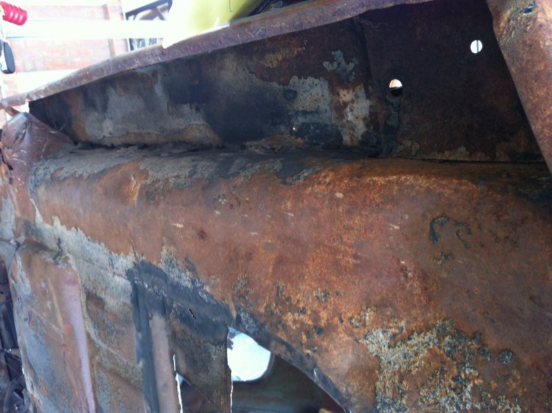

                              thank you all again very much for your responses. Please find below photos of my longitudinals and closing panels to provide context.
                              Justin, Jase B has seen these panels and offered the suggestion that I may elect to just replace parts of the outer longs, as this was a practise he had used previously. I am sure he was considering my (much) lower level of skill. Another caveat is that he strongly suggested that I have the car bead blasted as soon as possible (which I have not done yet but will obviously do so) so that we could see what I was working with.
                              As you can see the lower portion of the outer front closing panel is trash and I have purchased a replacement panel for that. The outer long has some pinholes and has general outer surface rust.

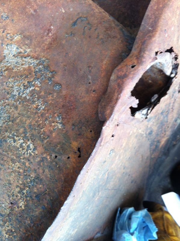

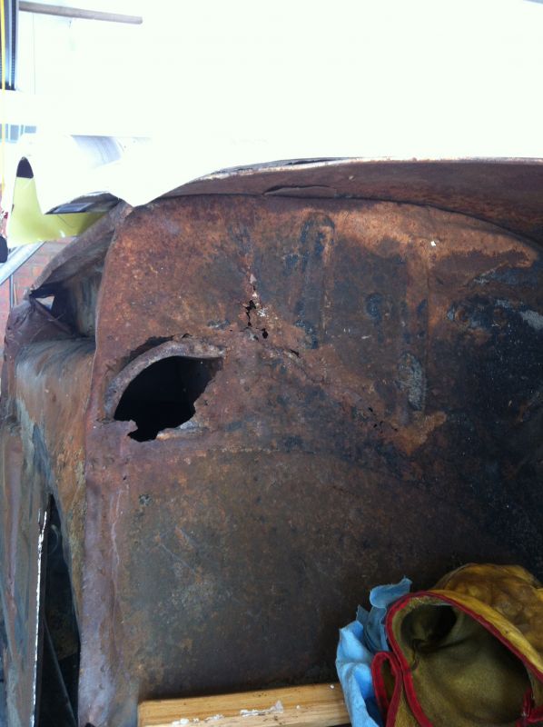

                              • #30
                                Continued...

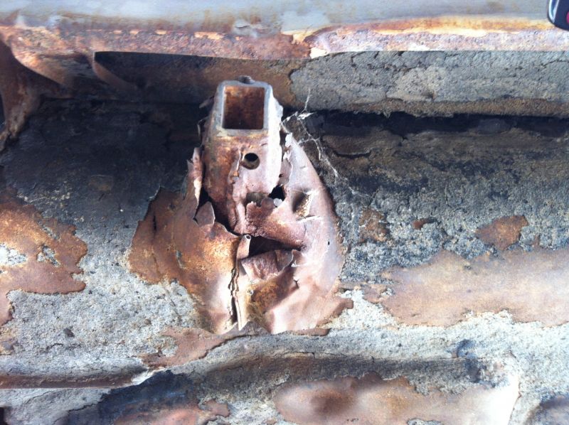

                                Both jack spurs are junk...
