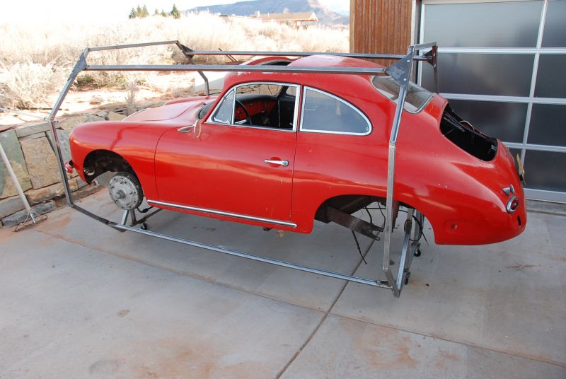

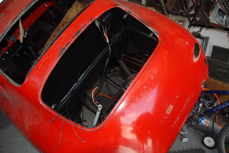

    3 years ago I acquired this car from a friend, he originally had 'sellers remorse' but that very soon disappeared as I started to look more closely at what he had sold me !
    We are still good friends ! My original intent was just to do a quick paint job and enjoy the car and have some fun, somewhat naive in retrospect.

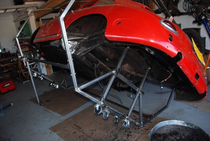

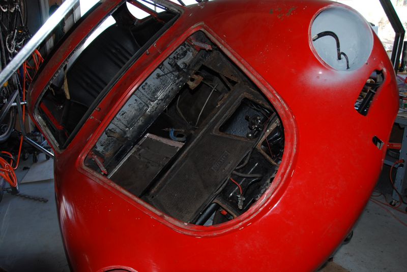

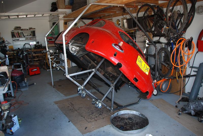

    So as can seen I built a tip over frame
    and made mistake number one: the wheels. To small and too far inboard and complete waste of time, broken off several times so spend the money and go big !

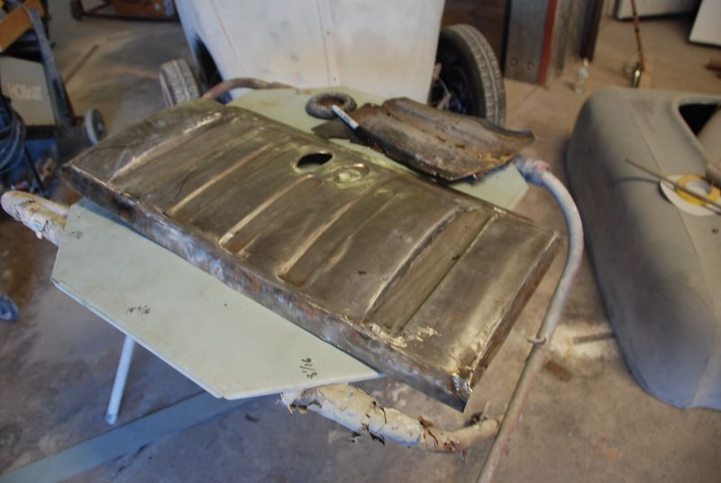

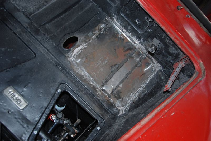

      Started chipping of the old sound deadening paper and tar. An old wood chisel worked well as well as a heat gun. Removed the gas tank to find a rotted out gas tank floor. Being cheap I decided to make a section myself.
      Humm easier said than done, but it looked OK - well sort of. I made and welded on one rib as I had no means to press anything; several months later I ripped it out in disgust and brought a vendor replacement. Lesson two: unless you are good and have the skills the time and effort aren't worth it !

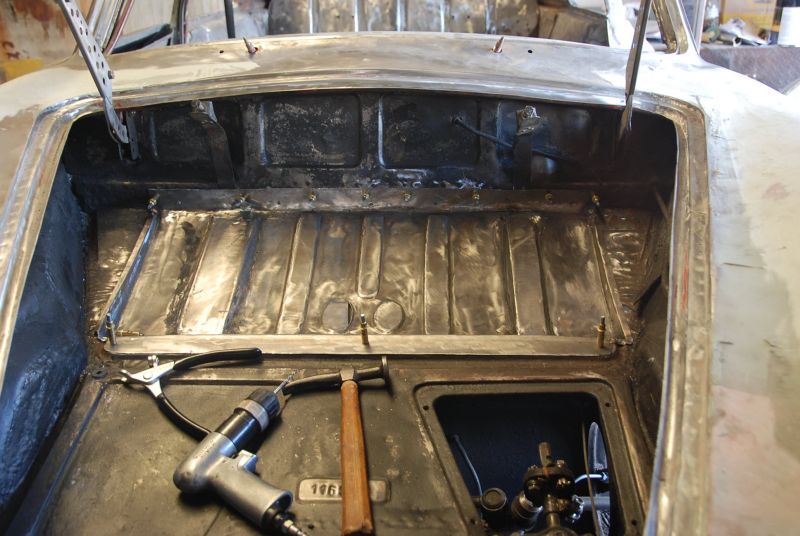

      But the quality of the new floor frankly sucked, badly finished and welded and I can't see why it was sold and I should have returned it. Lesson three: Don't be shy to talk with suppliers - if it is cheap understand why ! (I was suckered !)

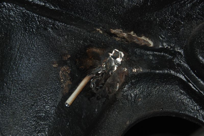

        But at least I could add the two gas/water drain tubes back in that had rotted off

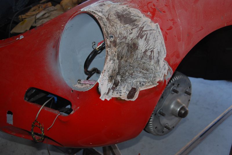

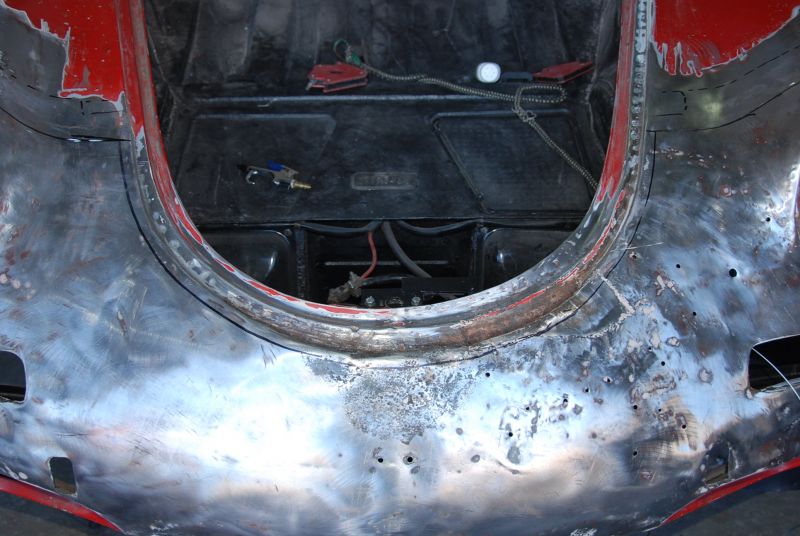

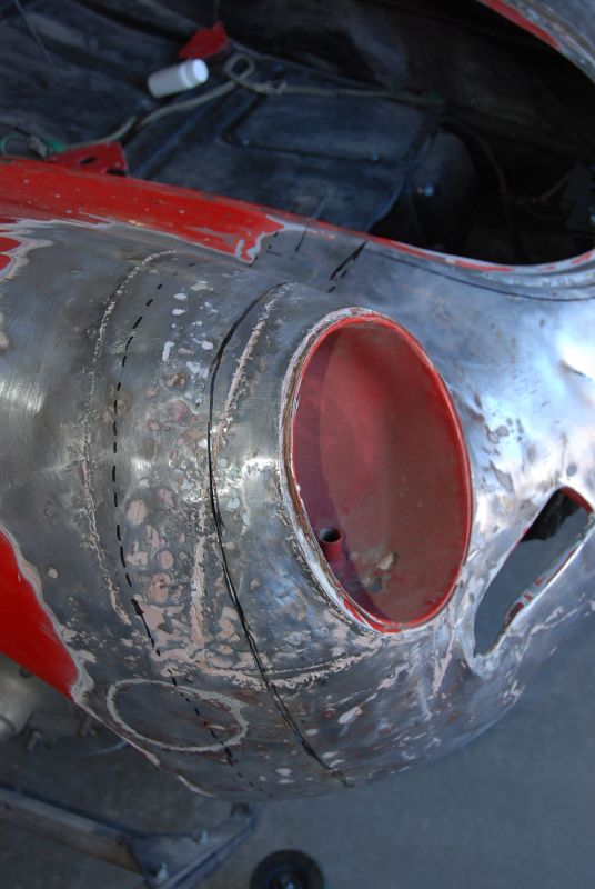

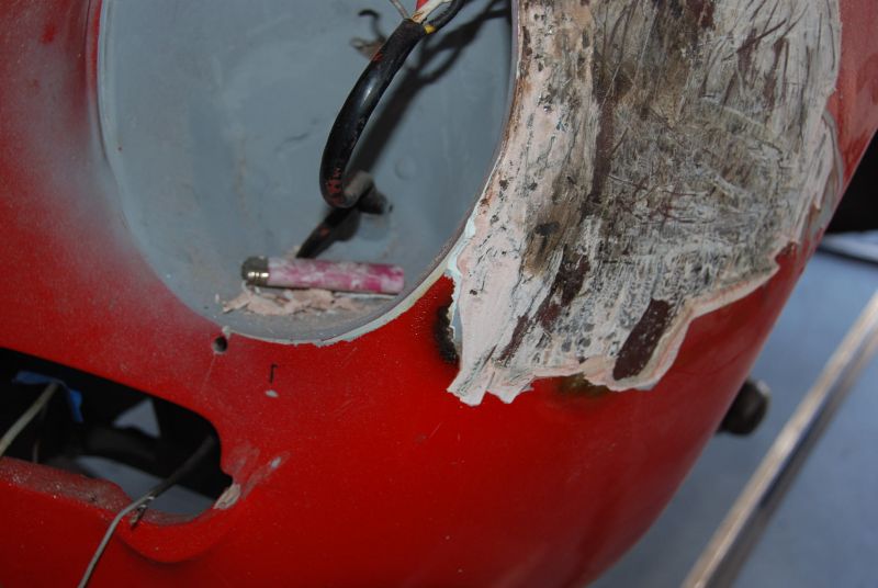

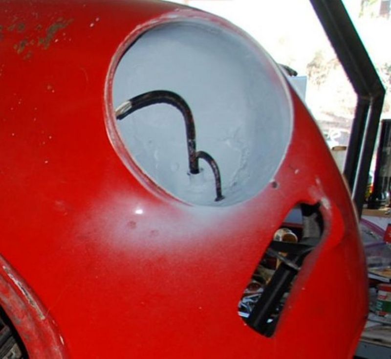

            Don't go digging in the dirt (aka bondo) unless you take antidepressants first. If you look closely at the head light bowl rim you see there is no rim, it smooths right out to nothing...

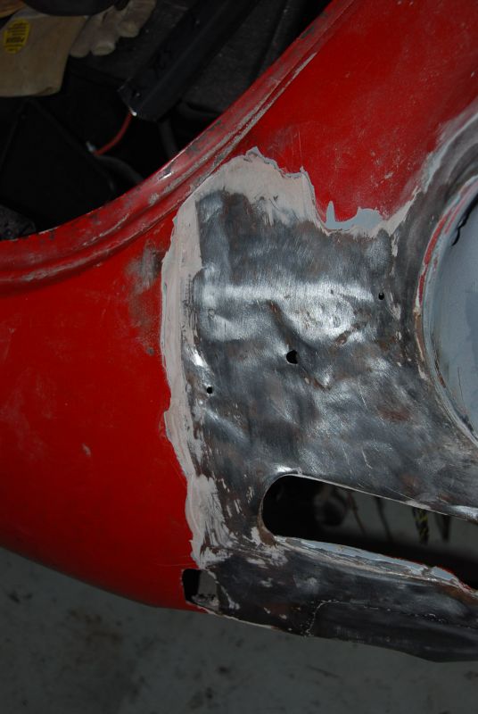

            So I started to dig
            and dig some more
            and some more
            and then got very depressed...
            but even better was to come !
            Thanks for all the support.
            Steve

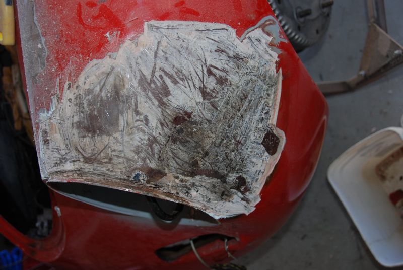

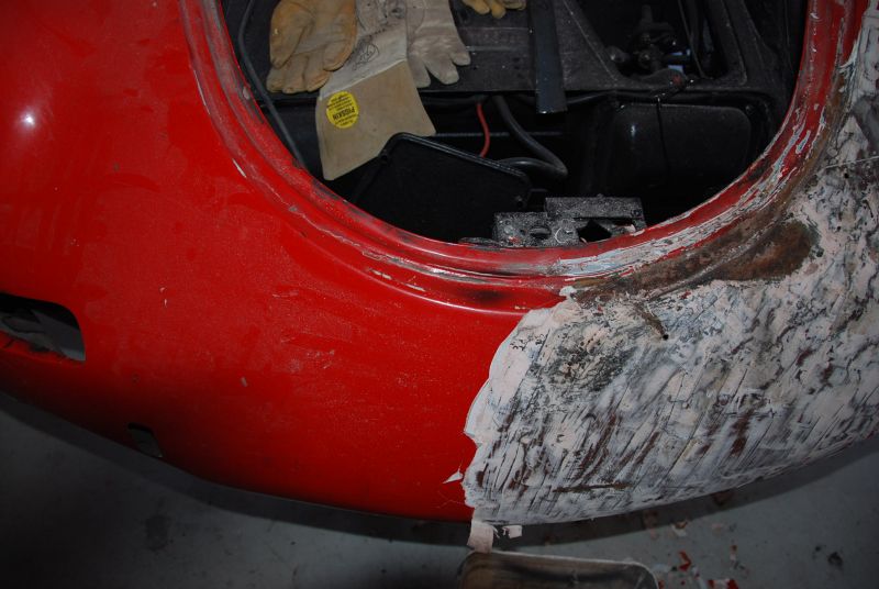

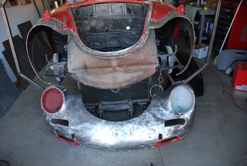

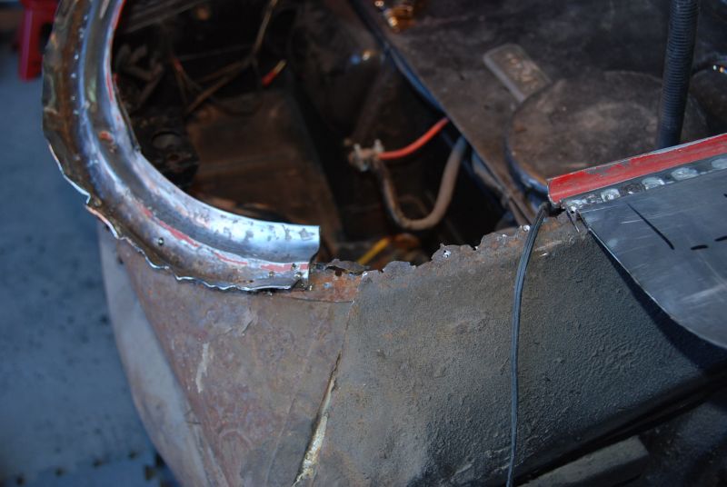

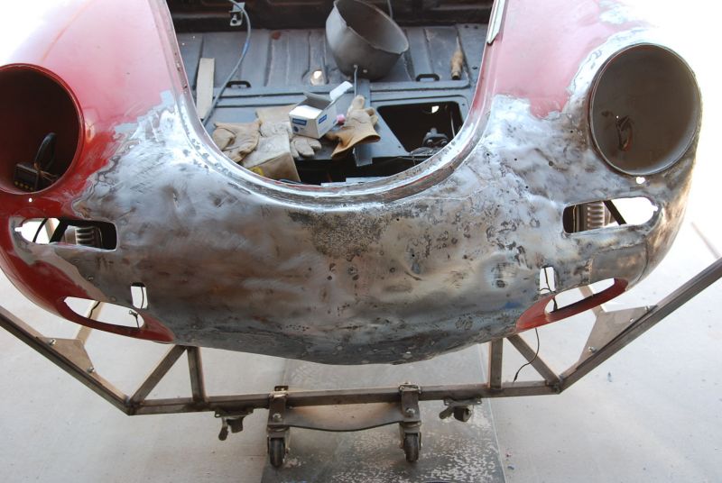

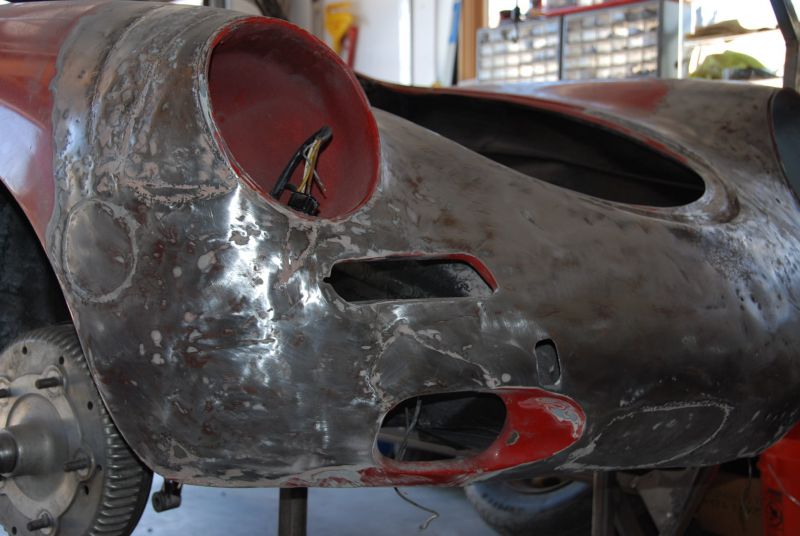

                        Ok sorry... to many pics of that stage - anyway I ended up cleaning up the whole of the front nose area only to realize that with the metal patch work and pushed in headlight area I would be into serious bondo again to get it back ...

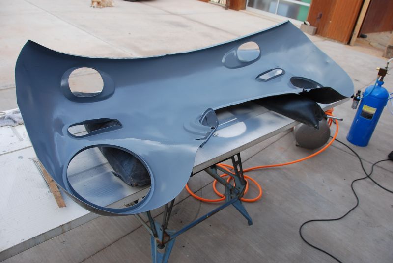

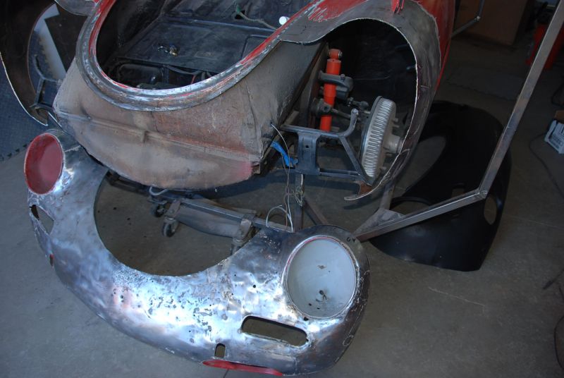

                        So ordered up a new nose from Trevor, now I was getting serious and way out of my depth ! Shown here cleaned and epoxy primed.

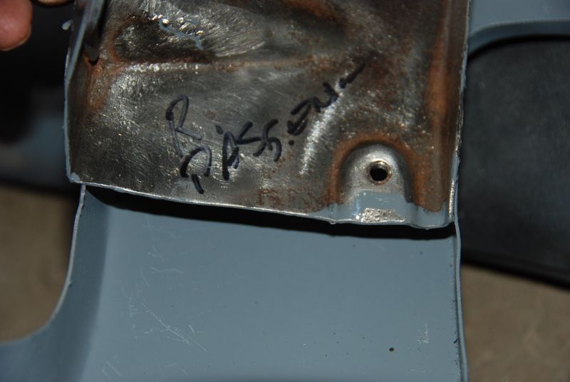

                        I took the old mounting plates of the old nose to weld on; so next mistake. The plates were too big for the new nose, or should I say the that area was not big enough for the plates. I choose to alter the plates and not the nose which of course is not a good idea.

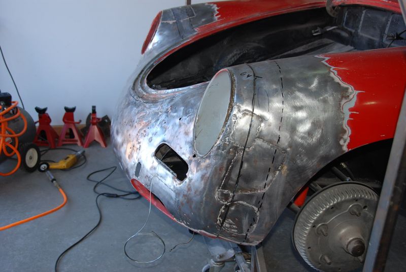

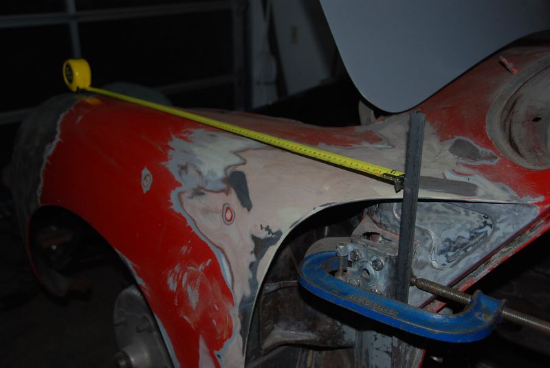

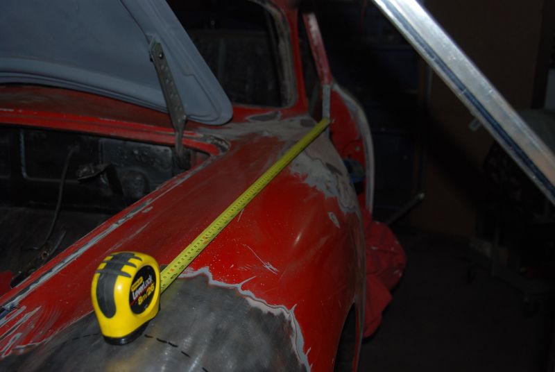

                          Key issue is where to cut for the new nose, and new nose won't lay flat of the old one to give an accurate guide..so measure, then again measure and then measure again ! (and yepp I got it somewhat wrong Click image for larger version
                          trying to make sure I would cut equally:

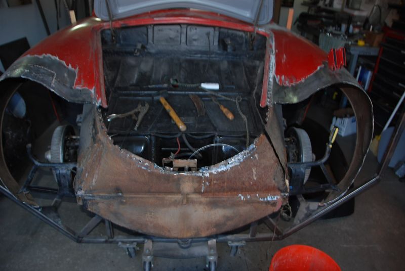

                            Not having enough new metal to allow cutting past all the old sin is a tough spot to be in. Like the sight marker off the hinge mounts.
                              So eventually I just went for it.

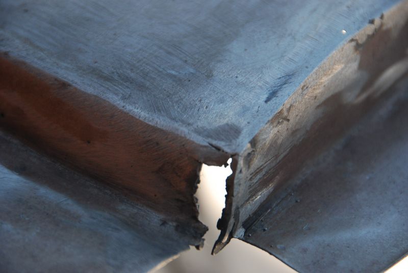

                              There was impact damage and fiberglass
                              and rot (what else !) so the lip I tried to save came off too
