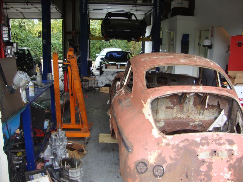

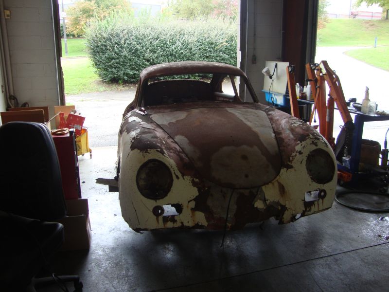

    Time to get moving on this old girl. Looking for some help as I go hope you guys don't mind.... Here is my plan on getting started.

    I got the doors off and have metal coming and would like to get them repaired and remounted then get the get the front battery box welded in so I can get it mounted on the rotisserie.
    Any thought's
    52 split window
    62 T-6 cab
    Good luck with the '54.
    Since you asked, one thought is to question using a battery box for a rotisserie mount. I use the suspension in the front and the trans and hoop mounting spots in the rear, as those BETTER be the strongest part of the car to be restored. If you are interested, some pictures of what I cobbled together can be posted when I return next week to where they are.

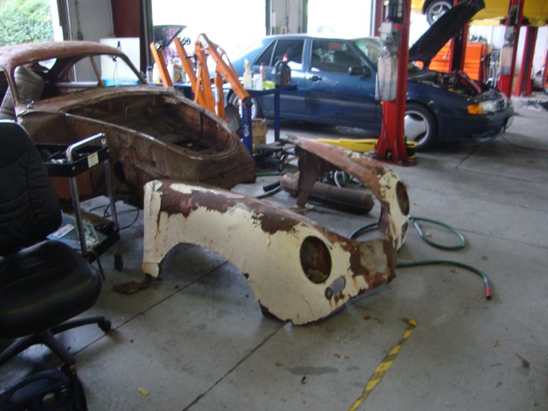

            Well I cut the clip of this afternoon so that I can get to the trunk side panels and the battery box area. Trying to move in sections and keep this thing moving forward. Now I need to wait for a box of metal to come so I can get started on the doors. Plan on trying to get it mounted on the rotessorie this weekend.

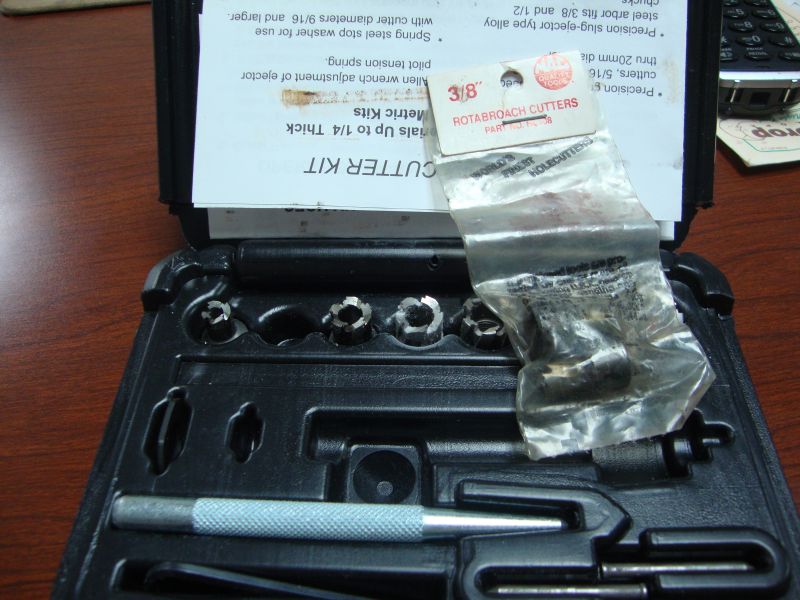

            Bought a new spot bit drill kit this afternoon this thing rocks compared to the one's I used to get from Wurth.

              Things begin looking better once the ratty metal sections begin to disappear. A nice start Tony. Like that spot weld kit of yours.
              BTW: don't forget to hit the "insert" button on each of your photo attachments so they will display. Place the curser where you want them to show up and hit insert on it. You can see how I added them in after the fact on your last post.

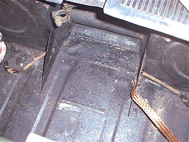

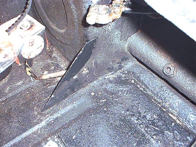

                  Phil I could use picture of the battery box area if you have any.

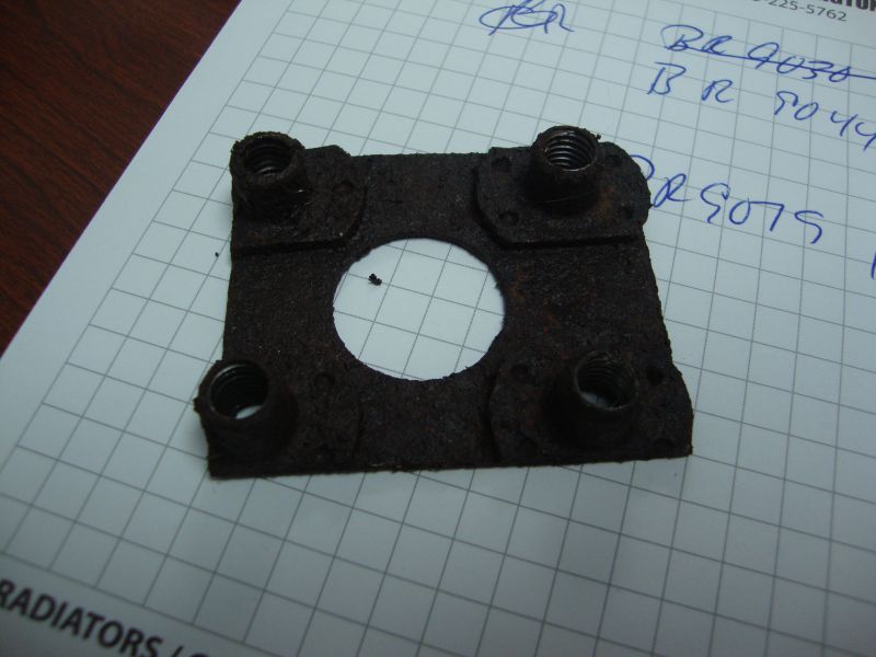

                  Also today project is the threaded plates that hold the door hinges to the body looks like I will have make four of them up does anyone have a part number for the "T" nuts?

                    They still use them on moderen Porsche/VW vehicles so hopefully I can get them from the local dealers and not wait a week.

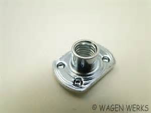

                      They're still being made though getting the actual manufacture might be the challenging part. Here's a place to start: VW Wagen Werks

                      They offer these fender nuts though I'm sure these will be too small for the hinge bolts.
                        My 55 is all original metal except the battery pan, so I don't have many shots of bare metal stuff as body has not been restored.

                        I have a dimensioned drawing I made of the triangular battery walls. Not sure if it is jpeg, but if you need it, let me know.

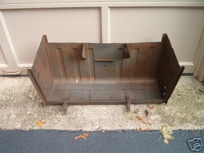

                        This was advertised as NOS on Ebay several years ago:

                          The part number was just what I needed VW still stocks them will have 20 on Monday morning. For the record the part number is N 011 407 1
                          Phil he pictures was just what I needed.
