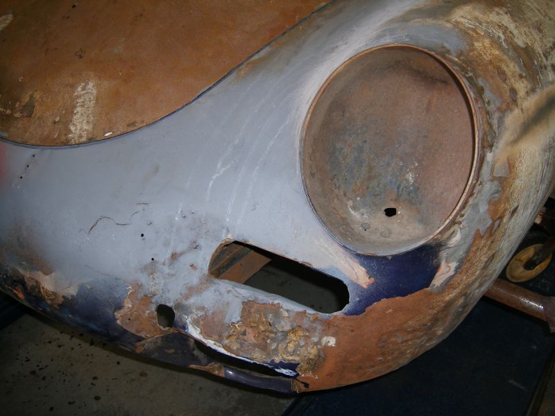

    Some detailed front end shots of what is on your car now and the donor nose would be helpful so we can see what you have to work with. There are two basic thoughts I would recommend if I was doing a full frontal replacement.

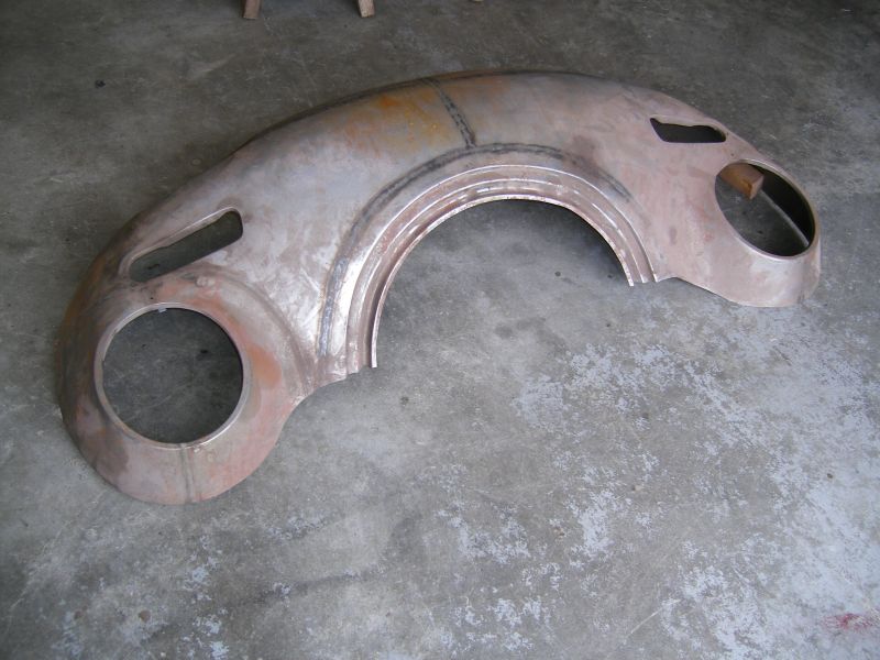

      I will get some pics up asap. The new nose I have has the trough bit it looks to short to me right behind the headlights.
      60 Coupe Outlaw Project
        Well if its short you of course have to work with what you've got...

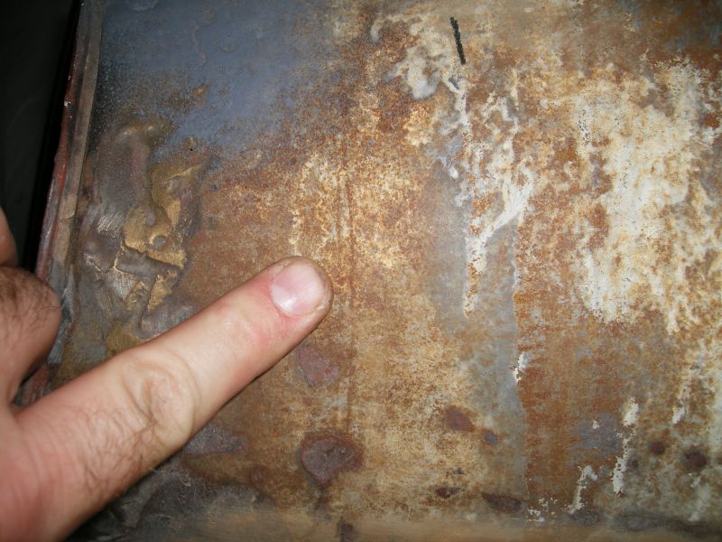

          Found the factory line and it looks like its close to what the new one is.
            Okay, you've got what looks to be a trevor Marshall new front nose. While these parts are close I would bet the farm there will be some additional cutting and splicing needed before it fits on your car like it should. So the same rule applies and is actually more important than ever; Get your hood mounted,latched, and gap set to the cowl and fenders. Its a sure bet letting the factory parts dictate your lines, provided they are not damaged of course. Make this aftermarket part fit and contour to factory hood and fenders not the other way around. Keep us posted! Justin
