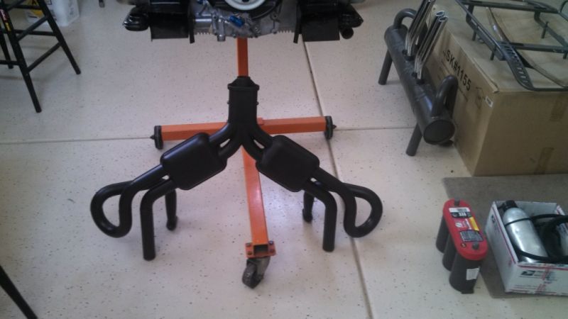

                  Okay, since last post, learned that the vintage Abarth muffler that Matt Howard restored and had jet coated is too restrictive for my 90mm engine with longer duration cam. Contacted Jim Constas and got one of his Sebring exhausts. Finally got the engine together and plan to bench test tonight. Fingers crossed!!

                    Really nice looking Exhaust Steve. Its the same style I'm looking to have on my car. Best of luck with the fire-up! Justin
                    • #40
                      Thanks for the info Steve. New JC exhaust looks sharp. I like the black look. If you are interesting in selling the old one let me know. My motor is standard 912 so I guess it would work.

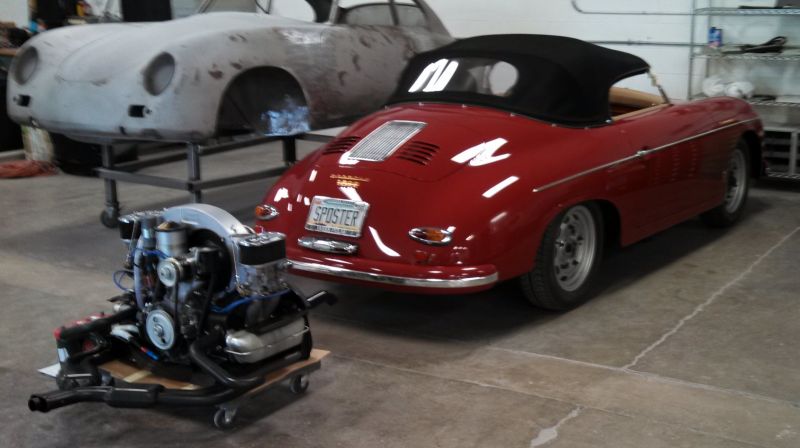

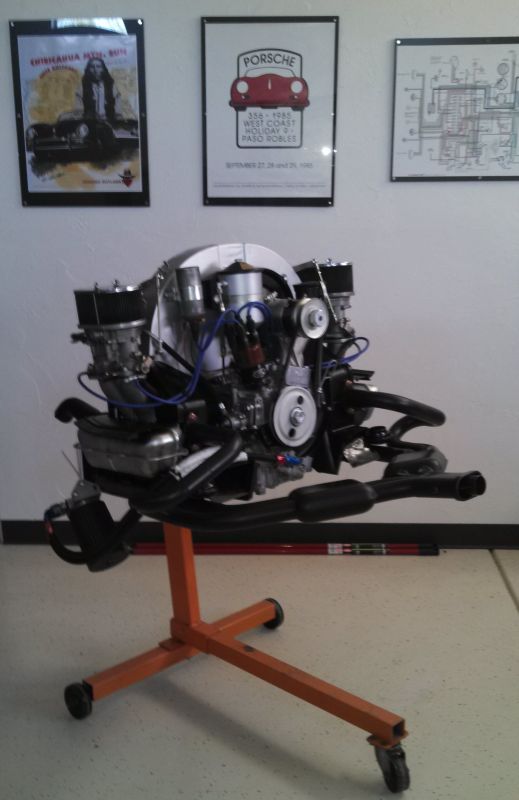

                        This post is a duplicate of one I did on the Outlaw thread, but thought I'd update this thread as well.
                        Mine is finally coming to completion. Install engine, set ride height, install GT mirror housing (hand made steel by Tom Boutos) and start dialing in for Santa Fe WCH. Borrowed static engine run stand and tested out of the car. 90mm Nickies, NuTec SX-1 cam, 40mm Dellortos with CB performance horizontal spray bar updates, light flywheel and Constas Sebring exhaust make for very responsive throttle blipping.

                          Congratulations Steve! It really turned out nice! Looking forward to a few additional shots after you get her up and running! Nice job BTW of Snagging that personal plate! Justin
                          • #43
                            Thanks, JT. It took a lot longer than it should have, but surely not Matt's fault. The car was at the upholstery shop for 6 months and it took me 5 months to build the engine when the car got out of the upholstery shop. I had remodeling at the house and it took forever. Matt and his guys did did their part quickly and efficiently. 678 pictures on their website document their great work.
