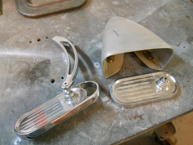

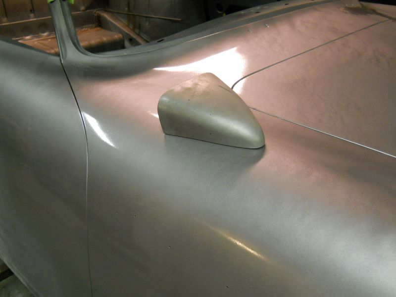

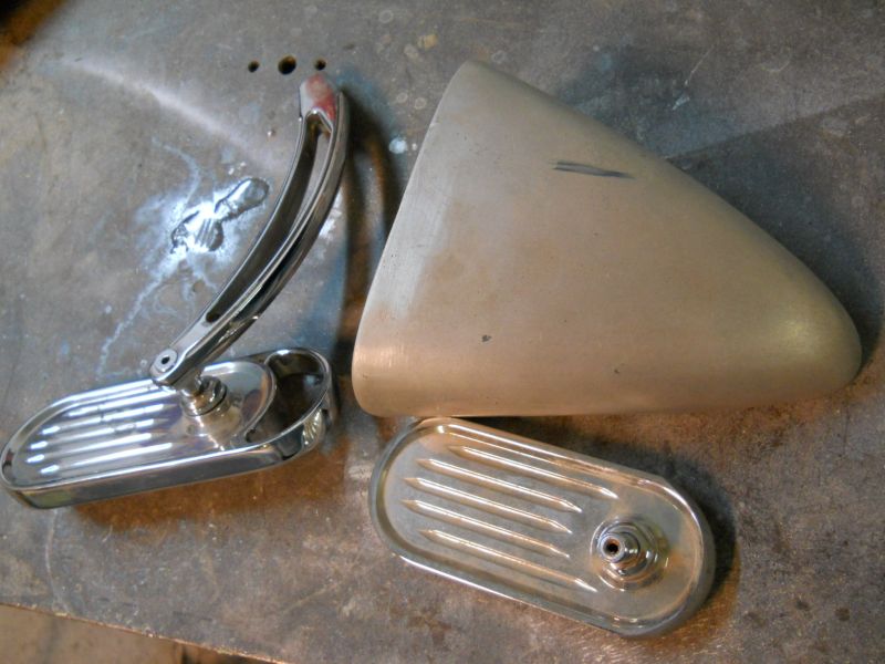

                            Here is the hand made steel GT mirror housing that will go on the car. I selected this one for two reasons:
                            1. The commonly available aluminum GT mirrors are made by Urs Gretener (sold by most of the usual suspects) and are probably the most correct in terms of shape, however I think the squared off shape looks out of place on a rounded 356.
                            2. The Spyder mirrors are HUGE and bulbous. I borrowed one and set it on the fender and it dominated the profile.
                            With that, I think this one, more rounded than the GT and less bulbous than the Spyder, better complements the shape of the Speedster. There is a matching hand made mirror base that I will post later.

                              Looks pretty good from what I can tell so far Steve. I am with you on the overall size of an original 550 unit, it is too big. I never gave much thought about the flatness of the other offerings but I can see that. I have been on a similar project for a while now too and my criteria was overall size but most importantly the final height of it off the fender. I'd like to see your housing on a fender to get a better idea. Below is my mirror project. Justin

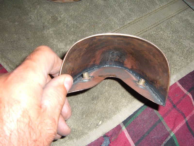

                              Alloy housing I found on ebay several years ago out of Europe. Its one of the smallest I have come across. This housing is for my Coupster project BTW not the coupe its pictured on. I am going try and keep a side mirror off of this car for as long as I can.

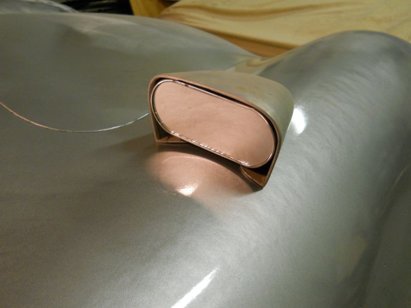

                              Trickiest part was finding a mirror that would fit.

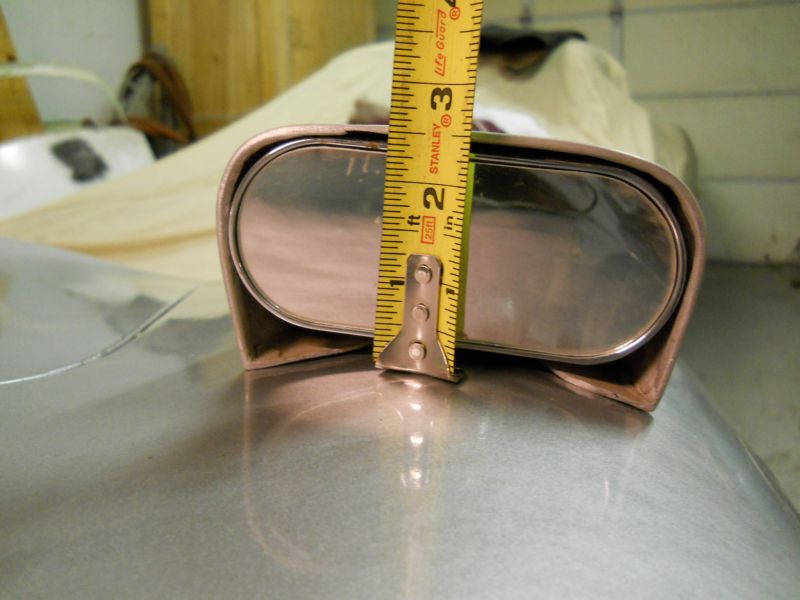

                              As you can see the final height is just as 2.5 inches. About as low as you can go and still be of some use.
                              I eventually found my mirror in the harley-davidson offerings. I of course had to buy as a pair. Once I cut the excess off it fit beautifully.

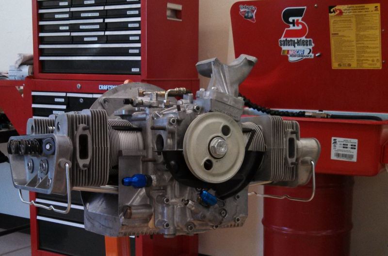

                                Here's a bit of an update. Car is done except for engine grill and windshield. Engine grill tumbled and ceramic coated by Jim Liberty. WELL worth the $172 insured for $500 and shipped to my door. Windshield is now at Deluxe Customs and will be installed before too long. Engine is "long pole in the tent." Got the cylinders and heads on today. Lapped the cylinders to fine sandpaper on glass and then to the cylinders. Installed the high tech pushrod tubes from Ron Ladow with nitrile rubber pushrod tube seals. Chased the threads on the head nuts and installed with nitrile rubber o-rings and ARP assembly lube for the ARP studs that are recommended with the Nickies. Funny how when you are trying to be so fastidiously clean, everything starts looking dirty and gritty. It's not, but seems that way. Next is the rocker arm assy. Sent the rockers out and had the pads re-machined. Will be careful to ensure that I still have ample oil flow through the adjuster screws. If not, may order chrome moly pushrods. We'll see. More later...
