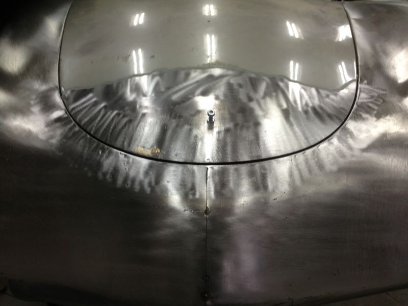

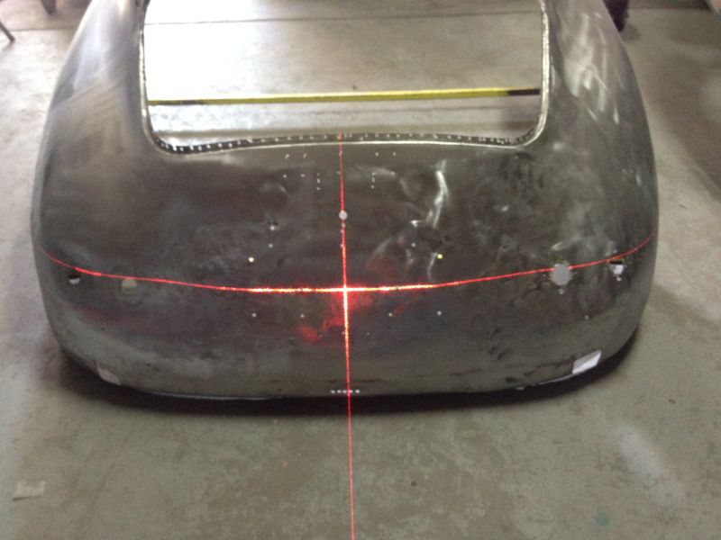

        Looked like the inner structure photos were getting boring so I jumped forward to the outer skin of the rear clip. It was full of bog (what we call bondo here). after digging it all out it was a bit like a bmx track! Highs, lows, whoopde doos, a table top and more. Repairs were done with gas torch, hammer ,dollie, body file and my worn out old bones.
        this one went to hell and back!!! but good as gold now.
        the front clip was ten times worse but the gods were with me that week and I was luck enough to save it too. Pictures to follow......
        BTW it possibly took me longer to do this post than repair the clip!

          Wow restore 1,
          I said earlier you were brave, take my word for it you are. The highs and lows and getting it to look like that very impressive. The effort must be huge to do this car but your results are super. Look forward to seeing the front clip.
          Well done indeed!
          • #35
            Exceptional and inspiring work as usual mate! Its the same magic you and your pop performed on my ratty old fender! It still continues to really amaze me! The welds around the tail light hole repairs were so pretty! Please don't edit your work because you think it may be boring like all the substructure stuff. Someone in the future might really want to see how to repair that "inner panel" correctly. I personally enjoy looking at it all! I know this was a bit of a time investment to post but thank you so much for taking the time to do it Jason! Your work really needs to be seen. Thanks again Mate!

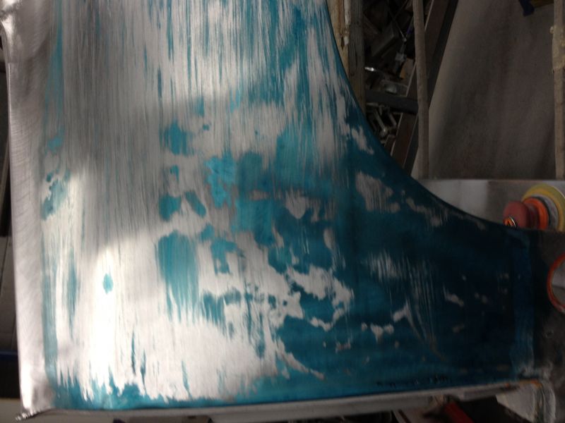

                We never get bored looking at this brilliant work. It helps all, of us non-pros get better. Thanks for teaching us. I have always wondered how you end up w such a nice finish. I see you use marking dye, or Blue I think it is called. Do you ever have a problem w the metal getting too thin after filing and working it?
