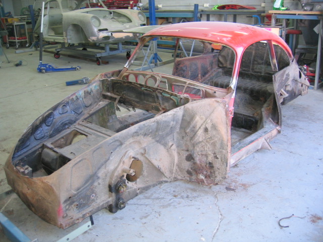

    This is how the car was purchased by my client. It was purchased with the intention of restoring as soon as I could fit it in. The car presented fairly well, some minor front accident damage to the front clip, Right door. It had some fibreglass rust repairs to the original floors, longs,battery box etc. It has probably been restored a couple of times and suffered a typical late eighties red paint job (they all had to be red in the eighties right Justin!) Probably done in a regular smash repair shop (body shop) where it seems it was one of those cars that sat in the corner for years. Judging by the way it was reassembled it was probably thrown together at the last minute using all sorts of mix matched bolts from Australian ford and gm cars.
    It is a complete numbers matching car and a 56 super AUD delivered car so pretty rare. originally Lago green met.
    We decided to purchase a car to restore rather than purchasing a restored car. At the time of purchase most restored A coupes were running at least $100k. Sadly most of these high dollar cars were "Mudflaps" (Shiny on top and Sh%# underneath).
    We advertised Australia wide and looked at quite a few cars finally purchasing the 56

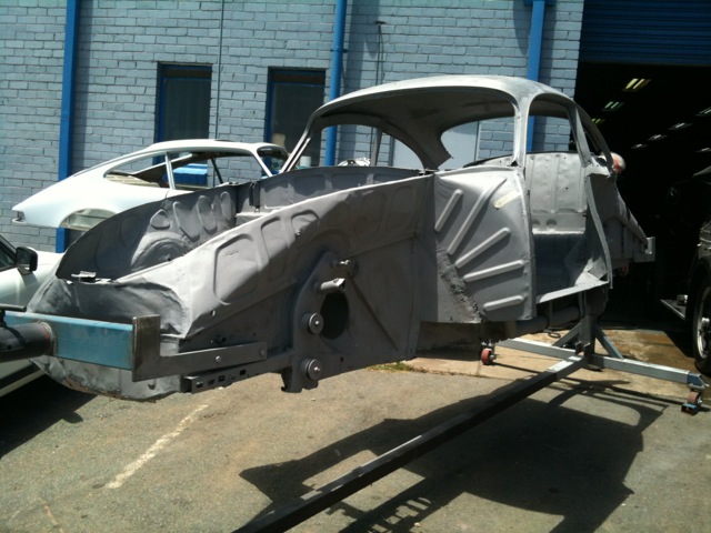

    It was pretty clear from the beginning that the skins had to be removed to allow full access to the inner structure and the inner rust repairs

    Jason, Thank you for sharing this restoration! I am in shock about all the outer panels that were removed. This looked like a solid car from the first photo. Can't be crashed and rusty the chassis looks too nice. Have you just removed them for access? looking forward to seeing this car progress!!! Thanks again! Justin

          Like Justin I am surprised at your bravery at taking all the front and side panels off the car. I realise photo's can often tell lies but actually the car looked so nice before you started. Was it really full of plastic filler etc? I know top notch restorations do go along this route but its an expensive road to go down especially from the time point of view.
          Again, if the restored car has to be perfect, then I guess it needs to be made almost new again and Justin really knows all about that with his car. From the photos and story of his, I am amazed at what he has managed. Is this your intention for the car to be 100%
          correct?
          I really look forward to seeing how you get on with the 'A' its basis looks in good condition.

              Yes it is a big job doing this way. Realistically many 356s should be done this way to be done properly. Most are not because it is very time consuming and expensive (As my client has found out).
              For this car in particular we had to go this way as will be shown in future.
              When the car was purchased and when it arrived at my shop as a bare shell it did look quite sound. after returning from the media blasters
              I was sure someone had switched cars! the one that came back looked like it had been to hell and back,maybe twice.

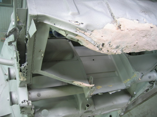

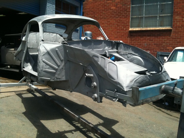

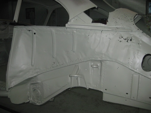

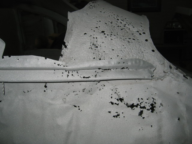

              This is how the body came back from media blasting. We mainly use two types of media. For the inner structure we use garnet which is quite aggressive with a texture similar to beach sand. Generally if the metal is thin the garnet will blow holes in it to show us what really needs replacing. The Garnet requires sealing as soon as possible as Garnet blasted metal will flash rust quickly. So we blow it down and vacuum it out and apply 1 Coat of Glasurit epoxy primer to any area that was garnet blasted.
              The second media is plastic and gives a very similar result to Soda . The plastic media however does not require water to neutralize it.
              The metal can sit for long periods of time in the raw after plastic blasting without rusting. (depending the humidity of course)
              The plastic media leaves a perfect surface (as if the metal were new) for file (metal) finish repairs.

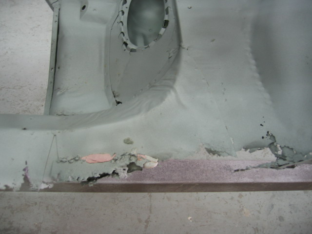

              as the images show the inner structure has a lot of issues which may not have been visible without removing the skins. Now all that is left is to make it pretty again.
                You're right Jason; that does not look like the same chassis in the previous photo. The amount of rusted out closing panels requires skin removal for a clean job and to make life easier. Makes perfect sense to me now. Looking forward to the repair progression! Thanks! Justin

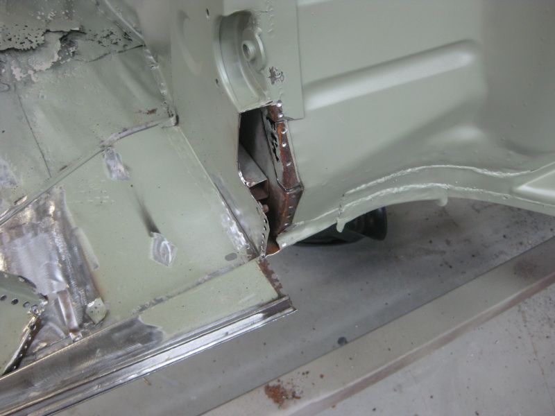

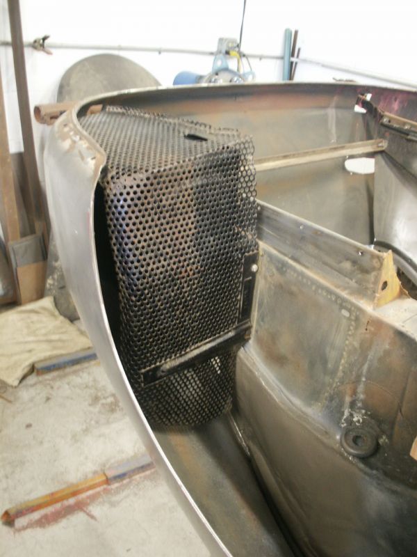

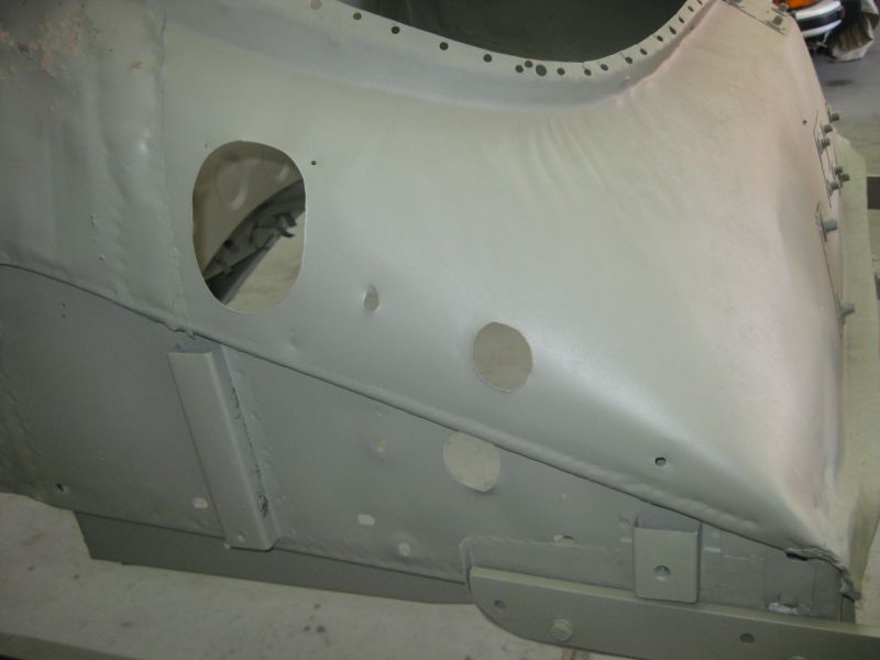

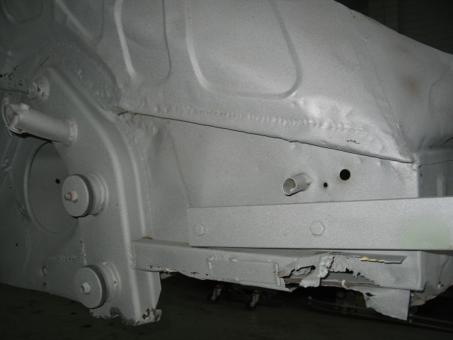

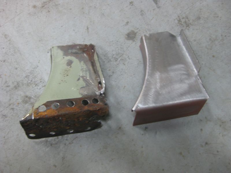

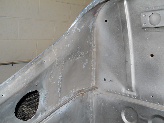

                    This is where I decided to start. I had noticed very poorly cut holes in the Left hand rear engine compartment.This was also my first mistake.
                    As it turns out Those poorly cut holes were factory fitted. I welded them up but they will have to be cut out again!
                    Through a little research I found out that 1956 bodies were built the same for push rod and 4 cam engines. bracket repaired was for optional oil tank (on 4 cam cars) and the holes were for oil lines.
                    Justin could probably shed a little light here?

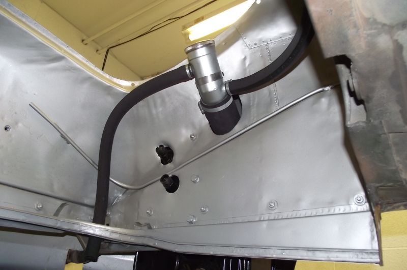

                        Hey Jason, Thanks for the update on this project. Yes, you're right all those holes were for the oil tank and the bracket you just repaired. All 1956-through early 1957 T1's rolled off the line "carrera ready" with the holes and bracketry. They stopped this sometime in mid to late 1957. Not the end of the world filling those holes. When its resound-deadend water from the tires cant get up between the new tarpaper and inside walls and cannot be seen anyway once finished. Here's a shot of the tank fitted to my coupe.
                        The smaller two holes were for the oil line fittings. Top for normal opperating temps and the lower for extrememly cold opperating temps. One or the other was always capped depending on conditions.
                        The bracket you repaired mounted both an oil tank flange and the screen for the tank. The two small nutters on the side of the bracket.
                        Looking forward to more progess on this beast! Thanks jason!

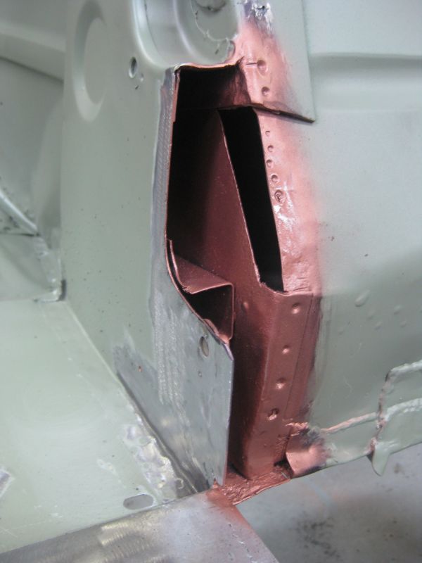

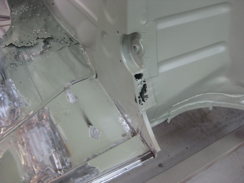

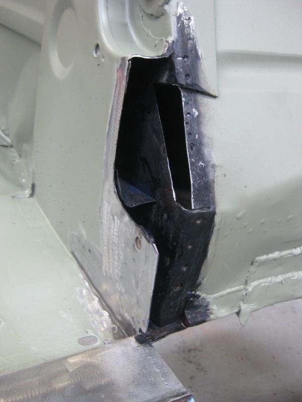

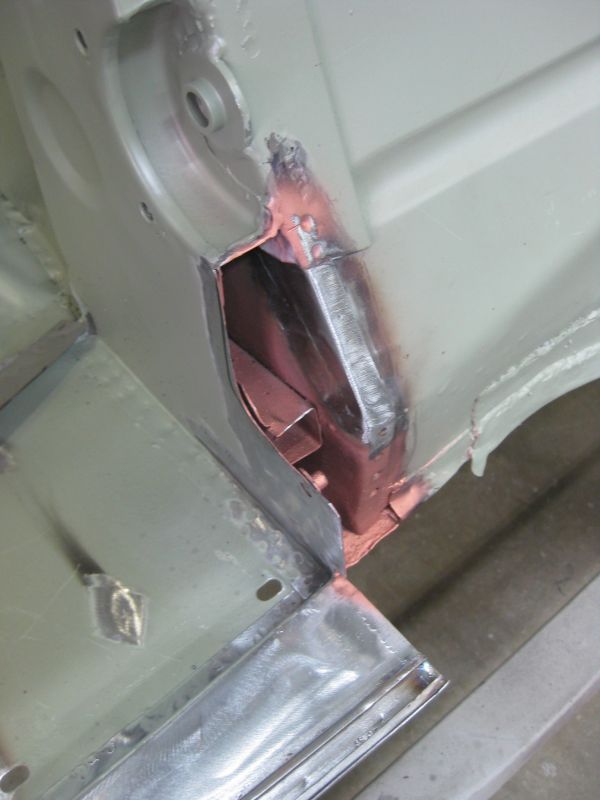

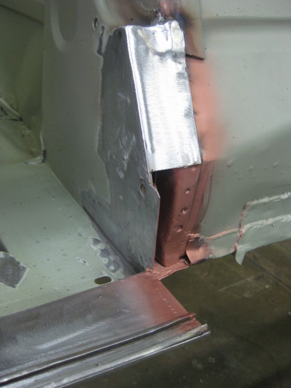

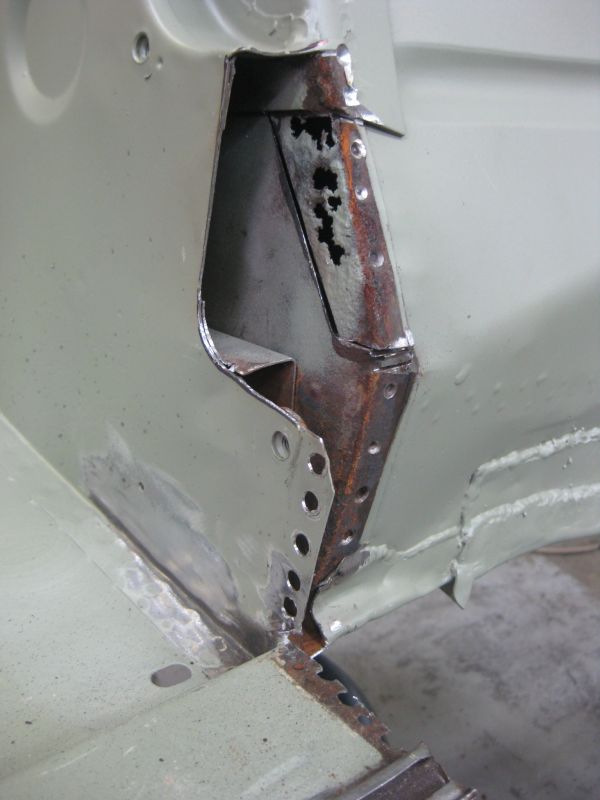

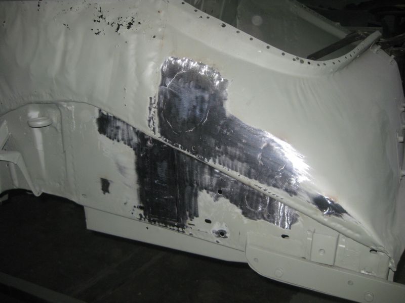

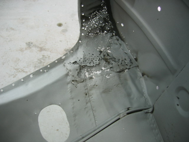

                          After opening it up we fon the inners to be rusty also.
                          We clean up the rust with a wire wheel on a drill (or whatever else we can make work) the areas are painted with Wurth rust converter and then with weld trough copper spray.
                          It is a little scary to see how these cars rust at the seams!

                            Thanks for this update Jason! Very nice work! All teadious little individual patch panels that can easily burn up an entire work day alone. Yes, its a reality that all of our cars have rust in these pinch seams. The amount of it varies to degree depending on the location of course but its under every seam guaranteed. These are the reasons good electrical grounds are always an issue with these cars. The lights are yellow or the starter labors with a fully charged battery. The current has to pass over all of these corroded joints to complete the circuit. Really an issue if your still on only 6 volts! Thanks again for updating! More please!
