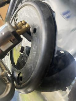

    Spent the last few days chasing wires, and the turn signal stalk. The wires were chopped off, the single color wires crimped in the ends. Laying on your back under the wheel is so much fun. Not sure about a couple things yet, T-1 used a brass block and screw for connections, now some switched are original for some bullets and some spades. Like the ignition looks like a 911/912 key in the back but wired like 356 with spades and the original key fits.

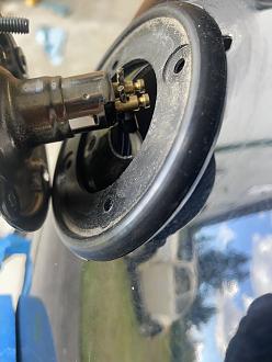

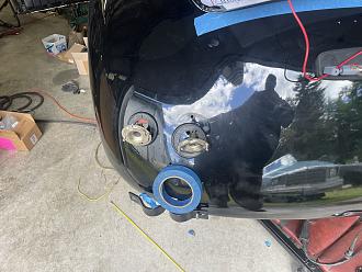

        More wiring today, made a new wire harness for the rear lights. Boobb replaced the rear bee hives, but ordered all fronts with dual post bulbs. I had Celeise order a Vintage Trader 356 T-1 LED Kit. But the reproduction front sockets use a dual filament bulbs. I had built the harness to light up both lights and use both filaments. That was easy with a jumper since the left and right are split at the fuse box. Now the LED bulbs do not for the sockets. I called Jules at VT when I realized the sockets were wrong for the original T-1 kit . He immediately knew what had happened and had new bulbs in the mail in under an hour, and no charge. That’s customer service!
ID:	116577 Click image for larger version
        Boobb chopped off all the wires under the dash, everything is short, even the main power cable between the battery and fuse box. . It’s a real mess but we are slowly overcoming all the defects. The light control relay is missing, and unobtainable. I can use a modern double pole single throw relays to replace it. Might be better in the long run.

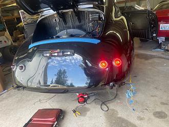

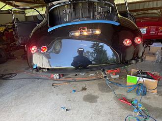

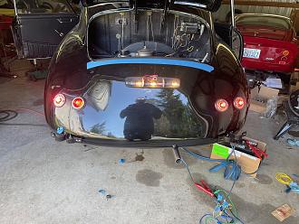

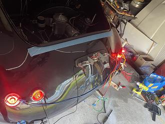

          ONE WIRE AT A TIME. Well after a couple weeks of wiring I think I can see light at the end of the tunnel. I never realized how bad someone could mess up a wiring harness.. And if you cut the wires to the flasher, or light relays or splice wires together with out matching the color codes. We have been starting at the bulb a working back to the fuse box, or turn signal selector, one at a time. I could not believe he cut the stalk harness 1/4" below the disconnect bullets and then spliced in a foot of red wire into the stalk, but did not match the original color codes from the harness. I do have Greg Bryant’s big windshield size color wire diagram, with out that I would have had to punt this one.
          Click image for larger version  Name:	rear lights1.jpg Views:	0 Size:	475.7 KB ID:	116637 Click image for larger version  Name:	rear lights4.jpg Views:	0 Size:	417.8 KB ID:	116638
          We have been starting with color code, then meter to the fuse box, then on to stalk switch or relay. After a good trace, inject power into the wire, if not too big of a voltage drop then test with a bulb.. one wire at a time. Cant believe how many miss connected wires there are. Also the 8Ga from battery to the fuse box was clipped right at the conduit above the battery. I sid manage to get a new battery cable in a couple weeks ago an a hot start relay with a push button next to the voltage regulator. I have finally crank the engine over and have oil pressure. The starter wire (50) is shorted into the ignition (30) somewhere so if you connect the battery to fuse box wire, touch the key and the starter runs. Never seen that before.
          Click image for larger version  Name:	rear lights2.jpg Views:	0 Size:	509.8 KB ID:	116639 Click image for larger version  Name:	rear lights3.jpg Views:	0 Size:	520.4 KB ID:	116640
          Click image for larger version  Name:	IMG_8015.HEIC.jpg Views:	0 Size:	1.49 MB ID:	116641
          jumpers, a kludge a couple bypass & work arounds and some extra wires but the original lamps finally light up
          BOOB ordered new reproductions but the wrong beehives, all dual filament fronts assemblies. I had Celeste order a T-1 LED kit from Vintage Trader, I called Jules, told him of the double filaments, and he sent new rear bulbs at no cost. I wired them in parallel so you now get two turn signal or four brake lights. Way brighter than the original bulbs.

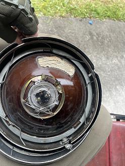

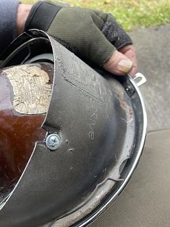

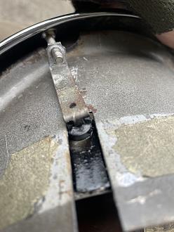

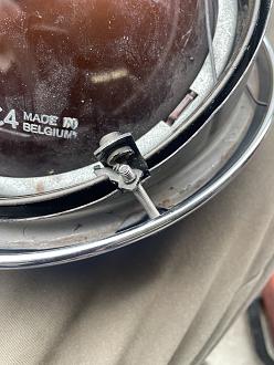

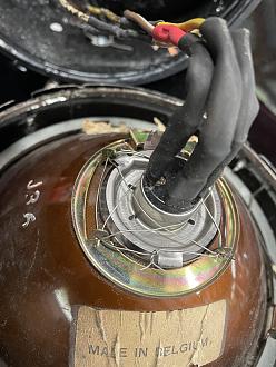

          I did swap out the headlights with led’s today. The previous Boob did not but the buckets back together correctly. I need to order some springs and rubber pivot kit. I think the buckets can be saved but there is no way they will adjust like they are. The old reflectors were cobbled together, they were painted black and sheet metal screwed together. Every time I start something it seems Boob was there first.
          Click image for larger version  Name:	IMG_8052.jpg Views:	0 Size:	1.19 MB ID:	116663 Click image for larger version  Name:	IMG_8050.jpg Views:	0 Size:	1.24 MB ID:	116664
          Click image for larger version  Name:	IMG_8051.jpg Views:	0 Size:	1.36 MB ID:	116665 Click image for larger version  Name:	IMG_8053.jpg Views:	0 Size:	1.66 MB ID:	116667
          Click image for larger version  Name:	IMG_8048.jpg Views:	0 Size:	1.59 MB ID:	116666
          Nothing like pulling a light bucket, and find 4 retainer springs laying in the fender bucket, and 22 gauge wire & spades on the headlight plugs, and some 0.010 safety wire holding the entire mess together. Plus the glass lens was loose with the inner seal popped out.
