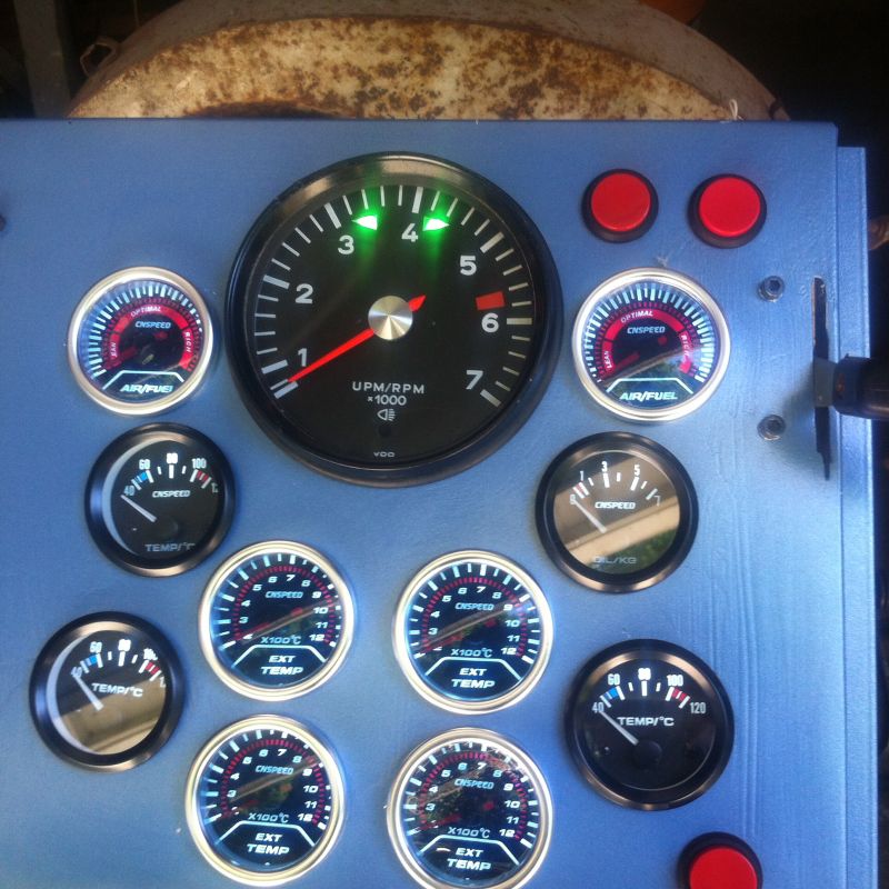

356 engine run in stand
    Very slick, I like it!
      It lives... Got all the instruments to operate, now for some calibration and I should be done. Has turn signal indicators in the TACH, so they are now tied to the oil pressure light. I used some 8mm LEDs instead of the 2w bulbs. The green lense is bright and will get your attention.
