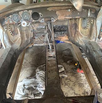

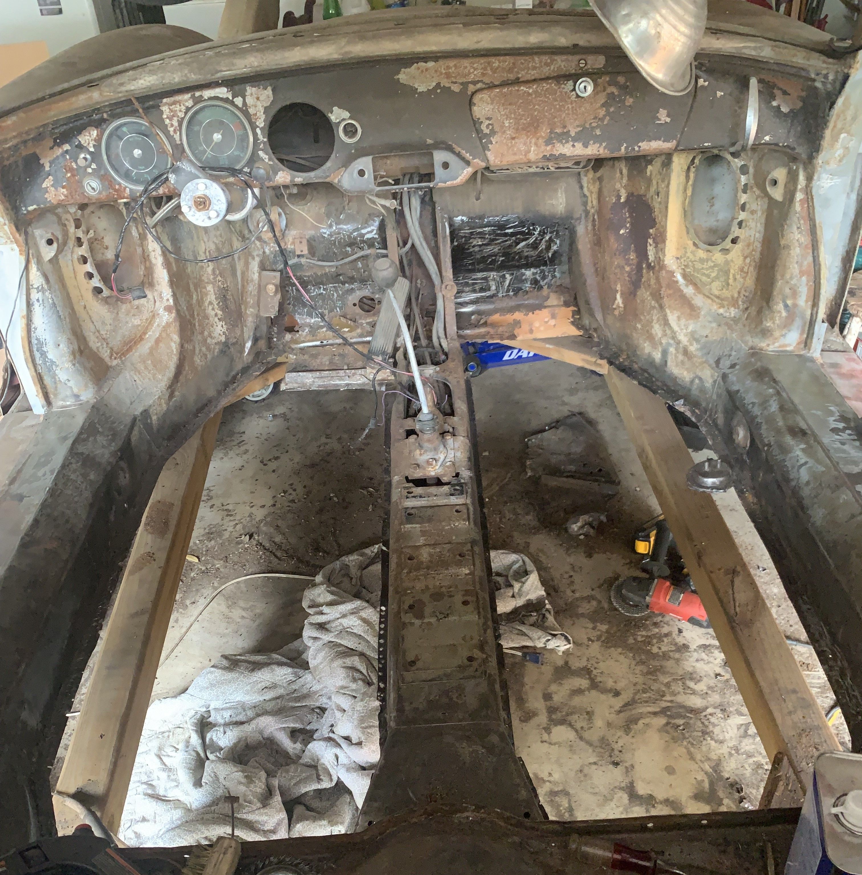

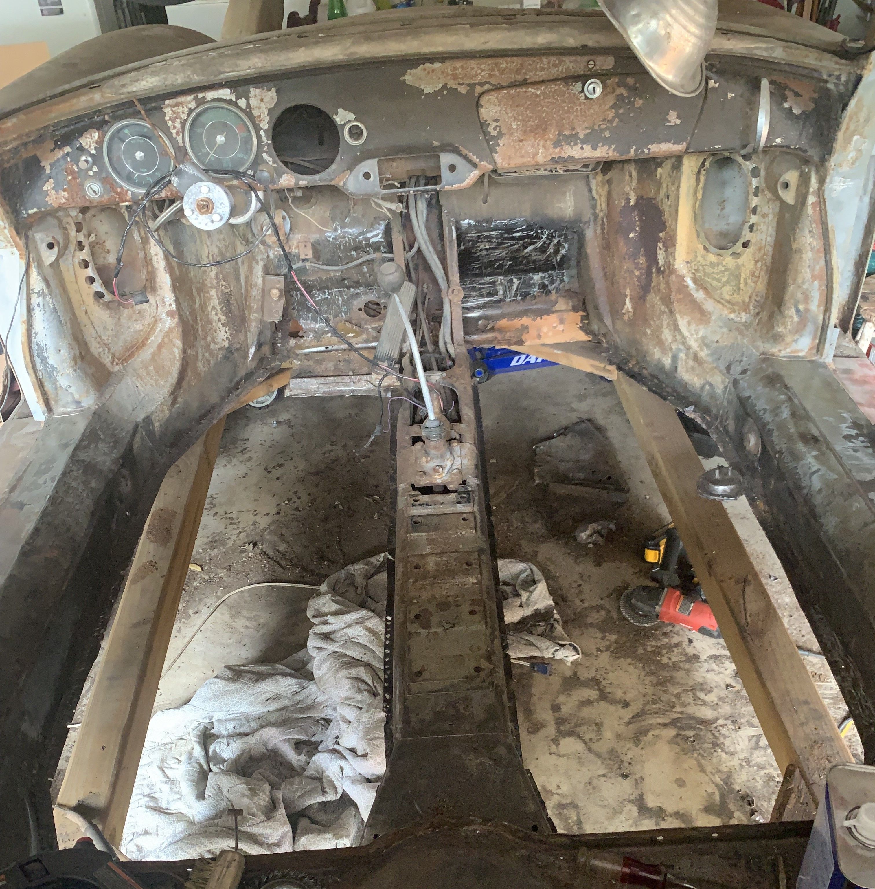

    Floor work to date on driver's side.
      Hey Mark, Just saw John's post on the Registry and realized this was the same car under that tarp in the back yard?!? This car looks to be in surprisingly good condition considering the way its been stored. Tarps usually work like a hot house and the rust just goes nuts under there.
    That's the one Justin!

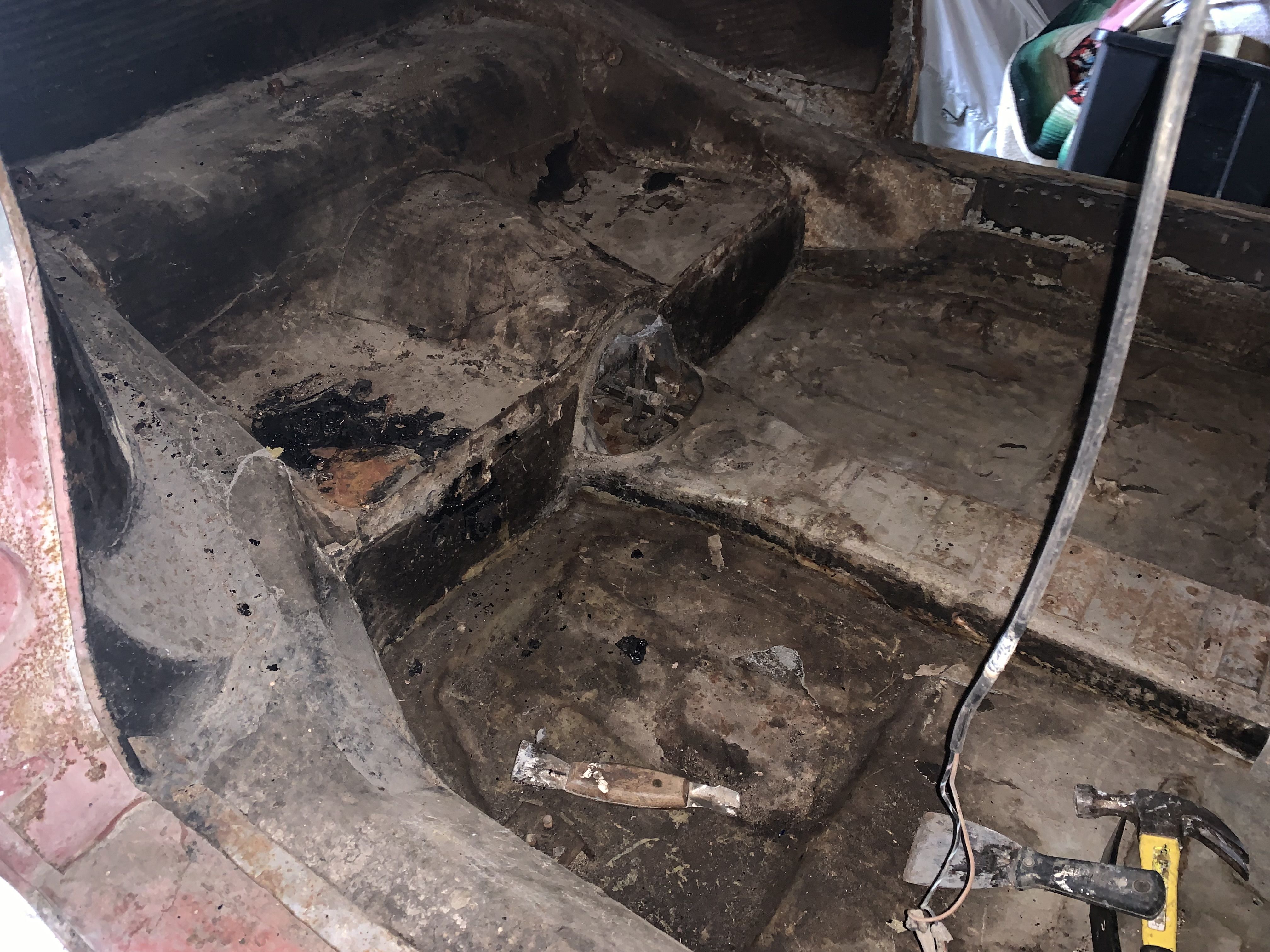

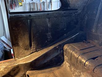

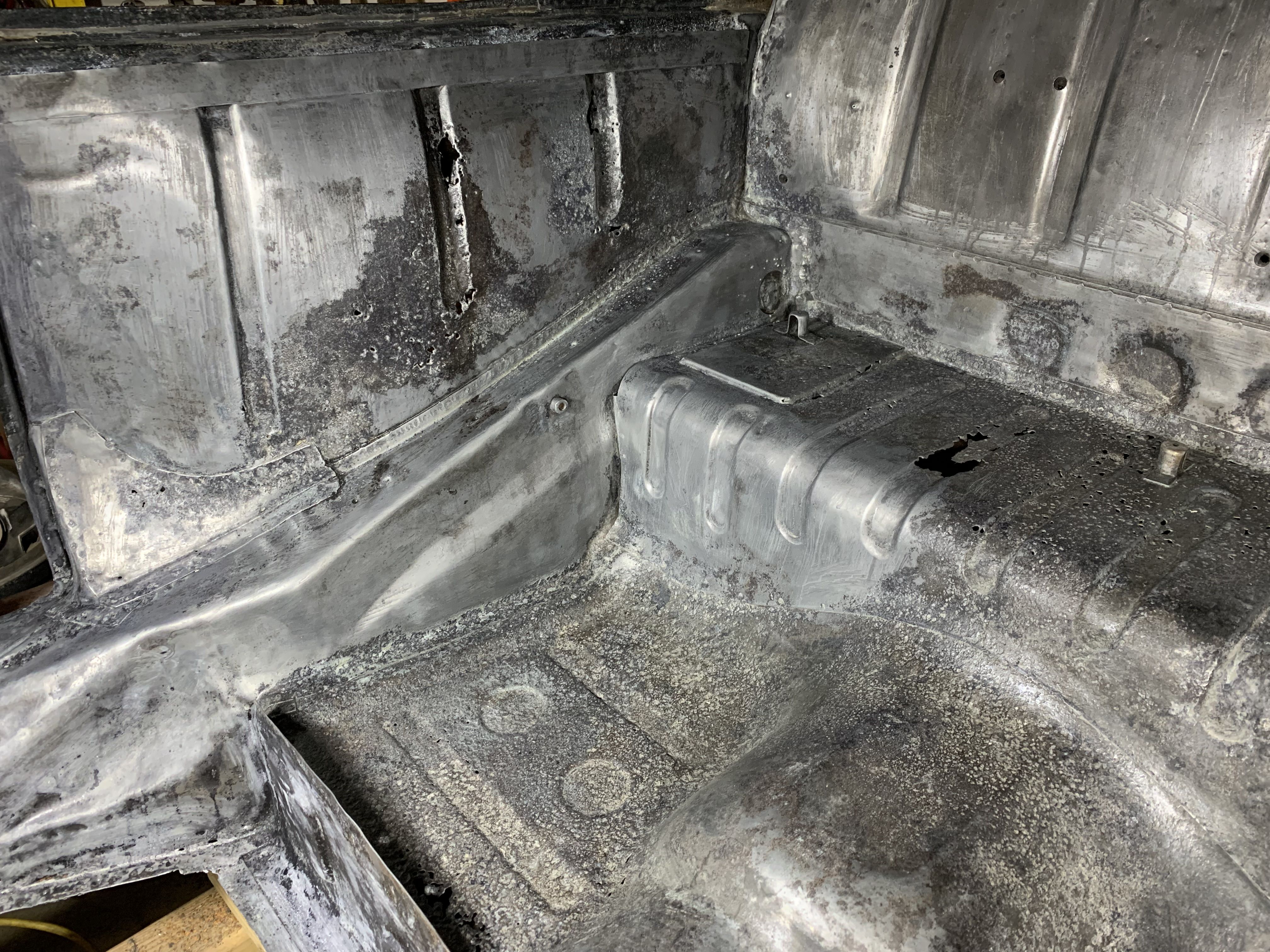

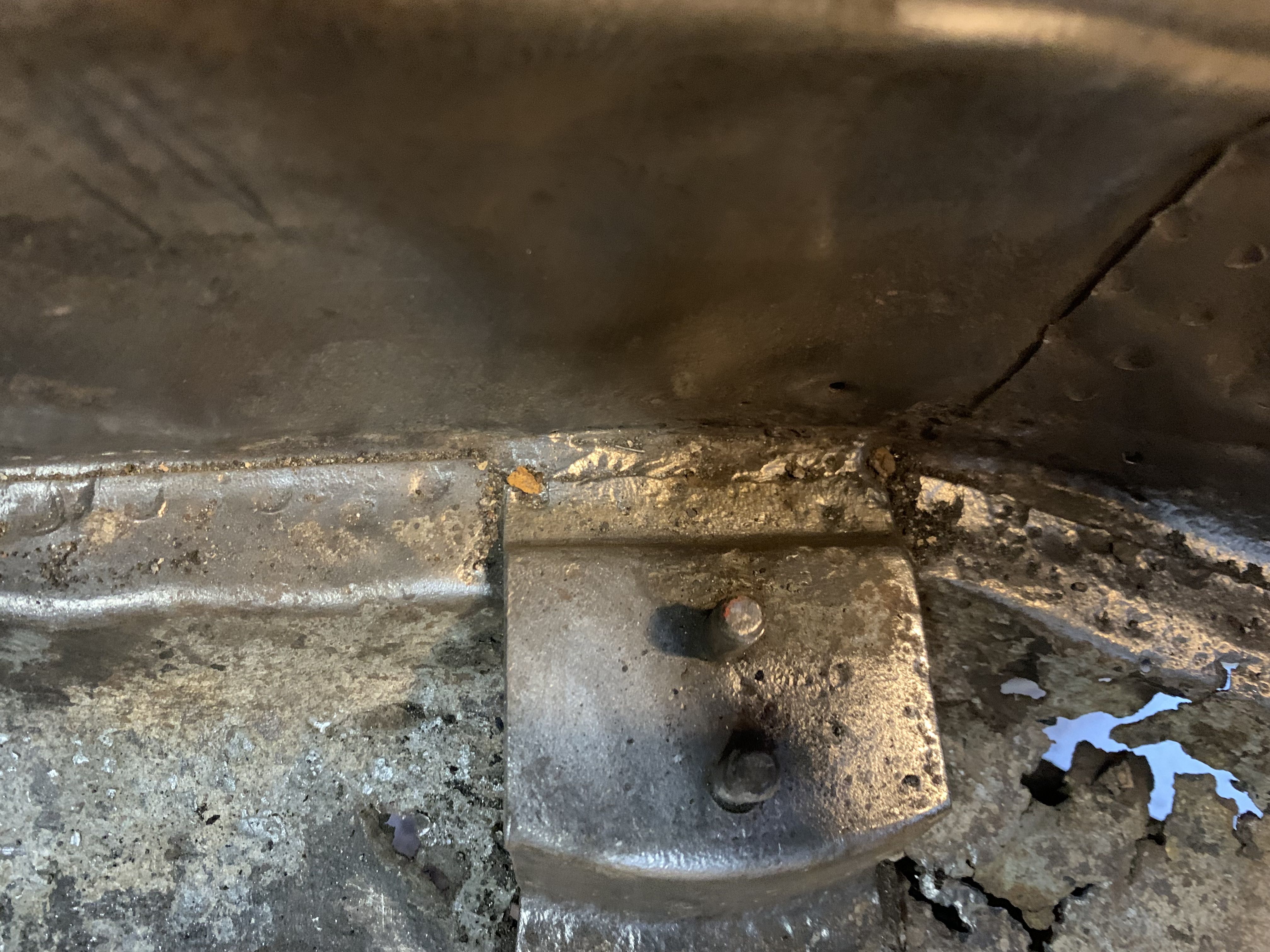

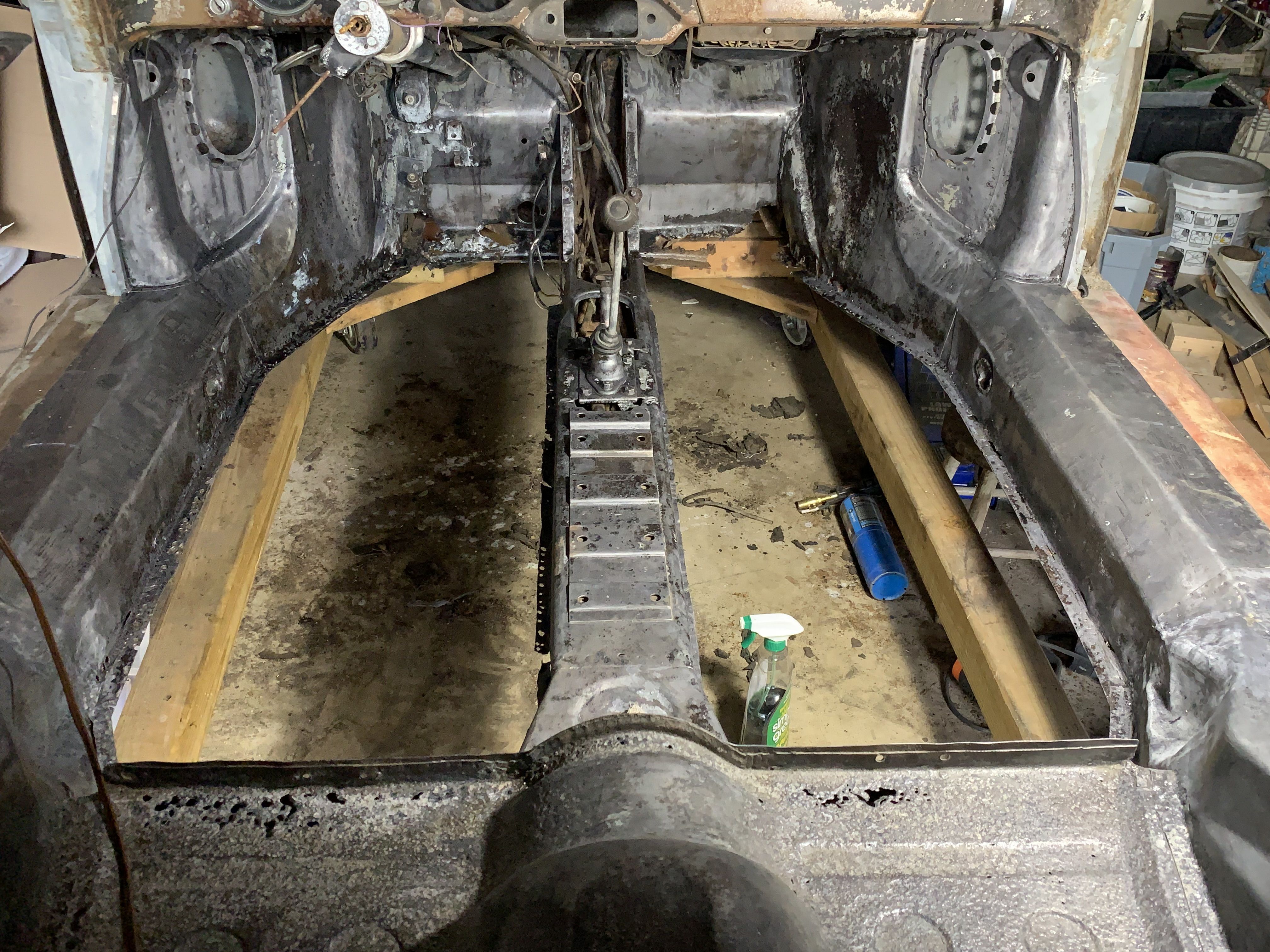

ID:	113582 Progress photos from my brush work on the floor pan, longitudinals, and shifter tunnel.

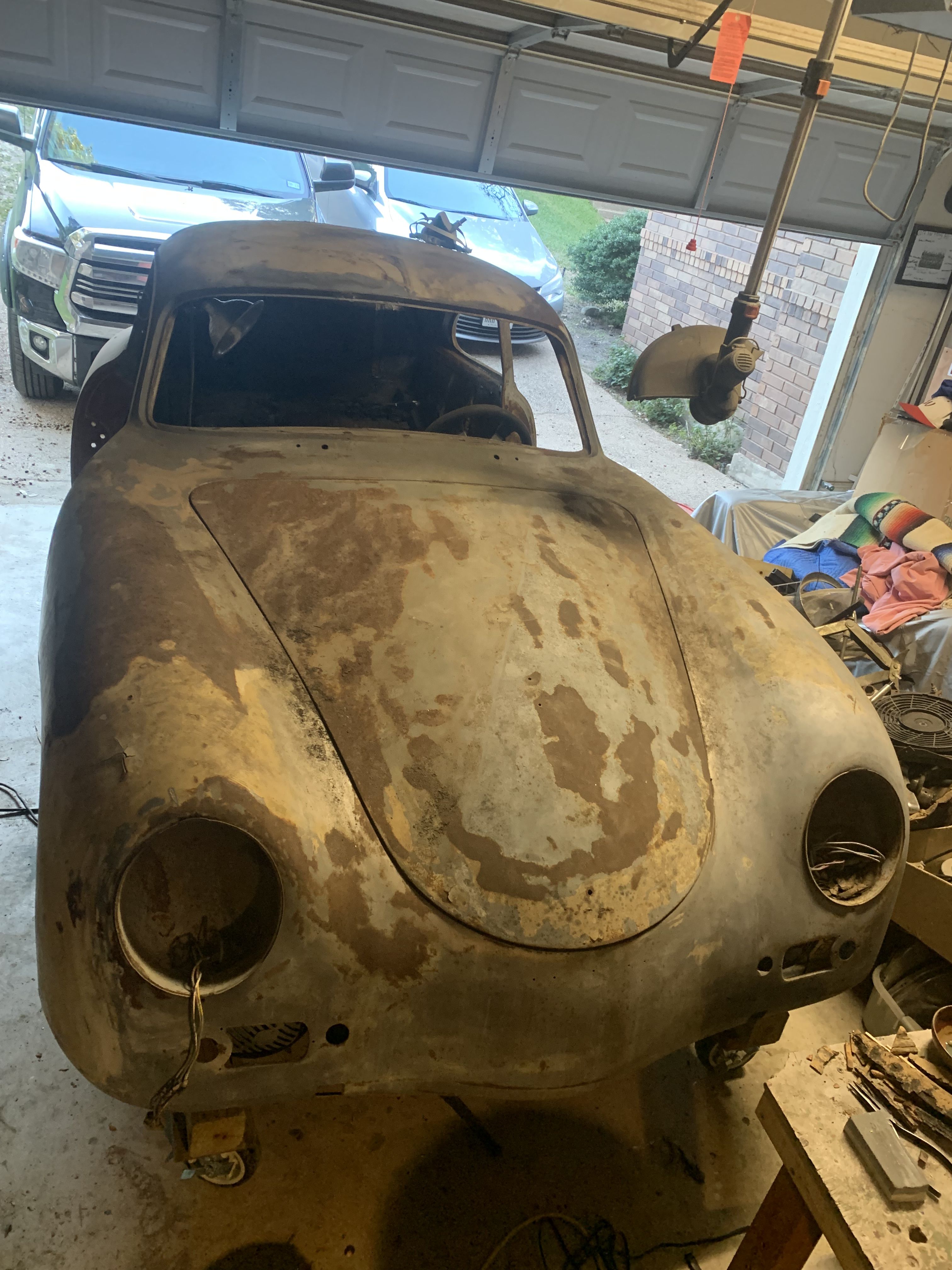

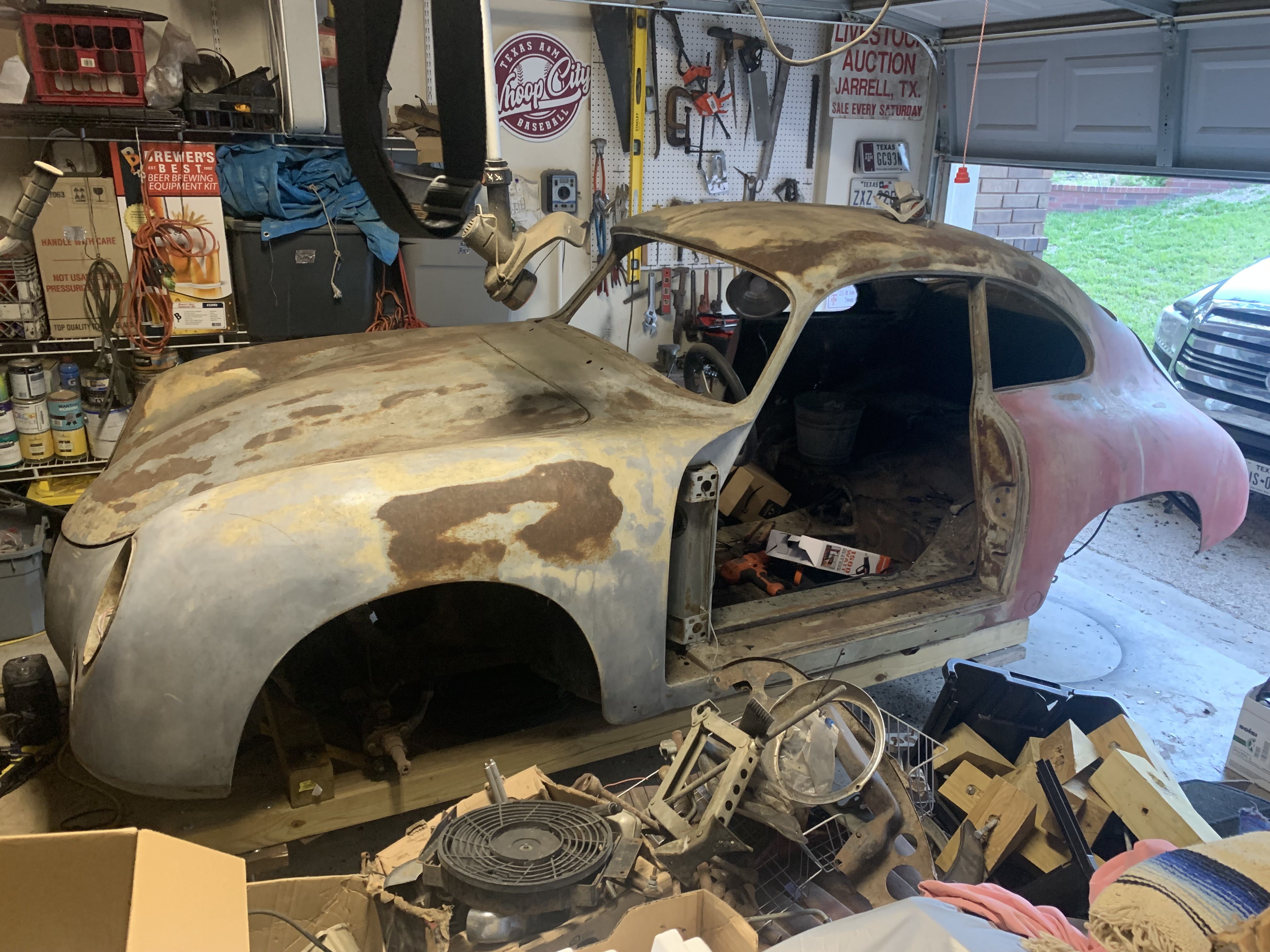

        I am helping Mark long distance with his tub. Its better than I expected. this is his first attempt at a resurrection, so everyone feel free to chime in and help him. He is in Austin Tx., He's a good guy, if anyone is close give him a call. He can always use the help.
          John - thank you! To everyone else - John is a great resource if you need help. He's mentoring me long distance and knows his stuff. Great guy.
            Mark, like you I have been through the restoration process on my 59 A coupe. but I started on it though now 54 years ago, Since then a lot has changed on equipment and methods . In my opinion your best resource is any one of Justins restorations. His way of doing it and the really helpful photo;s following each stage should be carefully studied. I only had oxy/acetelene welding gear in the early 70's when I did most of my welding so many choices now and after trying a Mig a few years ago, it would have been so useful back then. Its the same with so many tools, they are so important to have nearby. Look at each area to see if its problem is replicated on the forum. If you are replacing metal always make good templates, make sure you have accurate dimensions of the existing part. Justin always has another car to make comparisions with and don't trust that replica parts you buy will always just slot into place. I guess your 58 car is a T2 version like mine? There were 356A changes frrm the early T1 to the later T2.

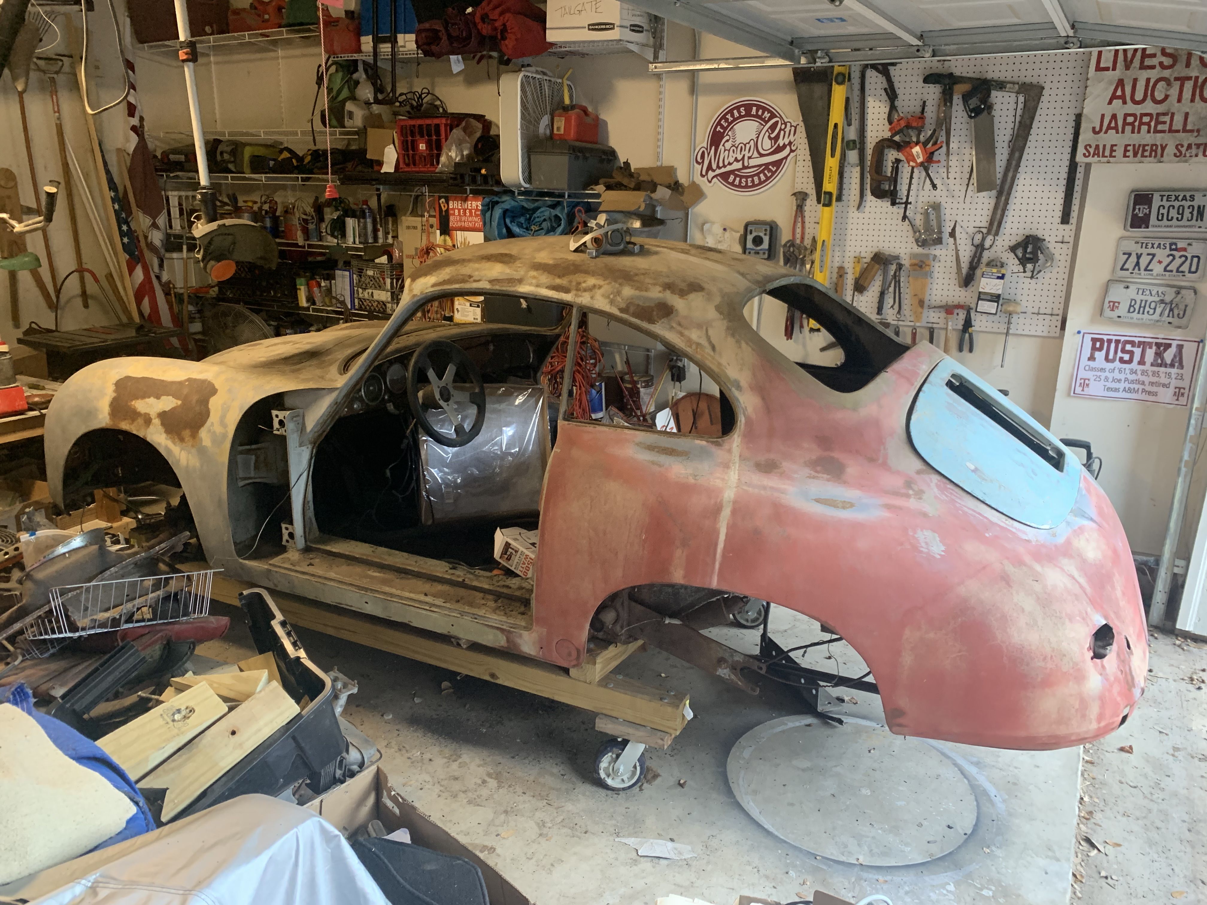

Name:	floor pan removal update 3.jpg
            Slow but sure progress on floor pan removal. Found a loaner rotisserie so as soon as I get it mounted should be easier than crawling under the tub to remove spot welds.
              A rotisserie is a must have for the lower steel work no two ways about it. I can imagine how miserable you must have been crawling in, around and under this car to get this far.

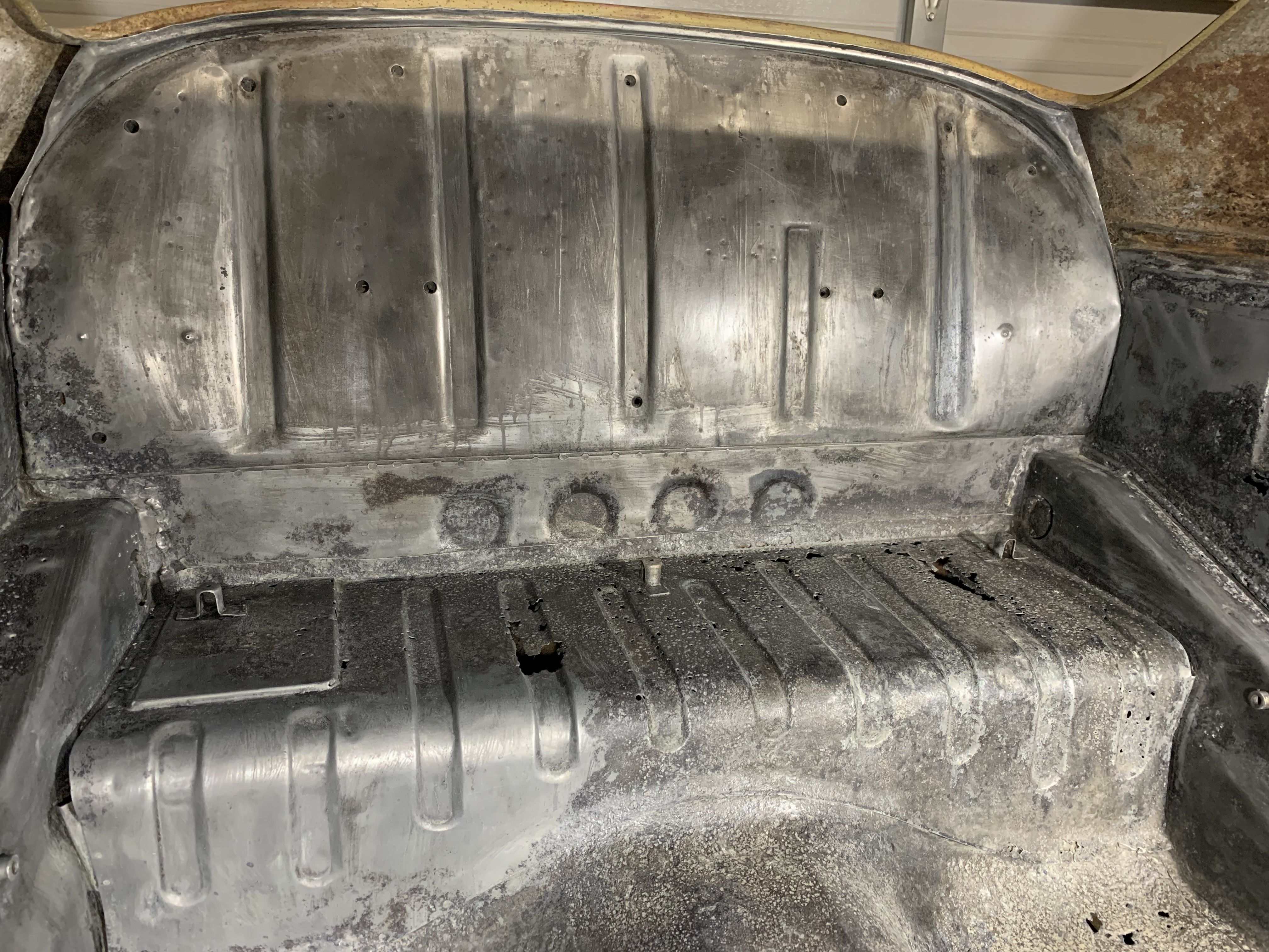

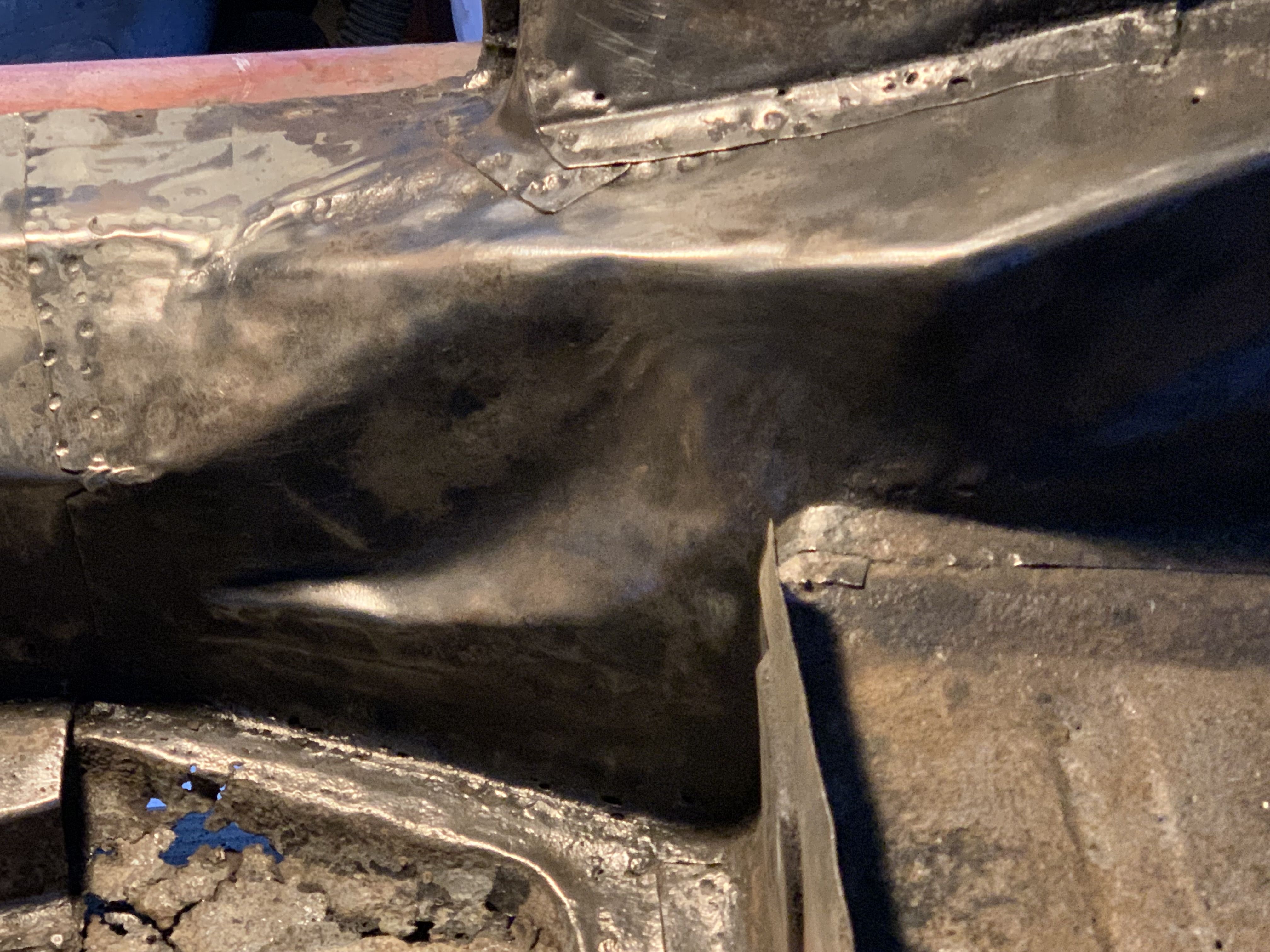

ID:	114028 Click image for larger version

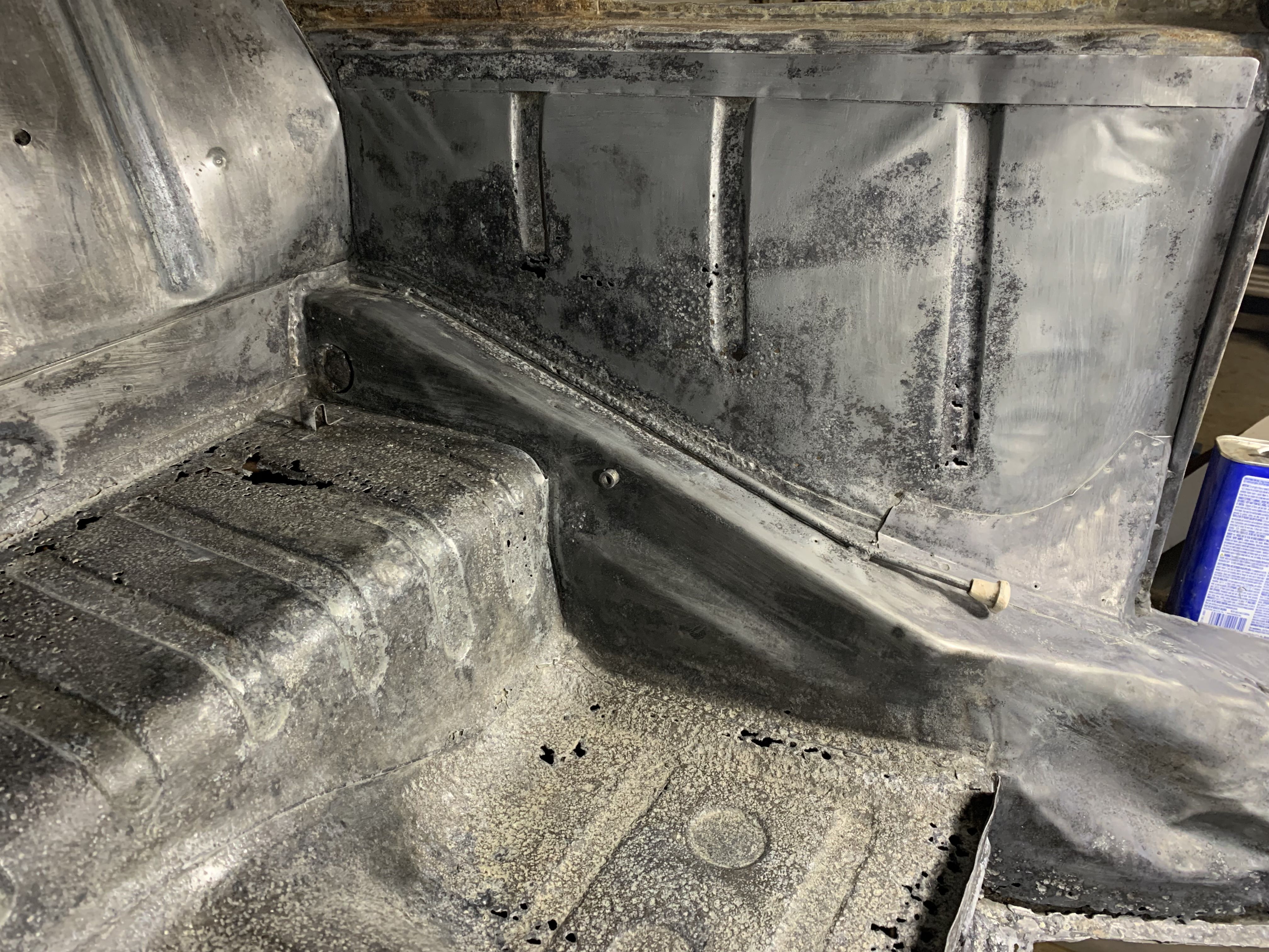

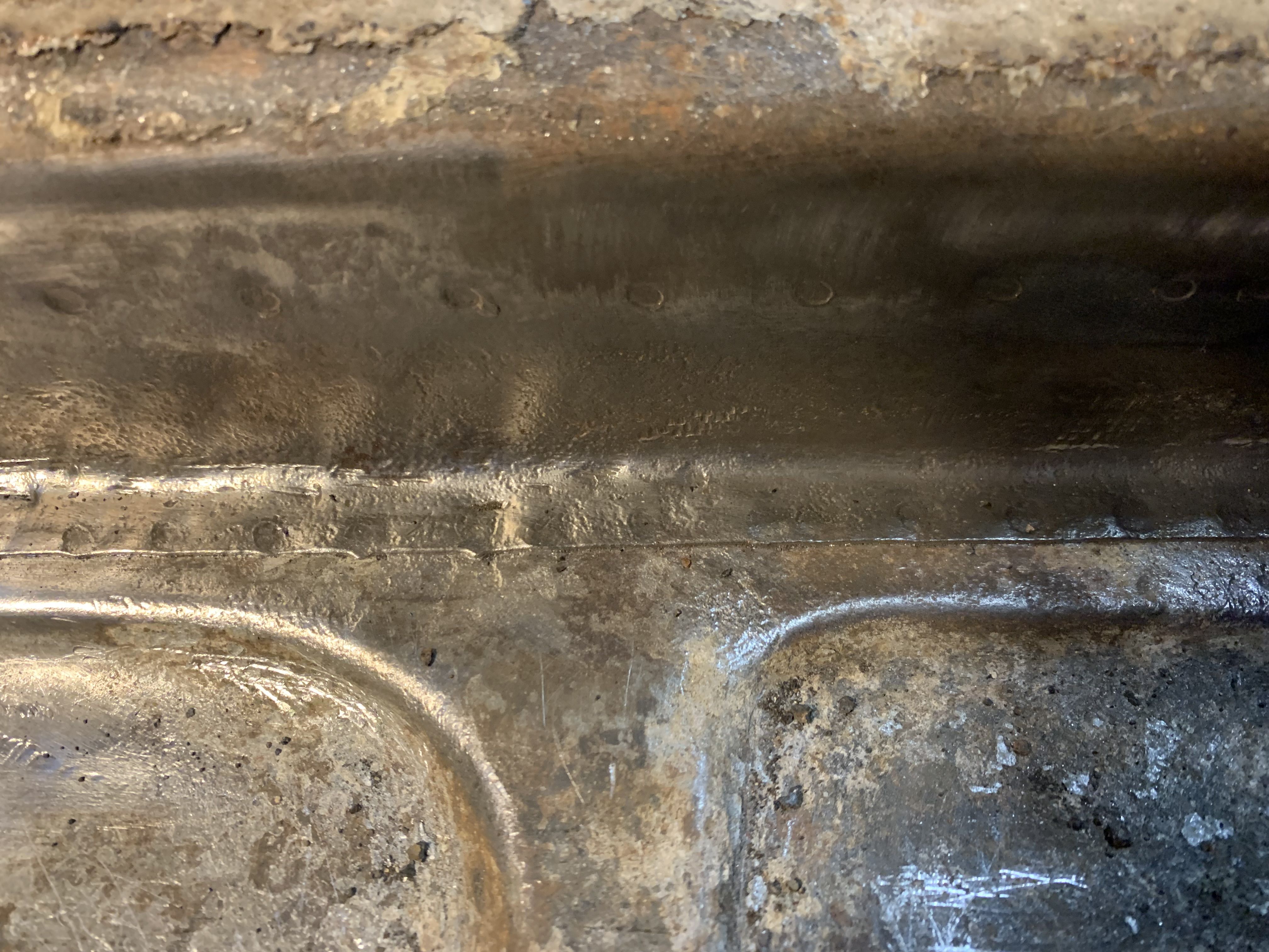

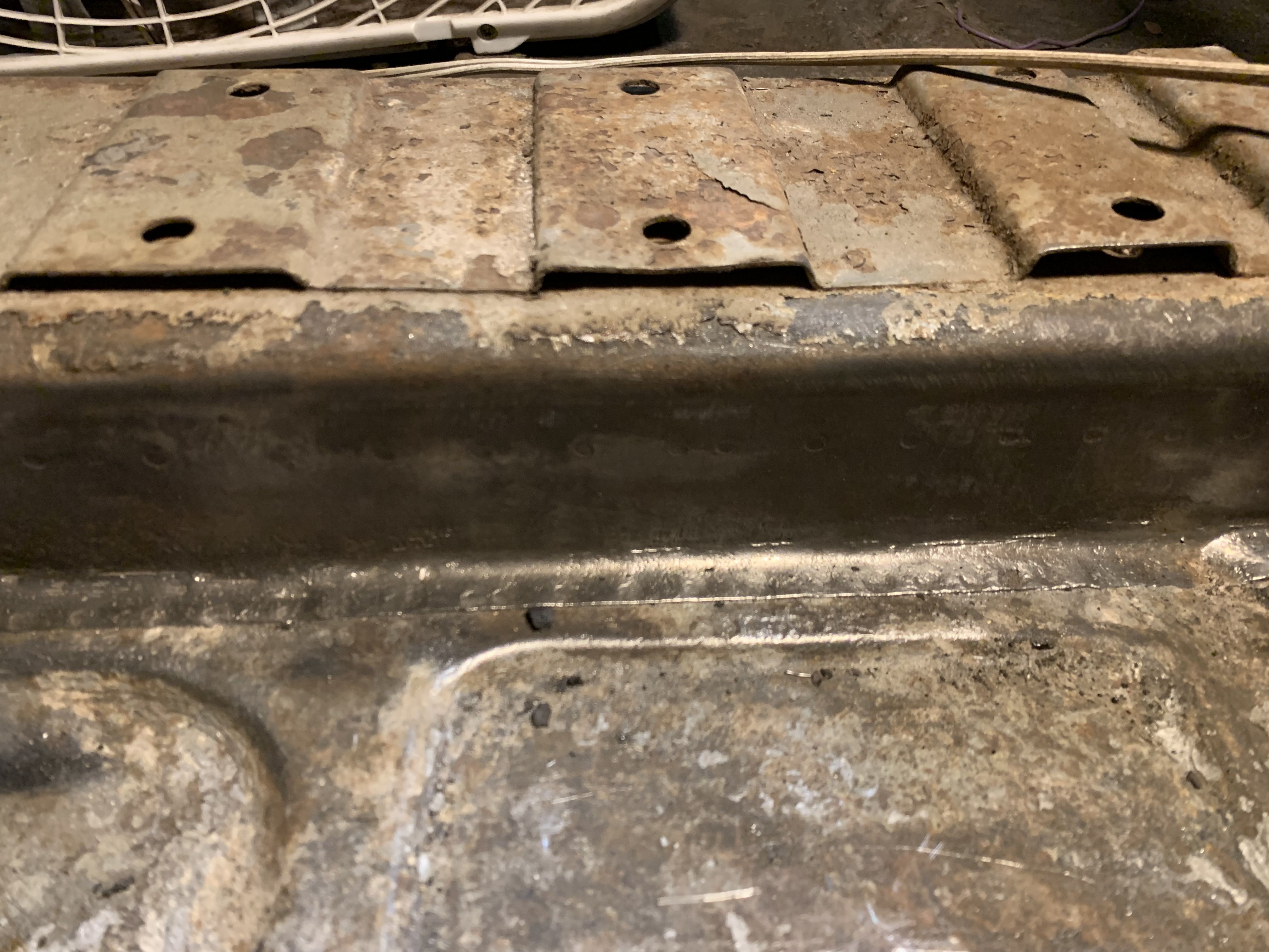

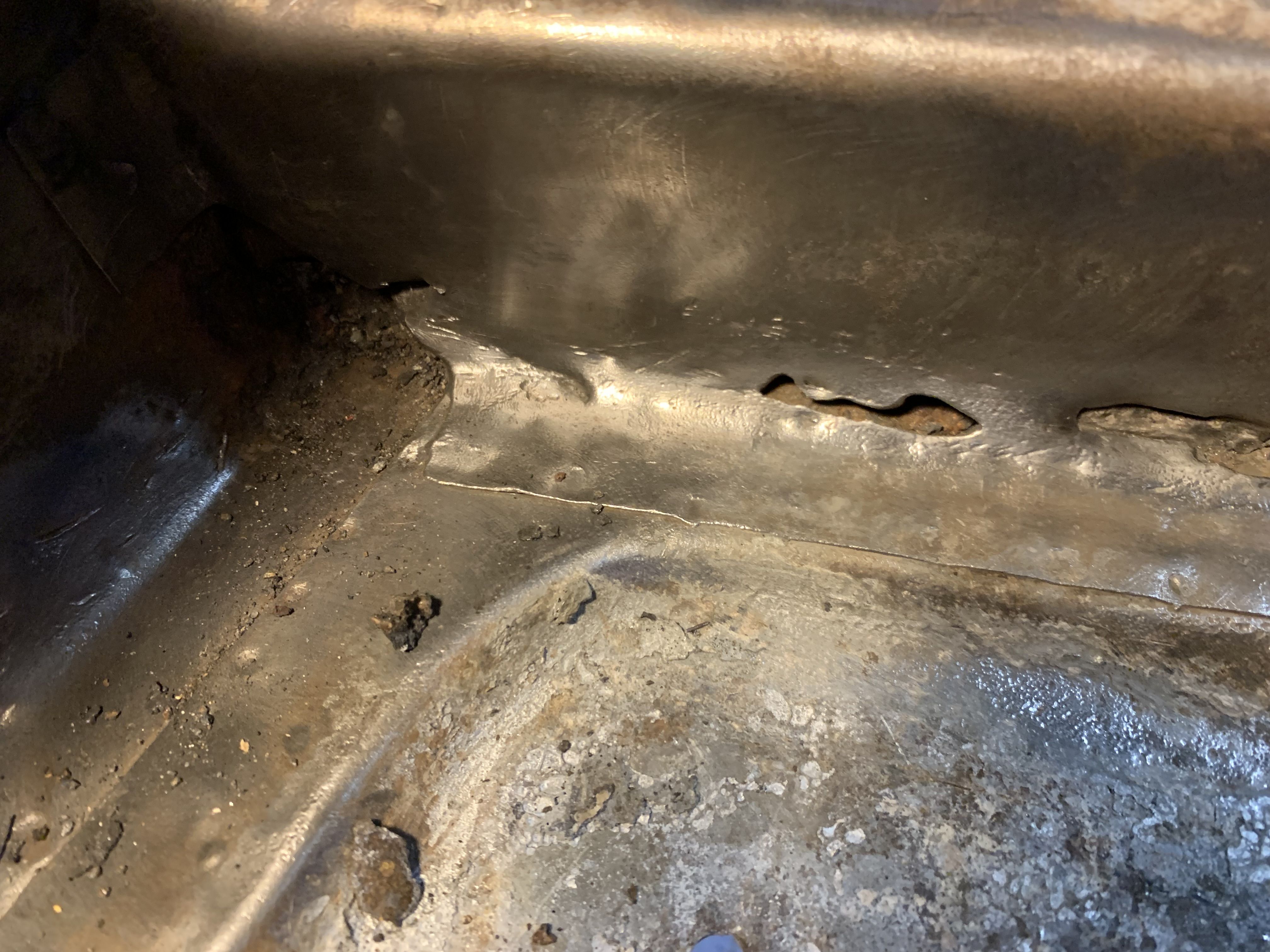

ID:	114031 Rust removed, Ospho applied, primer coming next.
              Looking good! The ospho treats the metal nicely. Based on the holes I'm seeing in your rear seat pan I would highly recommend removing the parcel shelf to clean and inspect the rust and how far it may have advanced inside there. Keep up the great progress.
            "highly recommend removing the parcel shelf to clean and inspect the rust and how far it may have advanced inside there" Assistance with what is the parcel shelf and how to remove it?
              Take a look here: 1959 356A S/R coupe project chassis # 108625 - ABCGT Forum​
              Begins toward the bottom of the page. Post # 409

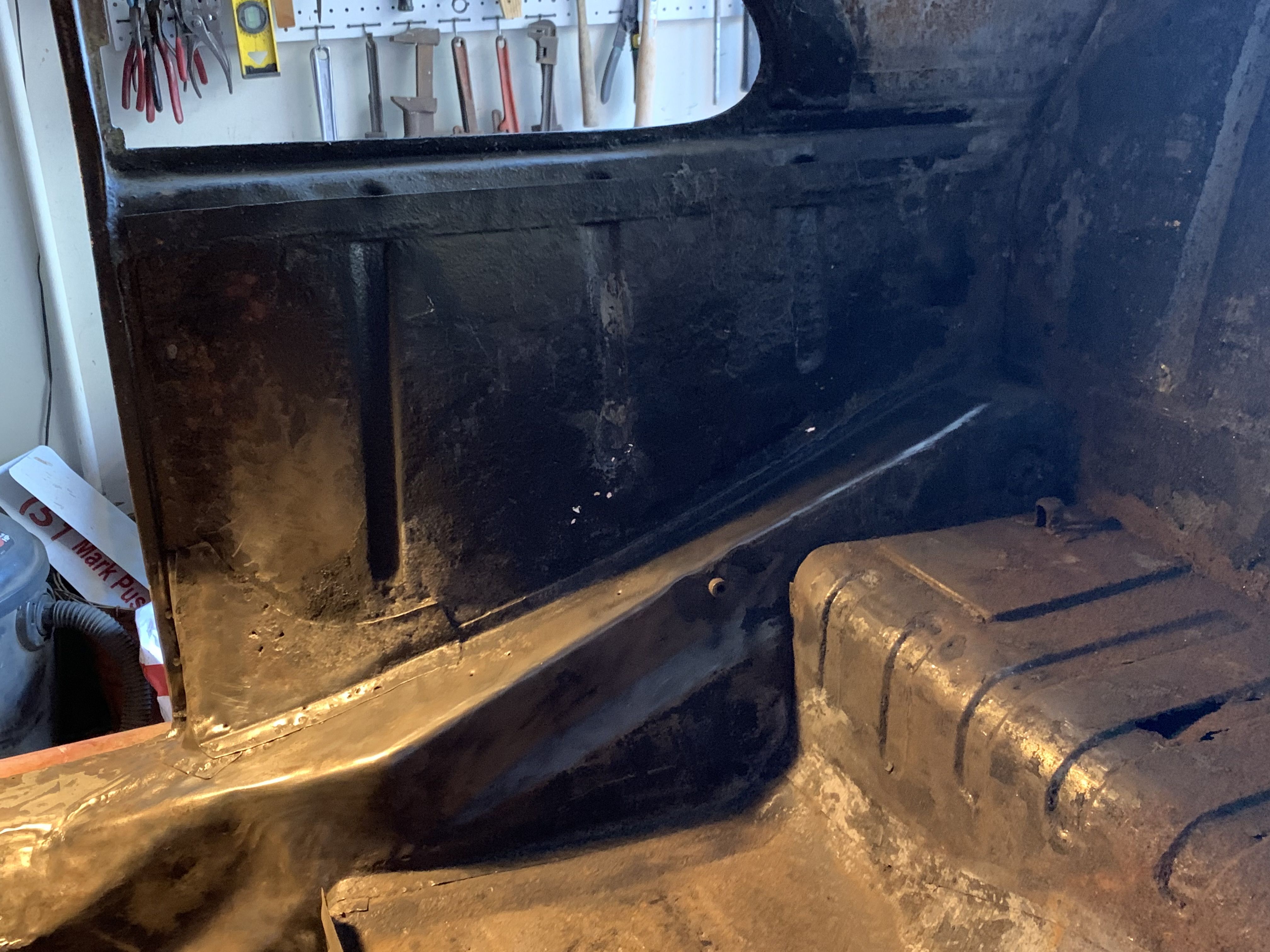

                One application of Top Coat to the interior.
                  Looking good. A fresh coat of sealer sure can change your perspective. Are you foregoing the inspection under the parcel shelf?
