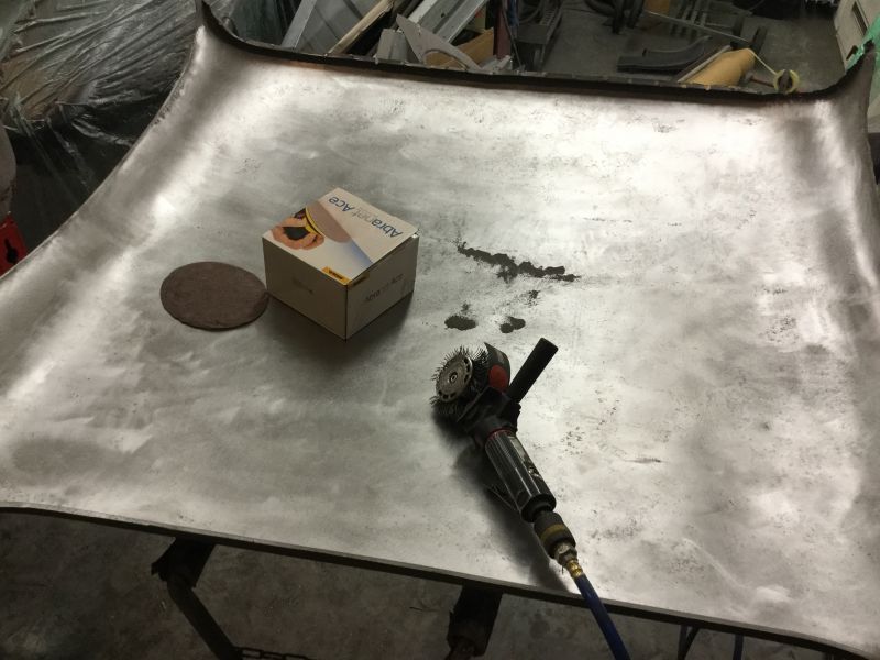

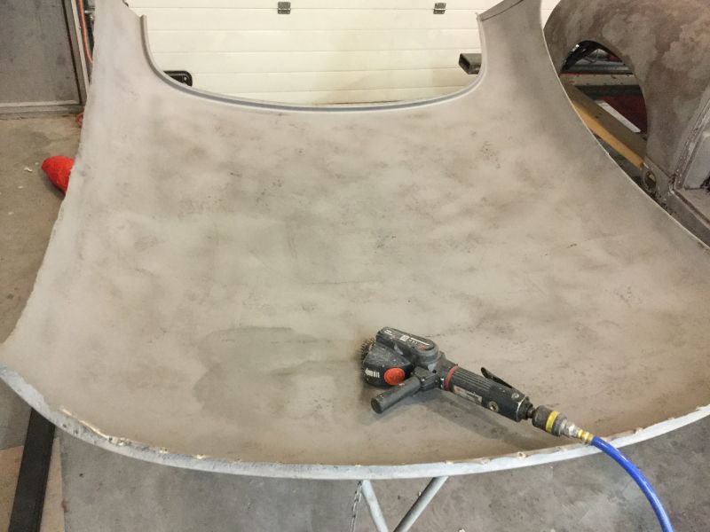

          Spend the day cleaning the roof donor,its not 100% but usable.
          At least a lot better then the current one.

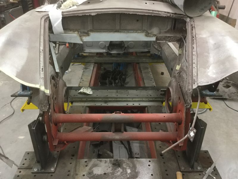

            A lot of hours spend,and rebuilding is starting

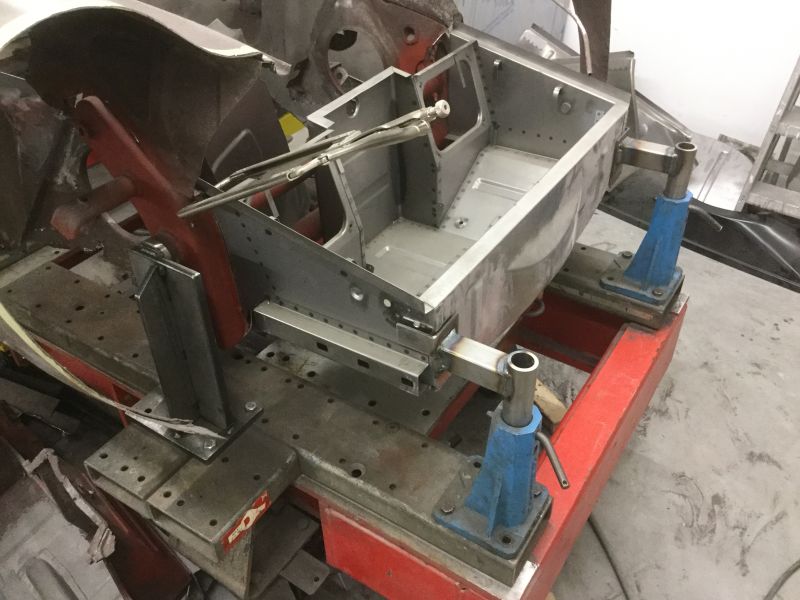

              We had the press pattern for the engine wall cnc made.

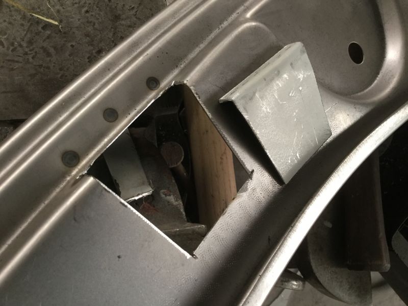

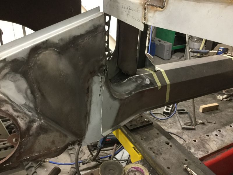

                A lot of work is involved around the A pillar.

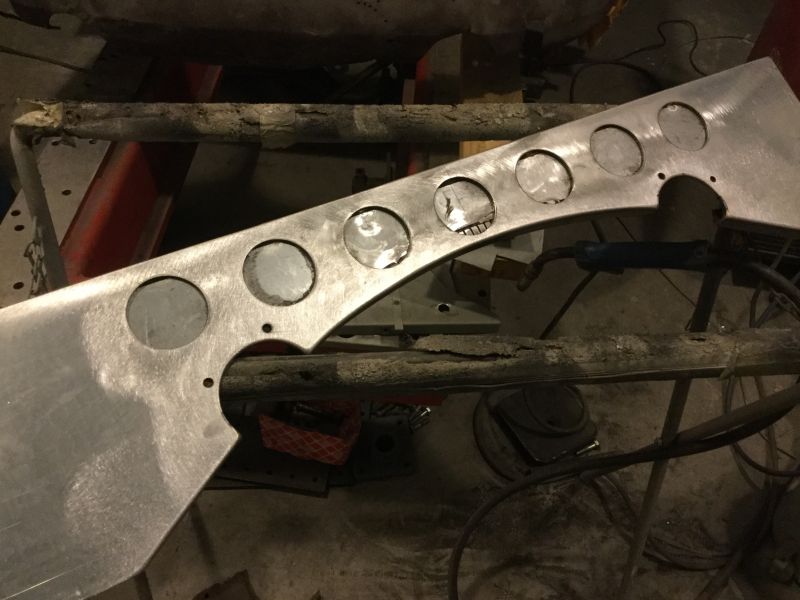

                  We had nothing to do,so we made these our self

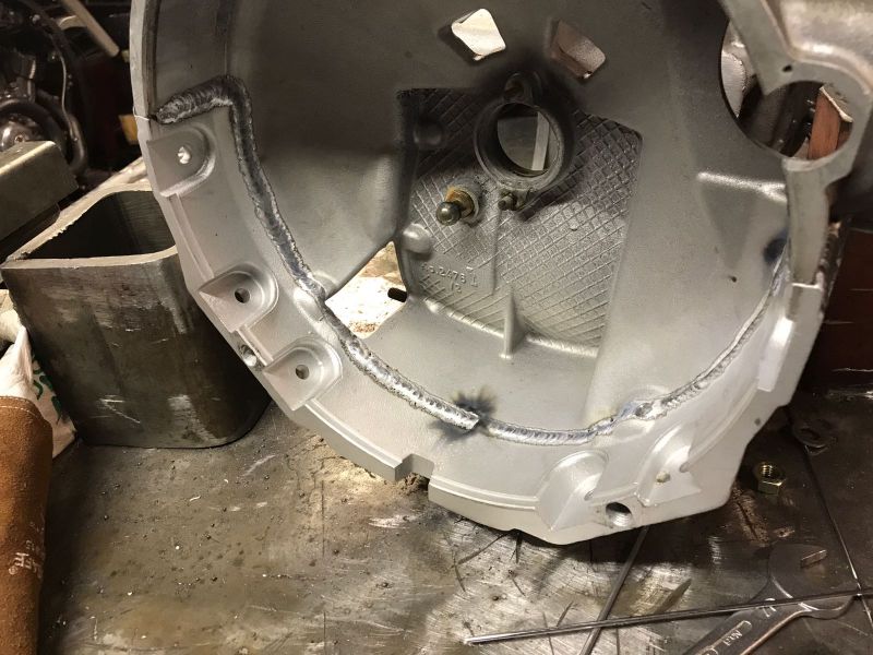

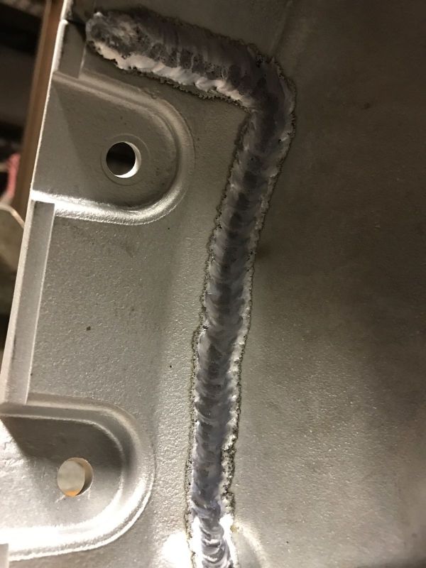

                  Justin's welding of his cam heads inspired me to some welding of my own.
                  Would like to try to mate a 5 speed to this project,wonder if this could work.
                  Anybody on the board tried it this way?
                    Looking great Dave! The extent of the chassis work puts me directly in mind of the beautiful recreation work Neil Blaber is doing with his car.
                    Love the bell housing graft! I don't think its been done this way before and as 356 transmission get even more valuable I don't think anyone will sacrifice one to follow you. Dean welds on the extra material needed at the motor mount area then the holes and relief are machined in. I'll let you in on a little secret I learned completely by the accident of having that particular transmission on hand. A 1969 magnesium version 901 transmission's bell housing for whatever the reason has all those reliefs and embossments in it for an almost direct fit with a 356 hoop. I simply drilled the 4 holes in the reliefs and had the hoop bolted right up to it. Anyway, its another way of skinning this cat. Keep up the great work!!!!!!

                      I bought a damaged gear case at ebay,it was only 125$ so perfect to cut the part out.
                      The complete original drivetrain i still have.

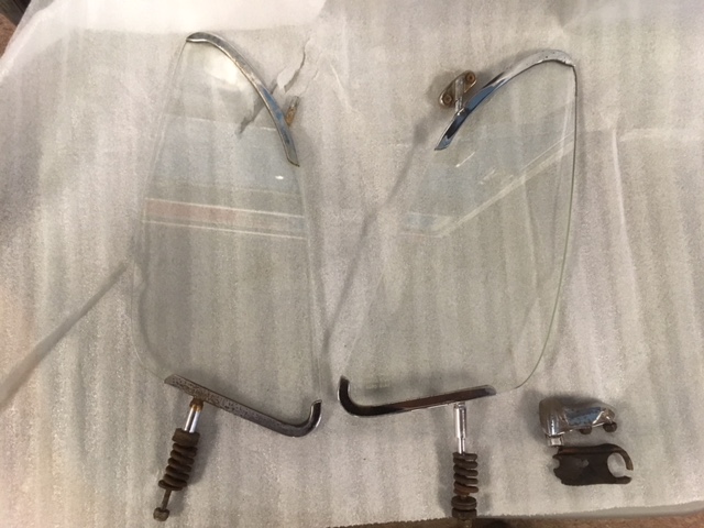

                      Just fond these wind wings on the web,a little resto project on them self!
                      If anybody has a lead on door holder i would be greatfull.

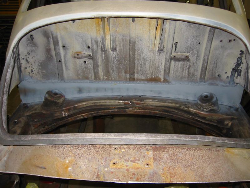

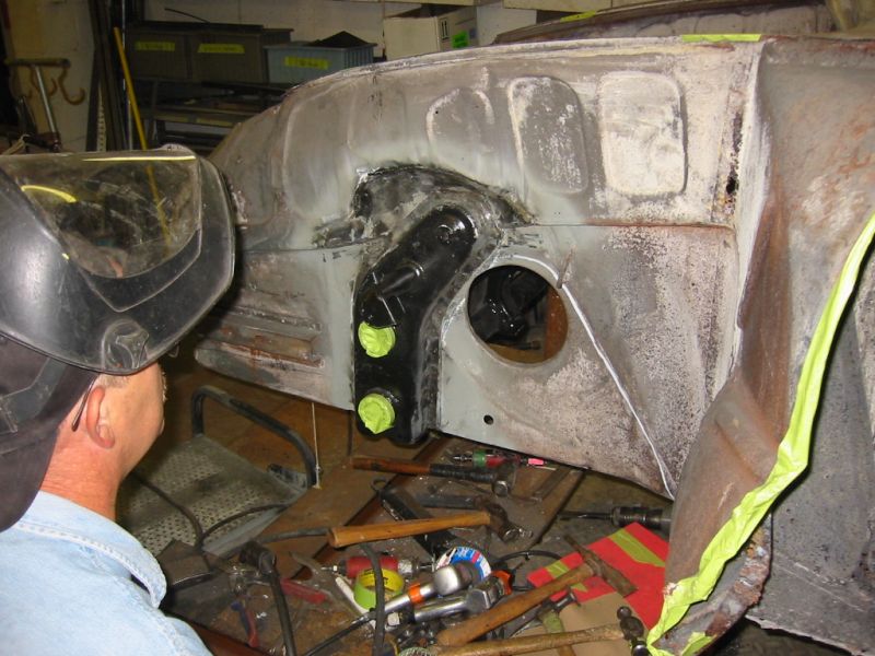

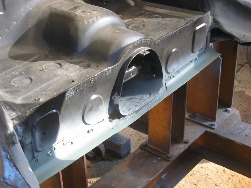

                        That was a good donor candidate then. As far as the 901 SWB conversion itself its very straight forward. The original torsion housing can be used in its stock location with the only the addition of the banana arm pivot points required. I've seen some where the stock rear 356 upper shock mount is still utilized with the 901 trailing arms. It may work okay but the geometry is obviously different from swing Axle to IRS so I find it a little half-assed. Porsche moved and angled the upper mounts inward for a reason which is why if it where me I'd graft in (or fabricate) the correct 901 cross-member with shock mounts to properly complete the conversion. You're doing a full on Hot Rod so you have all the liberty in the world.

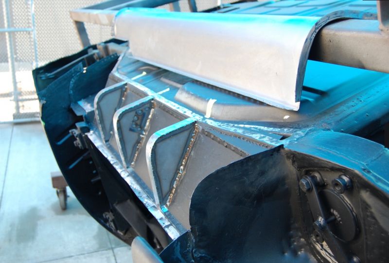

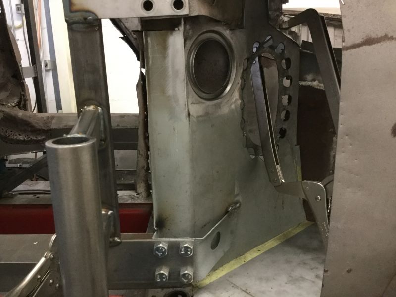

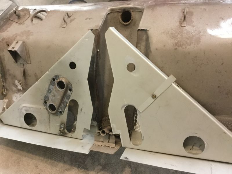

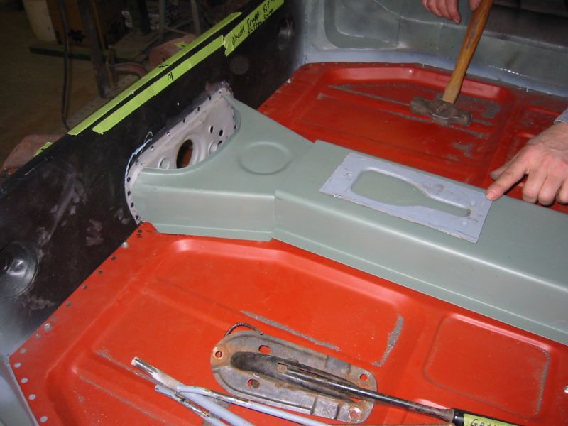

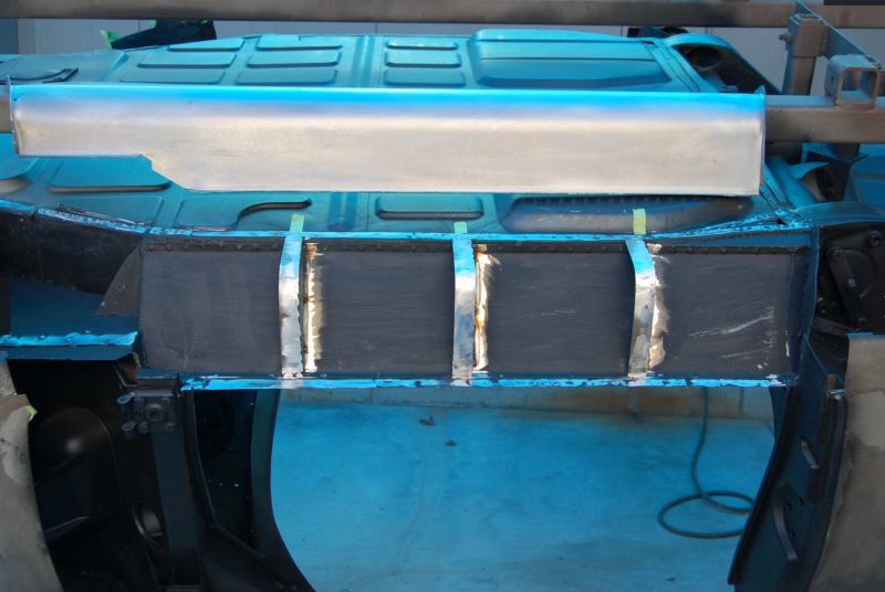

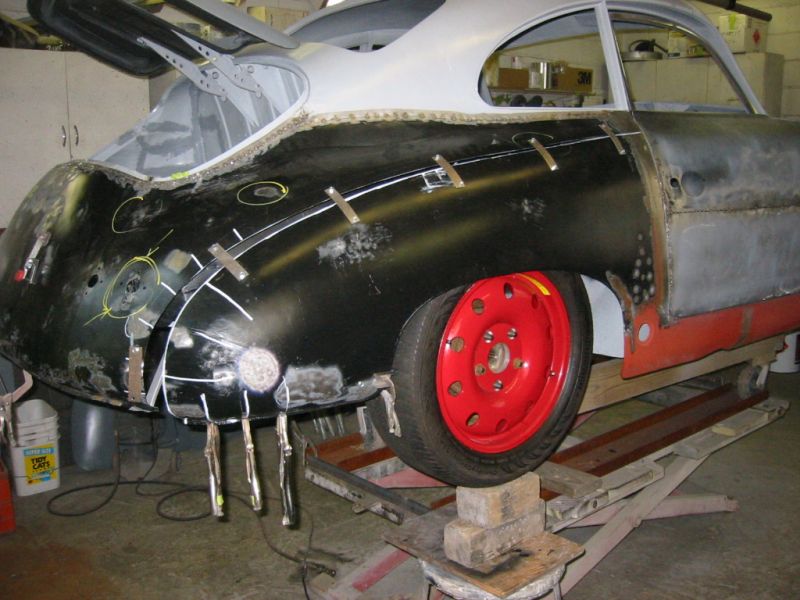

                          Pics found from a '52 shell 'outlaw' project that had the later front adjustable t-bar tubes added and the whole "modified" rear from an early 900-series donor so the IRS suspension and 5-spd could be used. The original plan was for a Polo motor, but a Massive IV 2.4 was finally installed.
                          • #28
                            Thanks Bruce, I was hoping you'd share those shots.

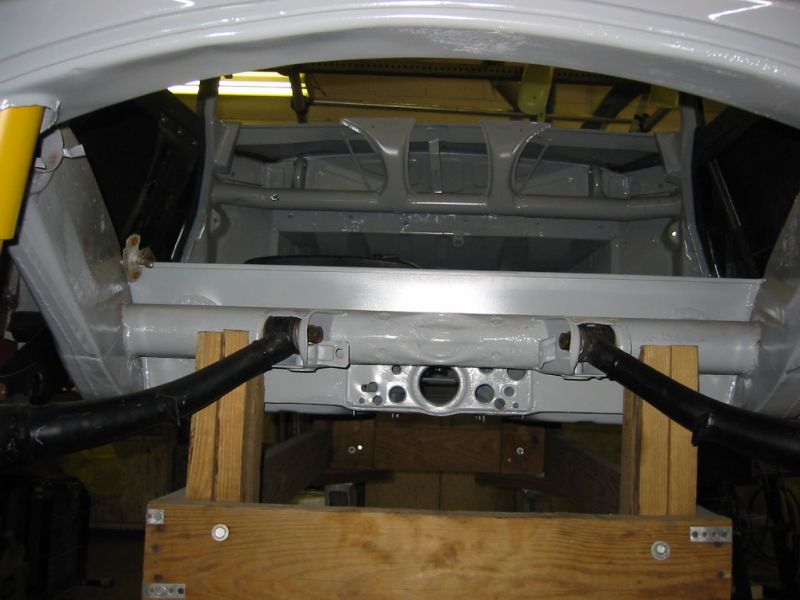

                            • #29

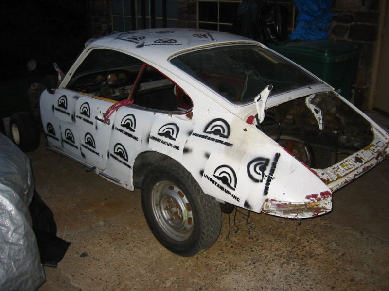

                              Donor car
                              Update front suspension
                              Make rear bulkhead and tunnel work together
                              Making more room

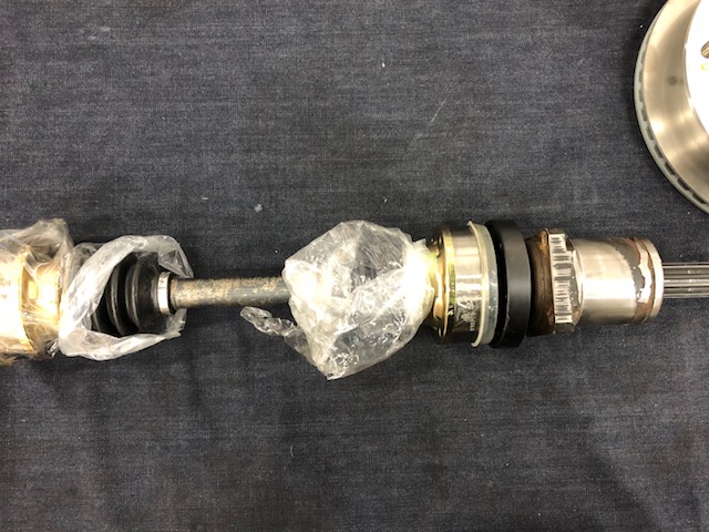

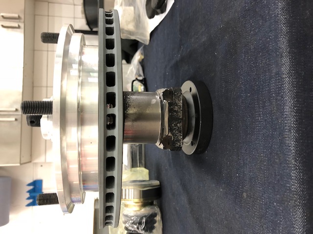

                                I found the way to go to stock width by using a 100 mm flange on the gearbox,and a 944 bearing house that i will use on the swb rear trailing arms.
                                This way i am able to go to disc brake and maintaining the 5x205 setup.
