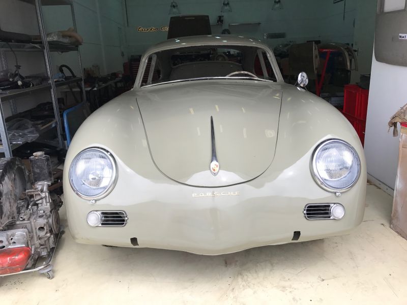

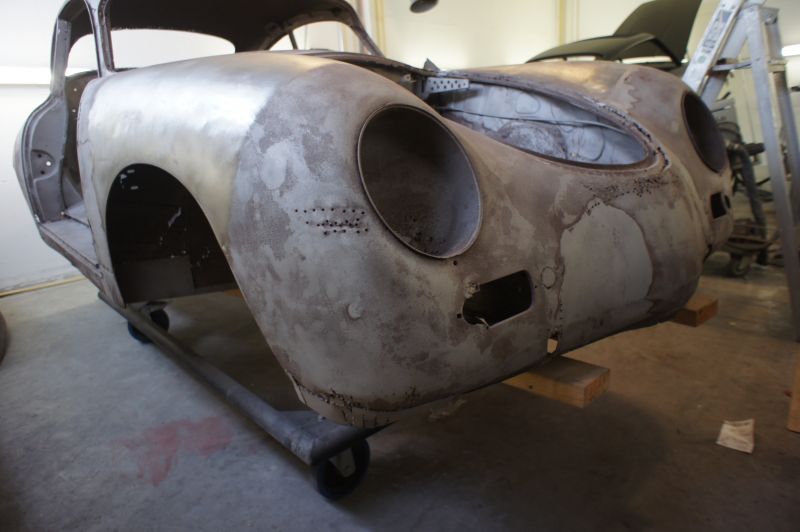

Captain Nemo's 356 A
  • Captain Nemo's 356 A
    Why Captain Nemo?
    Because it looks like it has bin on the bottom of the ocean for a while.
    Thought of scrapping the whole car after the chassis came back from the stripper.
    The amount of bondo that cam of this car was shocking.

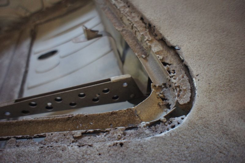

    The new sheet is not done by me,but previous owner.
    just tag welded,wonder what would have happened if anybody would have run this on the road

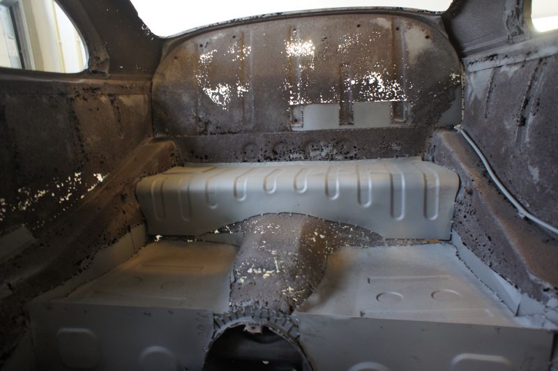

    A few more,to rub myself in..

      Hi Dave,
      Very sorry to see this.
      I just can't believe this is the same car. You just never know what you're in for once you get past all that shiny paint. Just based on the back seat shot I don't see any thing frame related that is savable and can be welded to. I imagine the front is about the same. If that is the case you're essentially starting with front and rear torsion housings and recreating out from there. What is your plan? Find another chassis?
      Again very sorry that you're in this position.

            Its frightening to think just how many 356 cars will have been purchased in good faith looking nice and then the owners thinking they are okay and then driving them. Only the serious guys strip them for media blasting. I do feel very sorry you, some of the rust you would not, or anyone else not have seen, until the interior was wet everywhere inside after a very wet drive in rainy weather. I hope you didn't pay a lot for it, just where is there any sound areas to weld to?
            If you have studied Justin's restorations you will see its many years of work not months and thats just for the chassis and bodywork. Out of interest, how bad is the torsion bar and suspension areas front and back? I presume even worse than the rear inside views??

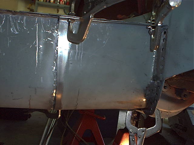

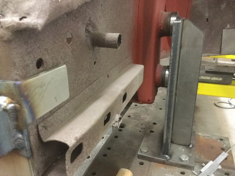

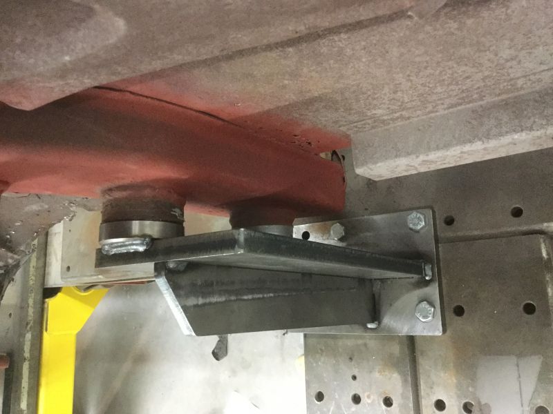

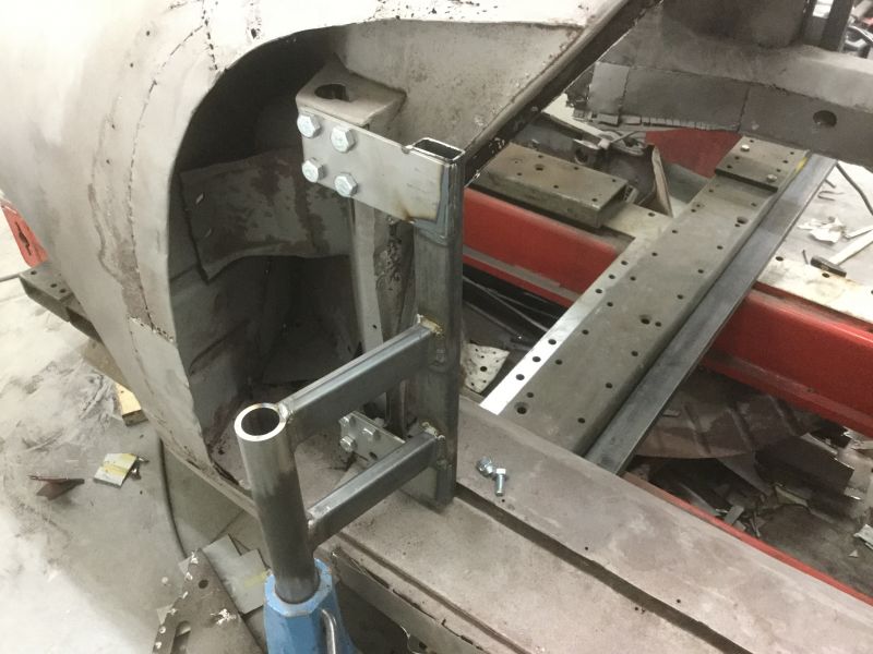

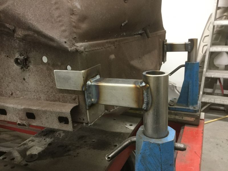

                Finalized the pickup point fixing,an start cutting today.
                As this is my first 356 project i can need all the advise from this forum!

                  Nice work on that tooling, are you a machinist? With that type of ability you should be good to go.
                  Best Luck!
                  DC
                    Yes looks like good fixturization there. Its all about datum points and those look professional to me.
                    Something tells me you have more experience than I first thought, pleased too your time estimations tally with reality.
                    This could prove to be a very interesting thread indeed.
                      what Roy said^^ with knowledge and good equipment you can do almost anything. looking forward to following you on this.
                      Jay D.

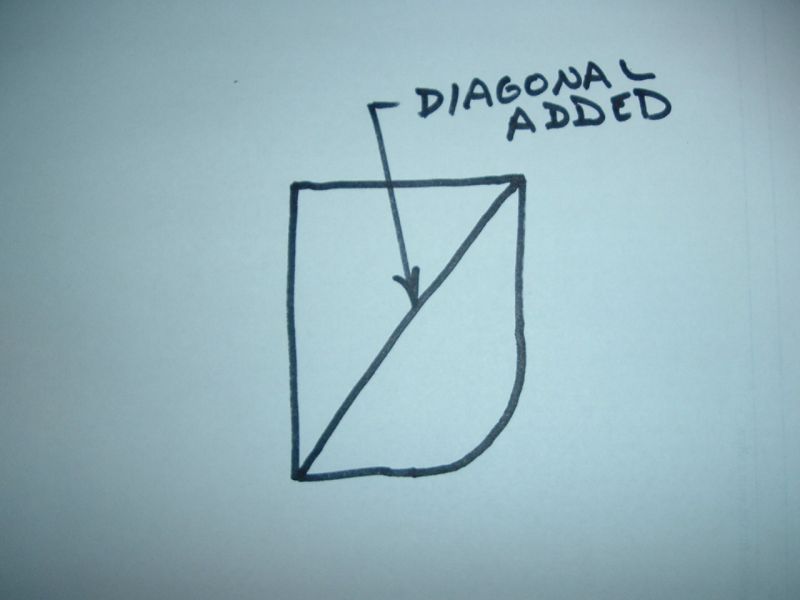

                          Dave,
                          I saw that a long time ago on one of Wilhoit's build photos. If I remember right he eliminates the heat pipe supports and adds a diagonal the full length of the longitudinal. I think this was done only on open top cars... I might be wrong. I don't know what he does about the heat pipe... eliminates it?
