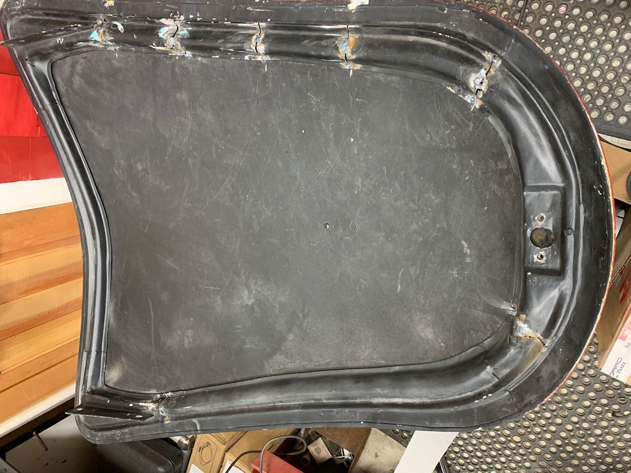

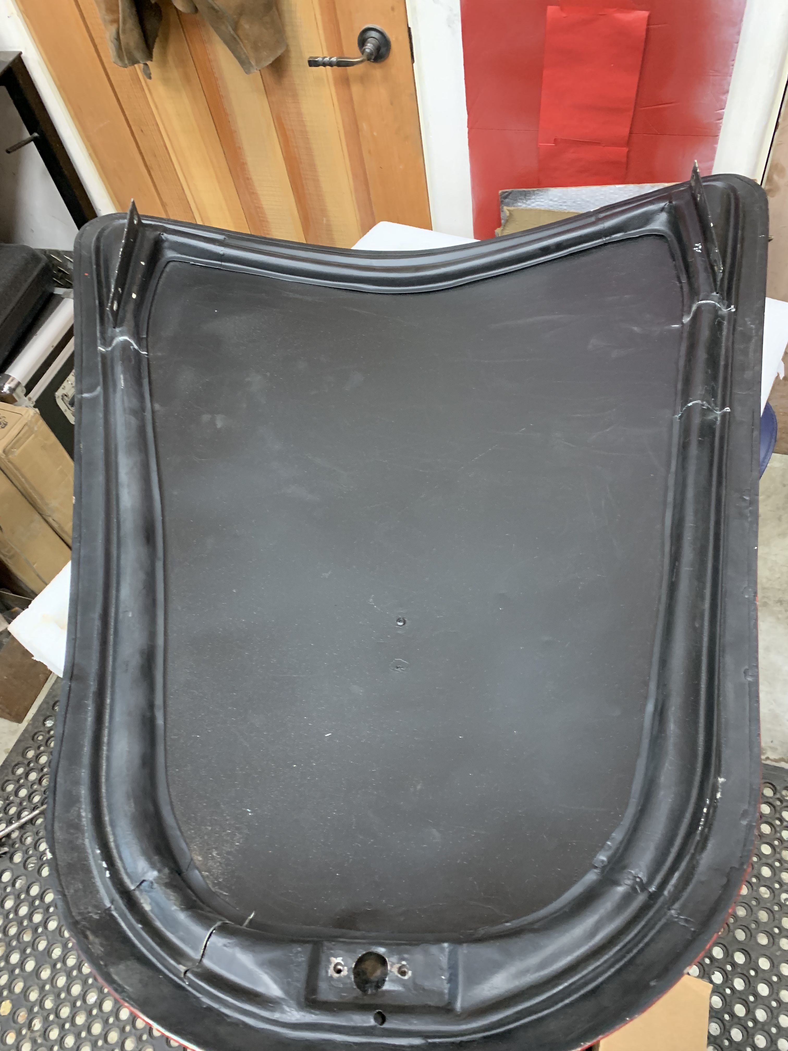

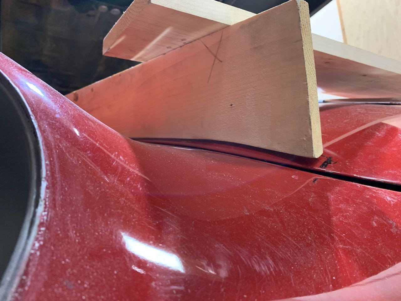

    I made some progress, but not enough. I cut the frame in five places, clamped wood forms that matched the contour I wanted, then tack welded the frame cuts. Now the rear corners and the left side fit fine, but the twist was reduced only about 50%.

      Really nice profile jig. Interested to see how it worked out for you.
    Dave, I have read your thread more than twice! I can follow the considerable effort you have made to try to correct it so far. The wooden former you made I presume from the left side of the car seems to follow the lid of the bonnet very well when you clamped it. So when you welded did it follow that shape when unclamped? Was the car in a right side impact to do that damage and are you sure the right side front wing ( fender ) is perfect for shape where it meets the lid? I guess with that considerable error of kink it must be clearly possible to see by eye?
    Trouble is photos are good but not like actually seeing it . In other words was it just the front bonnet lid that ended up damaged with that kink?
      Justin and Roy, thanks for the nice words.
      Roy, thanks for following the somewhat convoluted path I have been on. I am learning as I go, so the path so far is two steps forward one back. The repairs to the hood are a consequence of repair work done back in the 80's, when a front clip was installed and hood and cowl damage were repaired. Evidently the shop did not know how to weld, so they used bondo and pop-rivets to fix the hood kink. The front end looks ok, but it is not symmetric from side to side (hard to see). I would love to remove the front clip and correct everything, but I want to actually get the car back on the road in a finite amount of time, so my approach is more pragmatic. I am trying to do fix everything I can short of major surgery.

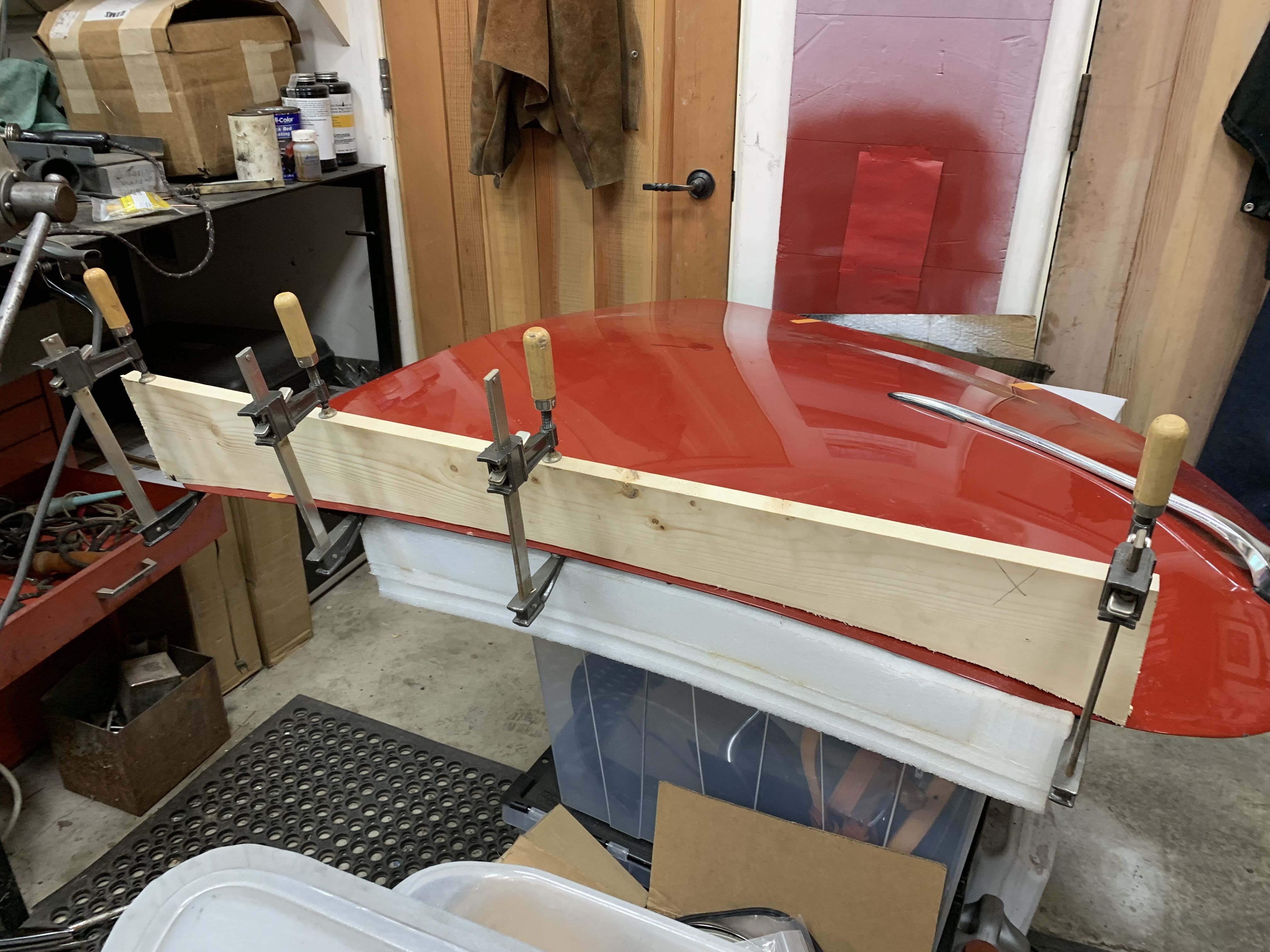

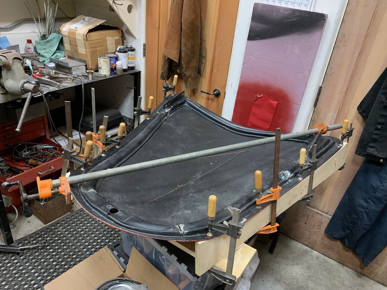

      Since the photo above the jig underwent a transformation. Originally two pine 1x6x42" (25x150x1066mm) templates were made, one for each side, since the sides are not the same and the contour goes the opposite direction. I made the rough template by tracing the outline of the fender (right at the hood opening) onto the board and cut the board with the bandsaw. Then I put the hood in place and set the template on the hood and adjusted the template using a sander so that the bottom of the template matched the slope of the hood (the slope varied from front to back).

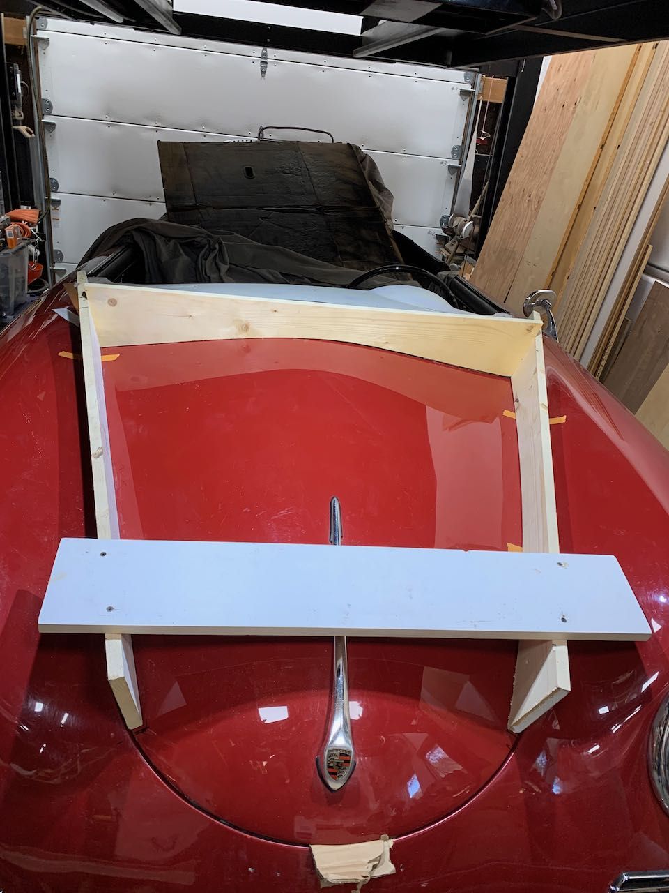

      To use the templates, first I cut the metal support frame of the hood as shown in the photo above and clamped it to the templates, then tack-welded the cuts. The first attempt was encouraging, but the hood had some twist. Next I tried two things: I added wood supports to join the templates into a cradle, put a clamp on the hood diagonally to counteract the twist, and went through another iteration of cutting the tack welds and re-tacking. This time the results were really good but the twist went the other direction and the right side needed some correction on the contour . Had to find the sweet spot for the diagonal clamp.

      So I modified the right template to give more clearance in front and rear, and did another iteration, this time with the diagonal clamp barely clamping. It came out perfect, or at least as good as I was going to get it so I decided to fully weld the cuts in the frame.

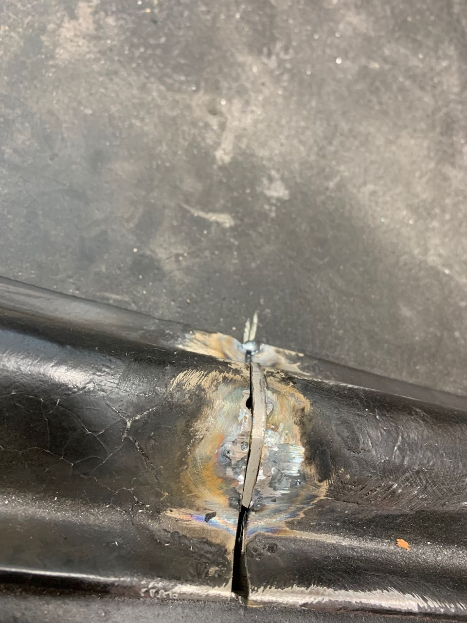

      But when I fully welded them, I had problems. The welds shrunk enough to lift the hood off the form when the clamps were removed. I'm currently re-welding and working on techniques to minimize and compensate for shrinkage. Here is a photo of how I prepped the original tack welds. The new batch will have full inserts in each slot. It seems to help since I can get away with lighter welding.

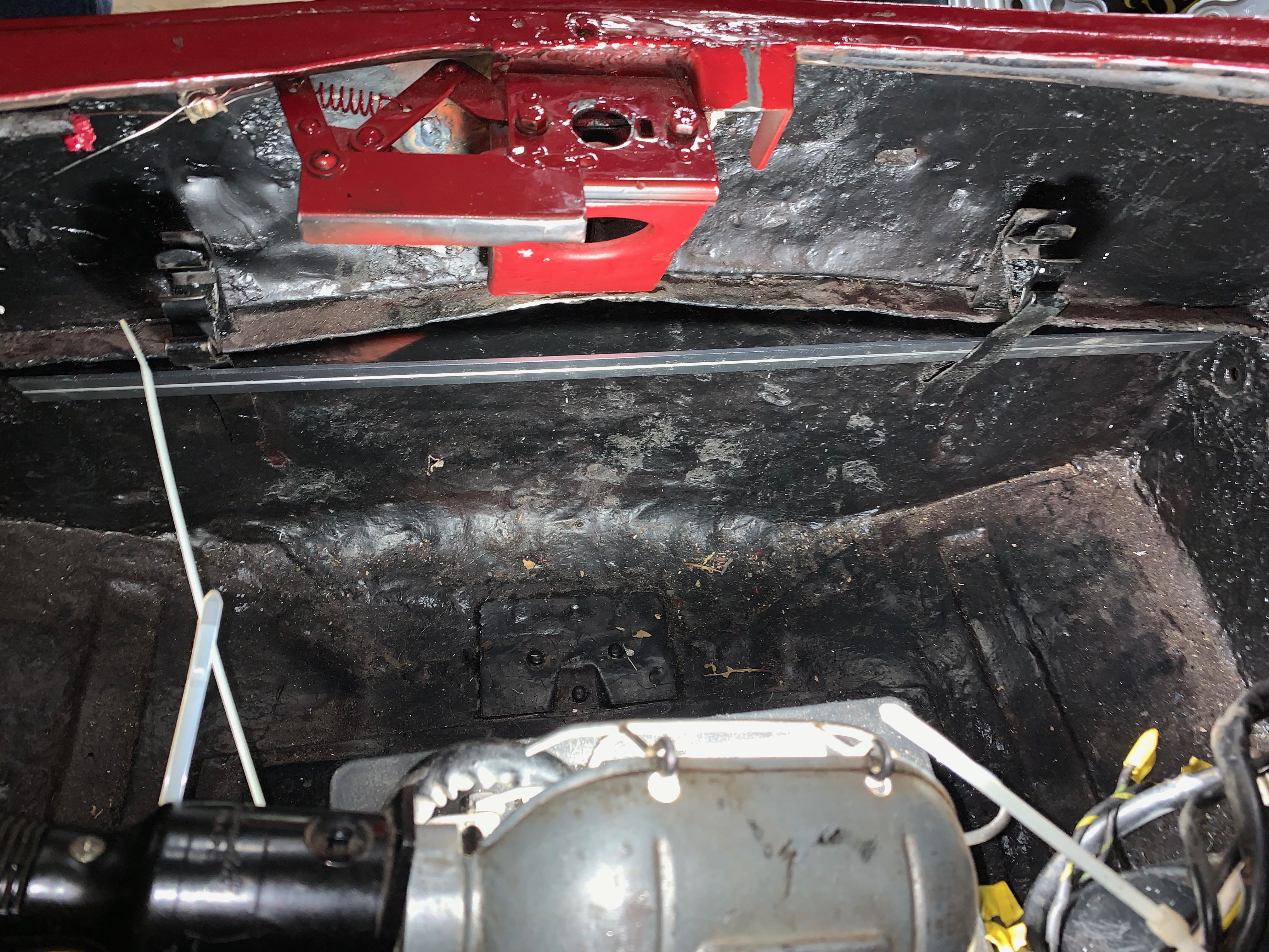

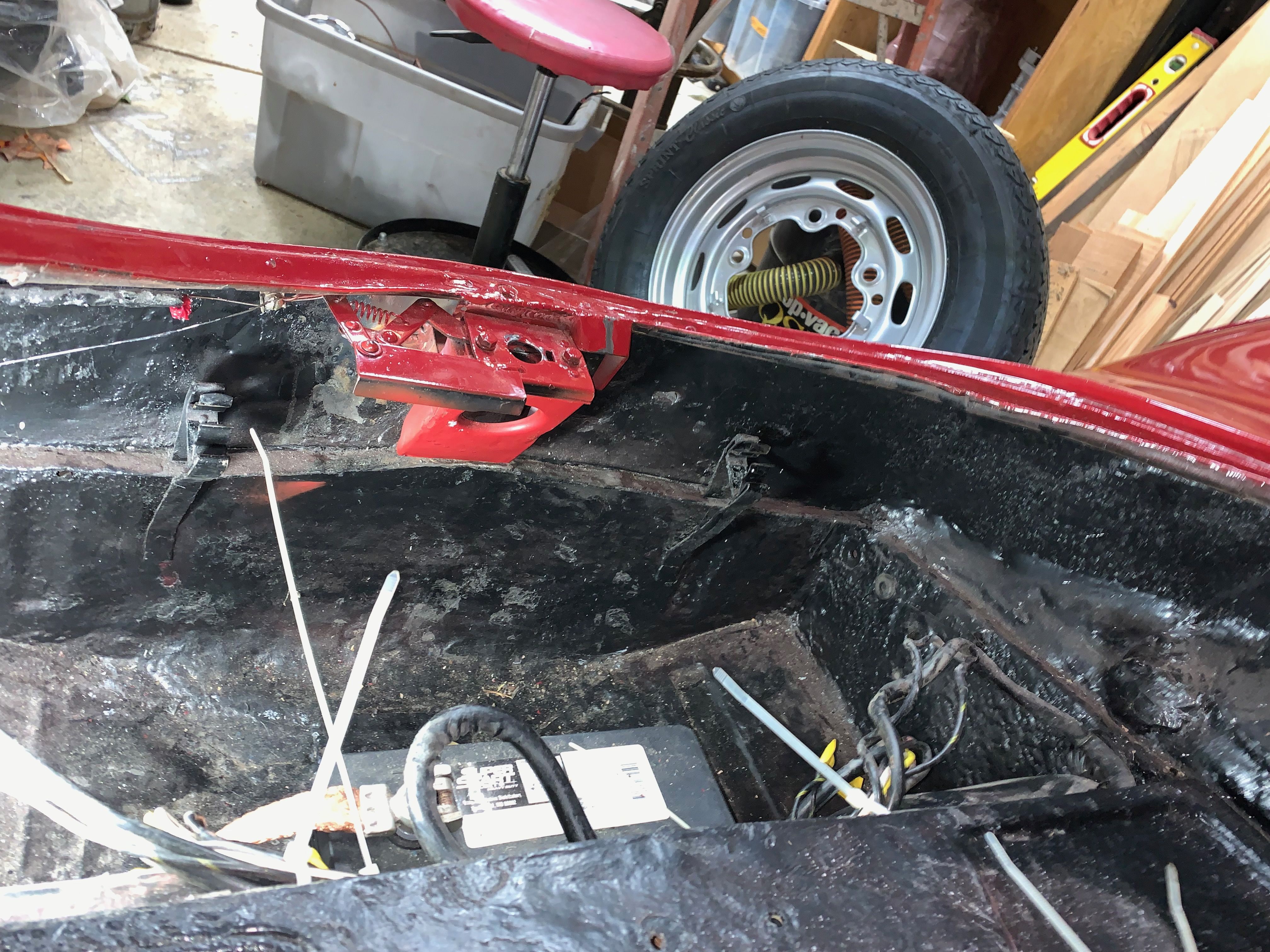

            So a new front clip and headlight buckets were ordered from Trevor, along with the inner front trunk wall. I do not have a reference car to check, so I need some help with what the inner trunk should be on a 59 Conv. D. Here are some photos to show both the existing trunk and the replacement panel from Trevor:
            Click image for larger version  Name:	IMG_1259.jpg Views:	0 Size:	1.75 MB ID:	113596
            Straight edge added to show the curvature in the flange between the upper and lower inner trunk panels.
            Click image for larger version  Name:	IMG_1262.jpg Views:	0 Size:	1.91 MB ID:	113597

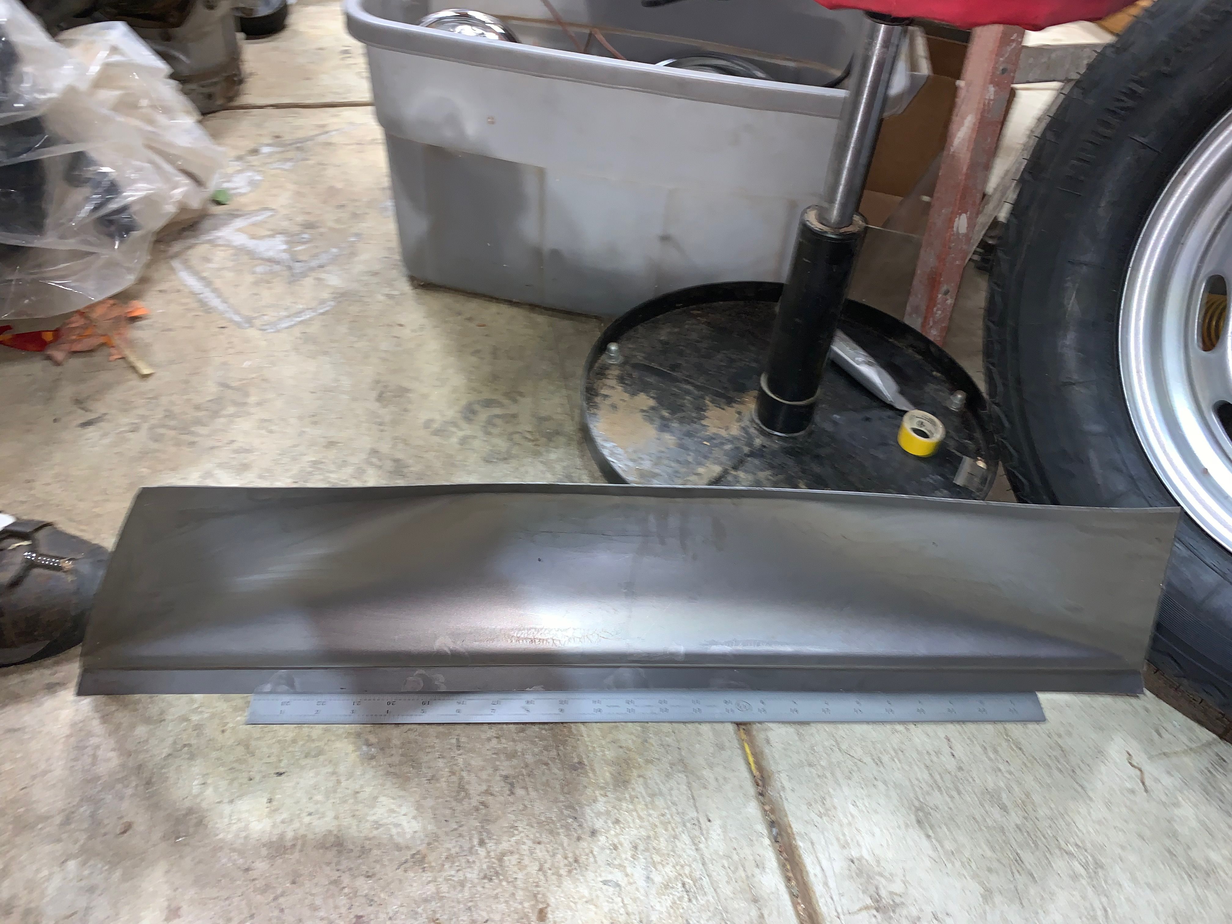

            Replacement inner trunk panel:
            Click image for larger version  Name:	IMG_1264.jpg Views:	0 Size:	1.23 MB ID:	113591
            There is a straight edge in the second and third photos. Is the curvature of the flange in the existing panels correct, or should it be a straight line like the replacement panel from Trevor? Is the flange in the existing trunk a single thickness of steel, or double, or a seam?

                    Dave, I have looked at the area of the flange on my still original 1959 356A Factory area you show with a 'kinked distorted ' flange. The flange on my car is flat when measured with a straight edge just like your new panel you have bought. BUT the front panel that is directly underneath the perfectly flat 'flange' is curved. When I place a rule on the middle of the flat flange to the curve depth is about 15mm. This lower front end panel has the two welded on 'jack' location spring type holders the that jack is secured to. The 15mm was measured between those two holders. I think its possible the lower frond end dished panel is welded to the top flange part. Mine is still covered in the factory black rust preventative. but it feels double thickness not really thin.
                    To get that flange so distorted it must have have had a bad sideways collision . Have you seen further damage near the front suspensiion areas?
                    Hope this helps sorry if my explanation is difficult to possibly understand . I do think my 59A chassis front structure is the same as yours.
