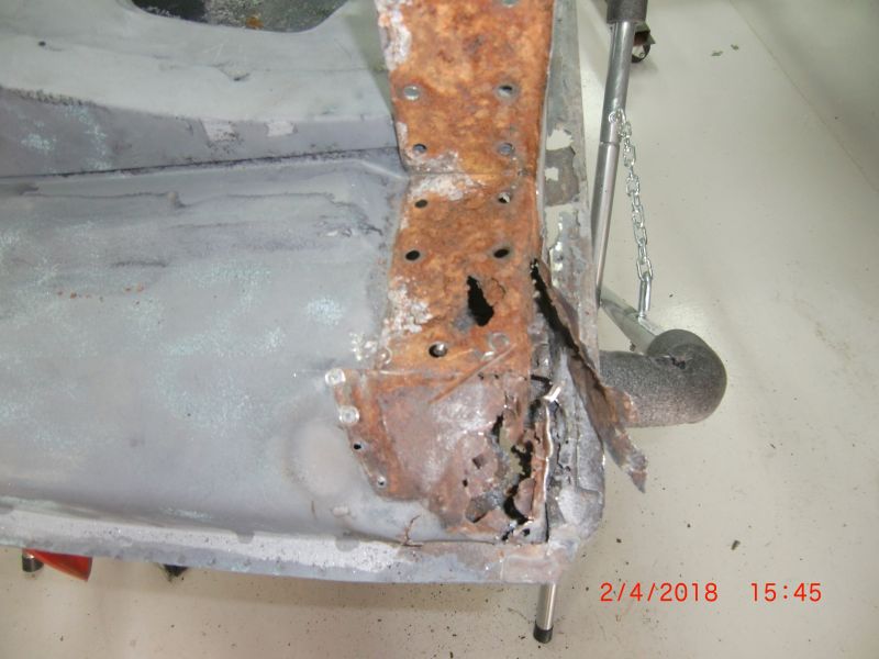

        Removed the bottom hinge, as you can see lots of rust.

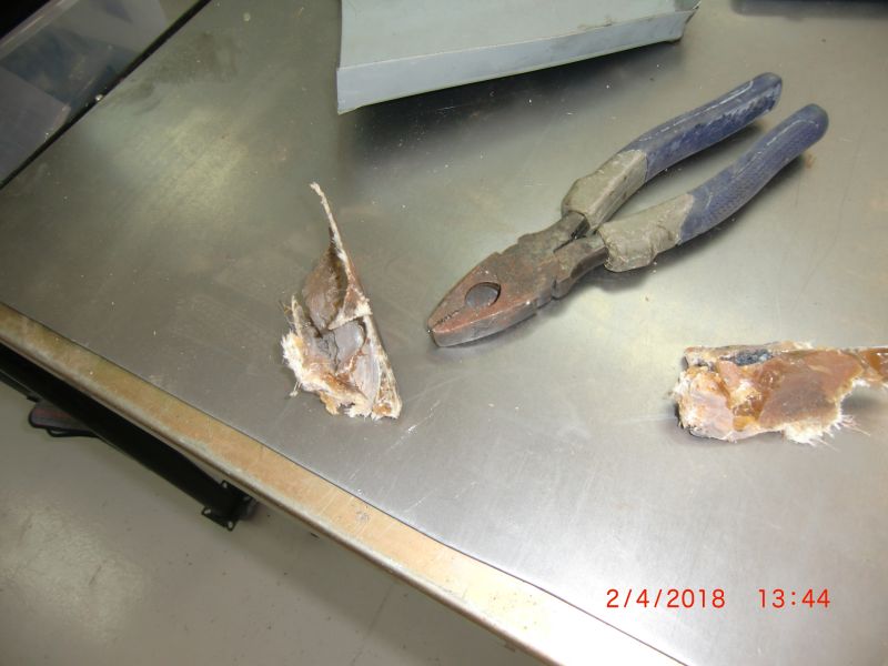

        This shows the bump stop bracket peeled up.

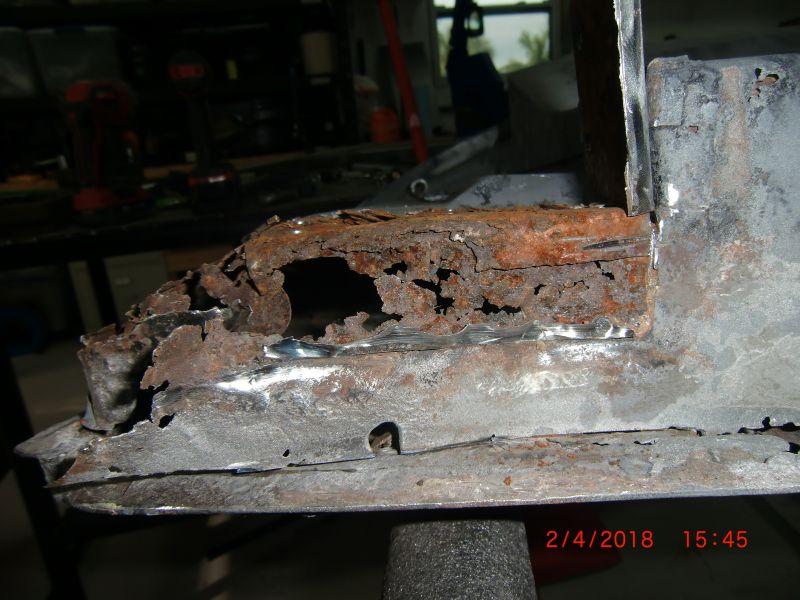

        Have been removing fiberglass from the bottom of the door for the last two days. The body guy(I now call him the corvette guy) managed to cover the area completely with a very thick amount. He also covered up the drain holes.
        Being a new to this process I did not realize the bump stop bracket was caved in. Early on I thought the caved in shape was detailed shaping Porsche used on the bracket. To further support my observation I have six doors in my garage and they all are caved in. It is probably a major problem and there seems to various ideas on how or what or what not to do with the bump stop bracket. Research will continue.

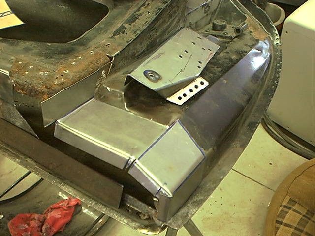

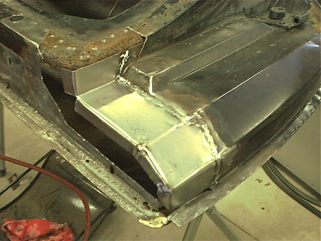

          On my 63 here is what that repaired area should sorta look like:
            Jim,
            It never ceases to amaze me the rust situation on our cars. It is a wonder so many subjected to rainy days over the years are still on the road. You are correct, there are many cars with impressive bondo repairs looking sort of really original. These guys with filler and a selection of special scrapers and abrasive paper are really artistic sometimes.

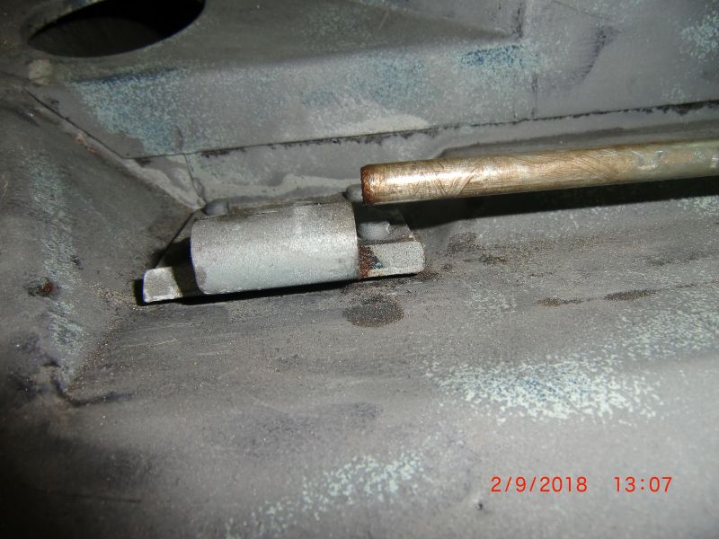

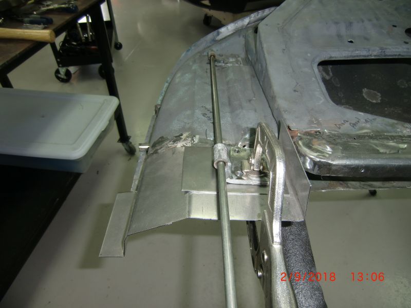

                  Working on replacing the metal in the bottom hinge area. Fab a piece for the door and did a trail run with a scrap piece under the hinge(bump stop metal) and did the rod align.
                  The rod wants to go above the hinge, I can basically force it into the top hinge. The was the line up originally before run removal.

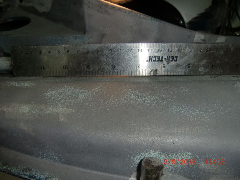

                  I placed a straight edge from the top hinge down to the start of the repair, all on orginal metal. Hard to see but the door has a dip in the middle of the straight edge.
                  Has anyone experience something similar. Or any suggestions. Does the rod have to move freely between the top and bottom hinge.
                  Is it possible the top hinge angle is off?

                    I think I found my problem, the metal piece I made does not have the step down, just found a good picture and checked another door. Will remake my piece. Thanks

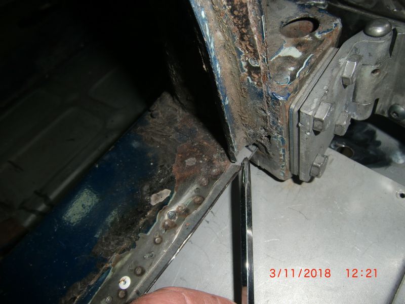

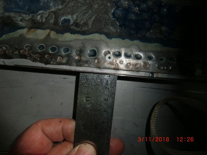

                      Finished the hinge issues and in the process of rocker, threshold, etc. Does anybody know what the depth of the threshold should be where it slides under the longitudinals. Mine is showing 16mm and I can cut more off. Also is the metal remove at the front and back of the threshold where it meets the door seal.
                      At this area I have around 16 mm and more can be cut.
                      I assume this small piece should be cut out to allow the door seal to come down to the bottom seal.
                      The back same thing. Also notice which is hard to see that the longitudinal and threshold extra metal is slightly beyond the original inner longitudinal and also extends a little beyond the metal for the door seal.
                        The width of the threshold can be determined when you close you door. There should be about a finger's breadth there. The front and rear should be cut to allow the rubber seal to extend downwards.
