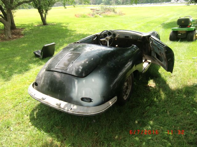

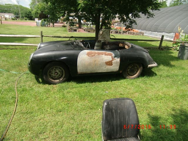

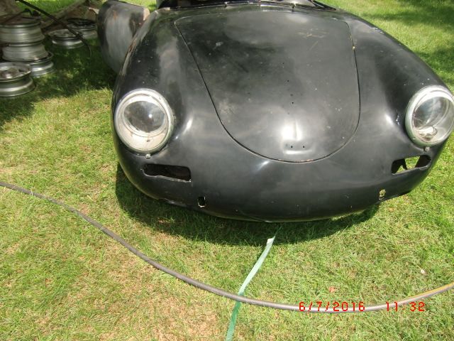

ID:	110890 The first day my roadster has rolled since being stored in my barn in the mid 90's. The photos are dated and now the car is in Florida. I'm almost finished with my 64 coupe, bogged down in the motor rebuild and an obligation coming up that will delay roadster work till late summer. The roadster is stripped of parts sitting on my rotisserie frame. I purchased the car from the PO who had started a restoration and bailed out. His work was not the best, a lot of brazing and he some how used an arc welder to put the floor pan in and in the process fried the wiring harness. What I have found is the car was rusted in the typical lower places (New England Car) and my guess the frame strut supports were complete gone and someone managed to hit a pot hole or curb. This resulted in moving the front torsion bar tube around 20mm, shorter chassis. And when you think things couldn't get any worse the PO decided to restore and welded, brazed, bondo everthing in place. I have done some cutting of the brazing and cleaning up at this point. I'll post a few pictures and see how this site works now, I have not posted in a long time. Jim

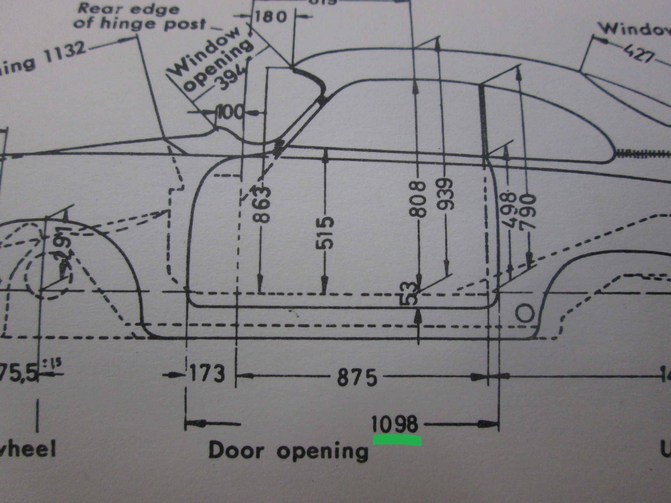

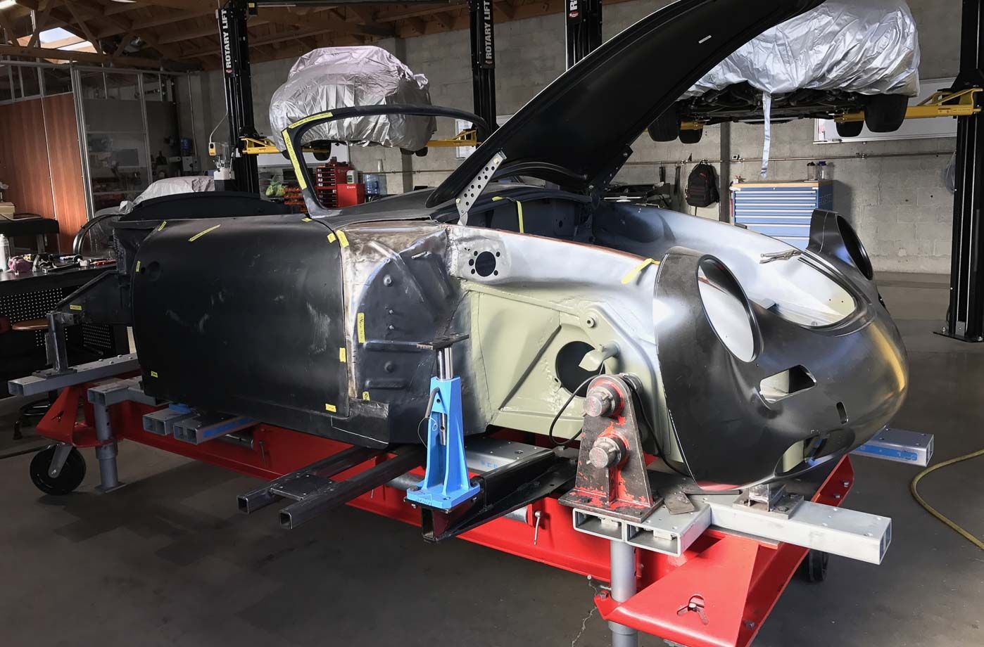

                      I'm back into the roadster, picked up the RD fixtures and other items, fab the base for the fixtures and moved the car into specs at this point. I need to address another issue before I move forward. The doors have a large gap at the door post of 10mm tapering to reasonable at the bottom. So far no hinge adjustment is working. What I believe the PO while putting the pan in with an arc welder and other repairs in the rear floor area may have contributed to this gap. Does anyone have a measurement for the door opening at the top. Best would be from the cowling point at the door opening to the upper flat piece at the top of the door opening in the rear. I have not yet cut the rear floor pan to loosen things up yet. A couple of pics are enclosed so if anyone has any info it would be appreciated.
                      Thanks Jim
                        Jim
                        I cant blow blow up the photos, if you have the car up in the fixture, measure the bottom dimension from the front sway bar to the torsion bar tube. Do both sides. I bet that is short a couple mm, which will make the tub like a banana with the wide door gap.

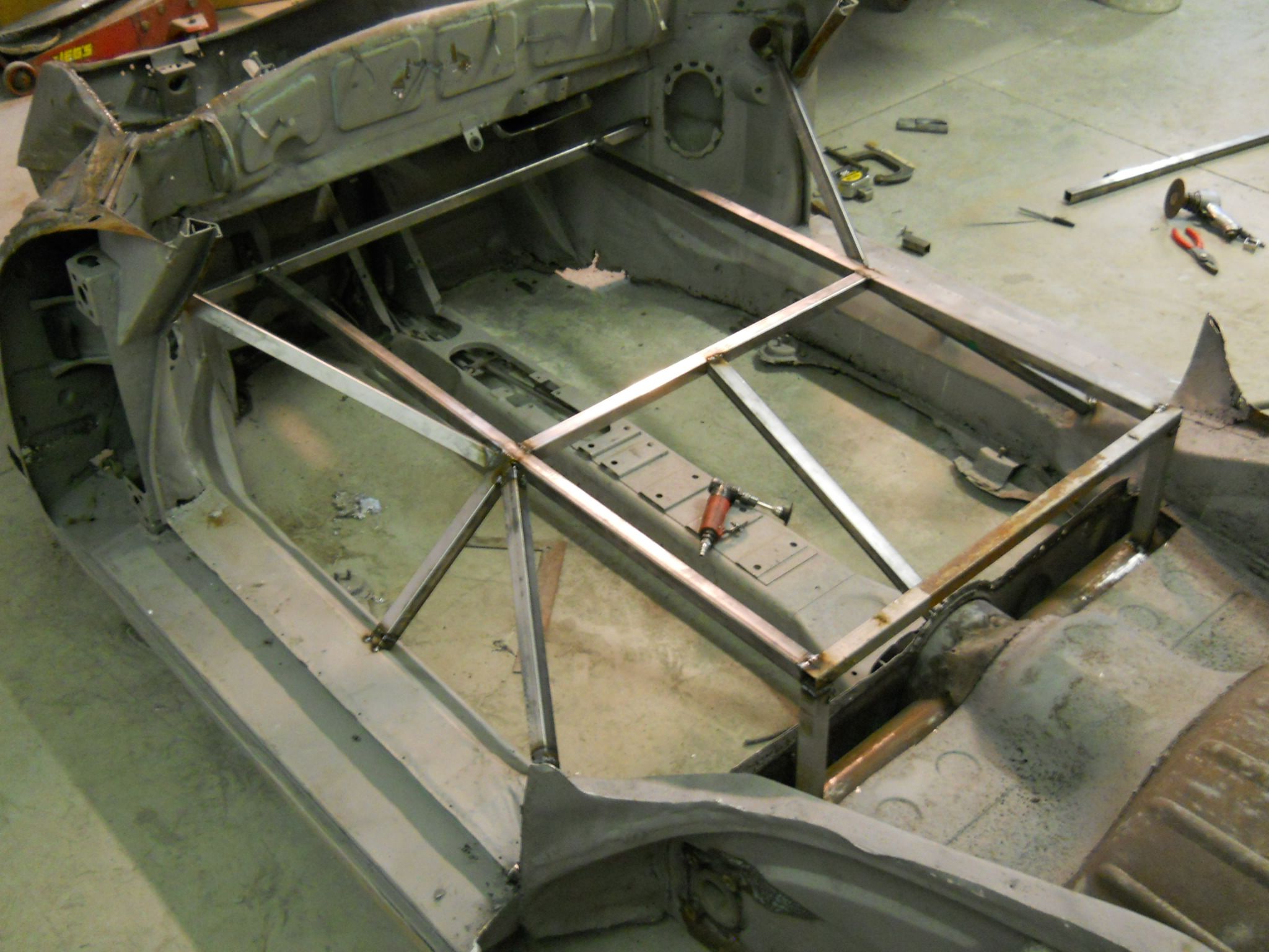

                          I'll see what my manual has as far as that measurement. By your photos it looks like the car has already relaxed open. The cross bracing across the doors is one angle but you also have to keep it from twisting.
                          Click image for larger version  Name:	A chassis 085.JPG Views:	0 Size:	313.9 KB ID:	112474 Here is an example of a brace that will cover all the angles and it was able to stay in position until the very end without getting in the way. Door fitment, floors, etc.
                          Cutting through seat pan my not be the option for you but can find alternate anchor points back there.

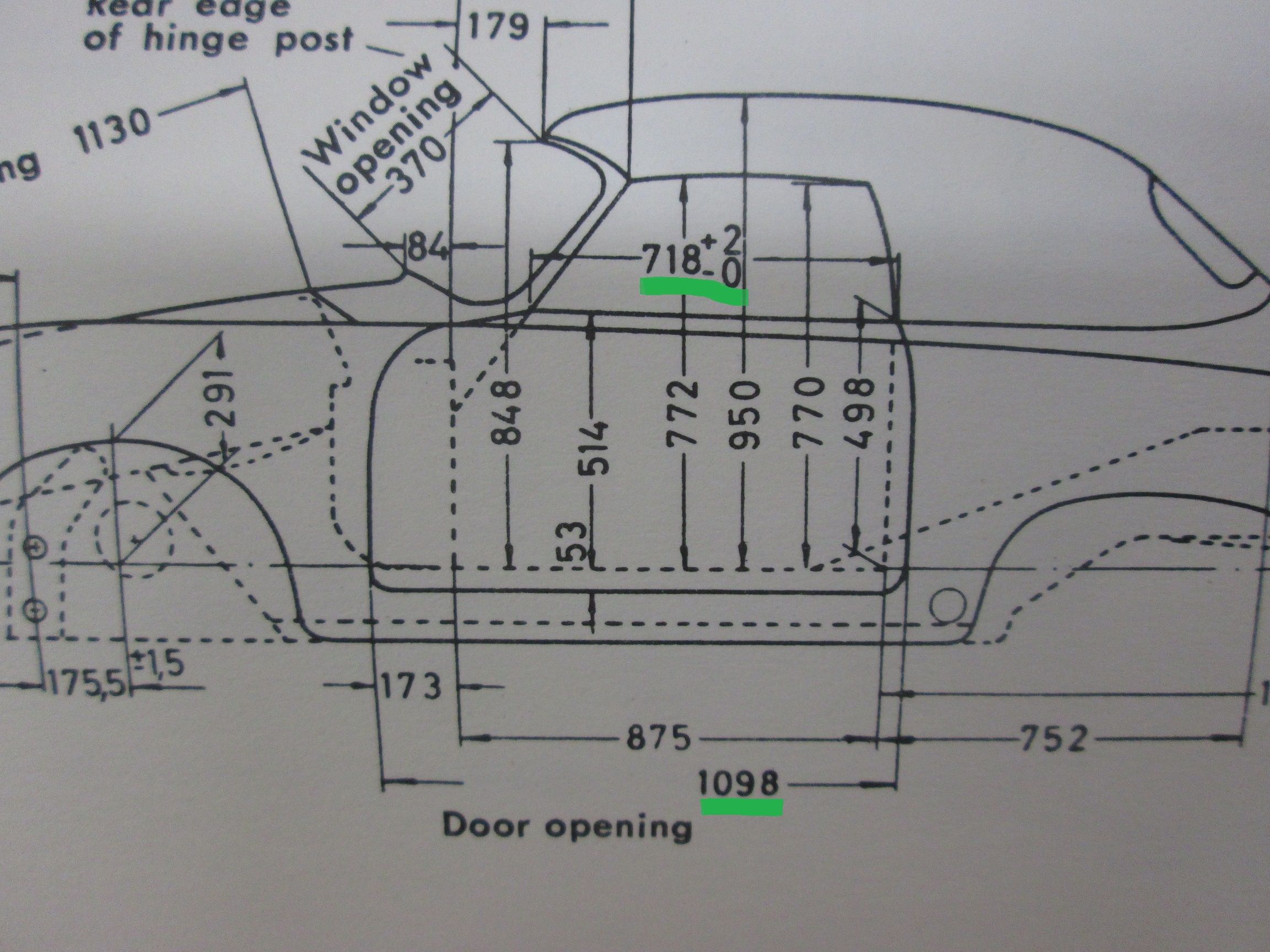

                            My manual only illustrates coupe and Cabriolet. No Speedster/Roadster removable windshield data but these doors were all basically the same dimensionally so the info below highlighted in green will give you a baseline.

                              Thanks for the replies, very helpful. I have the service manual but limited roadster info. Justin, I will look more closely at the coupe measurements and work thru this. I've been cutting the brazing and arc welding loose, the floor pan was welded to the bottom on the outside not inside and for some reason the PO hammered the rear bulkhead flange up and then massive brazing. After the removing and cleaning I cut my door opening brace loose, car on fixtures, the opening of the doors closed about 5 to 6 mm. Justin, will try to do a similar bracing arrangement, the car now is just about in specs for the torsion bar to rear bolt, 1890.5mm, I'm at 1888. I think I will start firming the front up with some welding then move to the rear. Thanks for the information.
