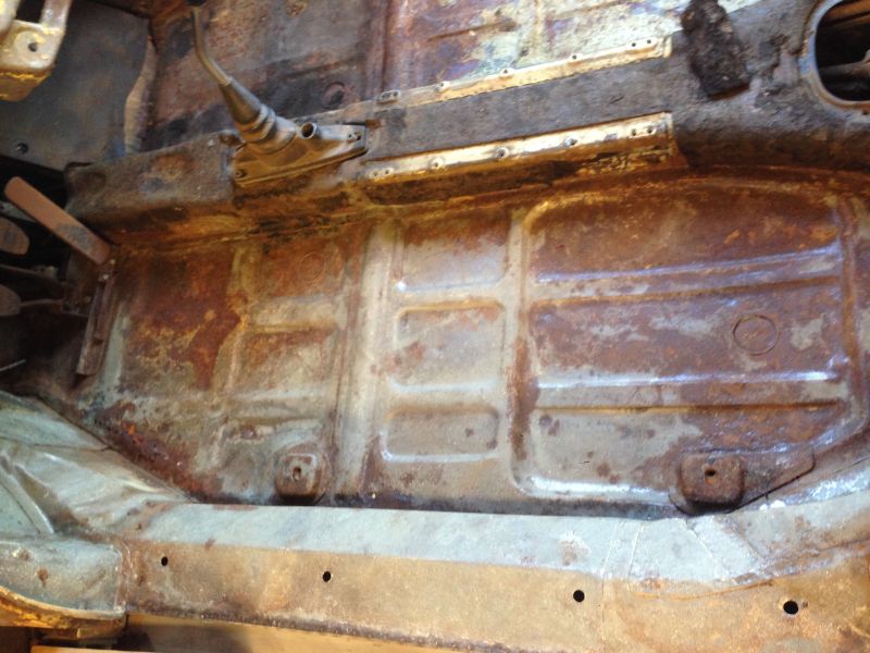

            Justin, here are a few pictures. Car is a bit of a fence sitter. If it were mine, I'd do it all and leave no panel untouched. Owner thought it was nearly rust free. But it was hiding some nasty surprises. Still, better than a lot of the cars out there.
            Some parts of it were pretty good, but some parts were distinctly not.
            Here's the floor.

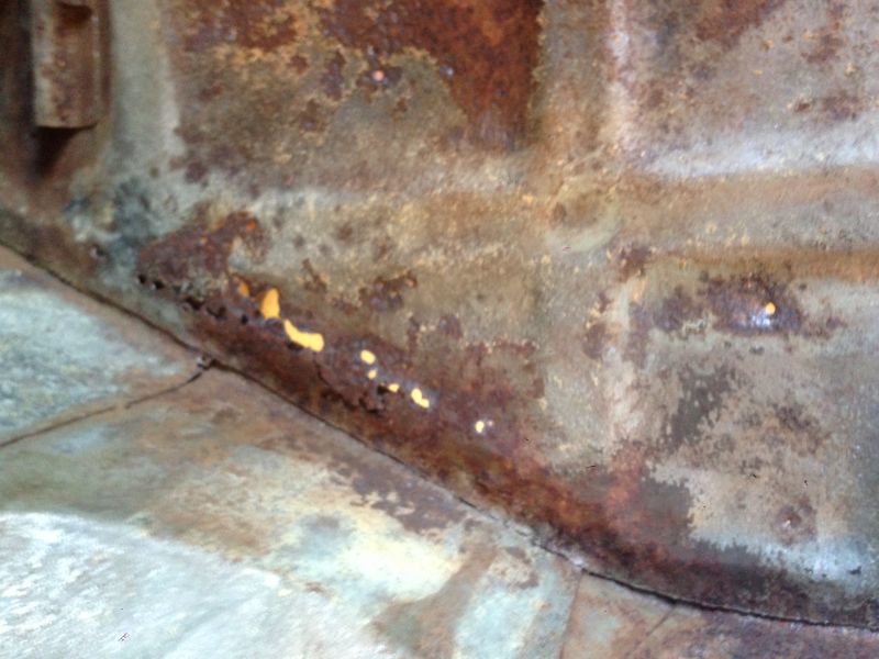

            Close up on the drivers side. passenger side also like this next to the tunnel flange and the tunnel will need a little repair there too. Whole thing is very soft under the drivers seat. But from the transverse tube back, its pretty solid, except for a small area by the drivers side rear seat mounts, localized enough to be an easy patch.

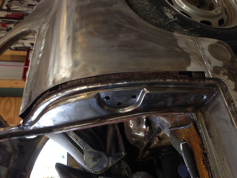

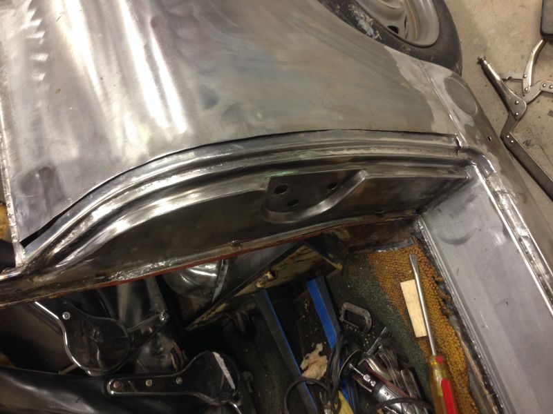

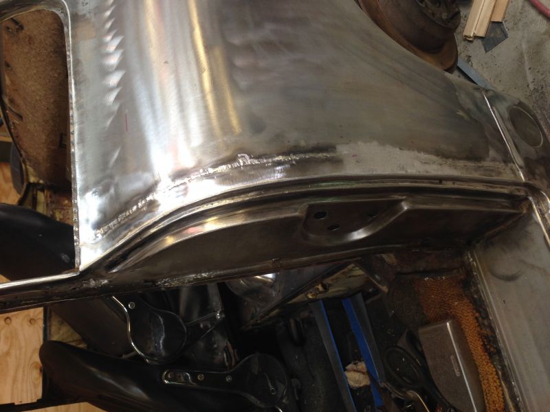

              Thanks John. was looking at your rear fender/door jamb earlier today. Looks like its coming along nicely for you. What would bubba think of your car now?
              Had to fix that are on this car recently. Not my favorite area to work in. Had to coax the curvature into the inner layer much like you did. Tedious work.

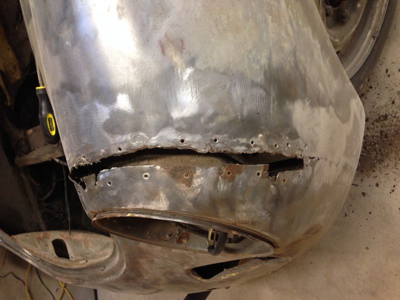

                So, this thing came to me as simply needing a battery box. That's what he said, anyway. He showed up with a one-piece Trevor battery box. I mentioned that I didn't think it would be possible to do this without taking the nose off the car. But then I got to looking closer at the nose. Something not right here!
                Peeled off a little bondo, and found pop rivets and fiberglass. Dug that away and it quickly got worse! Car had had a long ago nose job. Joint was overlapped and leaded. Rust got going between the layers and eventually came through the paint. Somebody pop riveted a piece of tin behinf it, then fiberglassed it from the back side and bonded the top side. Of course that just made it rust faster and ate away a substantial amount of metal.

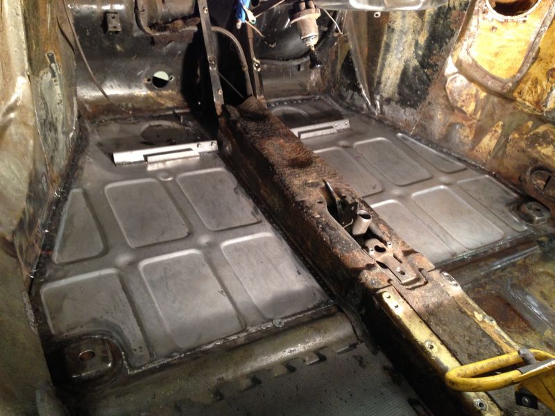

                          Photo of the '64 El Paso car after the front floor welded in place. Really quite simple to get it into place.
