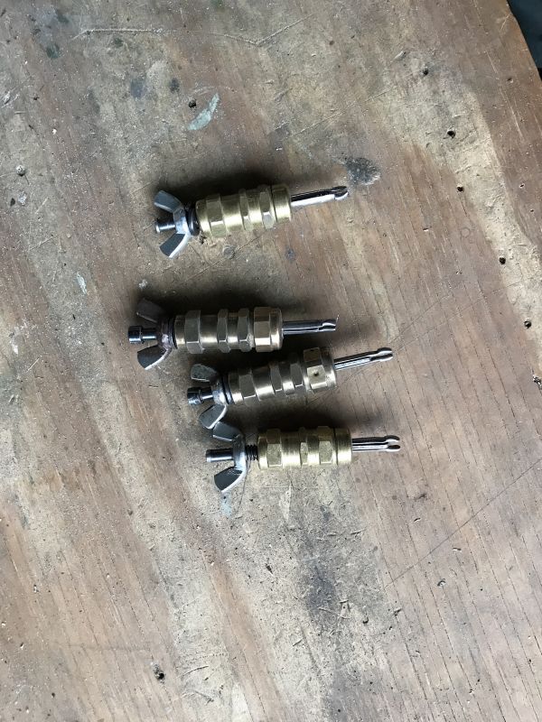

  • You guys are correct about Cleco strength, but I have some that I inherited about 50 years ago that are still stronger than some new that I bought a few years ago. Go figure.

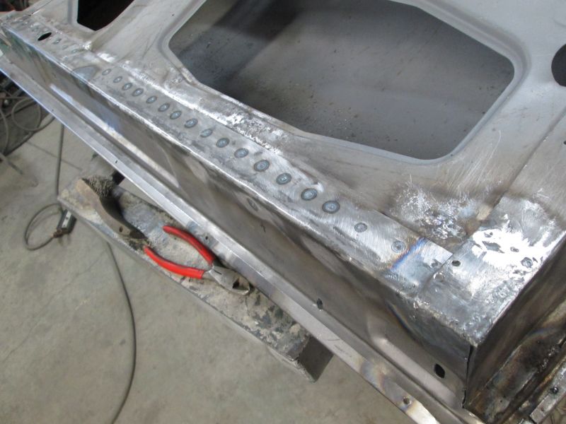

              Finished out spot weld detail then onto welding up the rear corner.

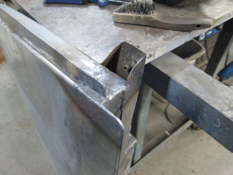

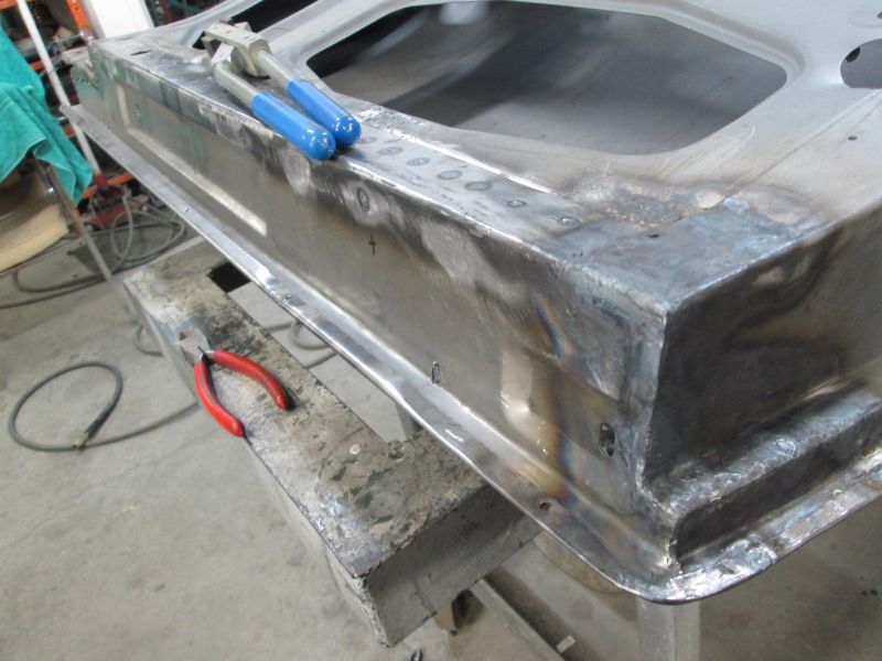

              Seam welded the edges but before I committed the door frame was installed again to make the it seated fully while bolted to this new bottom.

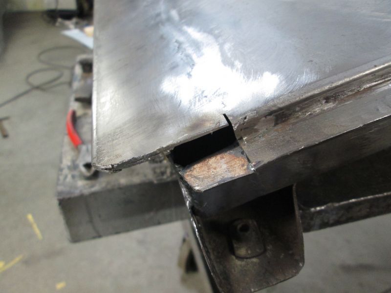

              Dressed then a little torch heat to finish all the edges. All done back here. Crimping the flange tight as I move to the front.

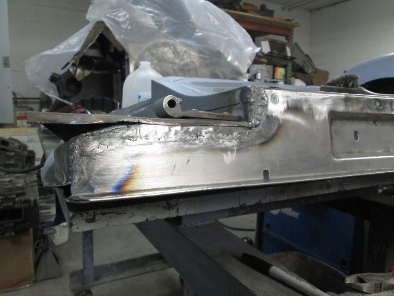

                Floor grafts were stitched up and the leading edge was gas welded as originally.
                I can now lay a new flange section for the door stop housing over top.

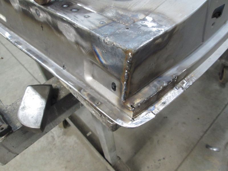

                Flange installed with gas weld details.
                The door was test fitted to the car again and much to my great relief after all the welding and all the heat that comes with it that lower hinge did not move out of alignment on me. The pins slid right in just like they had before I began cutting. I Thank god for small miracles.

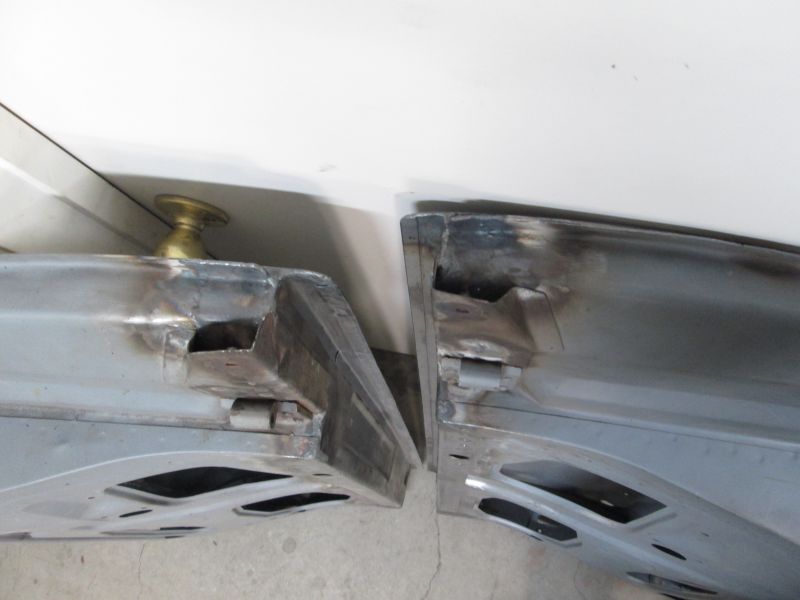

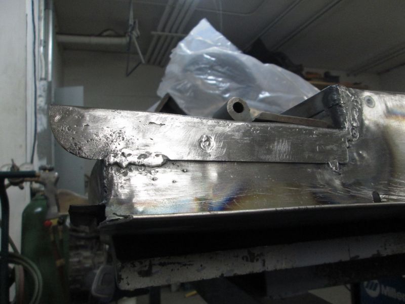

                One last hole to fill to complete my welding on these guys.

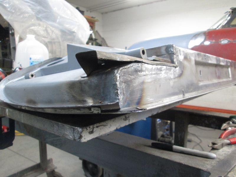

                New section in and gas welded edges as before. Done!

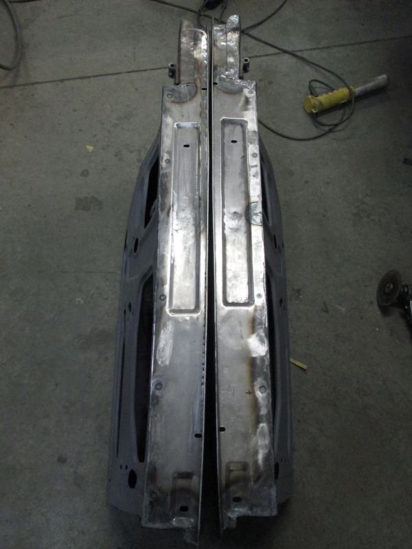

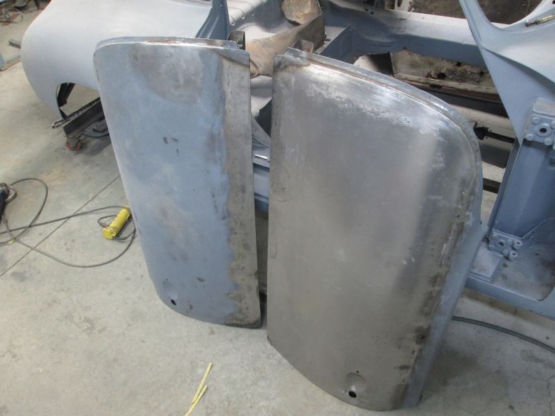

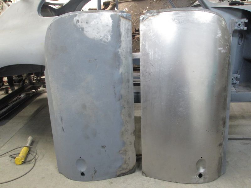

                Door repairs completed.

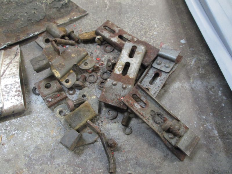

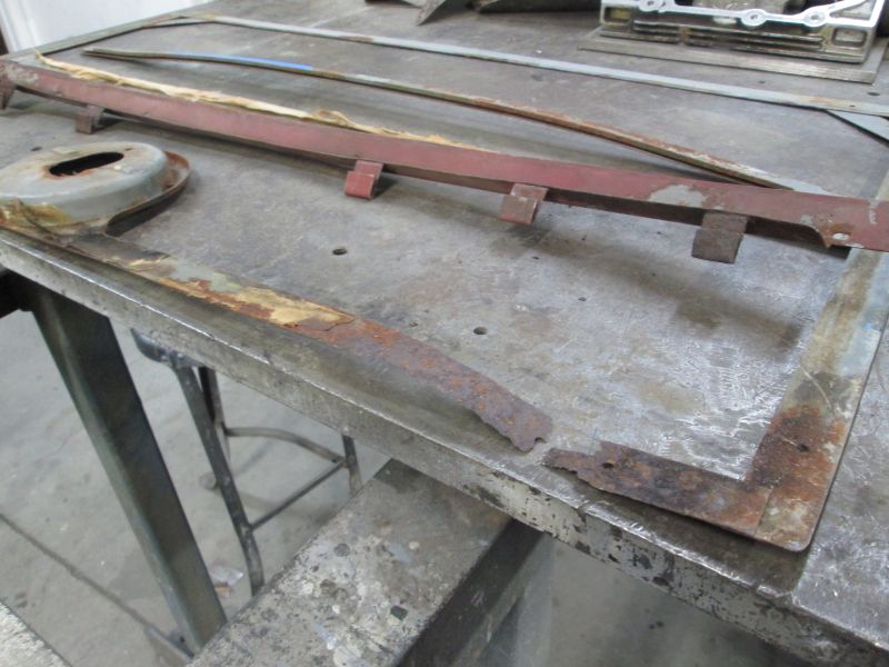

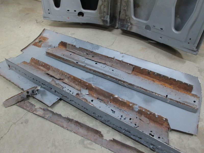

                Remains of all that was replaced. At first glance not a lot there, how hard can it be? ...Well

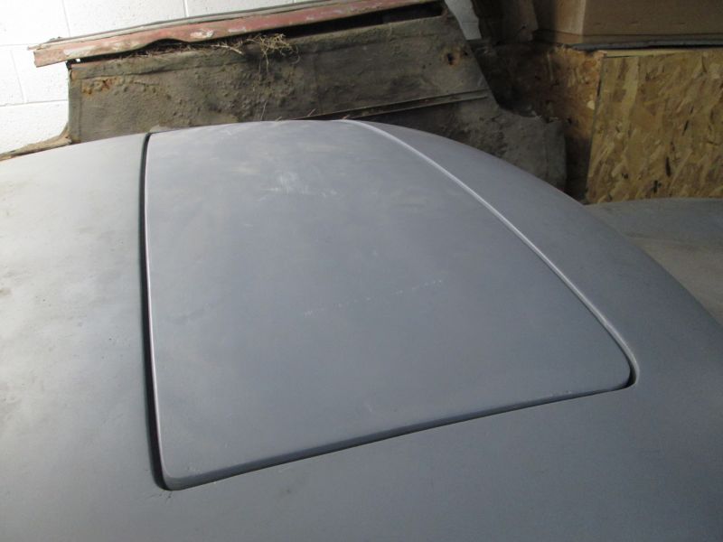

                I'm officially done with the rust repair but there remains body work and fine shaping for sure.
                However I've gone about as far as I can for now. That shaping and final contouring has to be done with the car so I've got to get all the rust repair done in and around the front fender and the rockers so I can transition the final shape of these doors with the final shape of the repaired body.

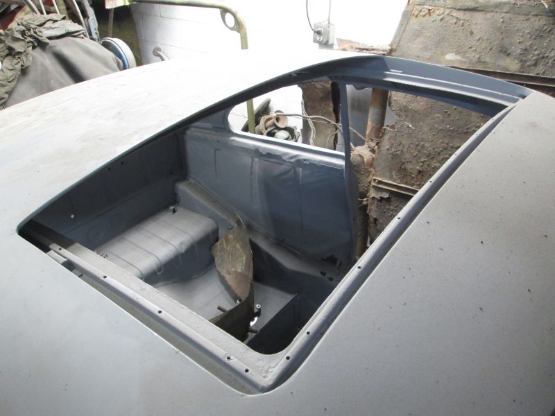

                It all has to be done, so for now I'm moving onto the sun roof assembly. We thought it best to address this sooner rather than later in case there are missing parts or things in need of replacement.
                The big items here with the rest of it in boxes. Exploring this more tomorrow.

                        • Very Cool, the clamping force of a screw with the ease of a cleco. I'll have to get me some...thanks for the tip Scott!
                          It was definitely a nice feeling getting those in the done column Roy.

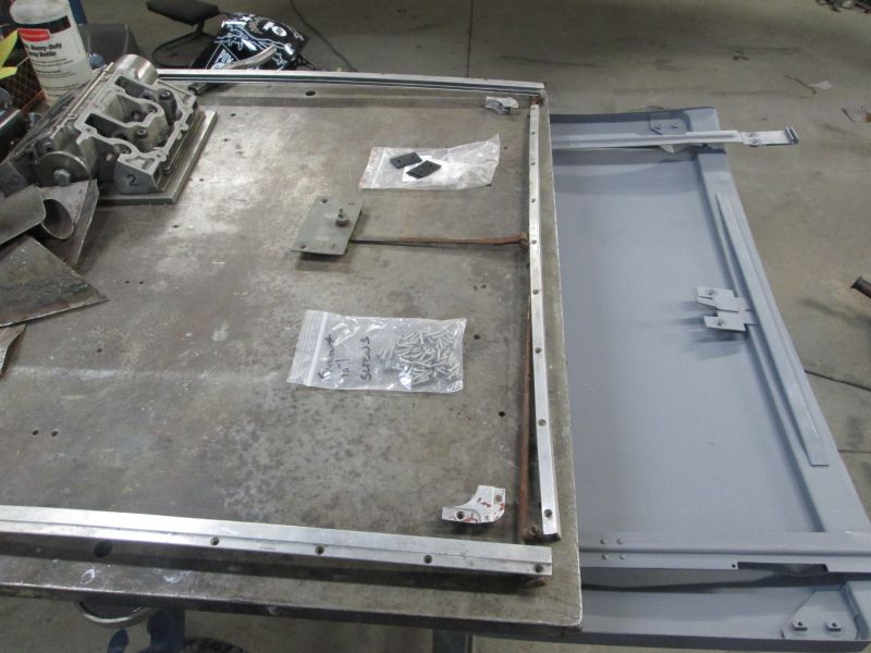

                          12/28/17

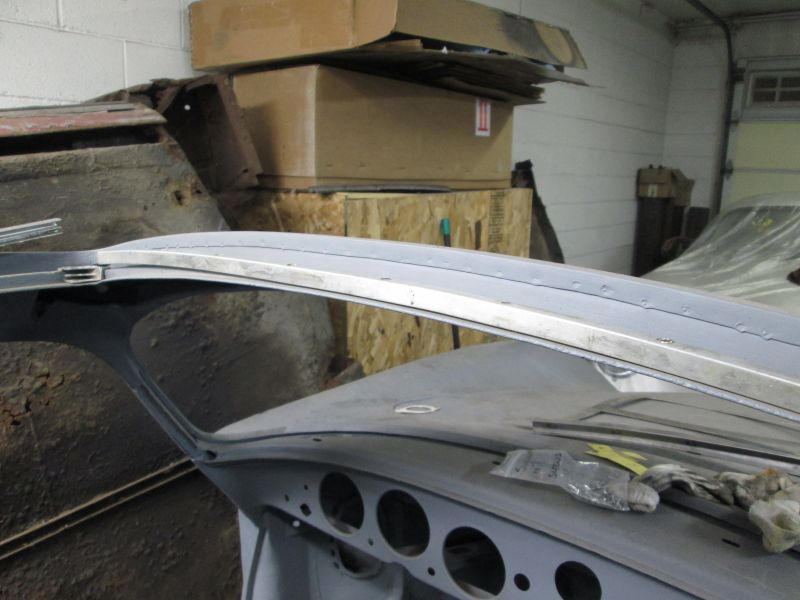

                          Familiarizing myself with sunroof parts.

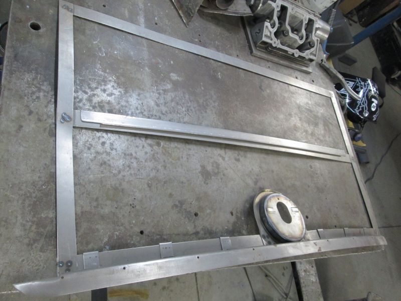

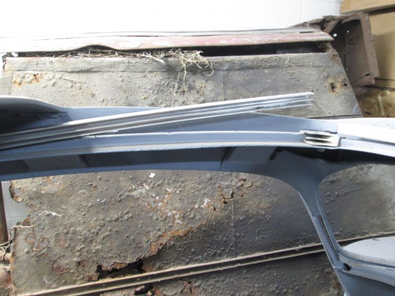

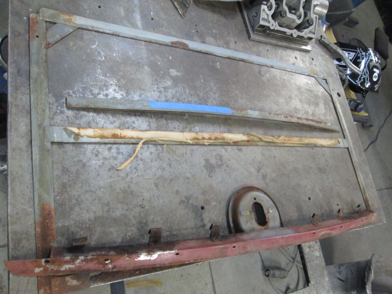

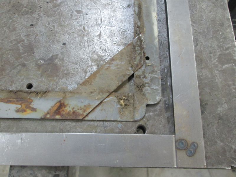

                          Original headliner frame
                          After really looking at it I think its in savable condition with the rot localized to the front cross member.
                          On the both sides but only this runner.

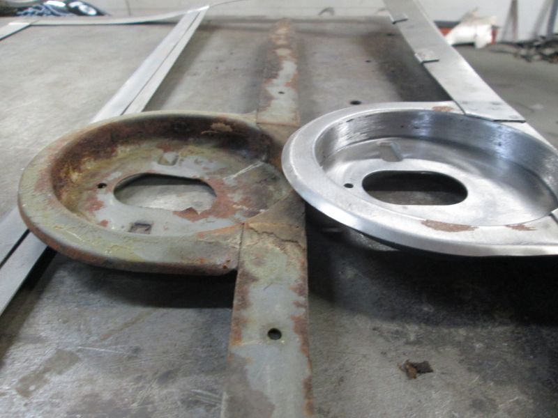

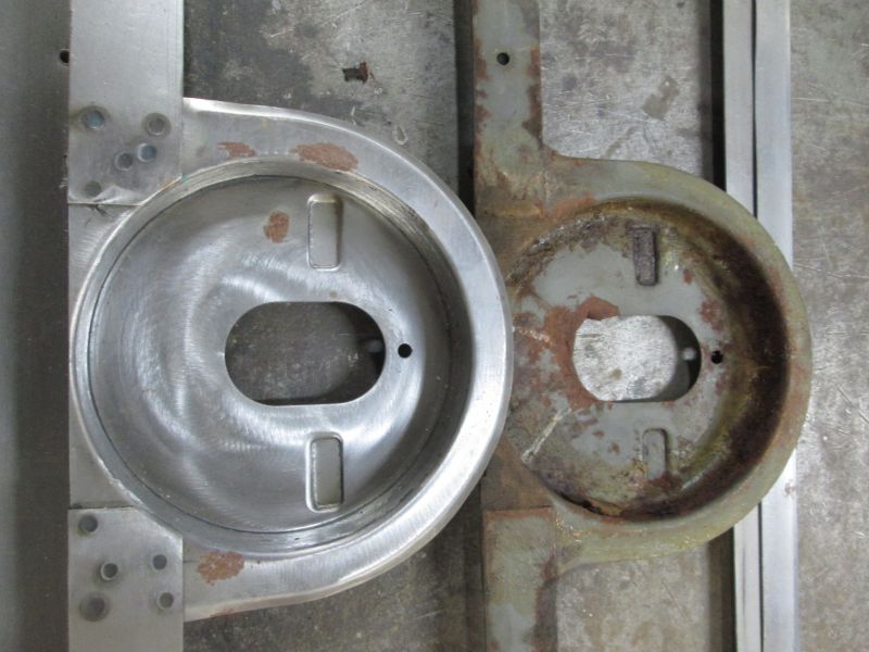

                          A new reproduction was supplied and it seems like a nice one.
                          Cup details are very close.
                          Lip profile varies a little but probably makes no difference once the liner material is glued over top.

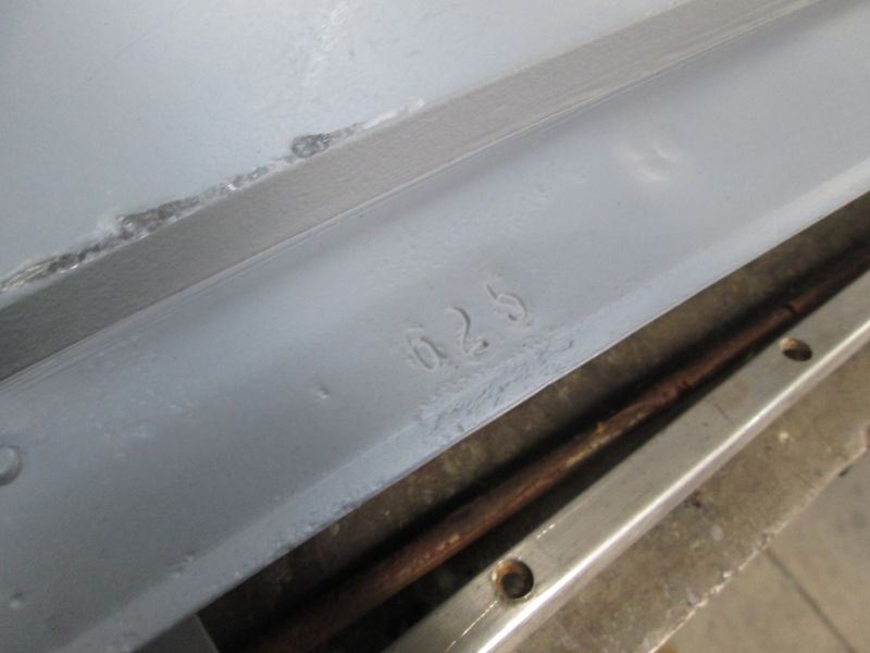

                          # stamped to this car.

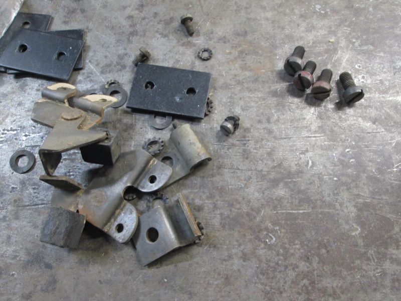

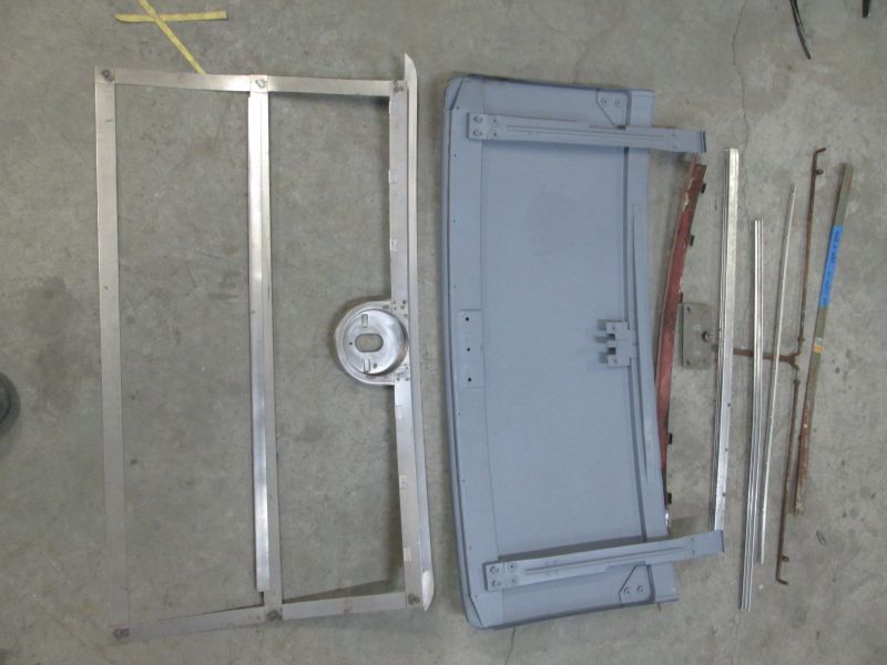

                          All hardware that was sent: original tracks, release mechanism, screws and spacer shims.
                          Again missing the mechanisms that go on the ends of this actuating rod.

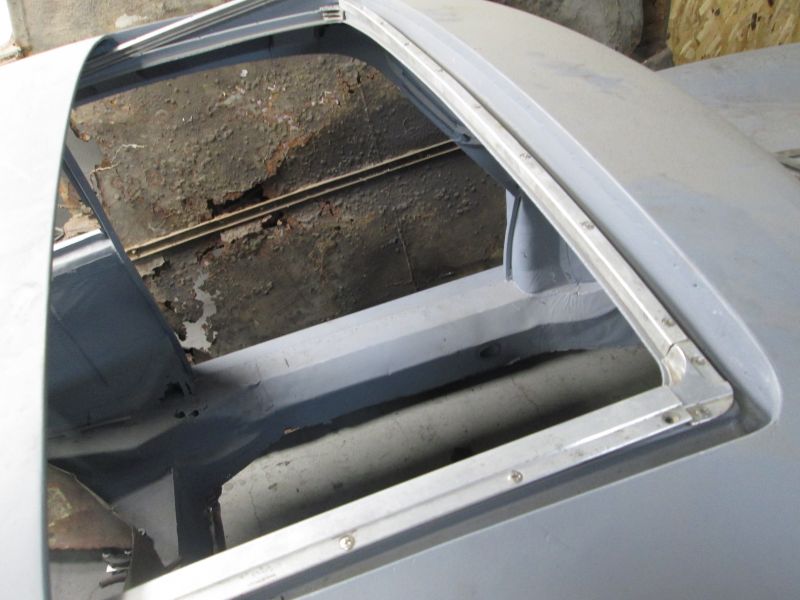

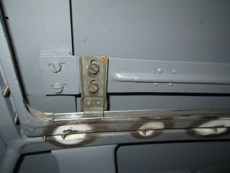

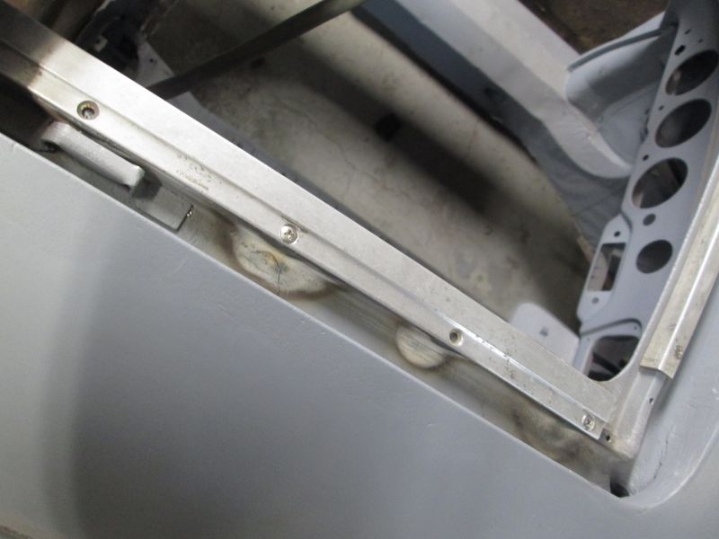

                          One concern was checking for blown out mounting holes.
                          Began mocking up the tracks to check for those.

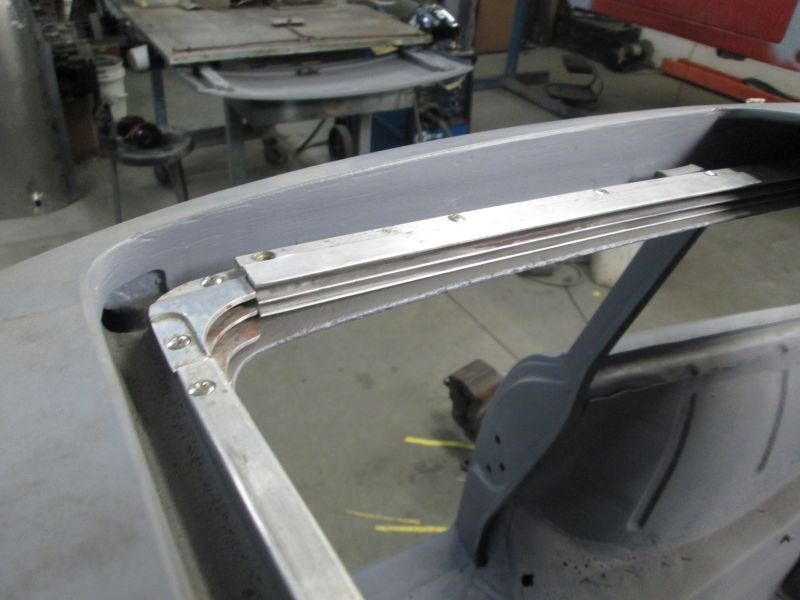

                          Pretty straight forward, the tail end of the track just inserts into this bracket.
                          track just about installed here.

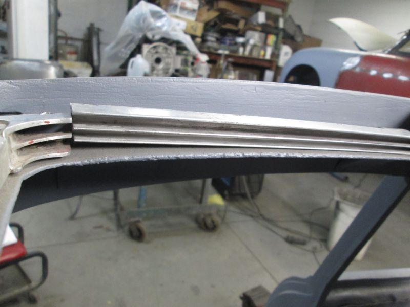

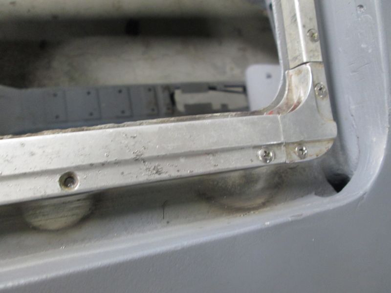

                          I was really shocked to discover what a forced fit these tracks are. I would have sworn that these extrusions would have been arced to follow the contour.
                          same issue with the cross piece though much easier to bend into position.
                          A lot of force needed to draw this down tight. These are all original to the car so this must be normal?? At least I figured out which are the "critical" screw holes.

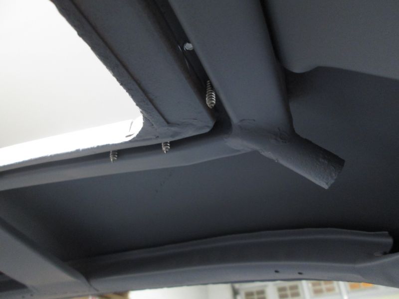

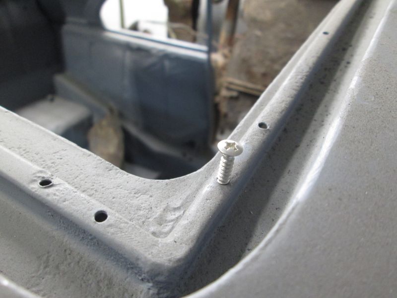

                          New supplied screws BTW seem a little too long. I can't see the originals
                          protruding past the frame.

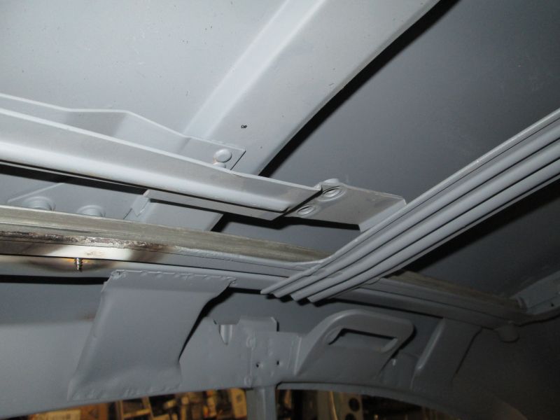

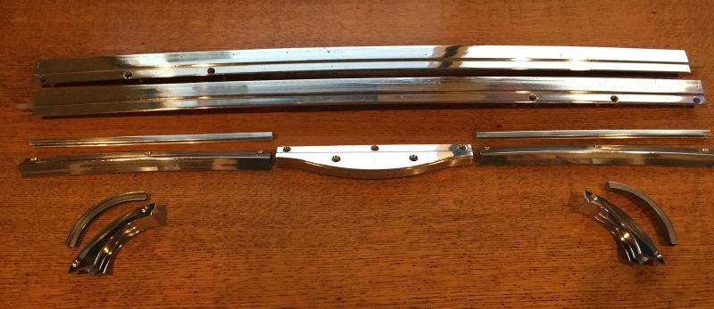

                          • The later T6 electric sunroof guide rails do have a convexity to them so they better fit the contour of the SR frame. Those screws may not be original size. Have you checked the manual to see what size is supposed to insert there? A search on the R has lots of information regarding manual sunroofs.
                            Here's a picture of guide rails for an electric sunroof with the convexity built into the longer side rails.
                            JP
                            • Thanks for the help John, Some nice jewelry there! These old rails do have a slight arc in the center but as it gets down to the last bit it really has to be forced down into position. I was just wondering if that was normal and I guess it is.
                              Thanks again! Justin

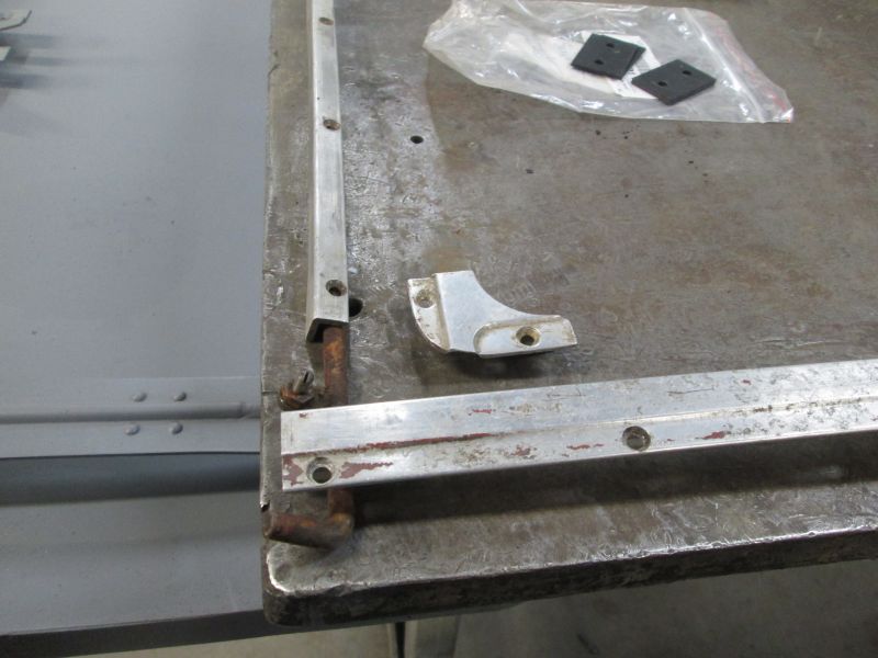

                              12/29/17
                              Repairing mount holes

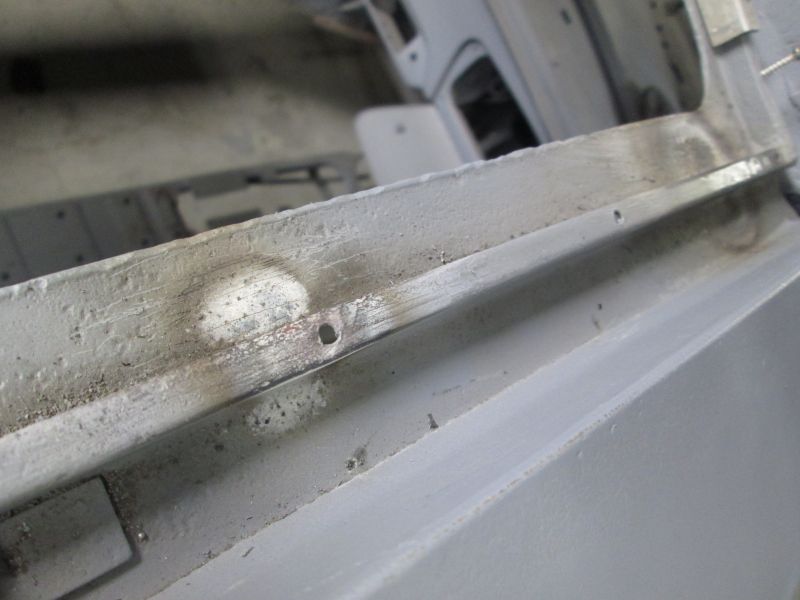

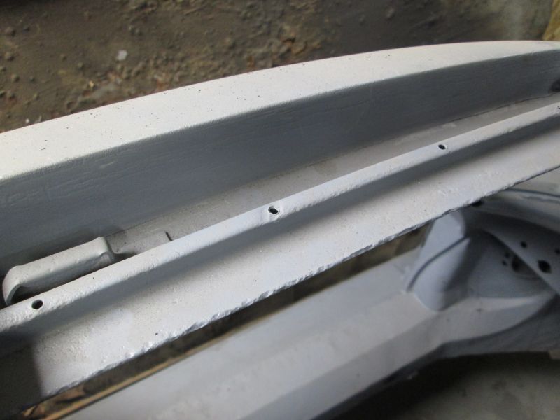

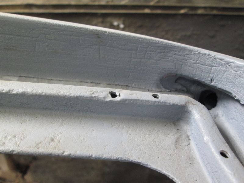

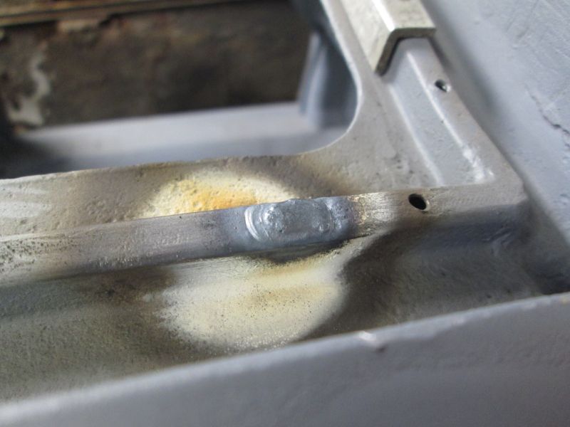

                              It became clear that this particular holes integrity is by far the most important of the whole bunch. This did still hold the threads but as you can see its pitted and thin around the edge so I had to repair it.
                              Welded over for a fresh start.

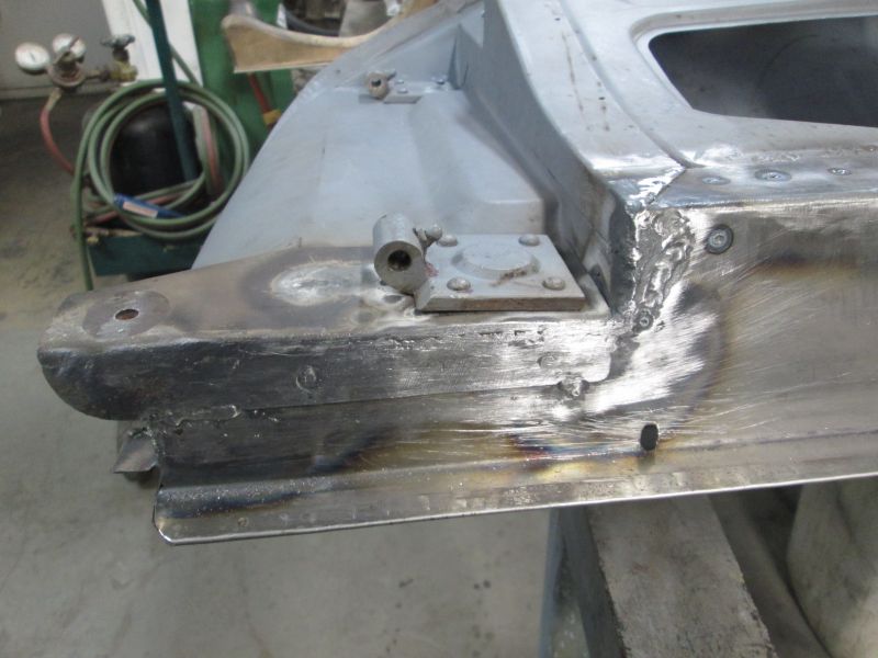

                              Re-drilled and run through. You can see that the weld provides a bit more of a shoulder so the screw has a lot more to hang onto than before. No worries about this one tearing out now.

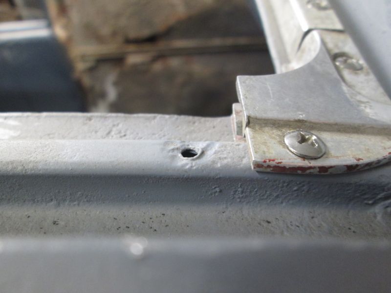

                              Third hole same condition so it was welded next. Before it was over I decided to do all four that secure this side.
                              last two welded and ready to be re-drilled. As I played with it I realized that it wasn't necessary to do the 4th hole as it sits in an about the fulcrum so it really doesn't do a whole lot. Confirmation of this can be seen in John's photo of his later tracks where it has been eliminated and shows only the three lower holes.

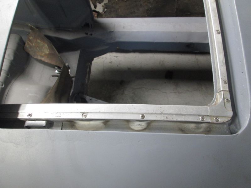

                              Right side done, repeat on the left side.
                              • 1/10/18
                                Repeat left side.

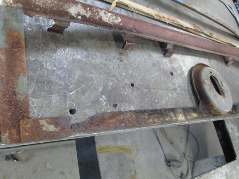

                                Same deal, critical mount hole is weak and rusty.

                                Rails all set.

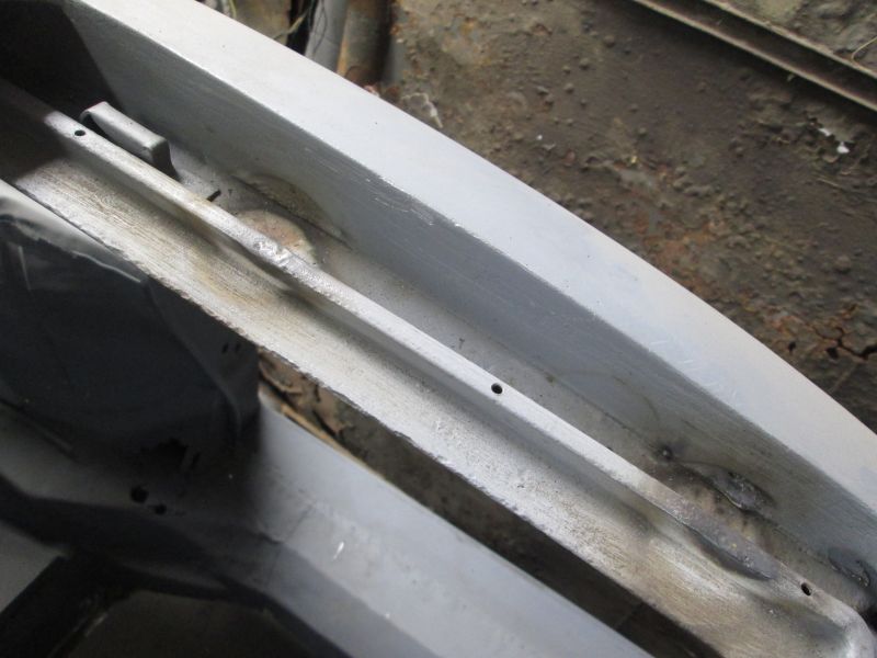

                                Not all good news while working on this left side I noticed the trough had rusted through. Could not be in a worse spot BTW, the cancer disappears under that cross member and the reinforcement to the other side. Its too far back in to get at it from the top so I'm thinking the cross member will have to come free here so I can be sure its completely repaired and sealed. If its not the eventual water that WILL find its way down in here in the future will seep in and ruin the new headliner. Anyway, I'm going to leave it for now as it will be much nicer to repair this area with the car on its side so it will have to wait for the rotisserie.

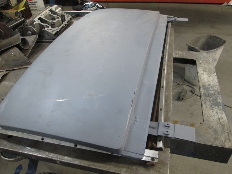

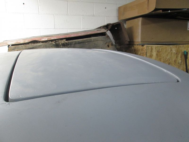

                                Begin refitting the lid
