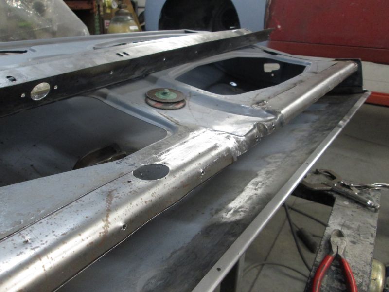

        A lot of waves and rollers to iron out but not a horrible start.
        Many rounds of heat shrinking

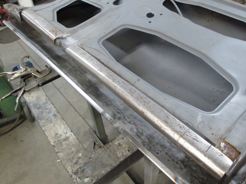

        Again the real luxury was having easy and clear access to the backside.
        Some waves remain but no deeper than the thickness of this ruler.

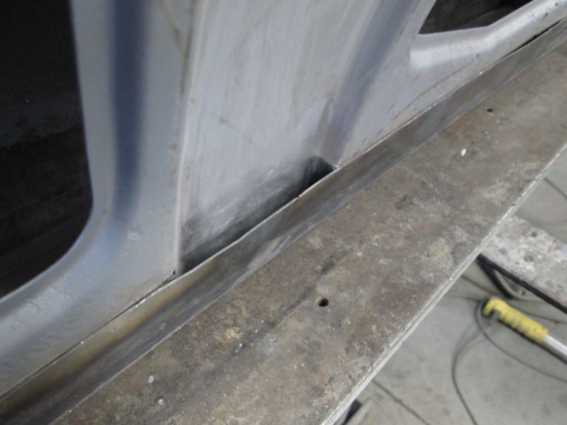

        Chased it about as far as I can with it hanging loose.
        It will certainly change a little once its finally clamped to the bottom so I wait and make any further needed adjustments to the skin's surface once its all built. I won't have the access but hopefully I won't have to correct too much.

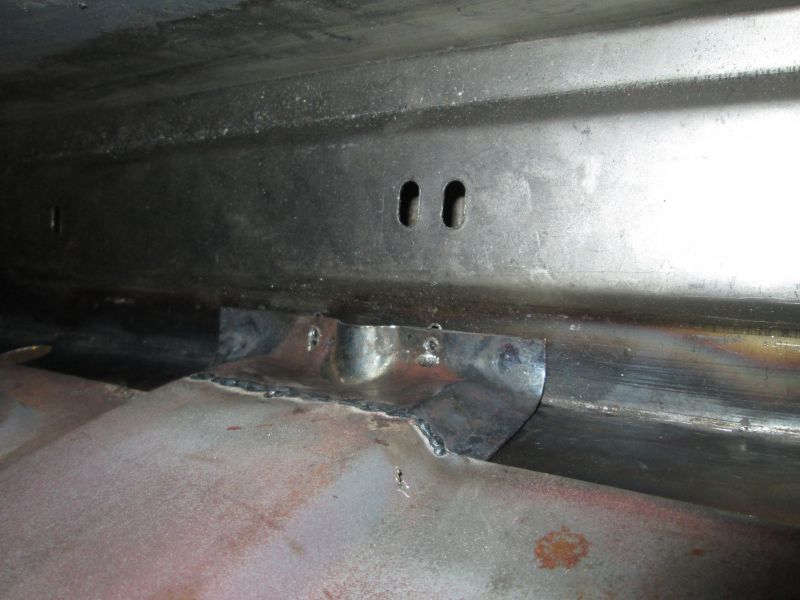

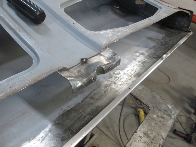

        • 12/14/17
          Installing inner wall flange.
          Starting with the center section then building outward. Setting it in here almost blind was a lot trickier than on the left side where I had open access with the door skin out of the way.

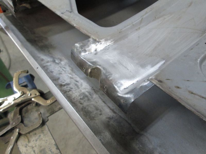

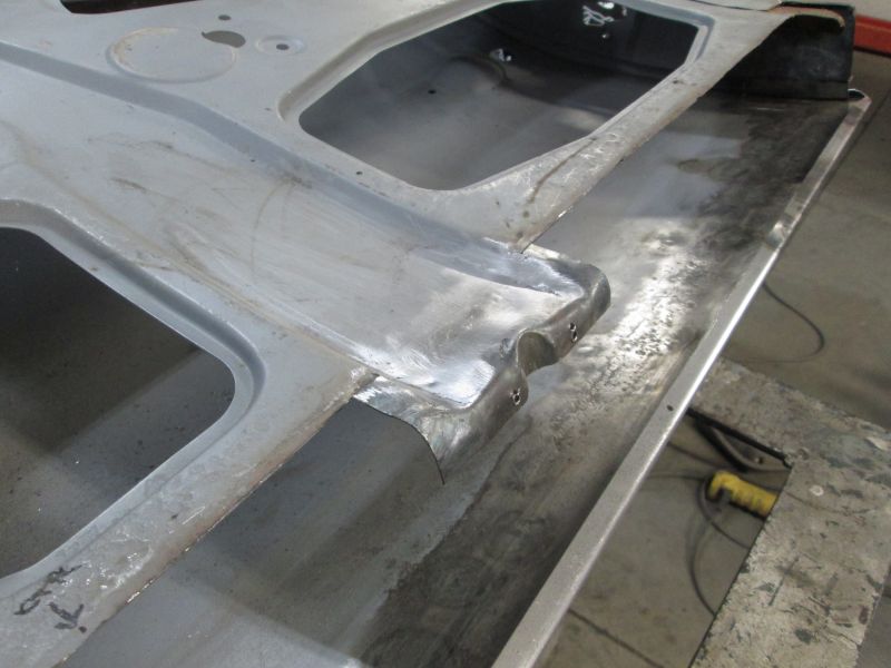

                12/14/17 Part 2
                This thread is a little behind so I'm trying to get it caught up.

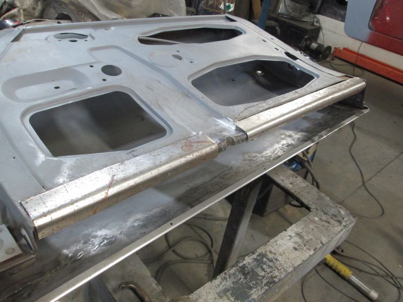

                Rear portion tacked in first.

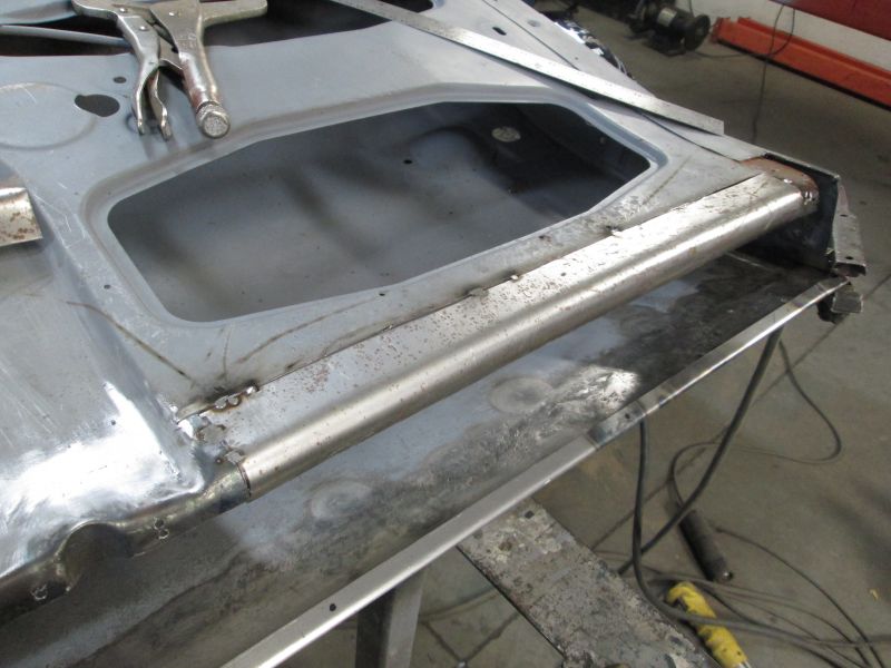

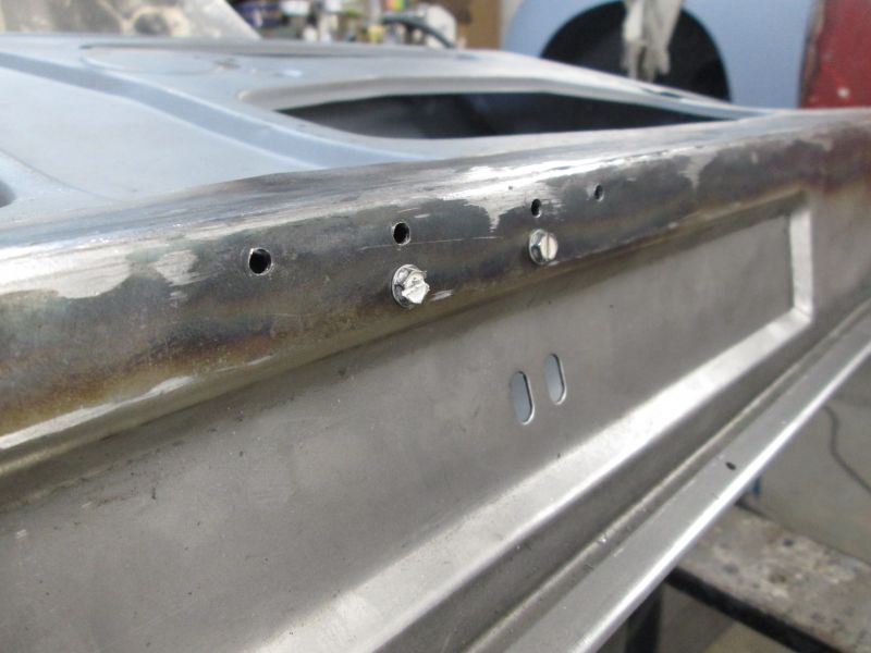

                Relaxed the flange a touch so it sat flush against the bottom then started adding set screws.

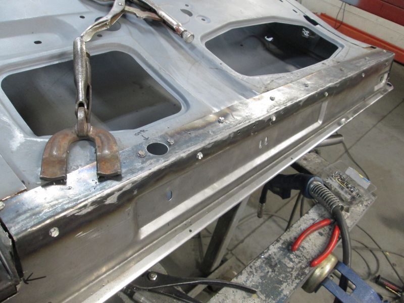

                Froward section next with access hole punched.

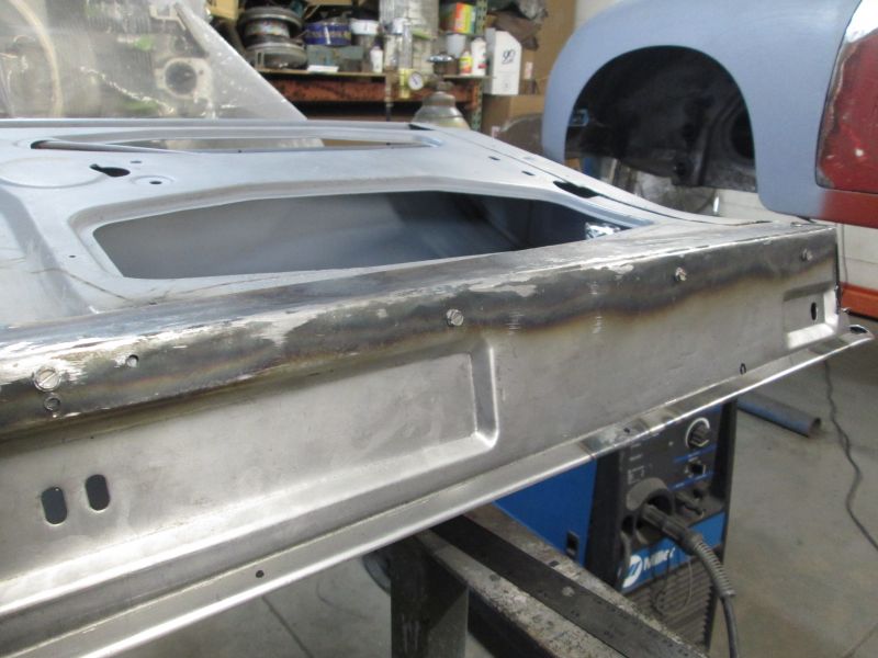

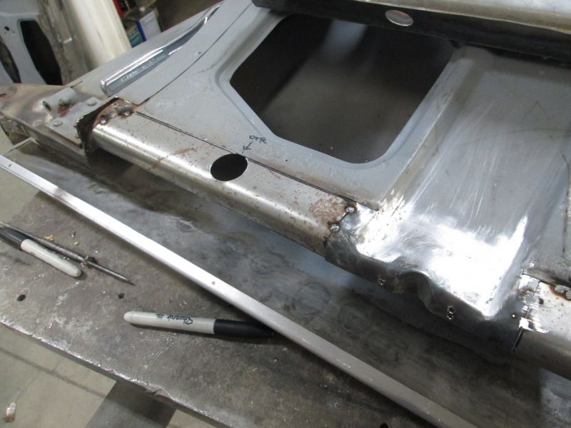

                With the new flange snug against the bottom I added more screws to draw everything tighter still they also represent where the eventual plug welds will be.
                Had to finish stitching them in. The last of the long seam welds on this repair though.

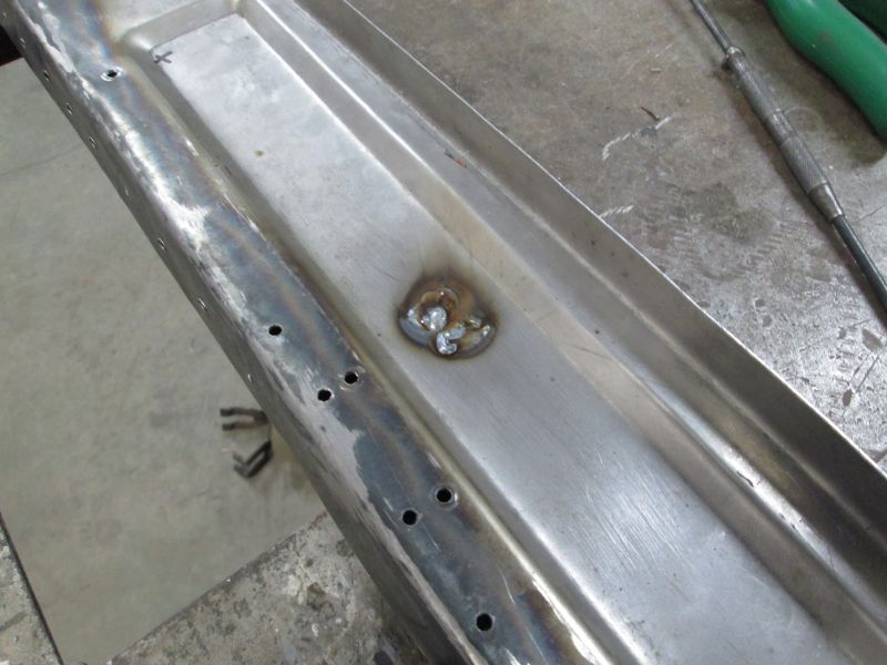

                And also adding in the twin drains up by the outer flange.
