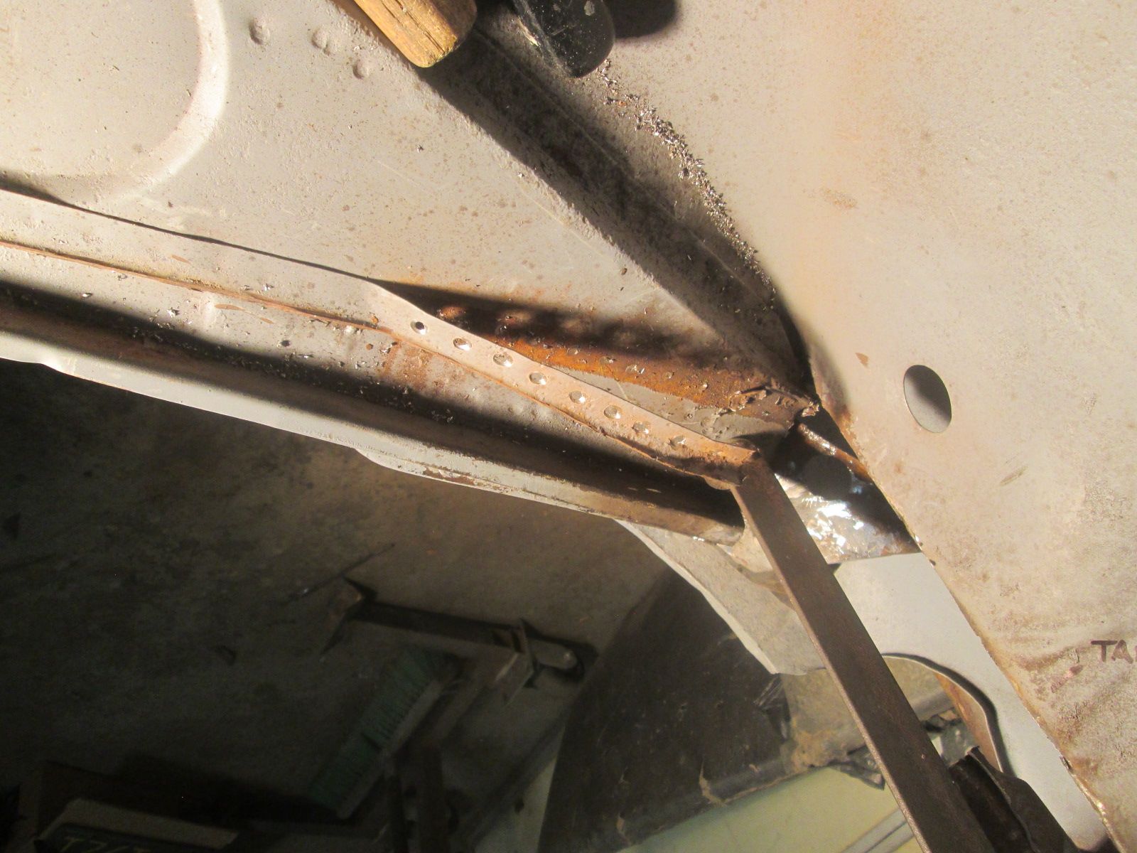

            • Flange clean up continued.
              Click image for larger version  Name:	IMG_3413.jpg Views:	0 Size:	234.4 KB ID:	117205 Finally touched bottom in this left corner. Gusset and pinch seam cleaned of the last remains of the old cross-member. Still have to clean off that strip of metal down the sides of the frame which was the old mounting flange. That a bit later.
              Click image for larger version  Name:	IMG_3423.jpg Views:	3 Size:	193.8 KB ID:	117206 Moving over to the right side of the pinch seam. It became clear that this side did not fare well and was too thin and compromised to salvage.
              Click image for larger version  Name:	IMG_3424.jpg Views:	3 Size:	188.4 KB ID:	117207
              Decided to replace the entire right side of it. Didn't replace more than I had to though and made my break line right whare the severe rot ended.
              Click image for larger version  Name:	IMG_3427.jpg Views:	3 Size:	231.0 KB ID:	117208 It was the right decision. As I was attempting to get the rest of the old cross member flange free in the corner the pinch seam was coming apart all around it as I worked the area.

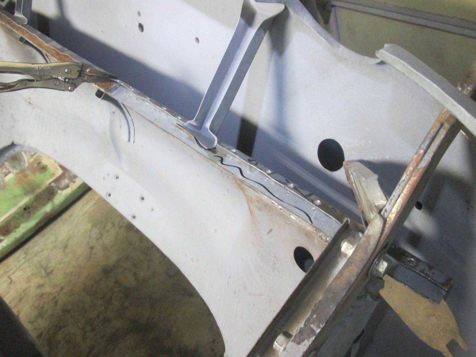

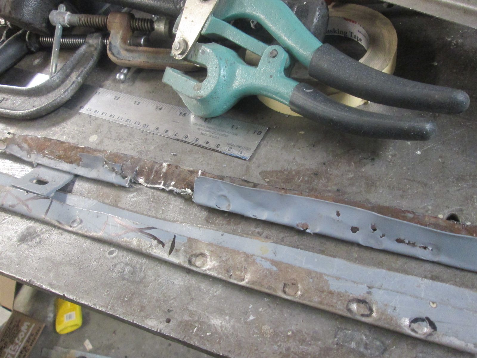

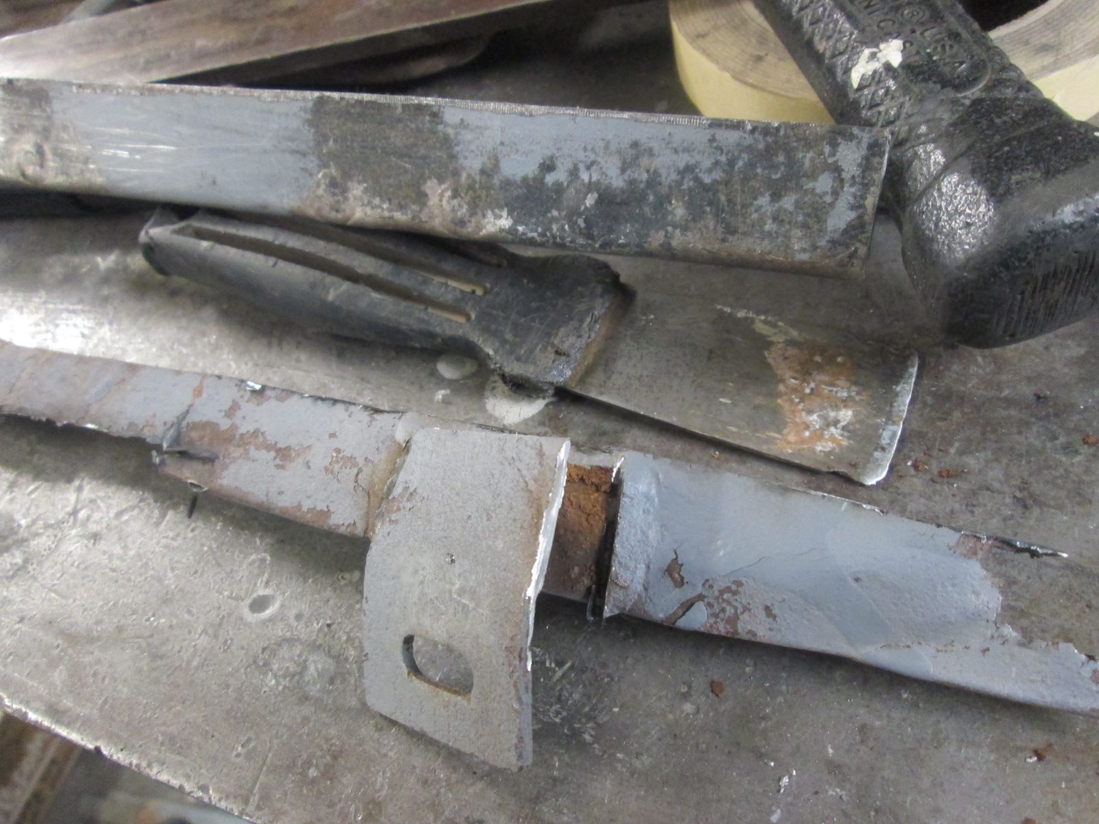

              • Flange repair continued:
                Click image for larger version  Name:	IMG_3441.jpg Views:	0 Size:	266.4 KB ID:	117213 Replacement section folded over into a new pinch flange. Since I'm only replacing half of it I didnt want it to look too fresh continuing on from the section that is staying. The factory used these enormous spot welds along the entire run. I wanted to mimic this detail as close as I could so I turned my hole puncher die over to the shouldered blunt end which produced this detent at just about the right size. This is just cosmetic to season its appearance a bit as this run will ultimately be secured with plug welds.

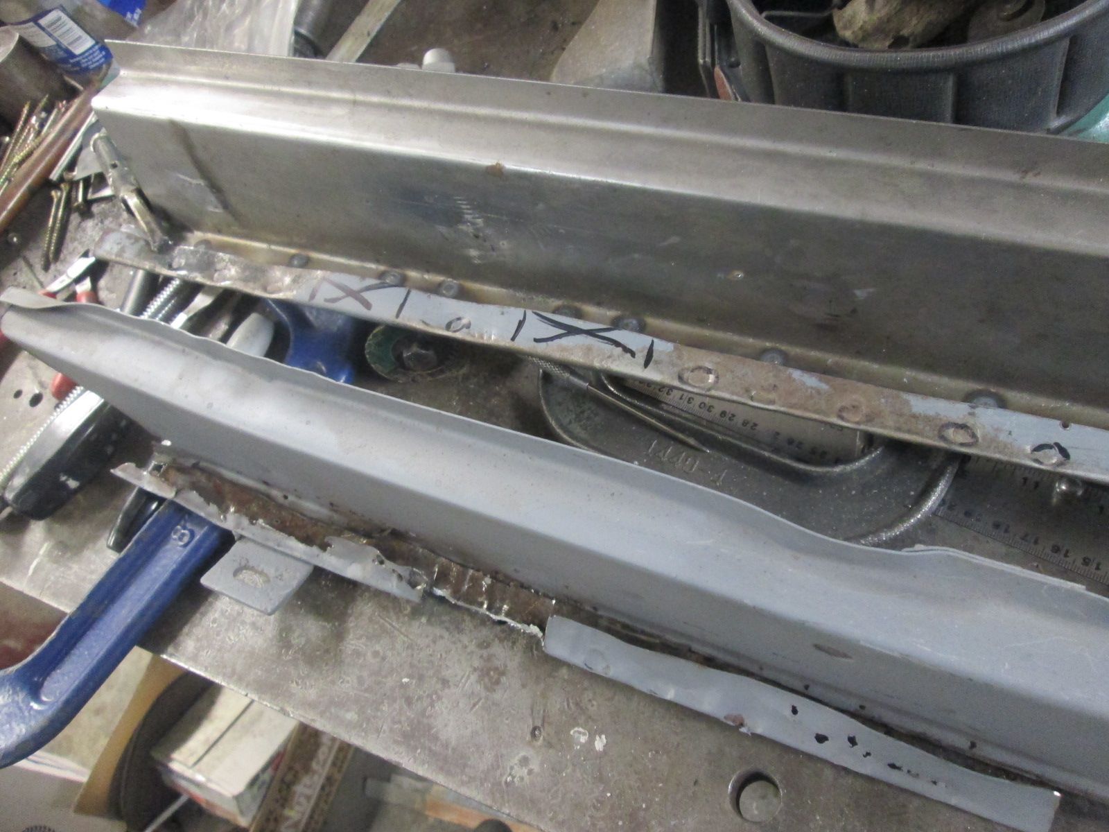

                Click image for larger version  Name:	IMG_3442.jpg Views:	3 Size:	233.9 KB ID:	117214 New crossmember and replacement flange section just about ready to finally go in.
                Click image for larger version  Name:	IMG_3443.jpg Views:	3 Size:	217.5 KB ID:	117215 X's are marked for the apron strut and the over rider tube mount placement.
                Click image for larger version  Name:	IMG_3445.jpg Views:	3 Size:	193.5 KB ID:	117216 Begin fitting the new flange section and final trimming at the outer corner.
                Click image for larger version  Name:	IMG_3446.jpg Views:	3 Size:	254.6 KB ID:	117217 Harvesting the tube mount as this and the apron strut have to be welded on first as there is no access to weld them once the flange is mounted.

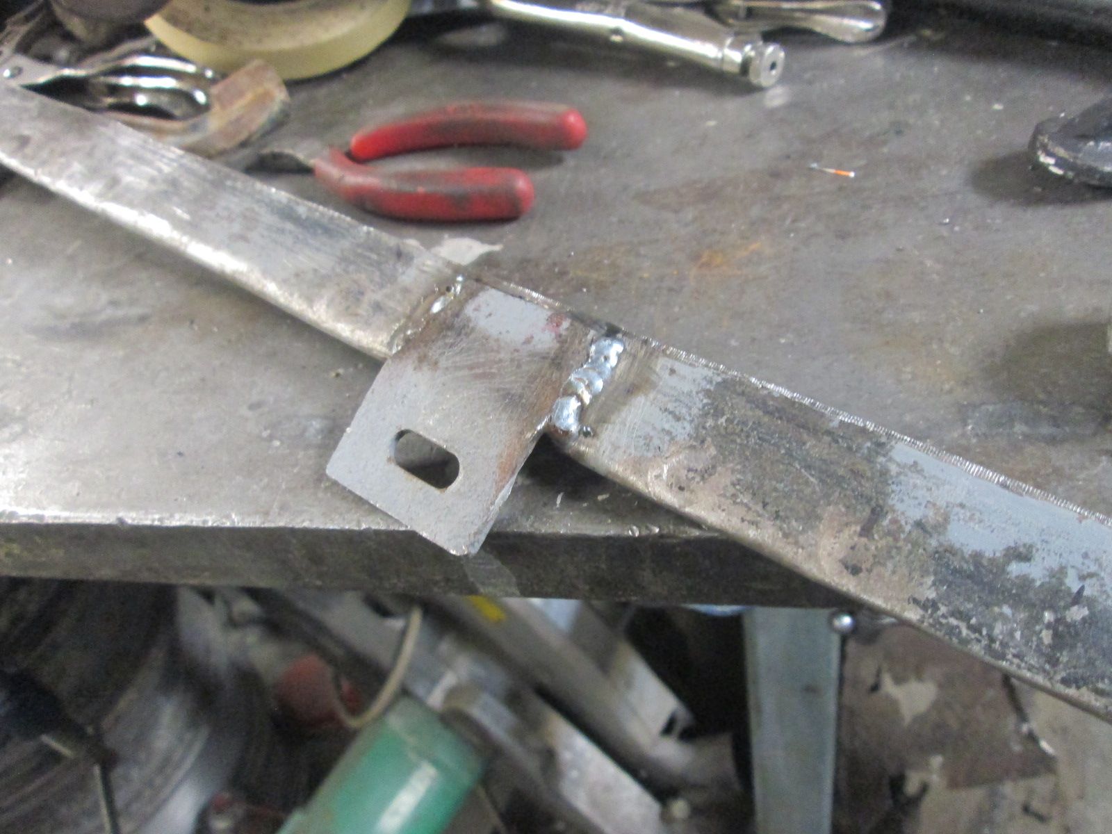

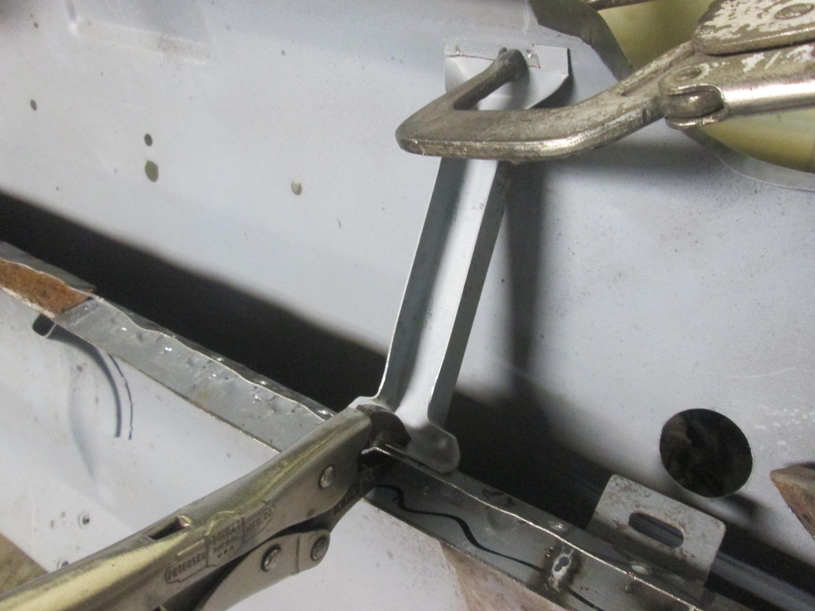

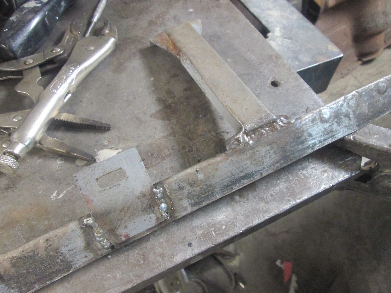

                • Transplanting the brackets:
                  Click image for larger version  Name:	IMG_3447.jpg Views:	0 Size:	216.9 KB ID:	117225 No way to get a clear shot at welding this bracket on with the flange installed so now was the time.
                  Click image for larger version  Name:	IMG_3458.jpg Views:	6 Size:	182.4 KB ID:	117226 The apron bracket had to go on first as well. Dialing in its lateral position in relation to the strut bracket here. The apron brace is back into its original position with the strut tube mount centered with the hole in the body.
                  Click image for larger version  Name:	IMG_3459.jpg Views:	6 Size:	246.1 KB ID:	117227 All welded with a seam weld as attached originally. Just a little more clean up prep and this new repair section can go in.
