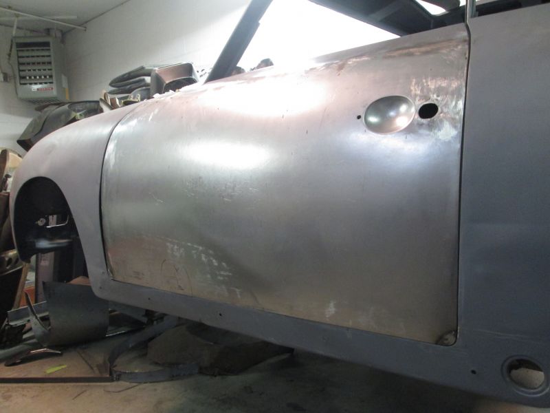

      Forward corner of the rocker sags a little but it still needs to be removed to repair the longitudinal so I'll have my opportunity to clean this line up against the final finished shape of this repaired door.

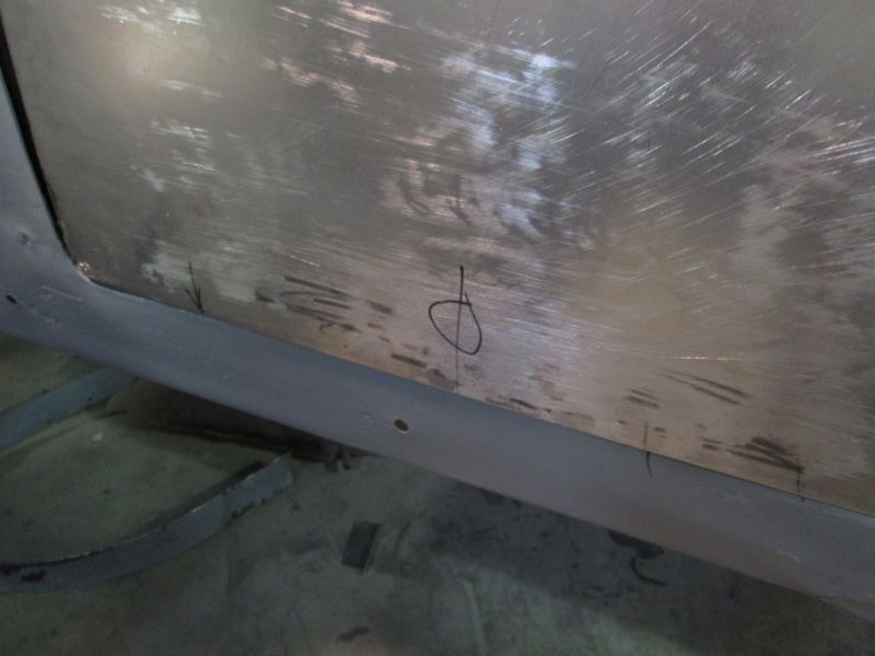

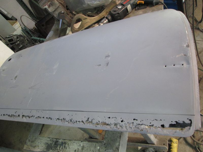

      But before I could lay down my first tack weld I noticed this really strong crown or bulged at the center in relation to the rocker. The rocker is slightly bent inward but the threshold line is still straight and the center of this skin was hanging out way too far.

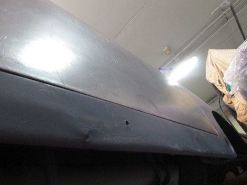

      Once I dismounted the door and removed the skin my straight edge highlighted the problem. The lower flange is bowed at the center. I checked some original examples and the best I can tell is that there is some slight bow in the factory flanges but not this pronounced. As more confirmation the new repair section for the right side isn't this curvy.

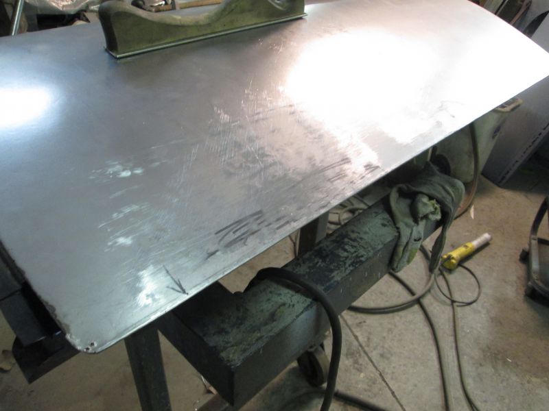

      A little hammer work to reduce some of that excess curve. Always something.

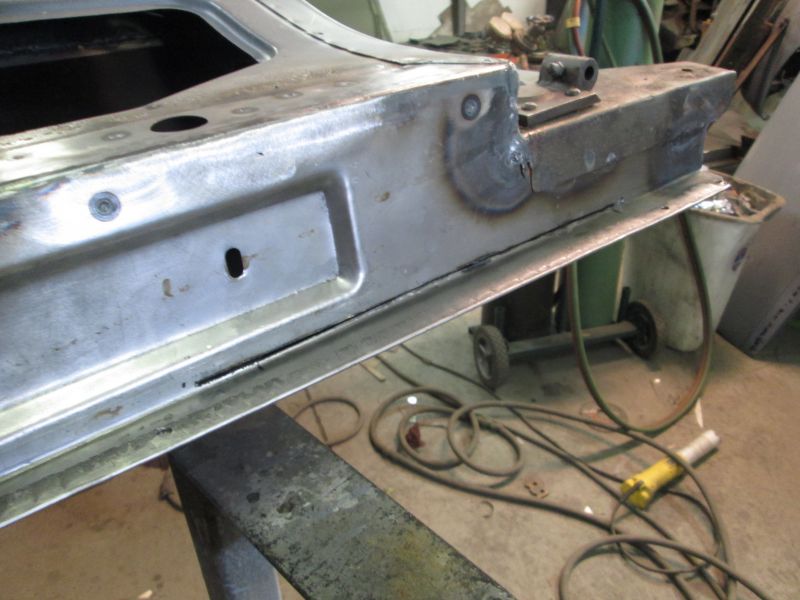

      The entire upper run is a slight overlap and I was in no mood to remove it one more time just to get that last fine trim in.

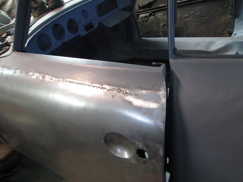

      I took it in stages and ground back to each of my initial tack welds then carefully set and tacked these small runs into final position then repeated the process. At this point I just have a little more to grind out at the front but she's almost there. Much to my great relief this joint is holding the shape I need so far.

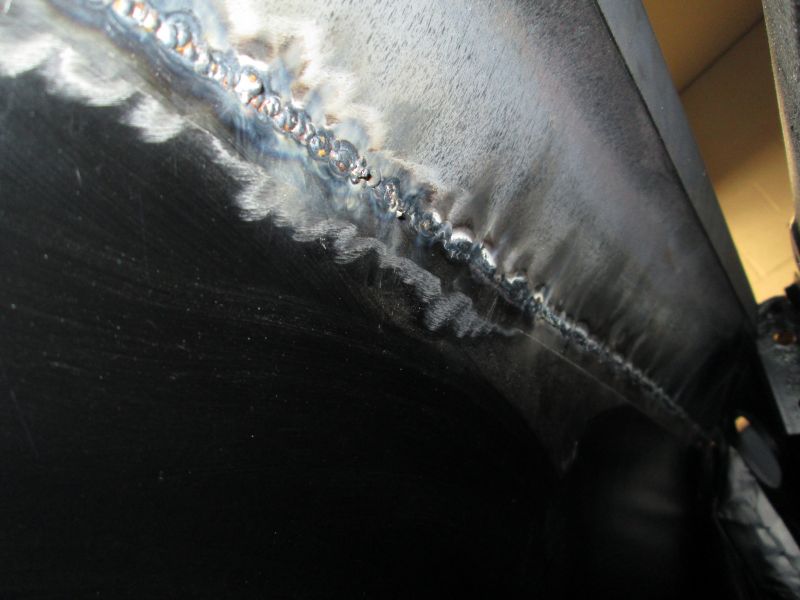

                This long upper weld joint fully stitched and ground.
                A great relief to get this one in the books and with minimal distortion.

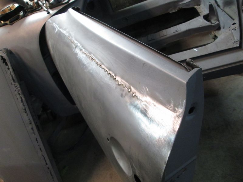

                A quick pass with a body file highlights the irregularities. Nothing serious

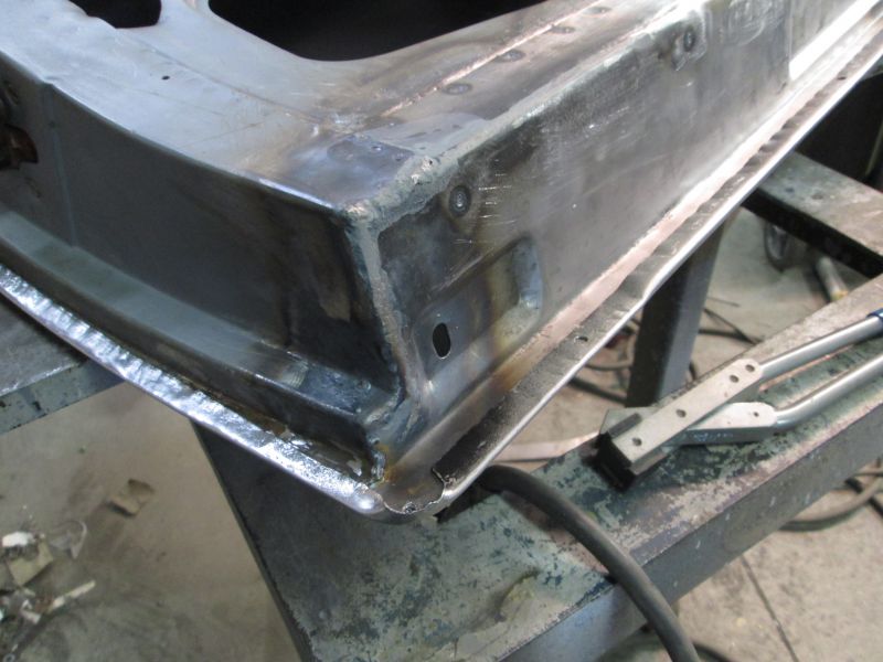

                            Moved to the rear corner to heat and roll it over tight. Relief shape not quite right.
                            Referred to this original.
                            Horizontal flange continues onto the edge and since this will always show a small patch was added for the right detail.
                            Welded and dressed. The vertical flange will eventually be smoothed over in lead as originally but I'm not soldering just yet.
