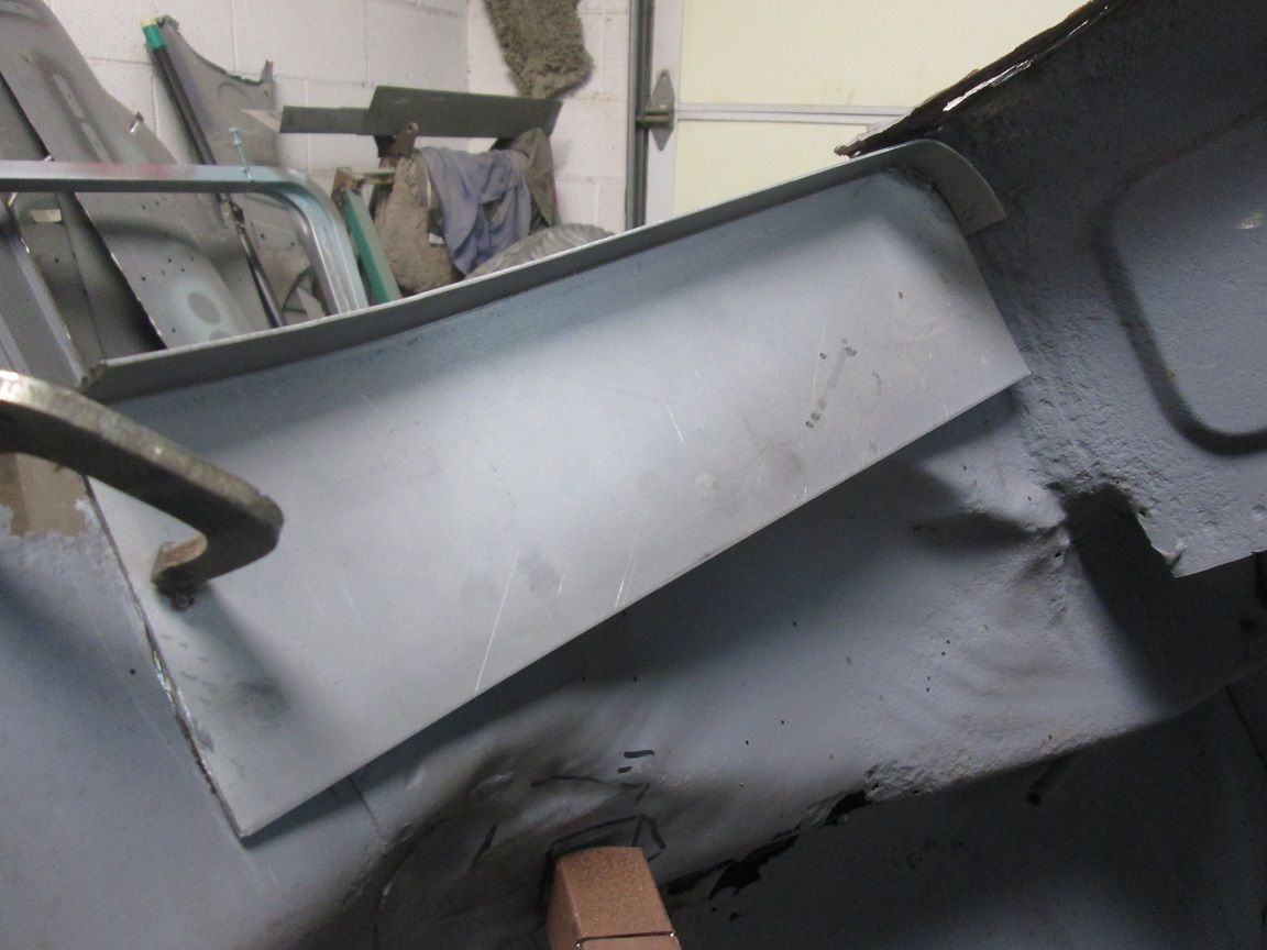

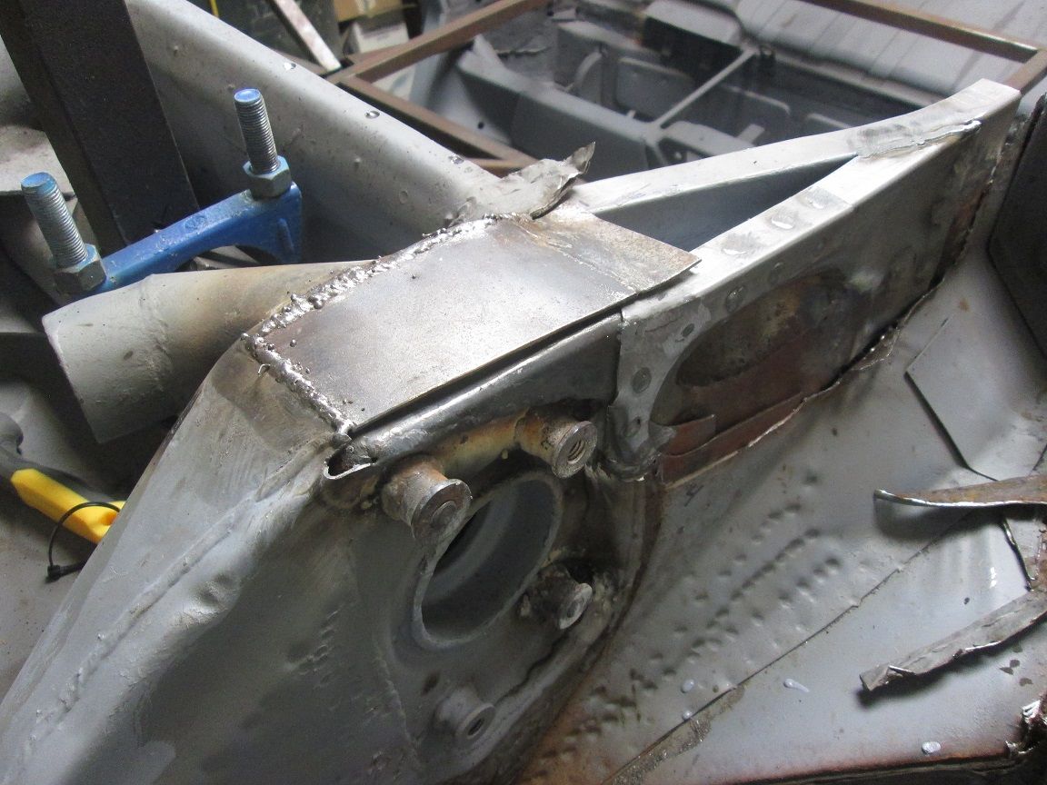

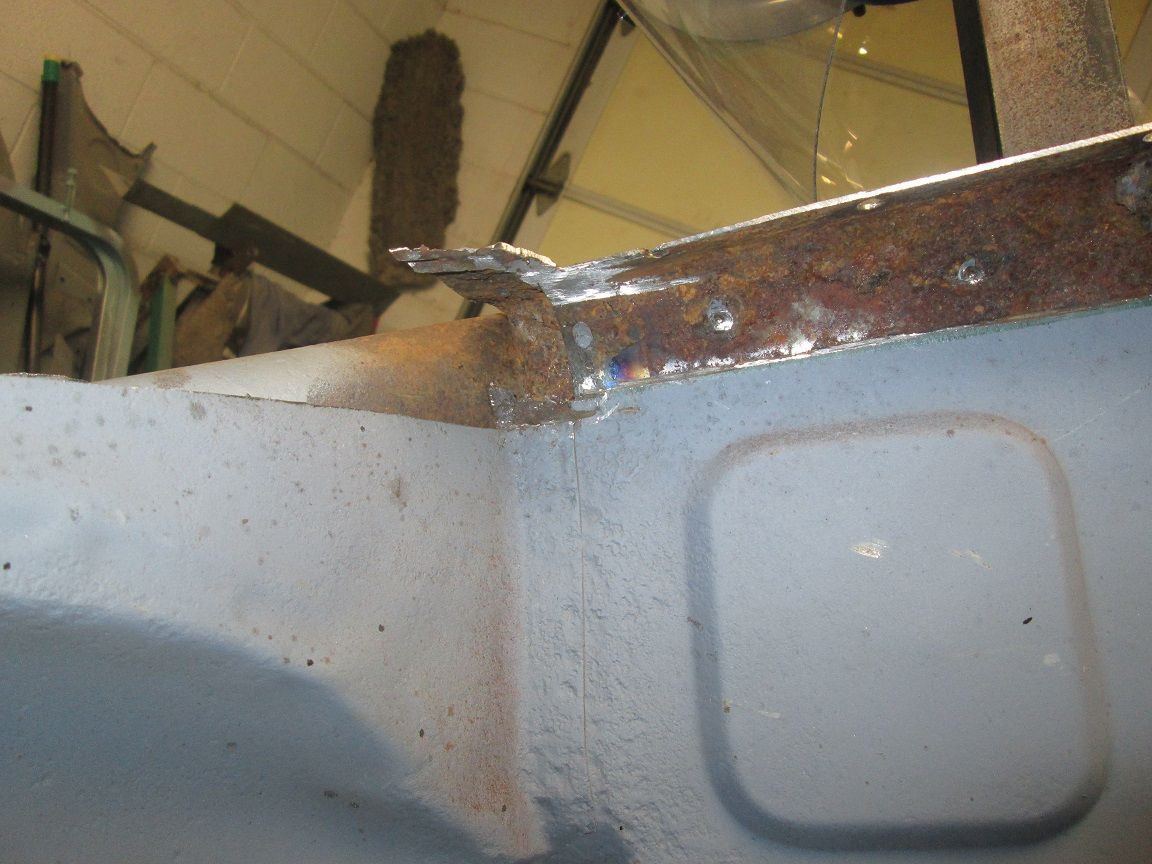

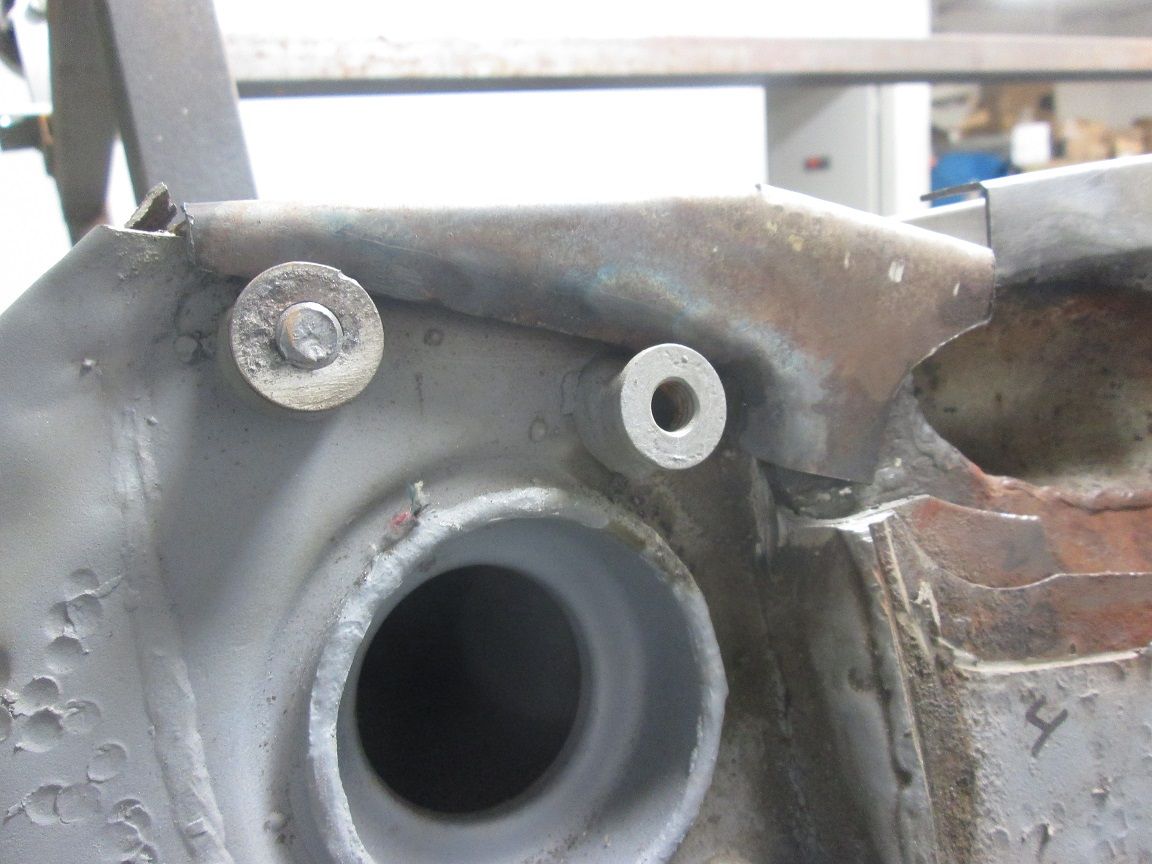

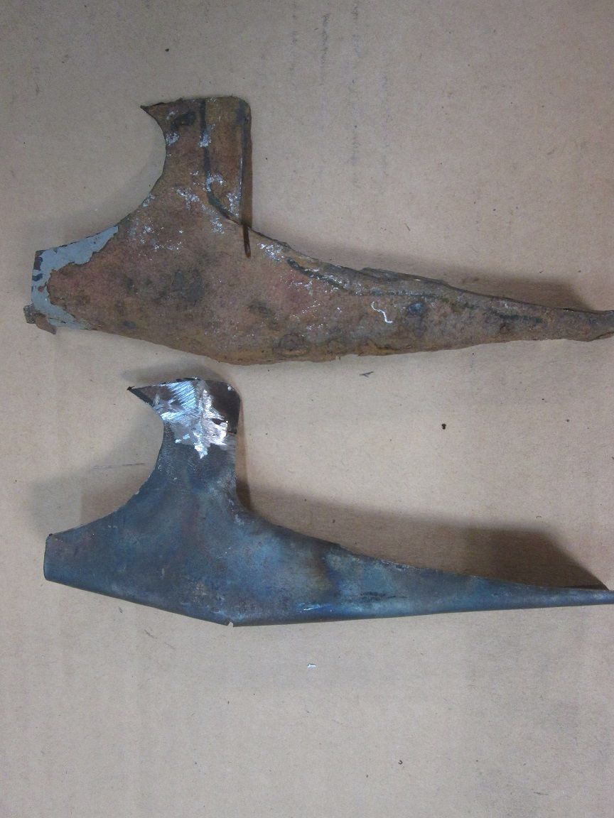

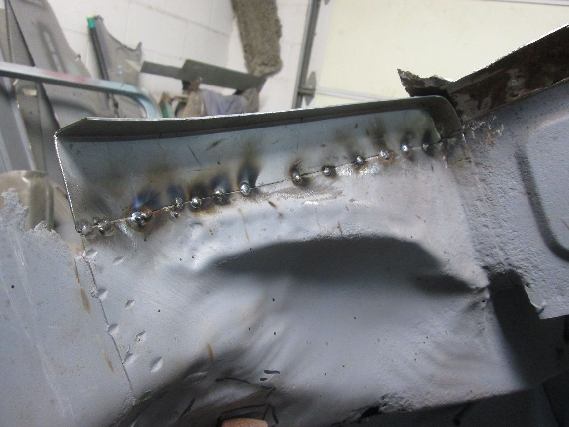

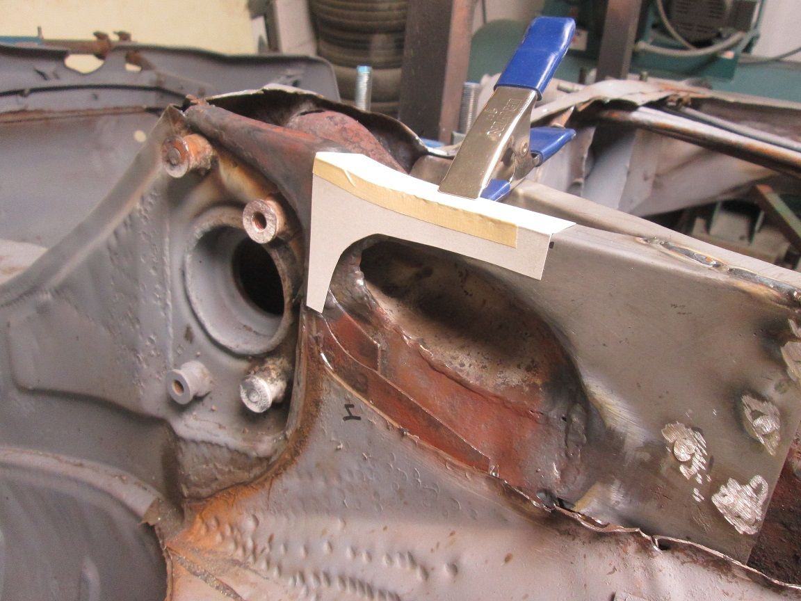

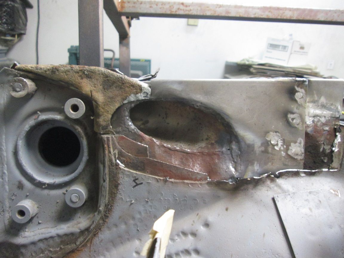

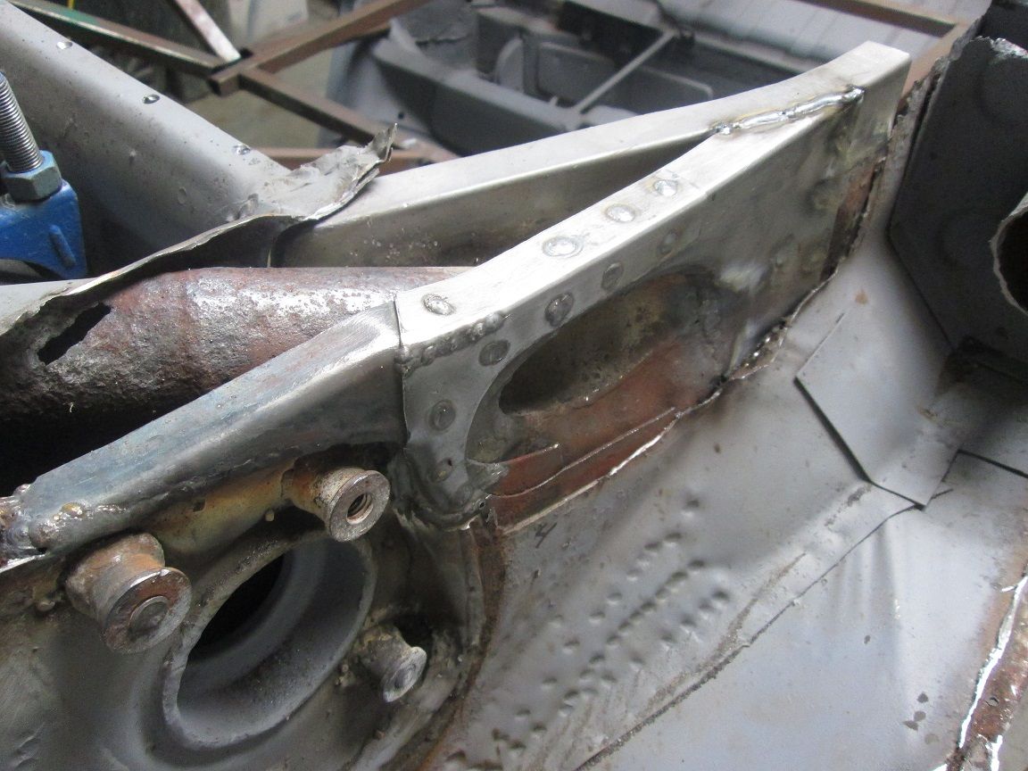

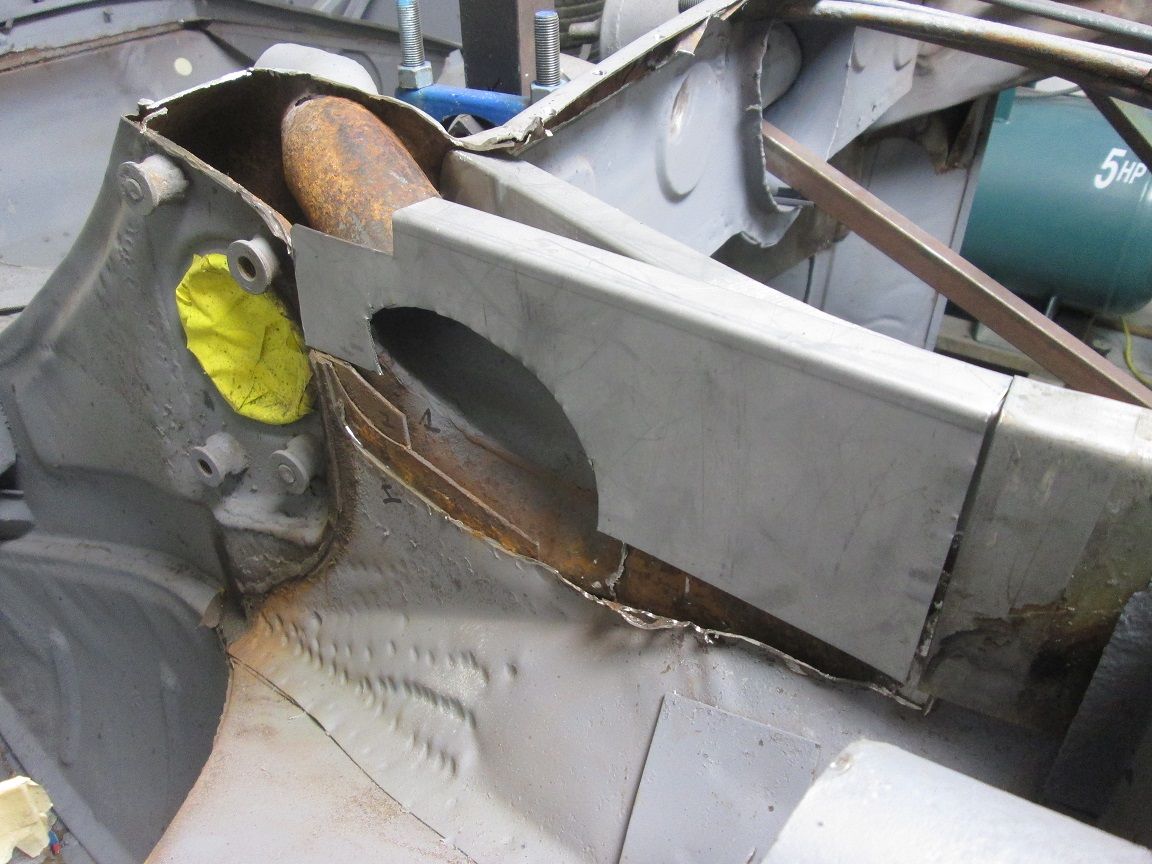

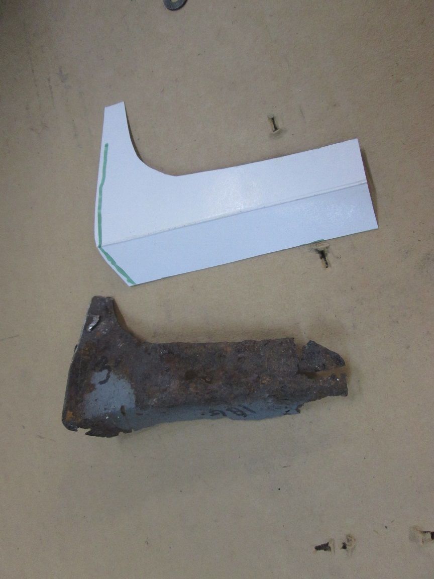

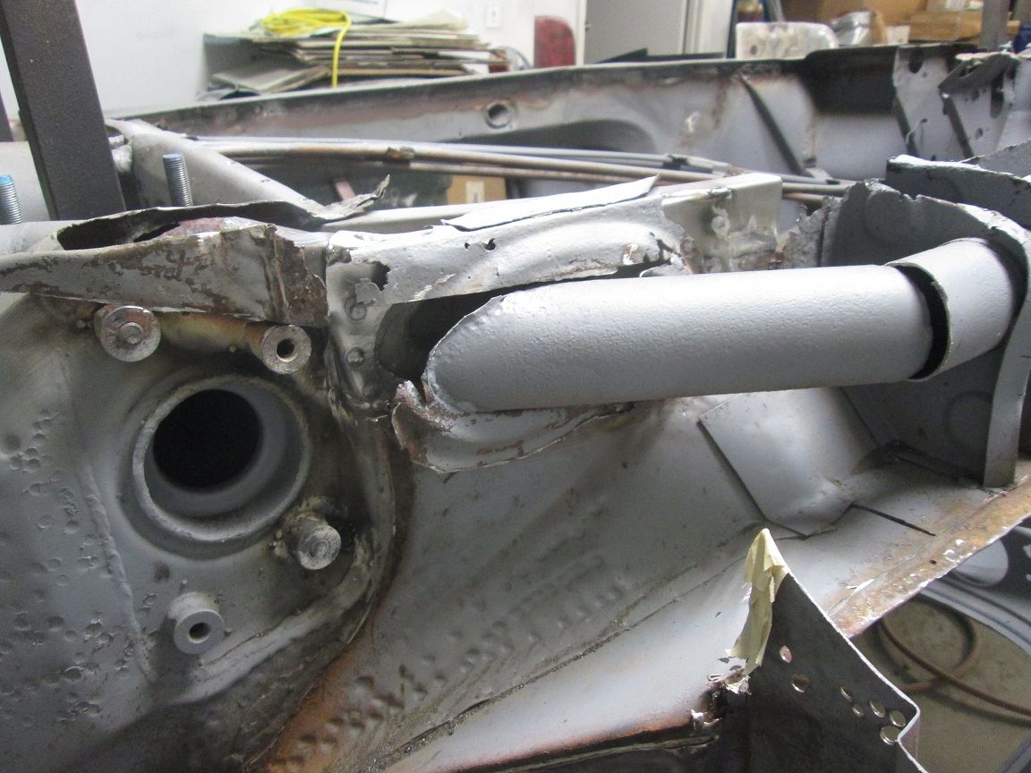

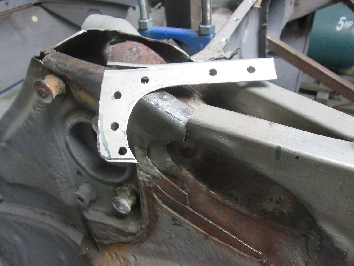

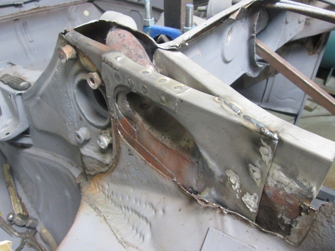

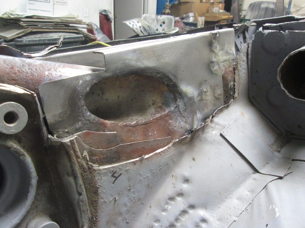

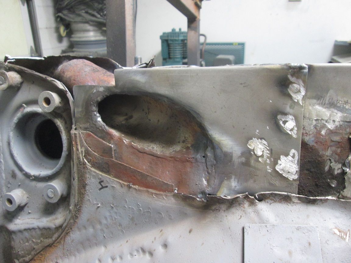

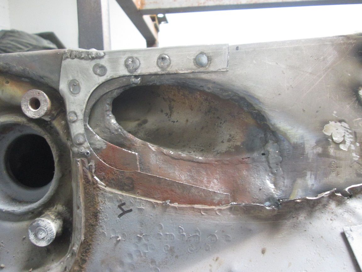

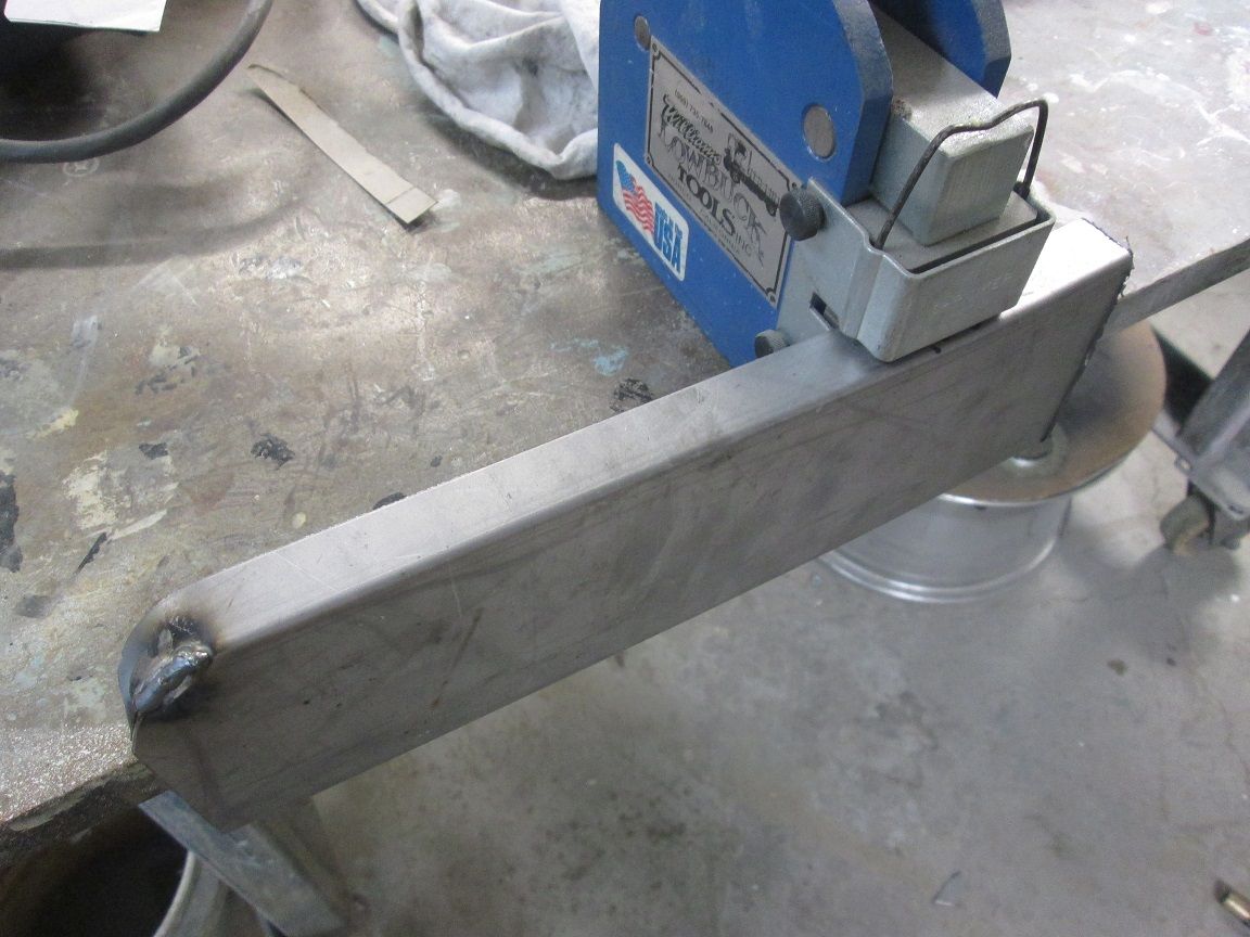

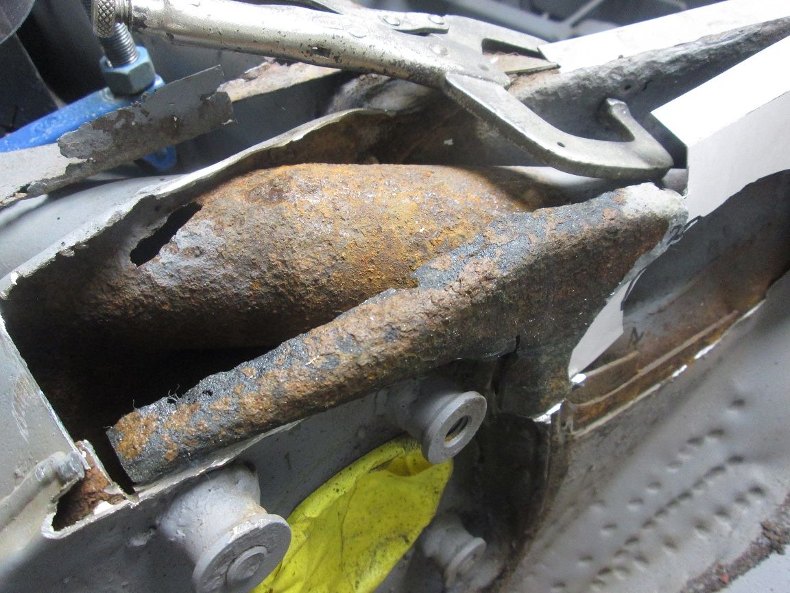

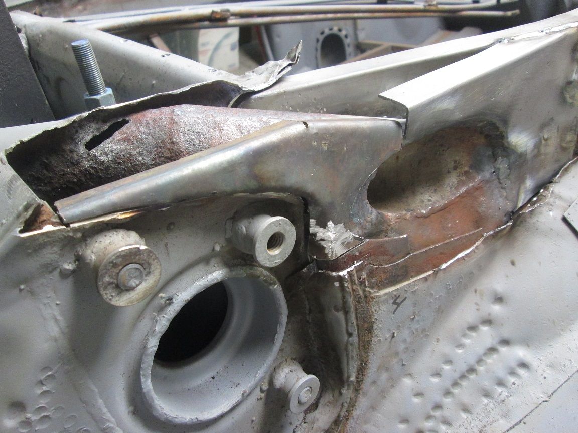

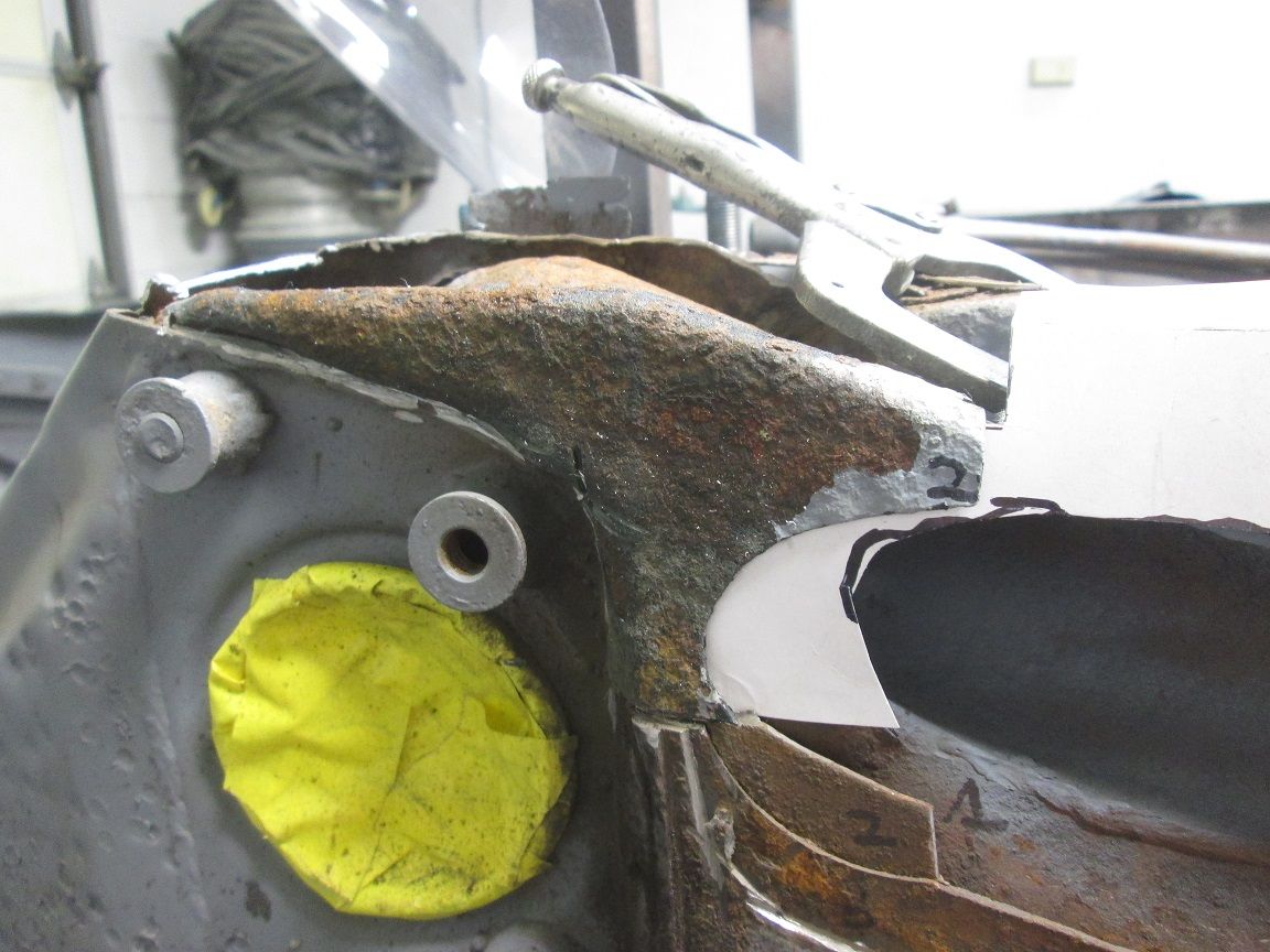

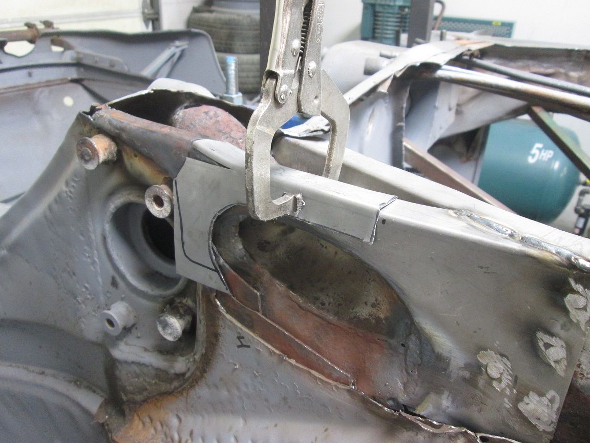

  • template for most inboard panel.

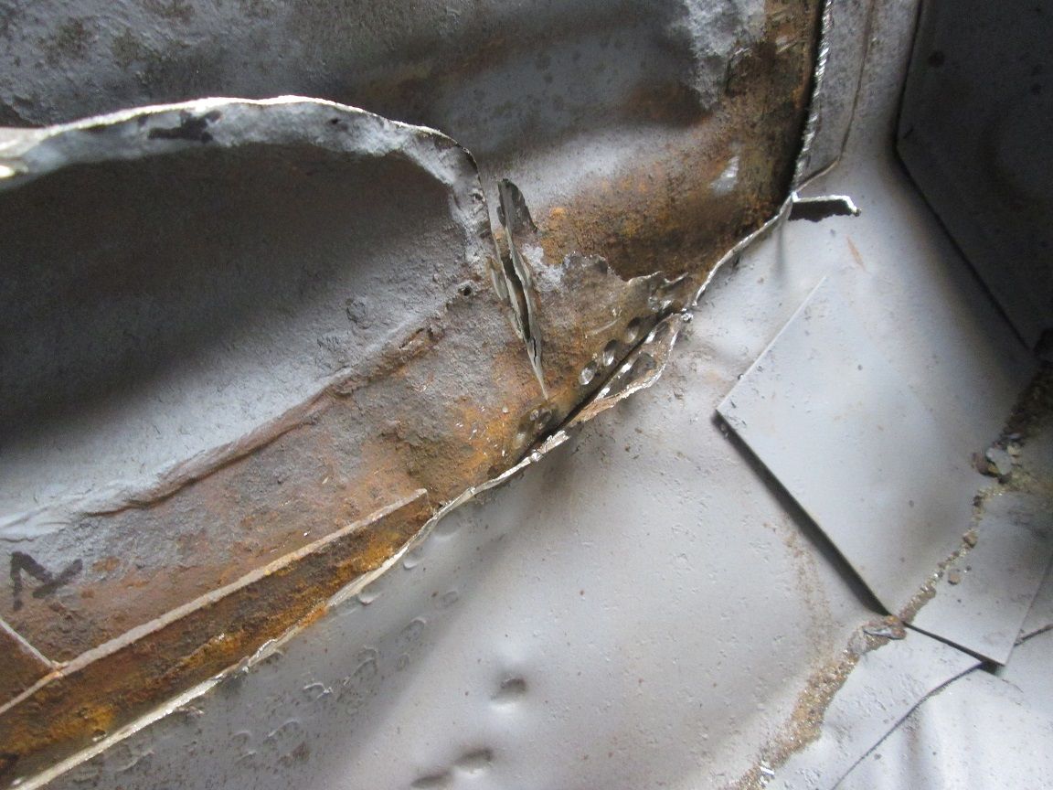

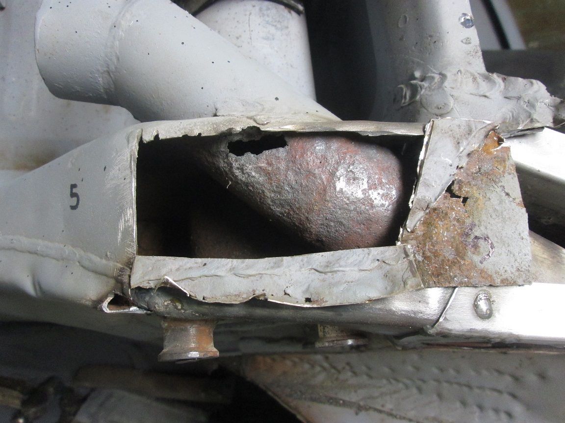

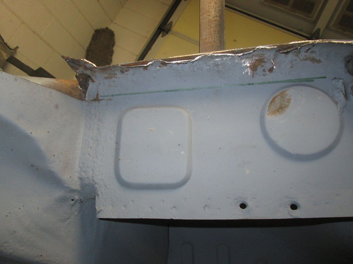

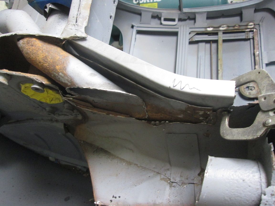

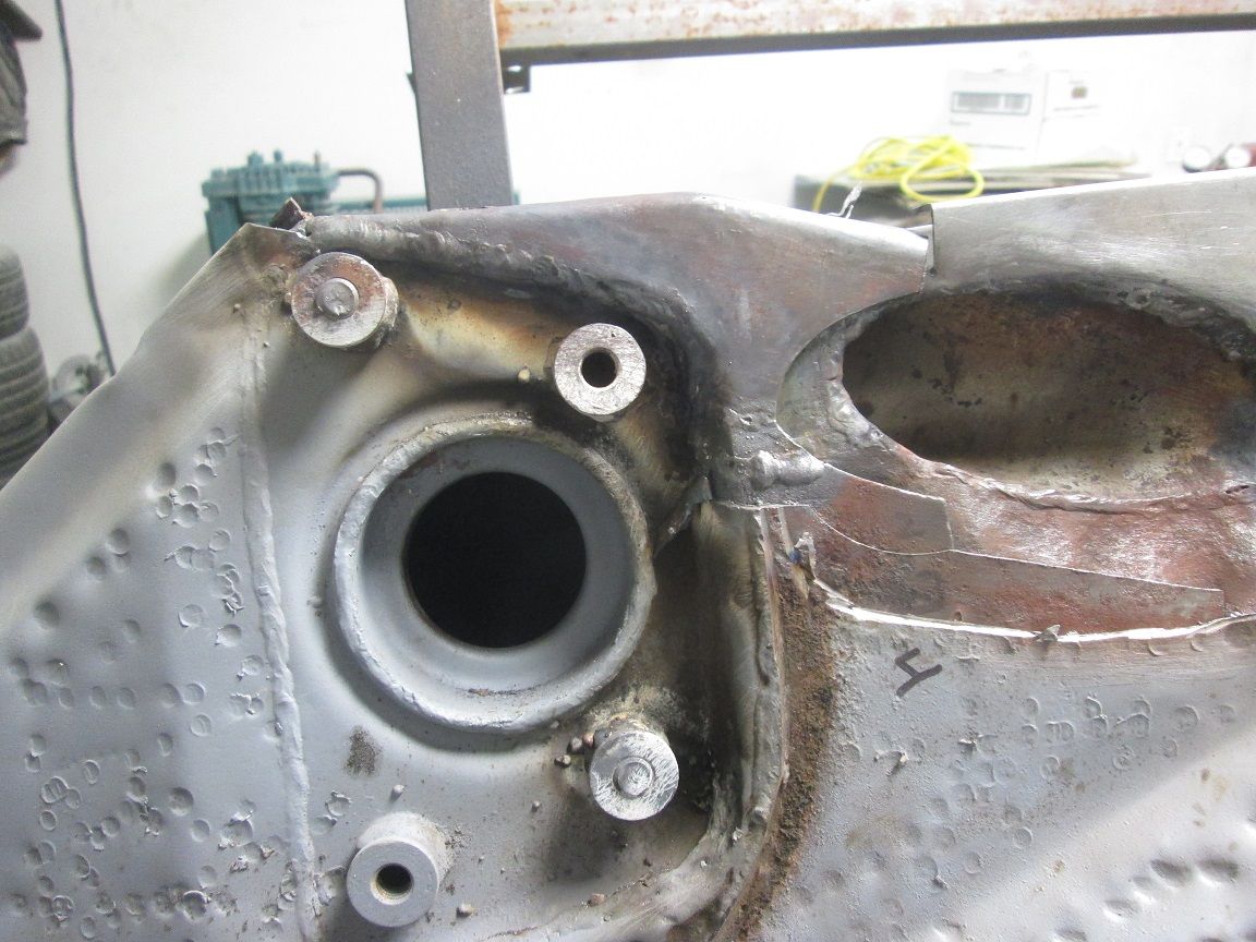

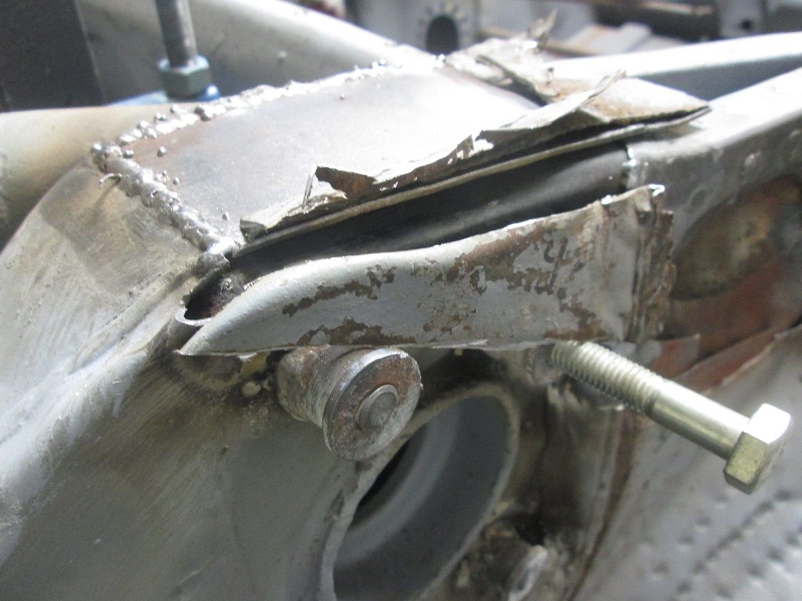

    Click image for larger version  Name:	IMG_7313.JPG Views:	0 Size:	148.9 KB ID:	111110 Getting it trimmed to size for better fitment as it goes

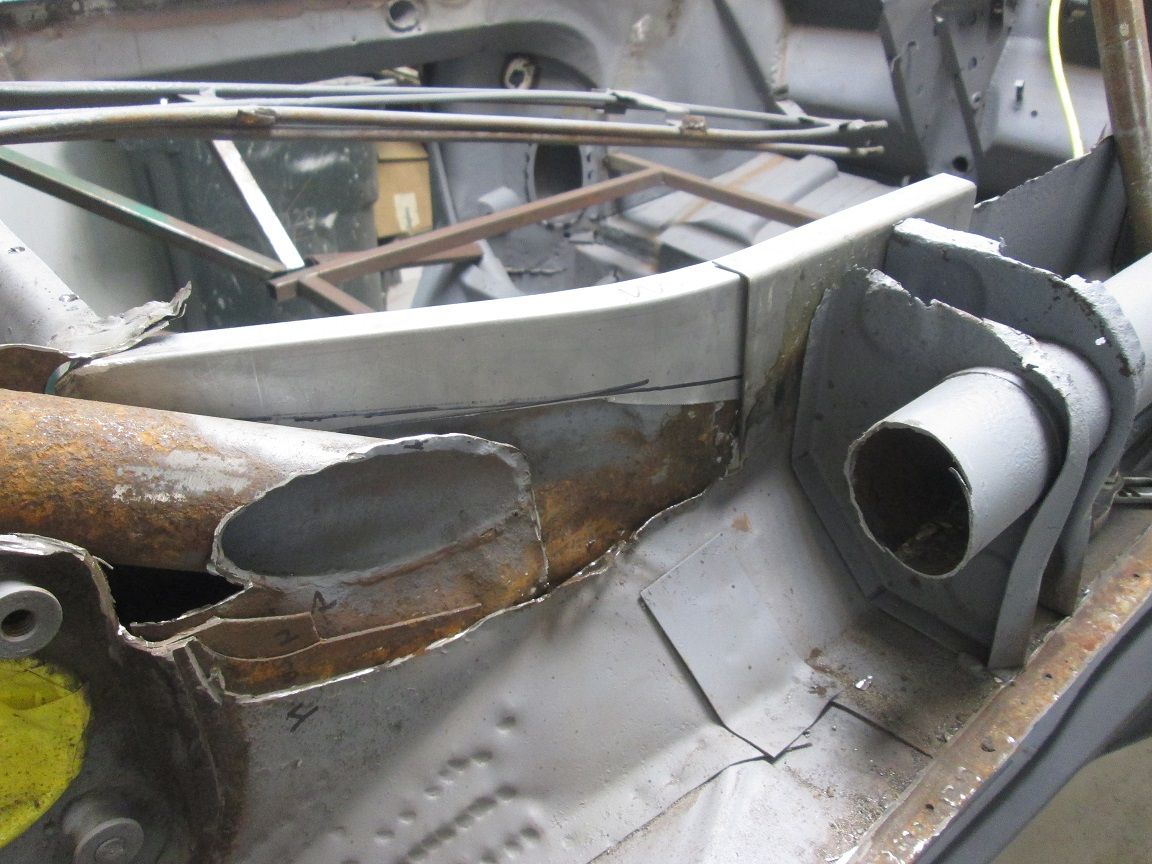

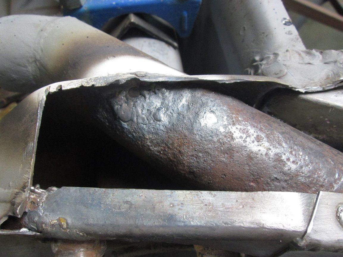

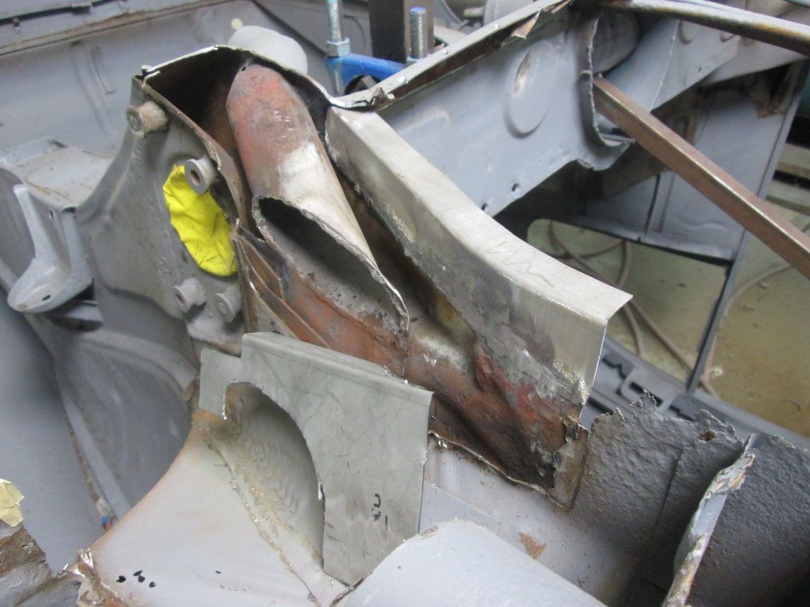

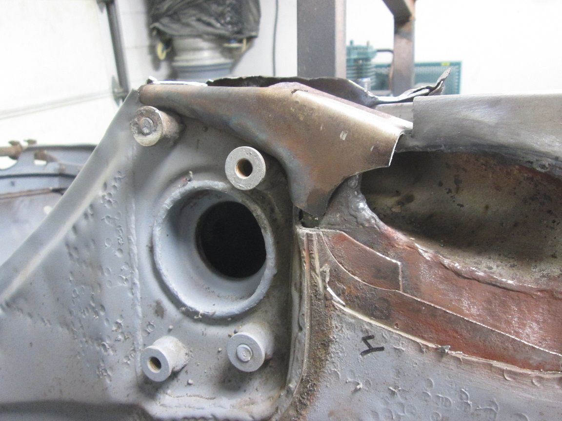

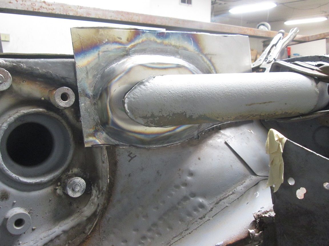

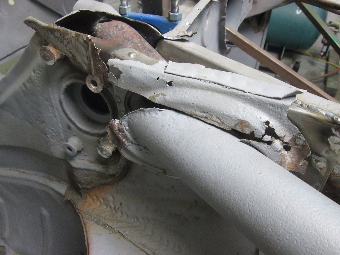

    Click image for larger version  Name:	IMG_7315.JPG Views:	0 Size:	138.8 KB ID:	111111 Highlighting how that main torsion tube anchor point that I had to cut past will layer over the eventual section made from this paper template.

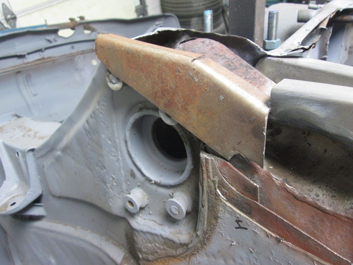

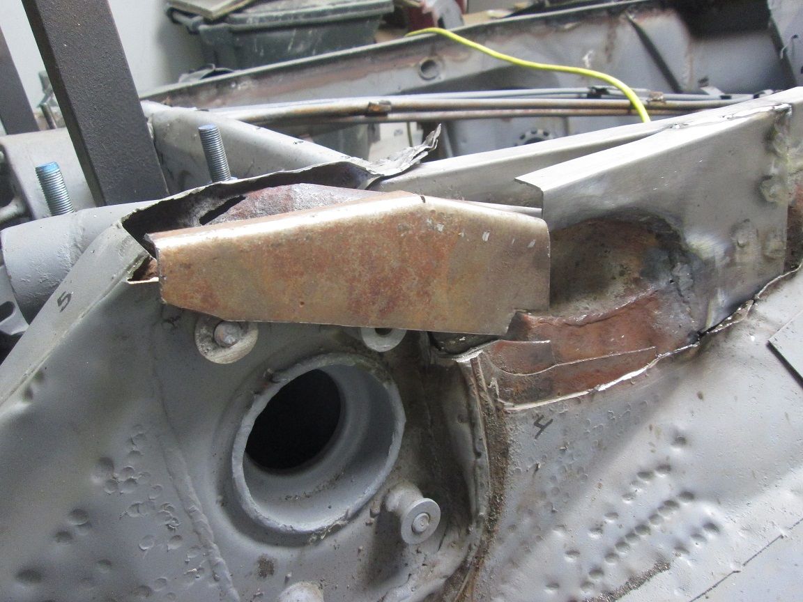

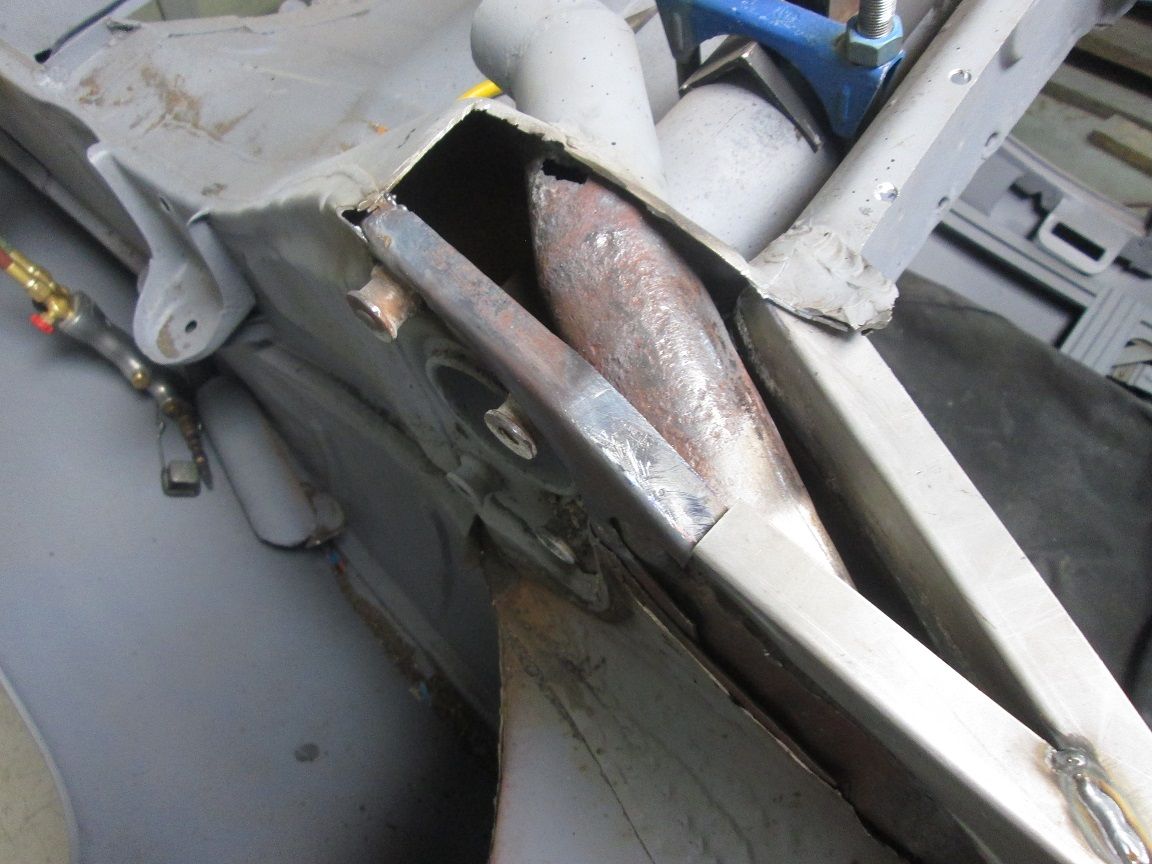

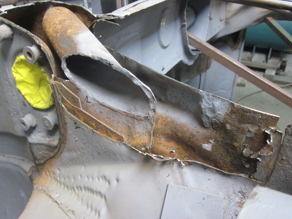

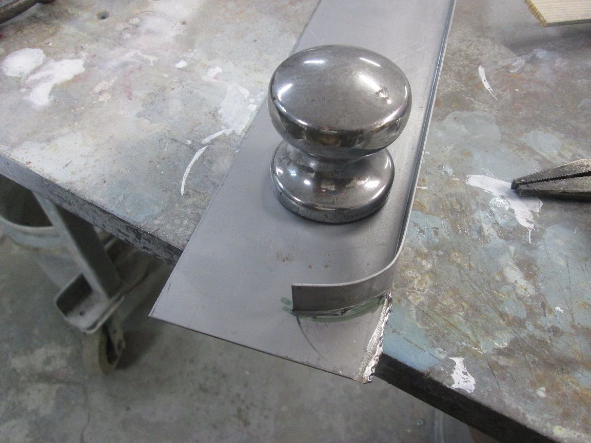

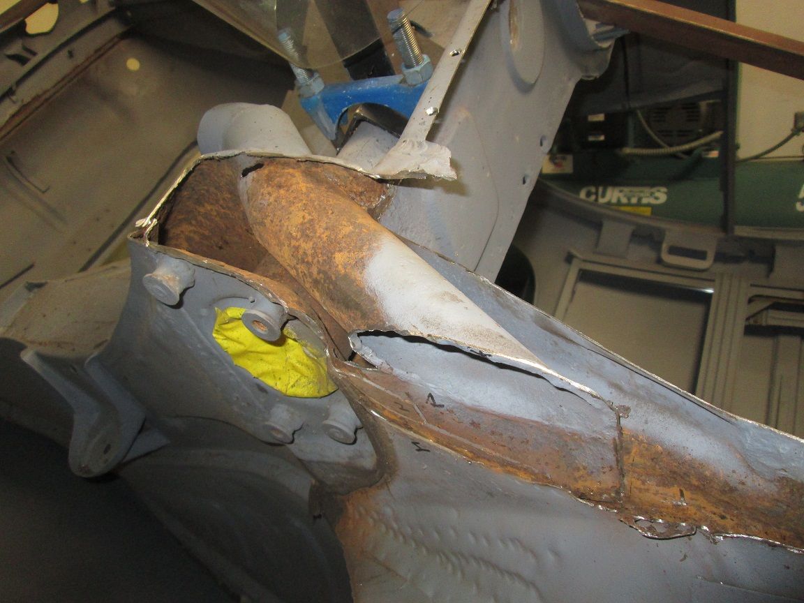

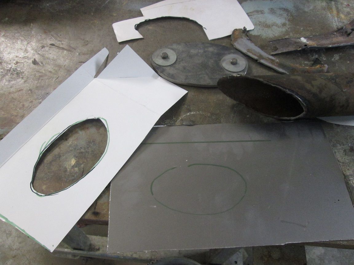

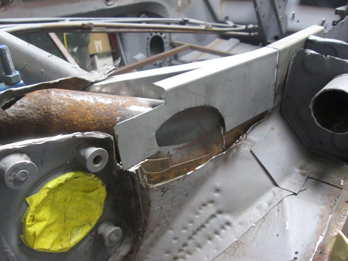

    Click image for larger version  Name:	IMG_7316.JPG Views:	0 Size:	181.8 KB ID:	111112 I have this piece soaking in acid and as its getting cleaner its revealing how thin and compromised it actually is now. This piece was at least 16 gauge to begin with so I may have to fabricate this section from scratch as well.

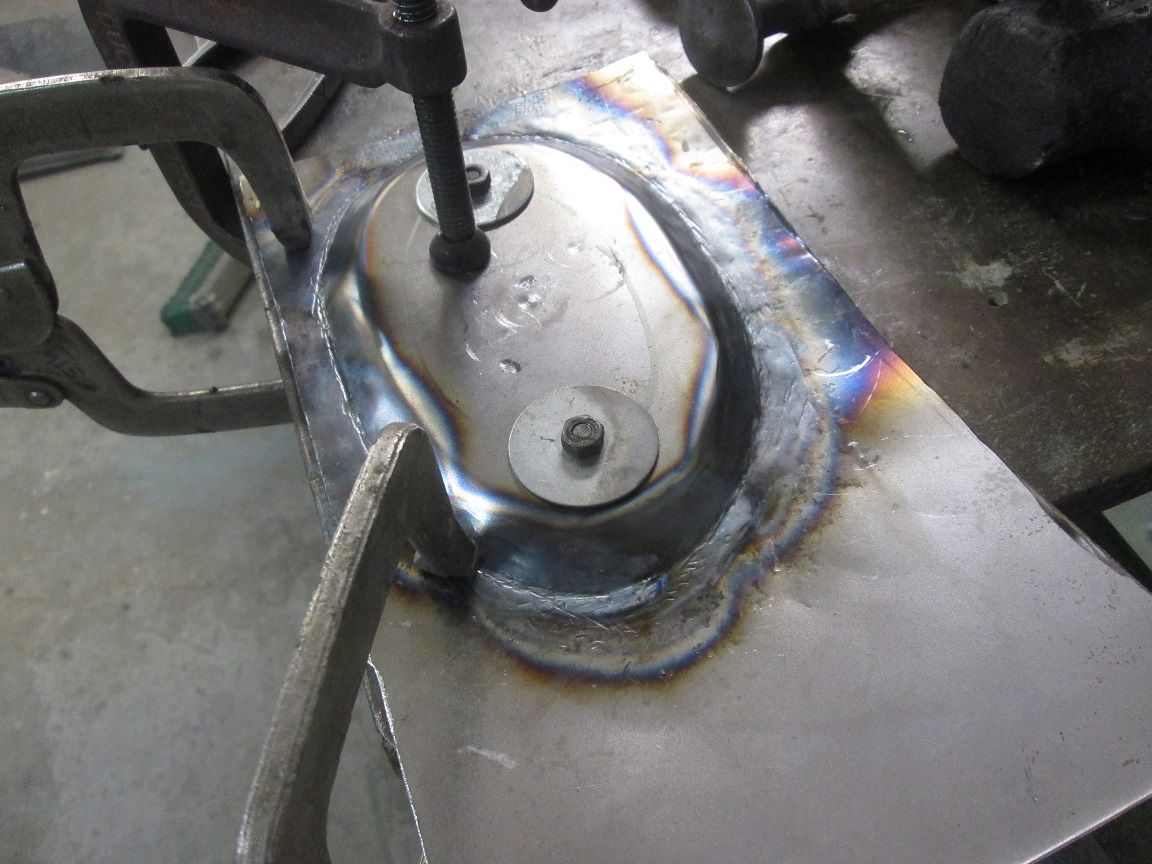

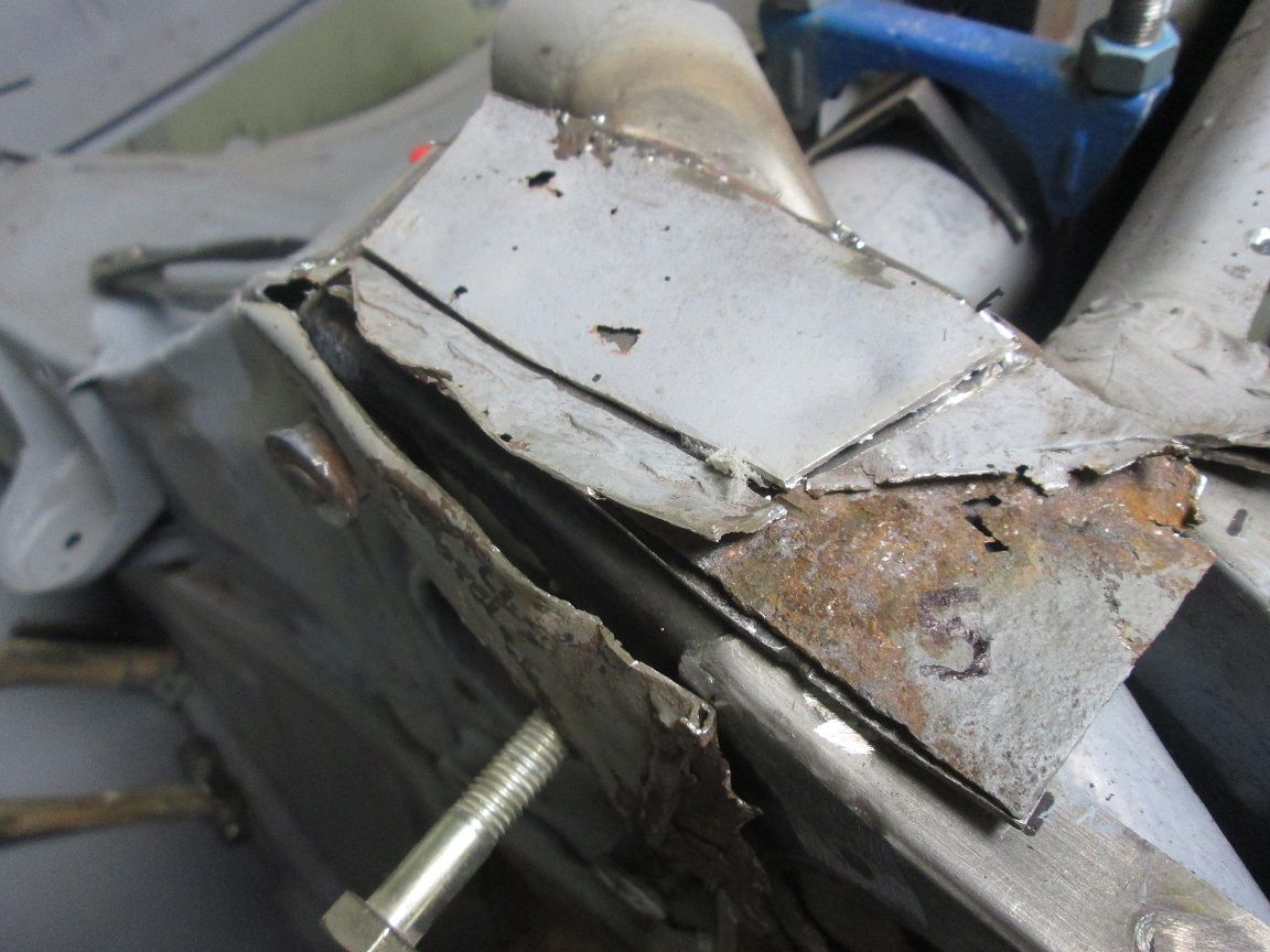

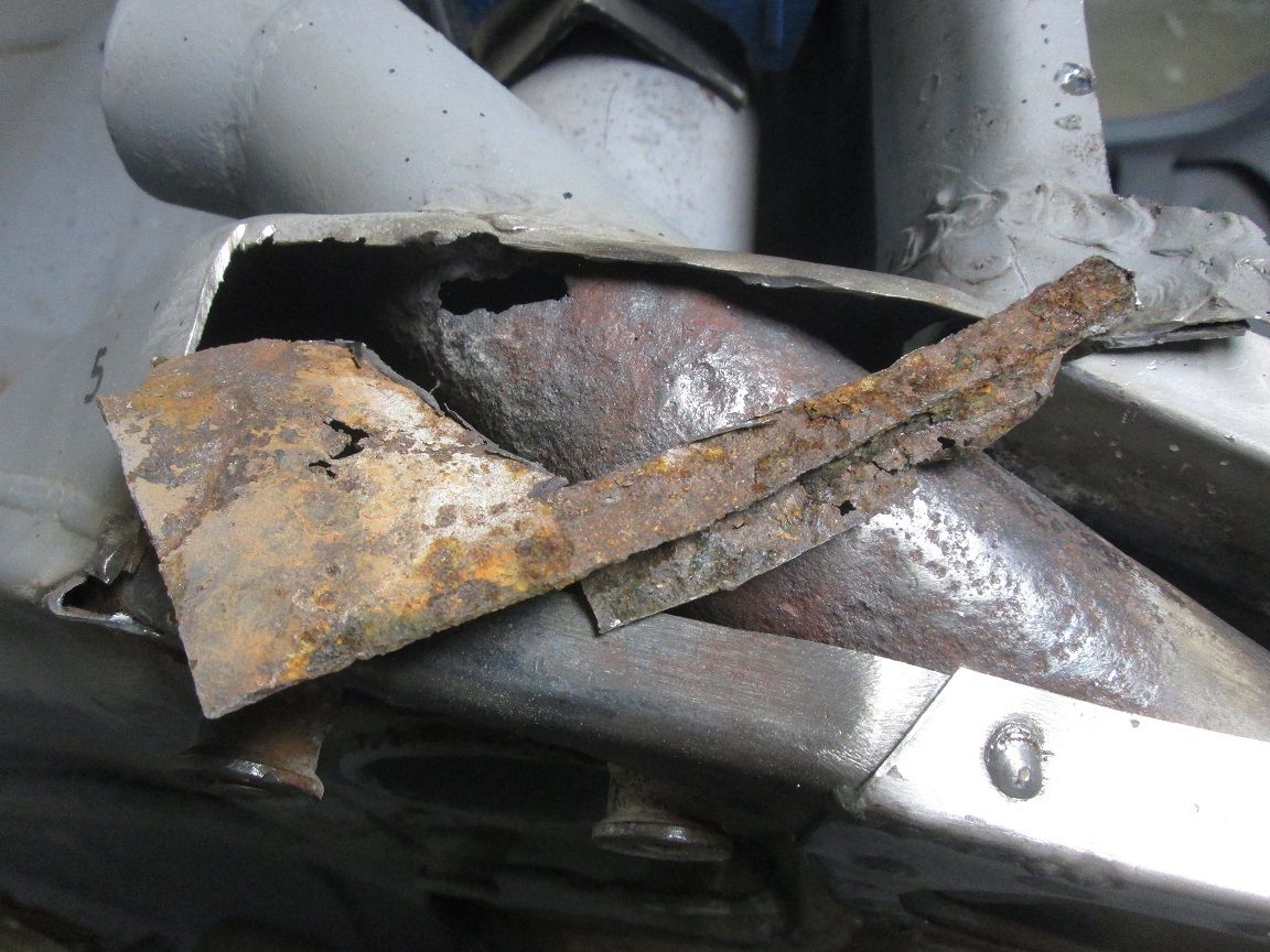

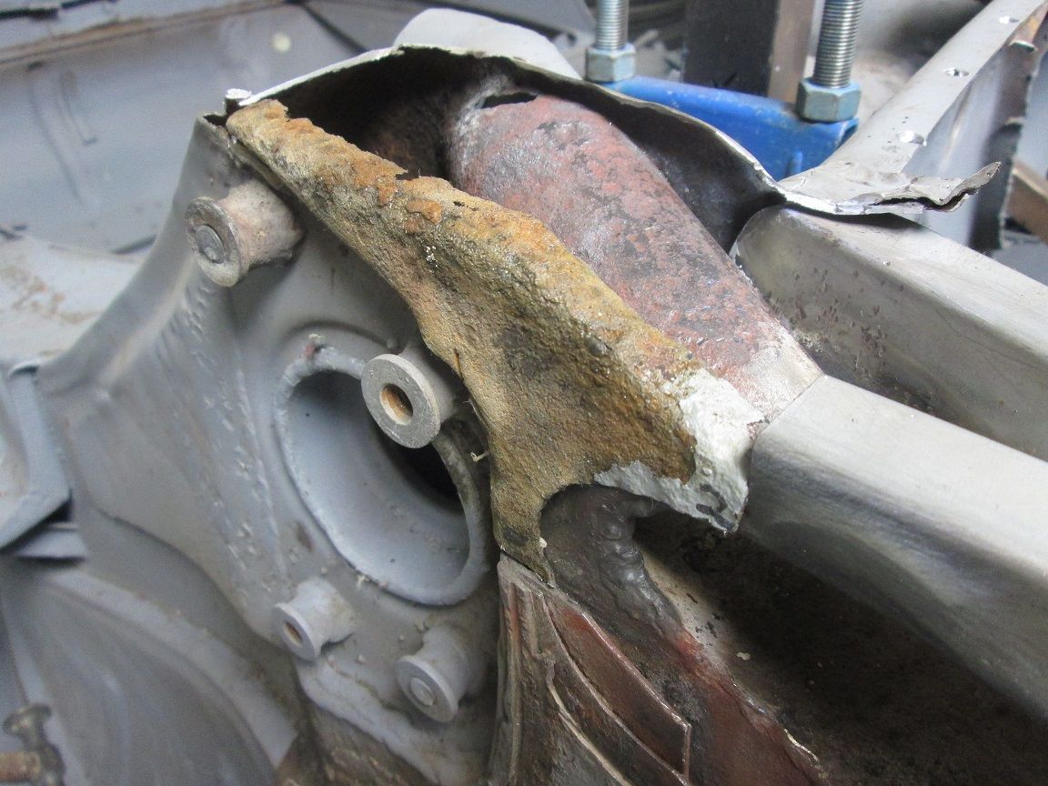

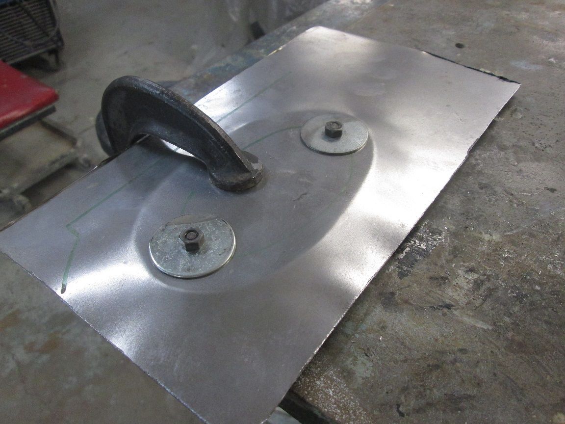

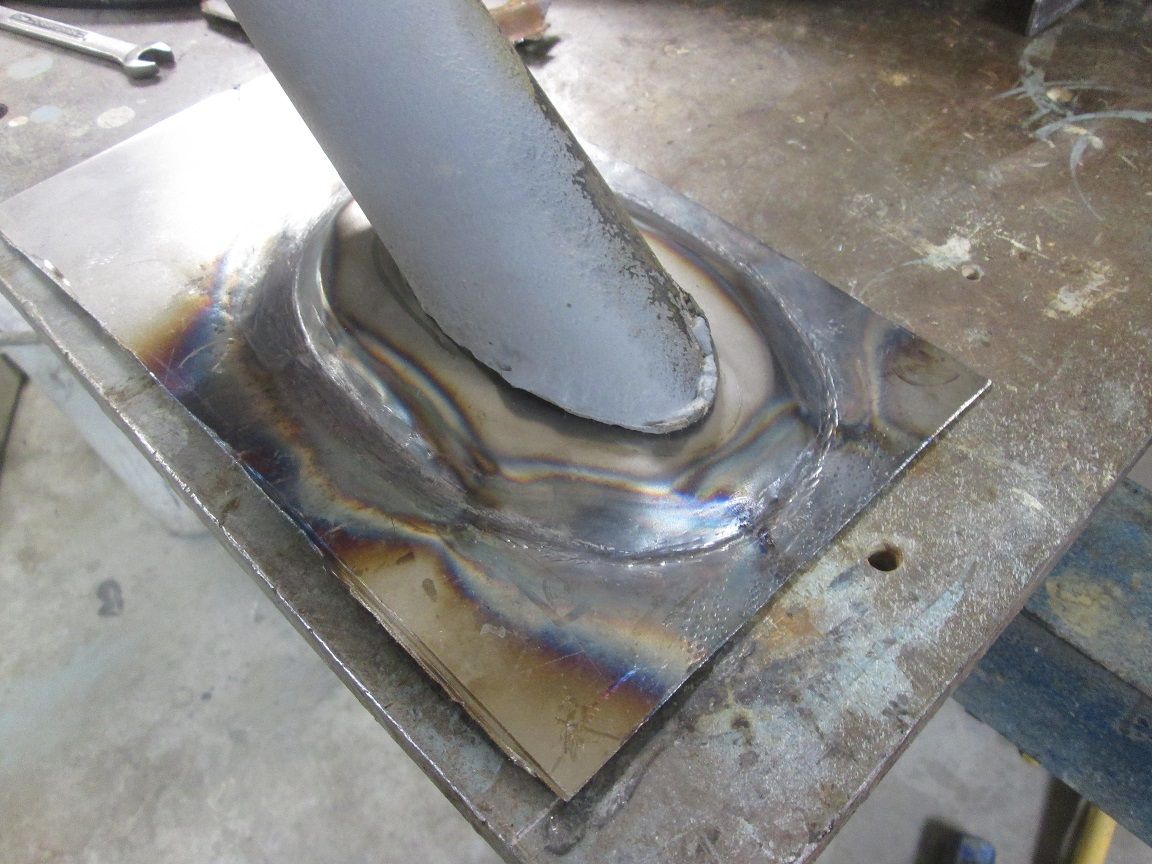

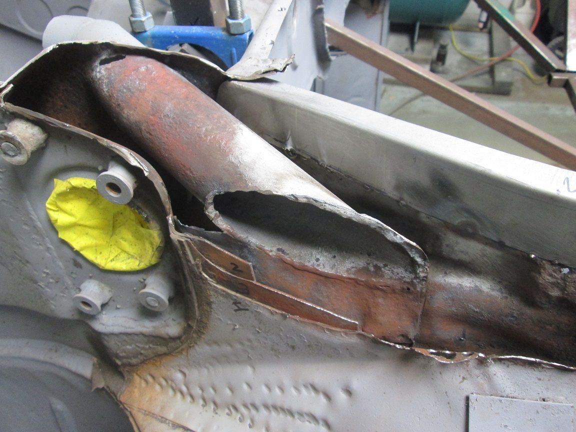

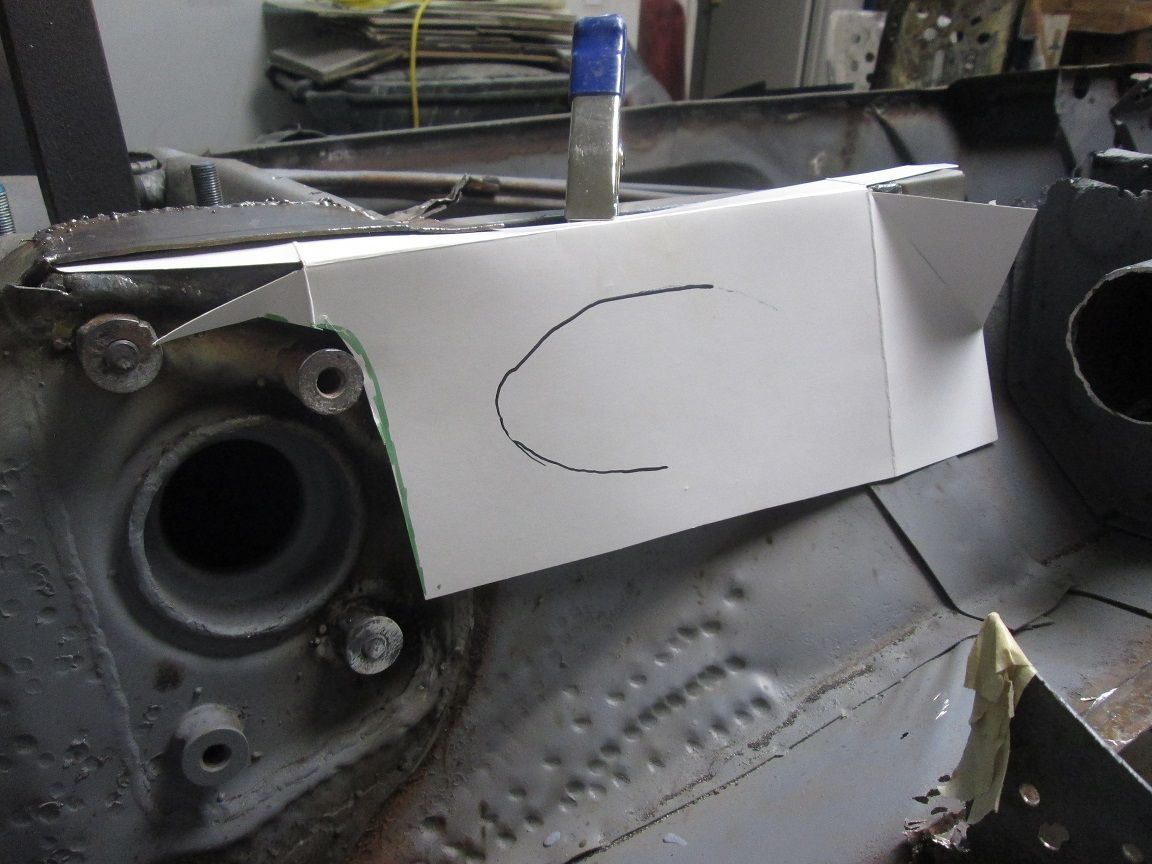

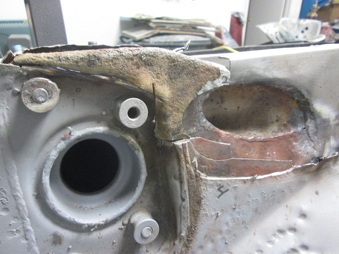

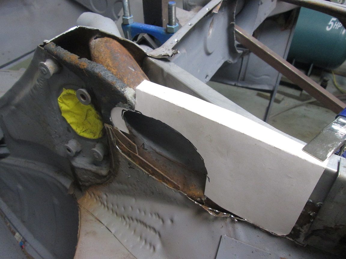

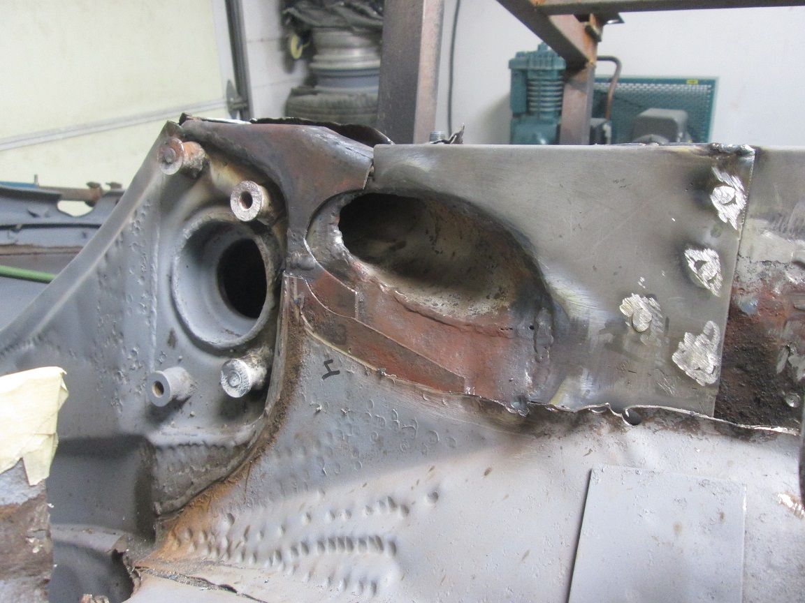

    Click image for larger version  Name:	image_64273.jpg Views:	3 Size:	153.9 KB ID:	111113 I wanted to end up with as much as much as full piece as possible so I had to peel back just a little more of this outer section to expose the top of this panel. As you can see it ends just under this section I lifted back.

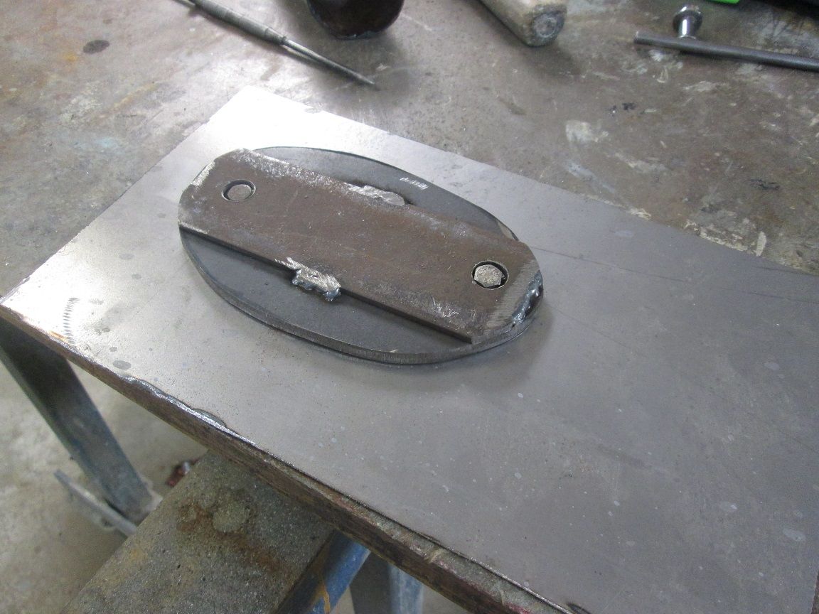

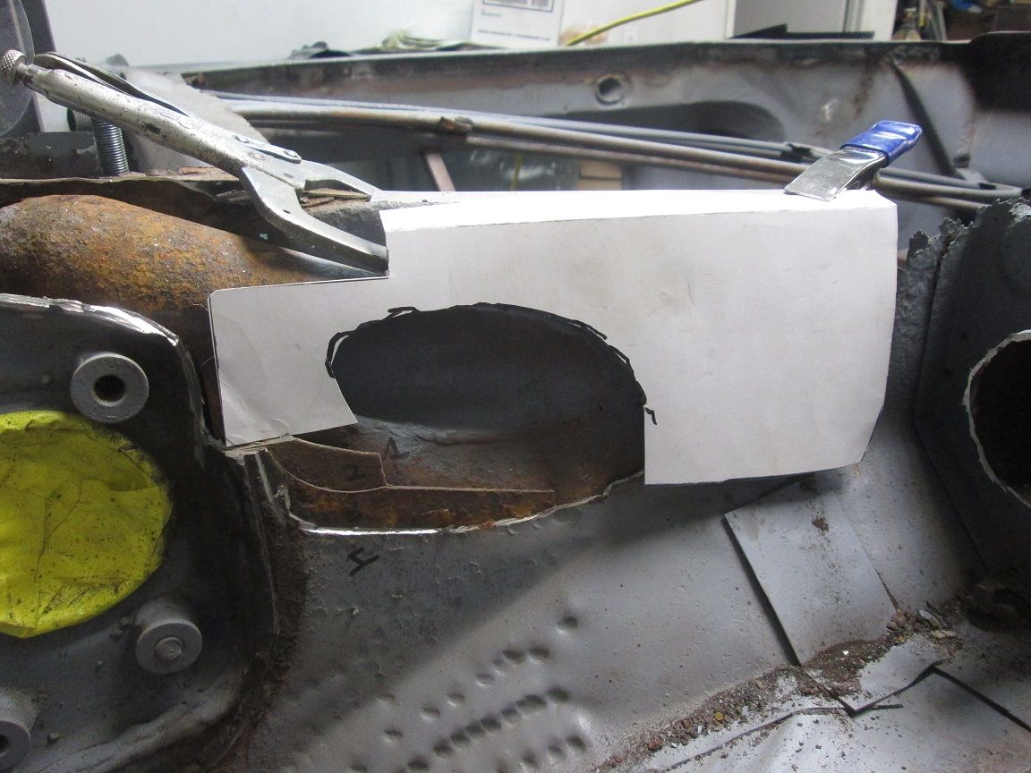

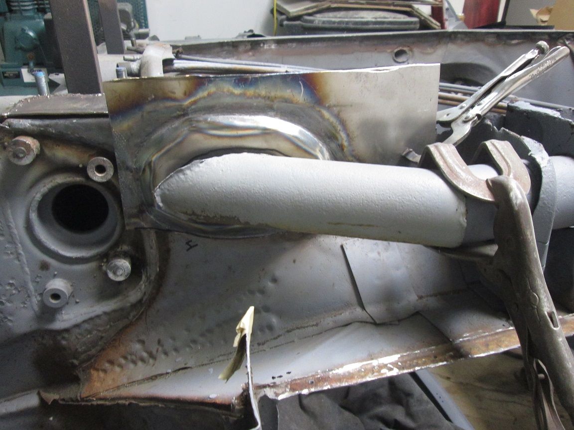

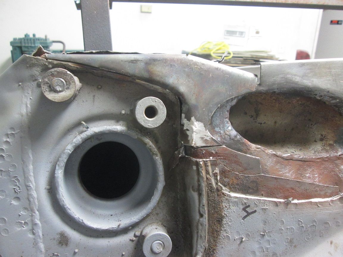

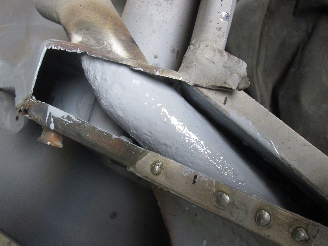

    Click image for larger version  Name:	image_64274.jpg Views:	3 Size:	156.3 KB ID:	111114 Finally touched bottom here and will not have to cut back any further. I'm switching gears for the moment and will be installing the interior wall and flange section first. I want a clear shot at the backside of it to be able to work the weld joint after its installed. This is something I remembered I wished I had done on the other side. Its been cut and removed here but I do have to finish cleaning the remains of it down in the corner.
