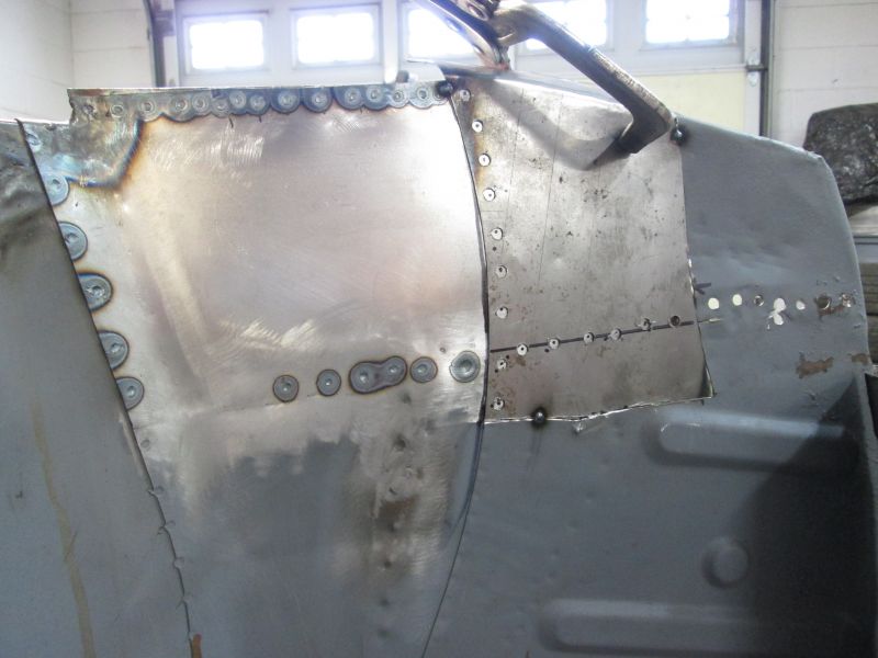

        • 7/9/18
          Right splash pan repair patch in.

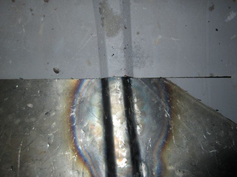

          Seam and plug welds all dressed. Gas weld detail at the base of the inner lap jont replicated.

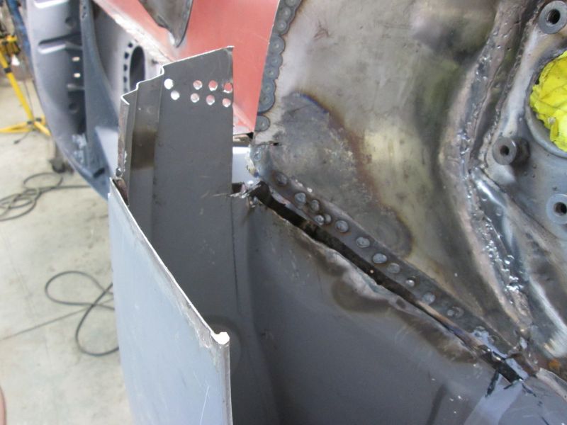

            Prepping for new inner wheel house panel.
            As this patch panel progressed
            It was becoming clear that the time was now to replace the inner wheel house wall as the corner of it intersects here and along with part of the inner gusset. I had ground into this intersection during removal so it all needs to addressed. Besides my original plan was to put the rocker in next but I have clearer shot at this panel with the corner of the rocker not there.

            So the time is ripe. My original thought was I'd do these after the floor but it all has to be done eventually.
            The original is breached and pretty thin throughout.

            Its even gone through in the far flung corners.
            Its a big interwoven piece and a repair patch would have been easier but it requires several patches anyway so one nice piece will make a much cleaner job of it and its provided so why not use it.

            Entire lower quarter window sill will come out.
            Tail end of this panel is here and is overlapped. Its going to take some digging and prep before its all over for sure.

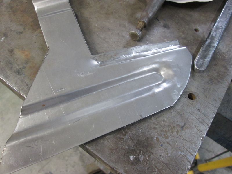

                Another quick practice run to see how close I could get the end to look.
                Again I literally spanked this relief in, in a matter of few minutes; and it shows. But if I take some time and care I think a nice relief patch can be had this way. No heat required either, all done cold much to my surprise. Anyway, new patch coming up next, hopefully.

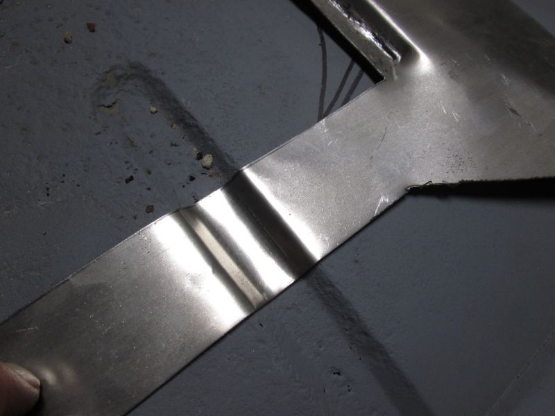

                  Hammer form will be tacked at the top so I can slip the old panel out and flip it over.
                  Tacking it ensured it didn't move as it was flipped and worked in blind. Basic relief spanked in here. Wasn't expecting the stretch to go so far past the end of the form but a little heat shrinking will fix it.

                  Drawn back up here. New Rib in only basic form.
                  Close enough to work. What I like most is how deep the draw is and replicates what's there.

                  Second rib in.
                  Shrink the end as before.
                  So far so good. Any misalignment or spacing discrepancy between these ribs and its back to square one.

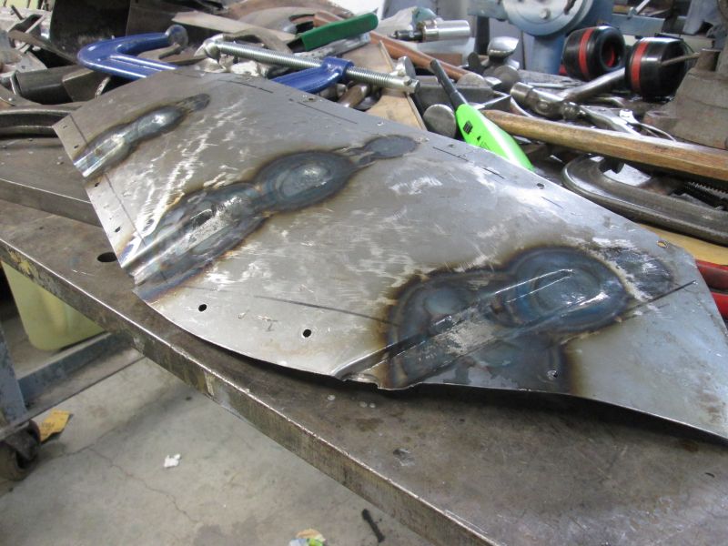

                  A usable patch.
                  OG panel shows an overall curved shape. The new rib features won't allow that so each one was heated where the sweep is need so they won't kink as I pried each one up.
                  Just a basic rudimentary part for today but I can at least use it.
                  More fine tuning tomorrow.
                  • Nice work. I always learn something here....in this case, how heat mitigates kinking as you bend the formed metal. Thanks! John
                    • Thank you John! Rigidity is what those corrugation shapes do so I had to soften them to get them to cooperate. Thanks again! Justin

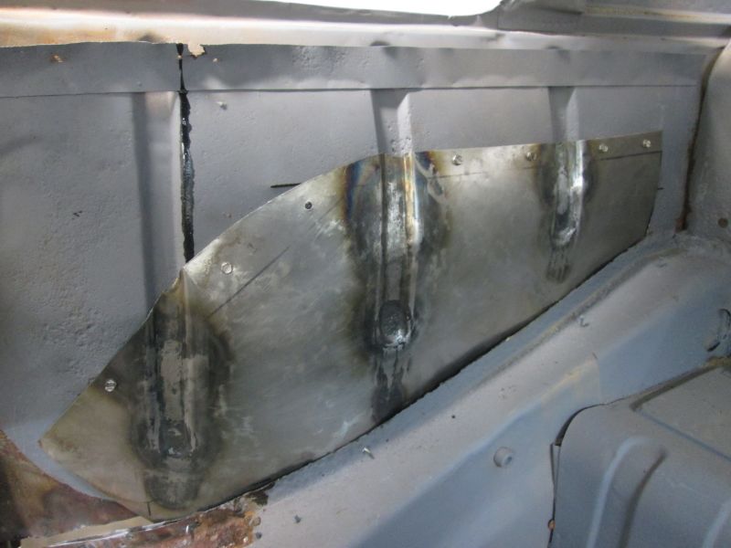

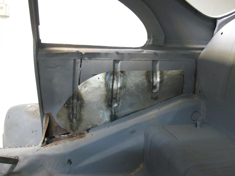

                      • 7/21/18
                        New patch panel tacked in.
                        Took some doing but finally have a replacement copy good enough to install.
                        Making a patch out Trevor's panel was tempting but the draw in the ribs just isn't deep enough to carry on the lines from the original features.
                        These details should pass the smell test just fine after a coat of rocker shootz.
                        Began installation by aligning (as close as possible) and establishing the center rib first. Tacked and moved outward from here.
                        Aligned the outer two ribs as close as possible next and tacked them. Everything else is completely secondary and adjustable. However this patch would be screwed if a huge misalignment occurred across any of these features. They don't match perfectly off the bat of course but they are well within range.
                        Since the panel has an overall curve it will contract slightly as the welding and pressure fit/alignment continues. If I'd have started at one end and worked back I'd most certainly have alignment issues across the ribs.
                        Already learned that one the hard way. Continue gluing this in.

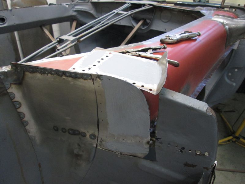

                          Inner striker repair section. Got a little ahead of myself and Had to get this done first as the inner wheel house wall is flange welded to this section.
                          Trickiest part was the gentle sweep in the trough to carry the line seamlessly.
                          Just about ready to weld in.

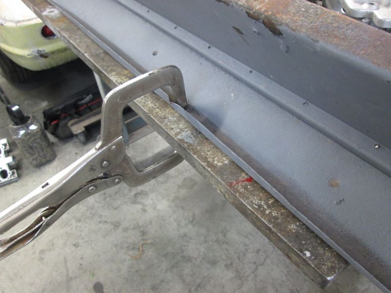

                          New sections tacked and old rocker installed to make sure its all in the right position

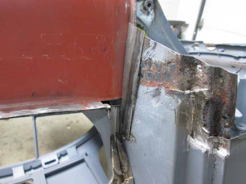

                          A few more pieces to make that comprise this corner but its closer.

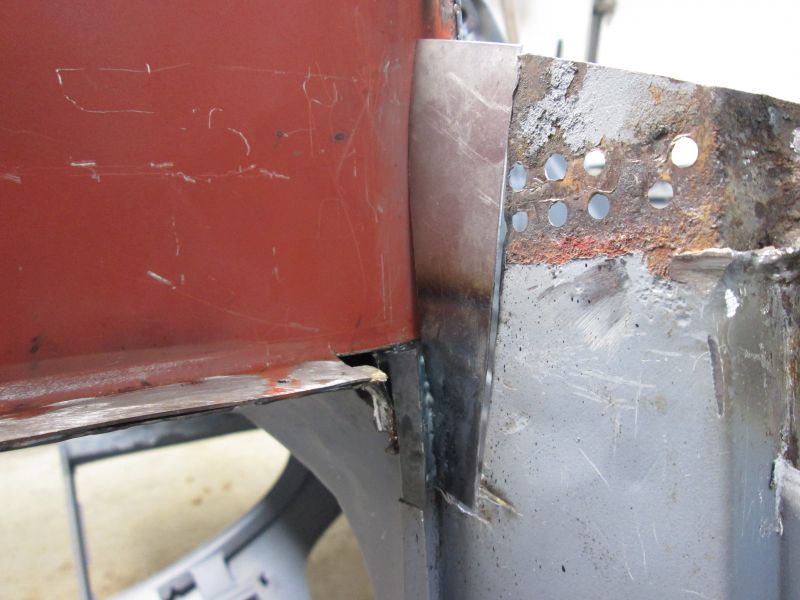

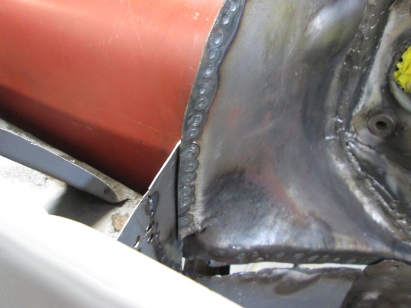

                          Striker mounted flush with its old flange. Leading edge is bent from me prying it but the drilled spot-welded section is sitting flush.
                          and rocker aligned

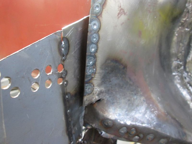

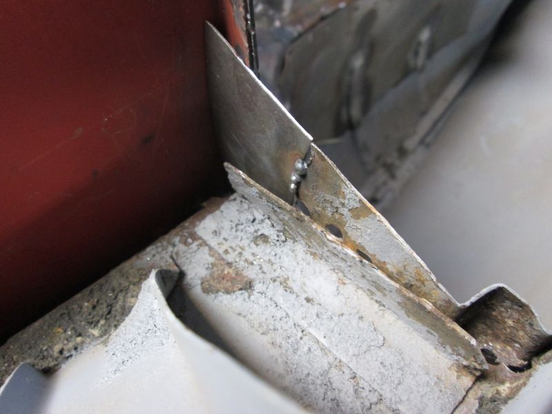

                          I have this air gap between the striker and flange. This is a problem as they are gas welded together.
                          The OG wall clearly shows hammer strikes where it was bashed forward through here so it could be seam welded. So its "legal" to bash this flange flush.
                          Indispensability of OG reference parts otherwise you're just guessing.

                            Begin replacement patch for the OG forward wall section first.
                            Miscalculated somehow on my final trimming and cut the new panel section a touch short. Certainly not going to toss it and begin again so I'll back fill it.
                            Using the chassis itself as the hammer form then locking it in place with a set screws as it went.
                            Almost trimmed and fit to final shape.
                            Ready to weld in.
                            Just about welded in. The leading lap joint edges where seam welded so I sewed them up too.
                            Cleaning up the welds. I'll go over those seams with my torch for the final presentation later on.
                            After wire wheeling the rust off the edge of the frame what was left of my new flange was heeled over tight and plug welded.
                            Shaped a filler strip and adding it on here; tedious.

                              New inner threshold corner shaped and tacked. One more piece that comprises this corner down.
