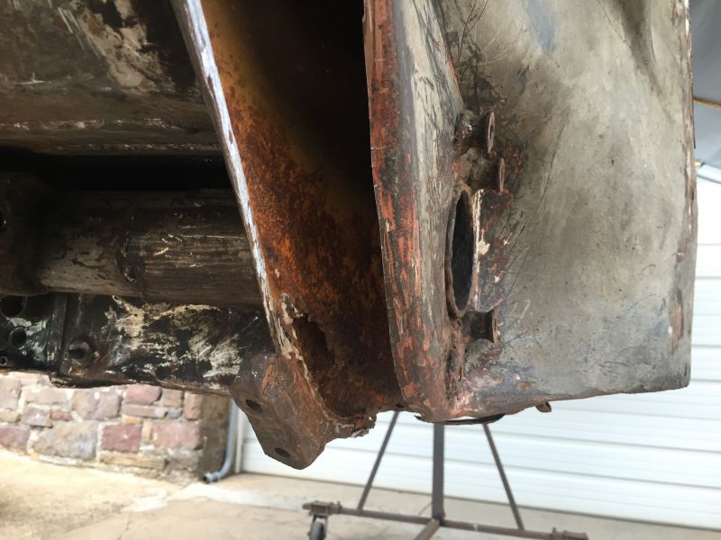

      You do this more easily on a 911:

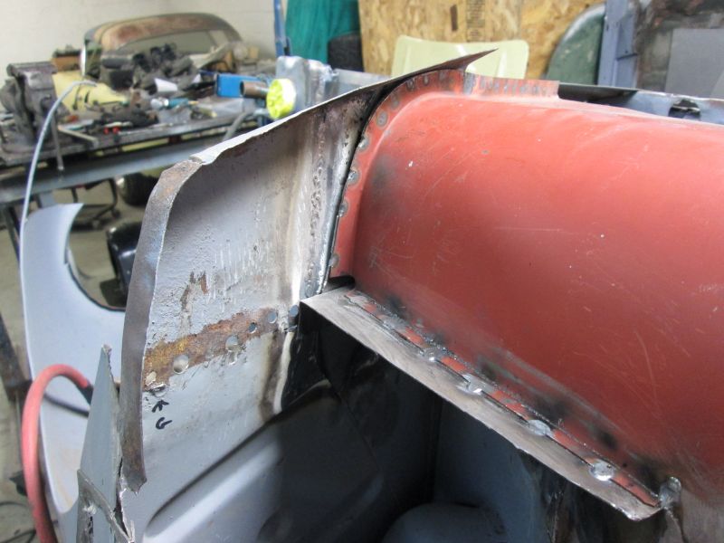

          Right splash pan repair patch in.
          Seam and plug welds all dressed. Gas weld detail at the base of the inner lap jont replicated.

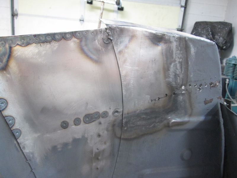

          Left the middle run of the plug welds loose for now
          As the forward rocker floor needs to slip in between there.

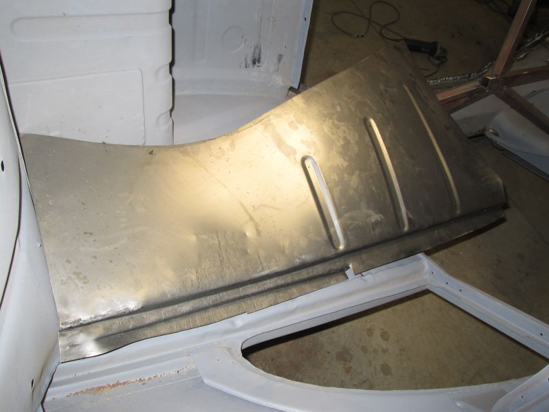

                      • 7/21/18
                        New patch panel tacked in.
                        Took some doing but finally have a replacement copy good enough to install.
                        Making a patch out Trevor's panel was tempting but the draw in the ribs just isn't deep enough to carry on the lines from the original features.
                        These details should pass the smell test just fine after a coat of rocker shootz.

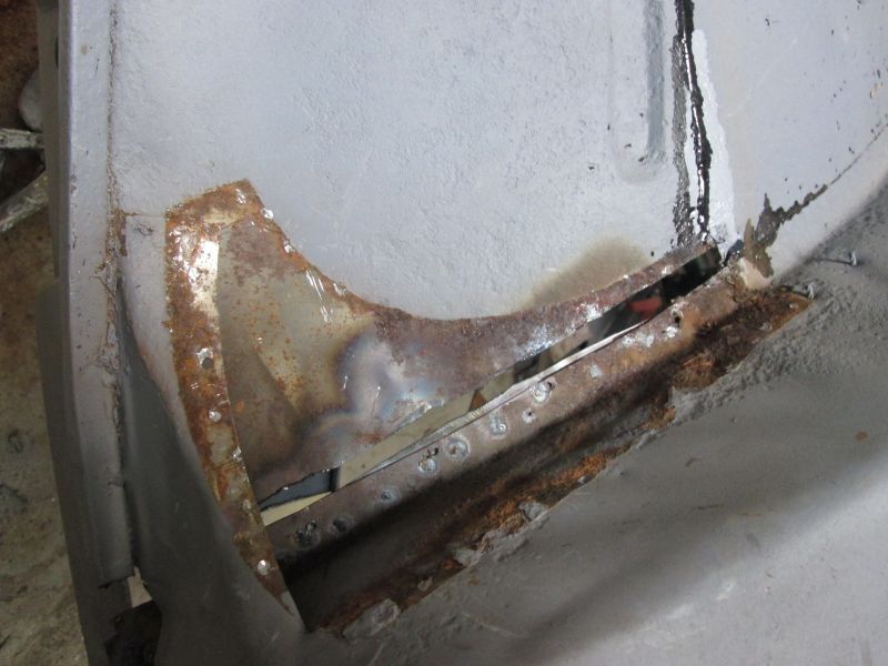

                          Not a whole lot of time to spend on it this week so I just got a pesky corner repair section made. Hoping to get some better progress on it this weekend.
                          Inner striker repair section. Got a little ahead of myself and Had to get this done first as the inner wheel house wall is flange welded to this section.
                          Trickiest part was the gentle sweep in the trough to carry the line seamlessly.
                          Just about ready to weld in.
                          New sections tacked and old rocker installed to make sure its all in the right position
                          A few more pieces to make that comprise this corner but its closer.
                          Striker mounted flush with its old flange. Leading edge is bent from me prying it but the drilled spot-welded section is sitting flush.
                          and rocker aligned
                          I have this air gap between the striker and flange. This is a problem as they are gas welded together.
                          The OG wall clearly shows hammer strikes where it was bashed forward through here so it could be seam welded. So its "legal" to bash this flange flush.

                            Flange run for wheel house closing panel.
                            Begin replacement patch for the OG forward wall section first.

                            Just about welded in. The leading lap joint edges where seam welded so I sewed them up too.

                              Forward end cap is hanging on by thread through this cancered out section.

                              More old damage just behind the recently removed section. A small crease from rubbing against something way back when.
