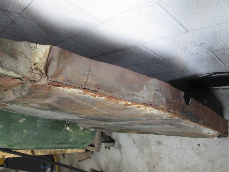

                  Right rocker out.
                  Finally got the last of the connective tissue severed for a full removal.
                  Extracted with almost all of the edges and corners intact.
                  It will need some lovin' but its still a solid savable piece overall.

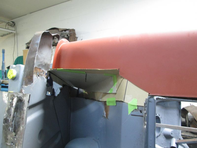

                  Begin template for the forward tray.

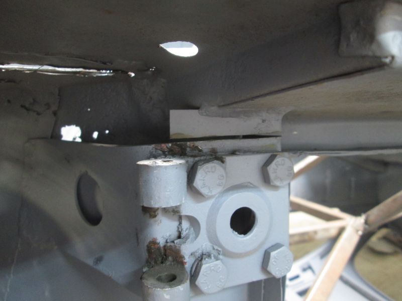

                        Lower hinge boss removed for a clear shot at the rust in behind it.
                        Basic paper template done so the remains of the inner tray floor was removed next.
