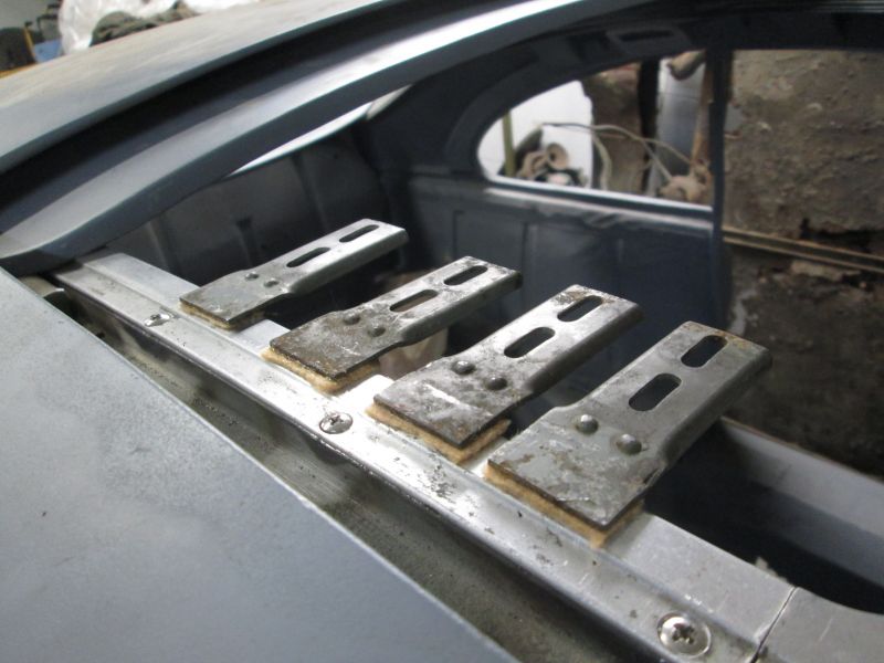

                        Began with a closer inspection of the footings. A felt liner shores up the contact with the rail but all these where bent open and slightly twisted. I would never be able to get a final adjusted fit with all this slop at the point of contact. BTW: these seem to be painted the same shade of grey that I had mixed up to match the steering column and wheel in my coupe.
                        Pretty damn close..

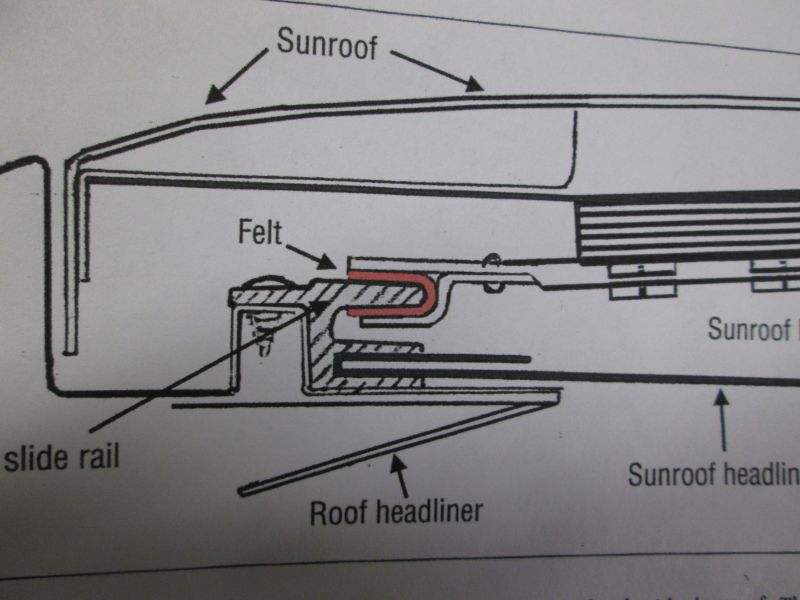

                        Supplied diagram shows the felt liner and parallel flanges.

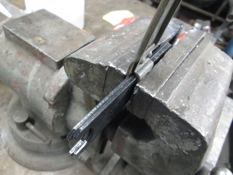

                        Pair of spanners where the right width for squeeze back to even and to reverse the twist without collapsing the tongs.
                        Some free style squeezing was needed to get that last little bit.

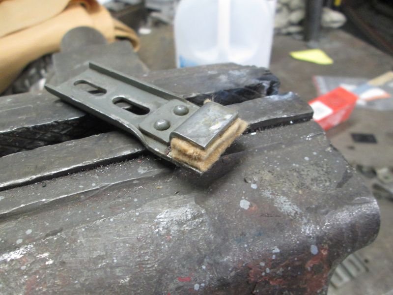

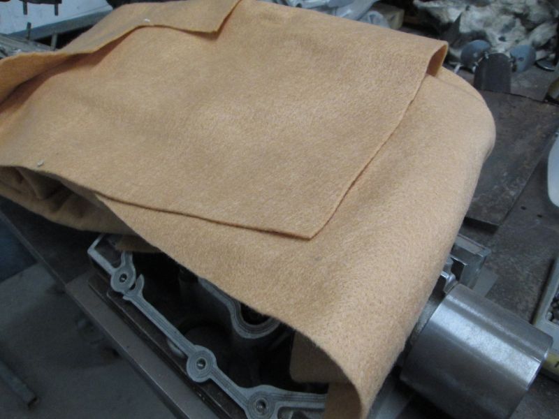

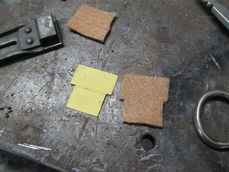

                        Looked at this felt I had on hand first but it seemed a touch too thin.
                        This other muslin type felt that I used for my headliner install seemed to be just the right thickness.
                        Quick temple for cleaner install.

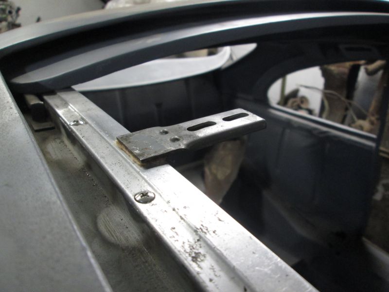

                        Glued
                        Not too firm, but a positive and smooth fit on the rail. Even holds itself there. So glad I looked into straightened these and not just added the felt. Repeat three more times...

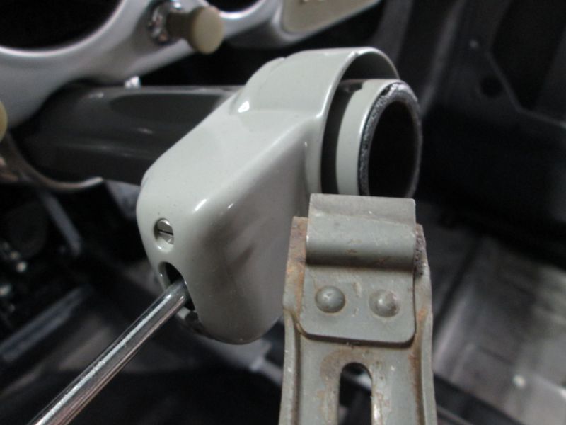

                          Reassembly of the actual mechanism is simple once you've done it once but since I didn't take this unit apart I had to rely on a photo and diagram to get me though. These corners can be the most confusing until you see one assembled.

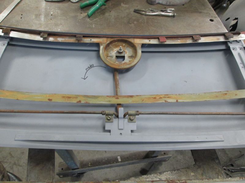

                              Headliner frame repair.

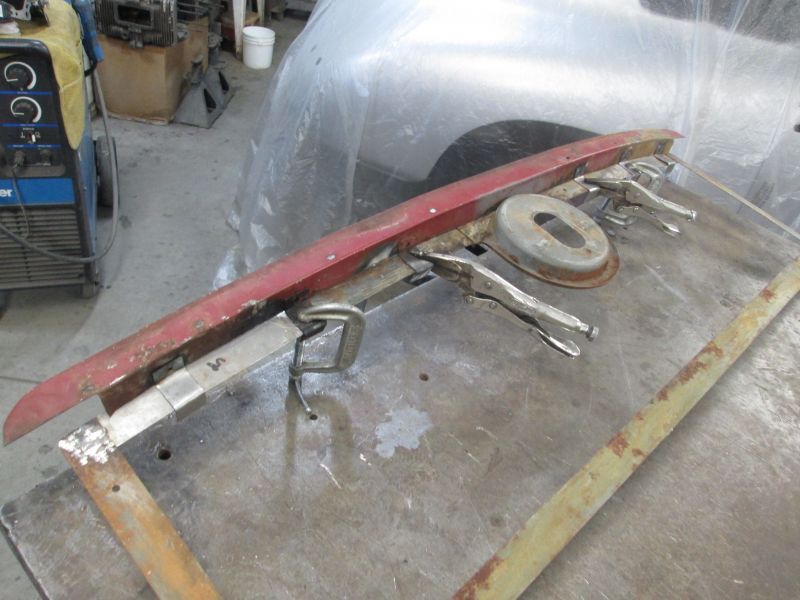

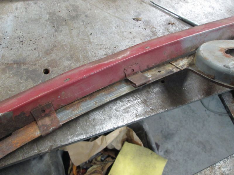

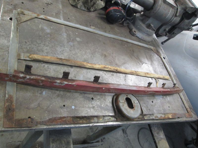

                              A repop frame was supplied but the cancer is so localized that it would be a crime not to fix and use this original. Only the forward lateral sections and four of the attachment clips need help.

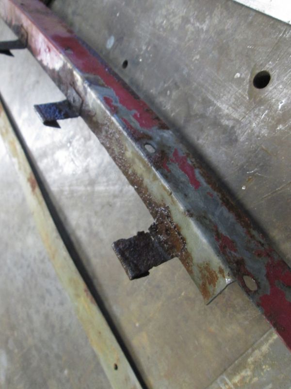

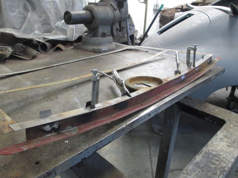

                              Want to get past the rust and weakness all the while saving as much of the original metal as possible. Decided on making the cut just center of the holding clip to both conceal it and to support the weld joint.

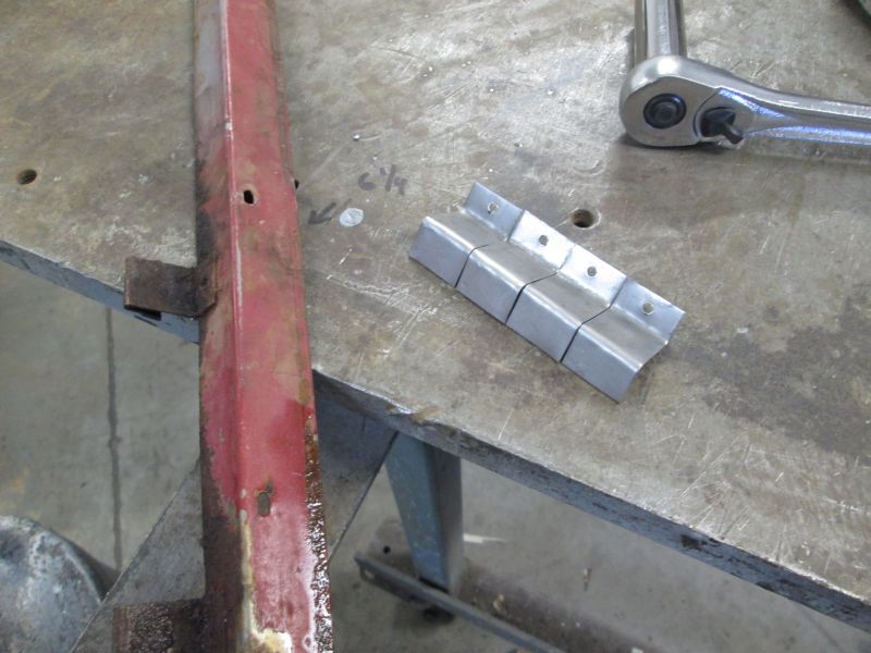

                              4 of the 6 clips need replacing but they could not be easier to replicate.

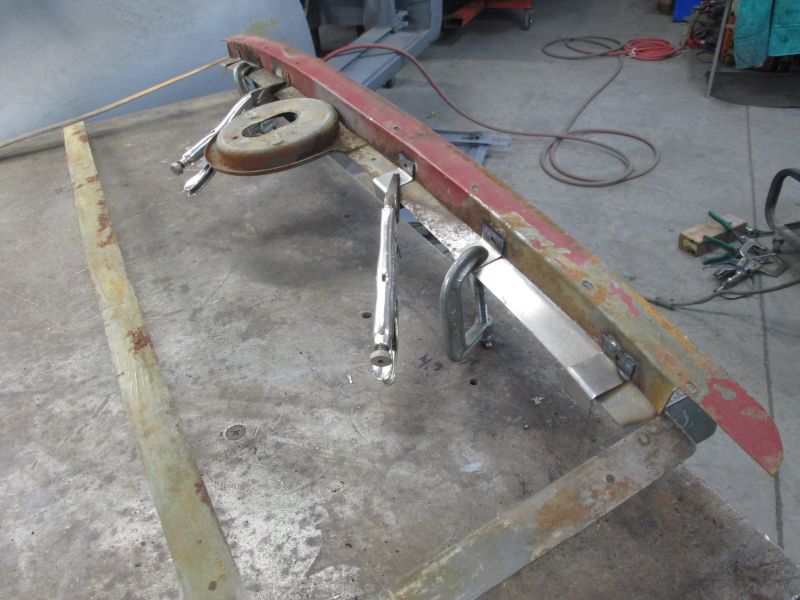

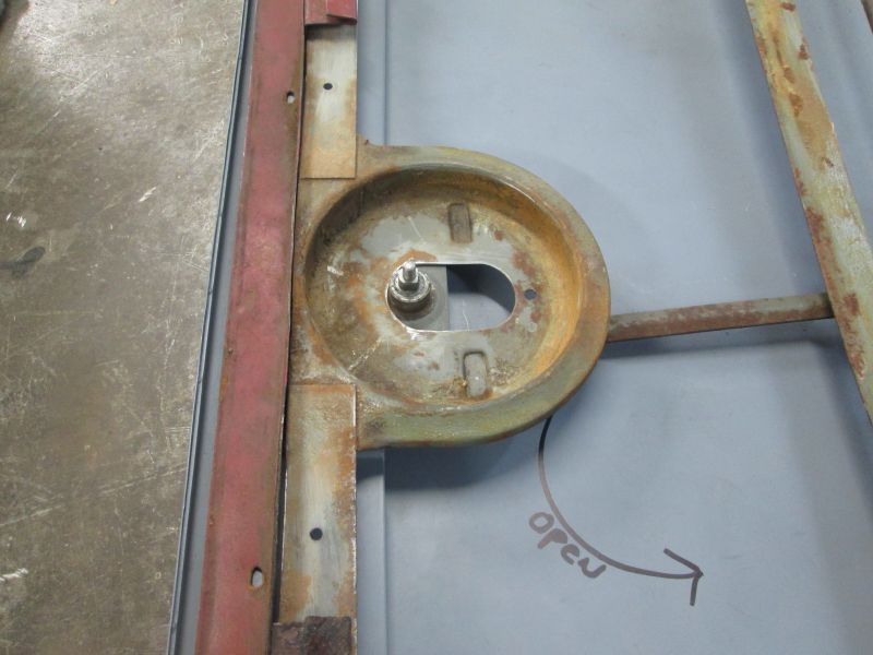

                              Left side provided me with placement and center for the release housing.
                              So the right side went first. New section all grafted in here. Repeat other side.

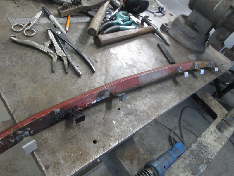

                                Headliner frame repairs nearly complete.

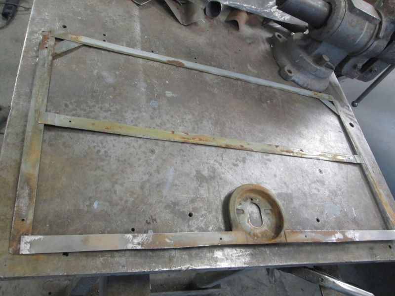

                                Lateral repair sections complete and this thing is one piece again.

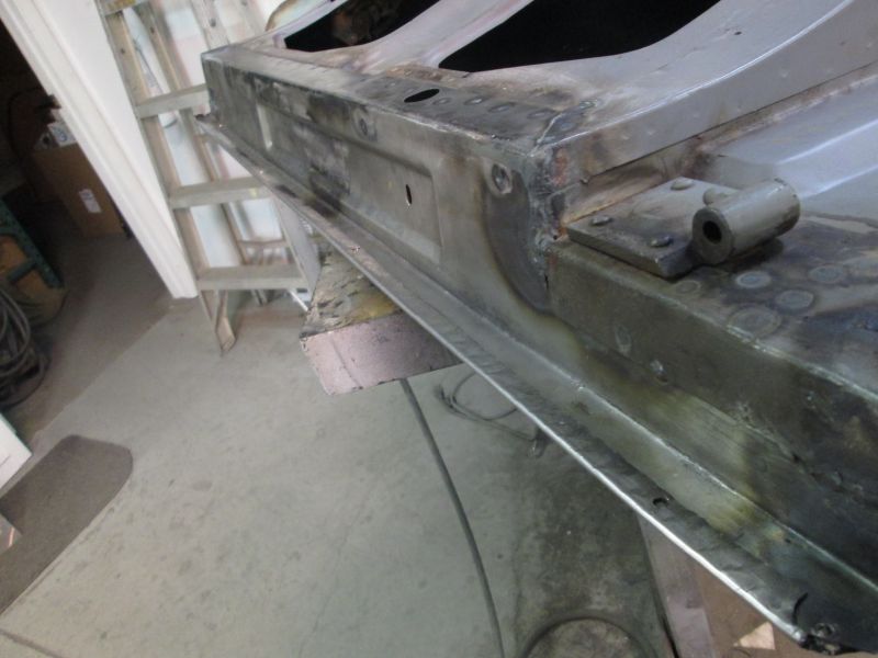

                                More clearance was needed a very long time ago in this slot opening and it was crudely tin snipped way back when. Decided to clean up the shoulder and file shape past the damage. Socket was the right OD to etch around

                                Last repair was to replace the clips on the header.

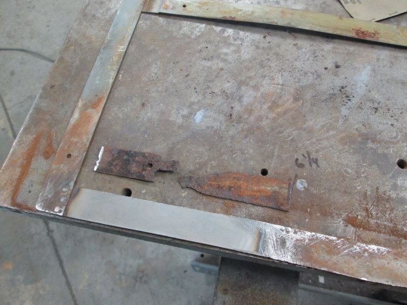

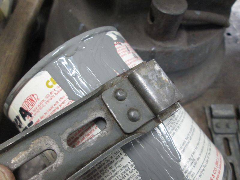

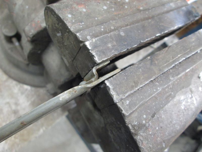

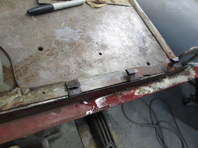

                                New clips folded and ready. The OG clips had a small hole which I'm thinking was just a marker to ensure the clips where not installed backwards.
                                all the clips on the right side where cooked

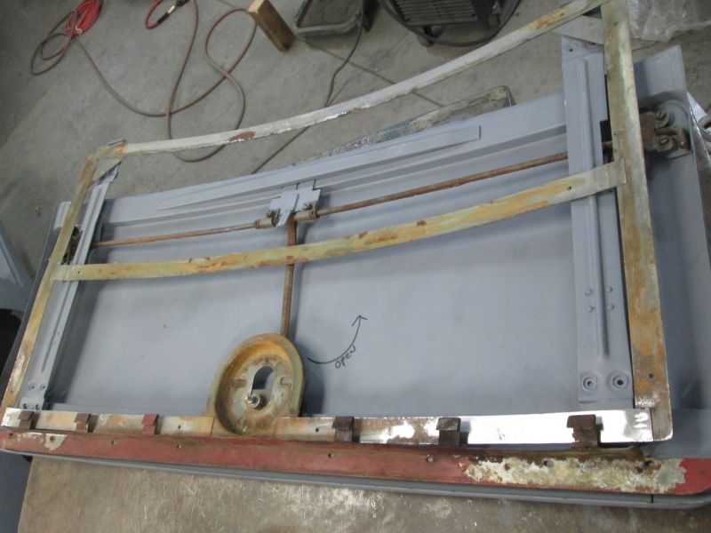

                                After that I test fit it all with the car.
