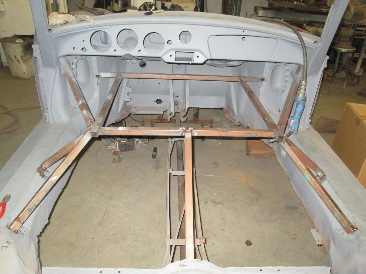

      Thanks for sharing your build Jessie! Yep, pretty much what I was expecting to see on the inside. The only two pieces of advice I'd have at this stage is to finish stripping all the removable parts then get it all media blasted clean so you know exactly what your up against. You can count additional and deeper rot than your now seeing. The last must have at least in my opinion is getting it on a rotisserie to perform the chassis repairs. Its shear torture to attempt chassis repair on your back
      Looks as if both longitudinals are compromised and open on your car as well. Even though you have the triangulation of the roof the integrity of the chassis is severely compromised at this point. I'm in the middle of similarly rusted out 59 coupe and added this holding jig as added insurance. This is the second car its been in and what works best about this design is it stays out of the way while the longs and floors are installed and can stay through the duration. Click image for larger version
      Hope this photos shows. trying to get that issue resolved.

      That looks like a great project. I will second what Justin recommended: take everything off with lots of pictures then get it media blasted. You'll then have a much better idea of what needs replacement. I put mine on a hoop rotisserie and got it media blasted. Shoring up the interior with braces and making sure the body is in spec are also key.
